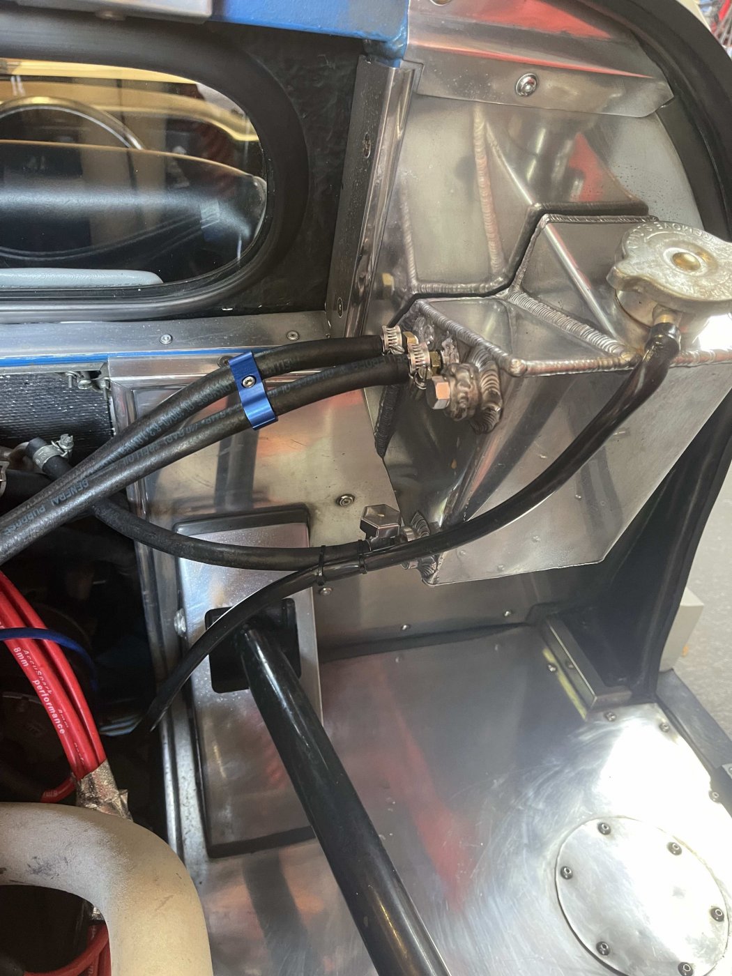

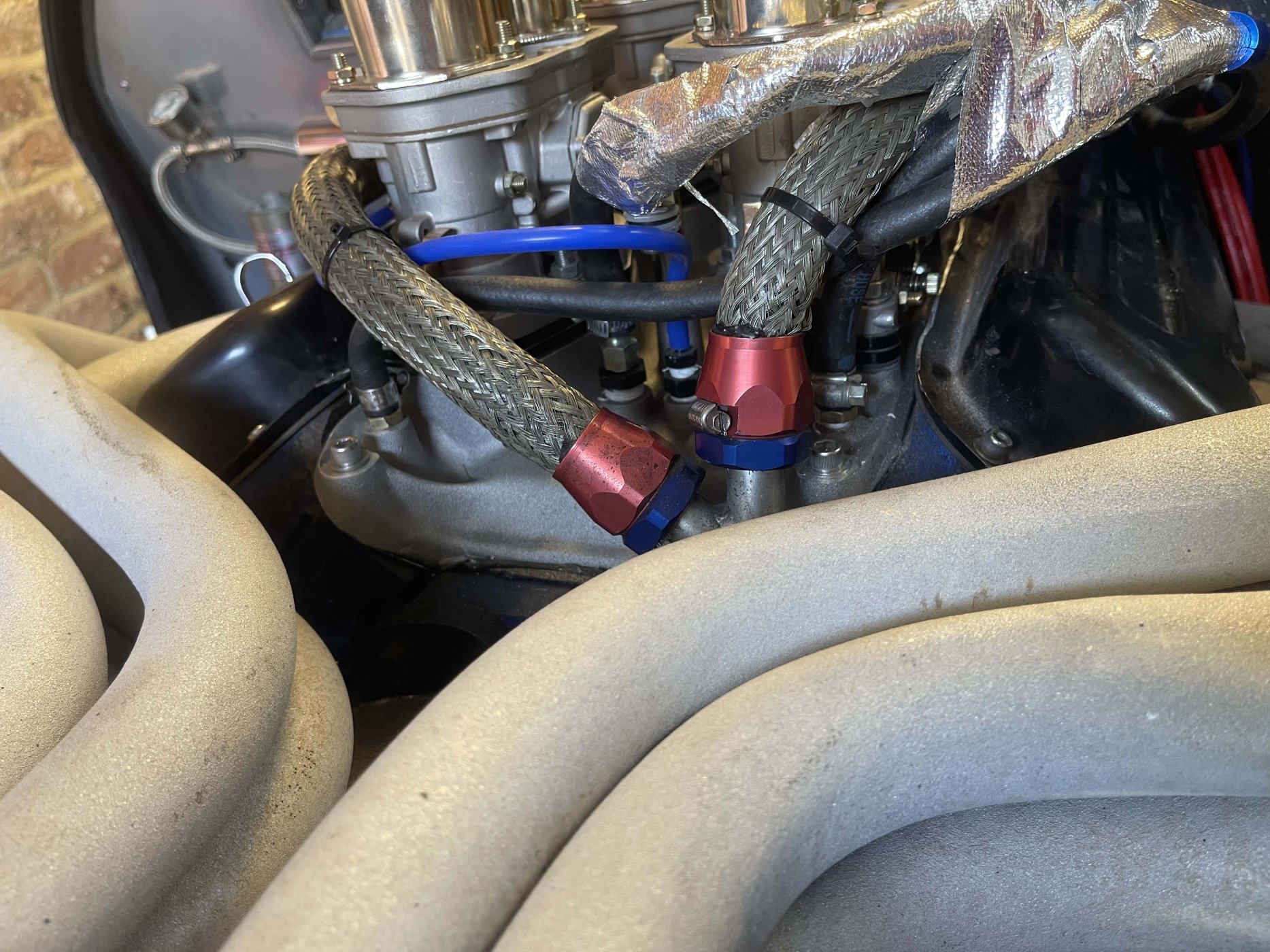

As a part of the ongoing development of the car, I've made another change since moving over to the Weber IDF's.
After speaking to a few people I decided to add some inlet manifold air bleed lines to the header tank. My Weber inlet manifold does not have any channel (just blocked) for the water ways at the back of the manifold which are often present on other manifold.
Hence, to stop the accumulation of air and subsequent lack of cooling at the back of the block, at least the air can bleed off. Will probably result in a little water circulation that was not originally catered for but every little helps.
I drilled and tapped the manifold before it was put on the car in prep for this mod.
As suggested by Frank Catt, will drop the lines down to something like Dash 3 in time but for now just using what was to hand and test Today as essentially getting everything ready for the Le Mans Classic now.
Nick.
