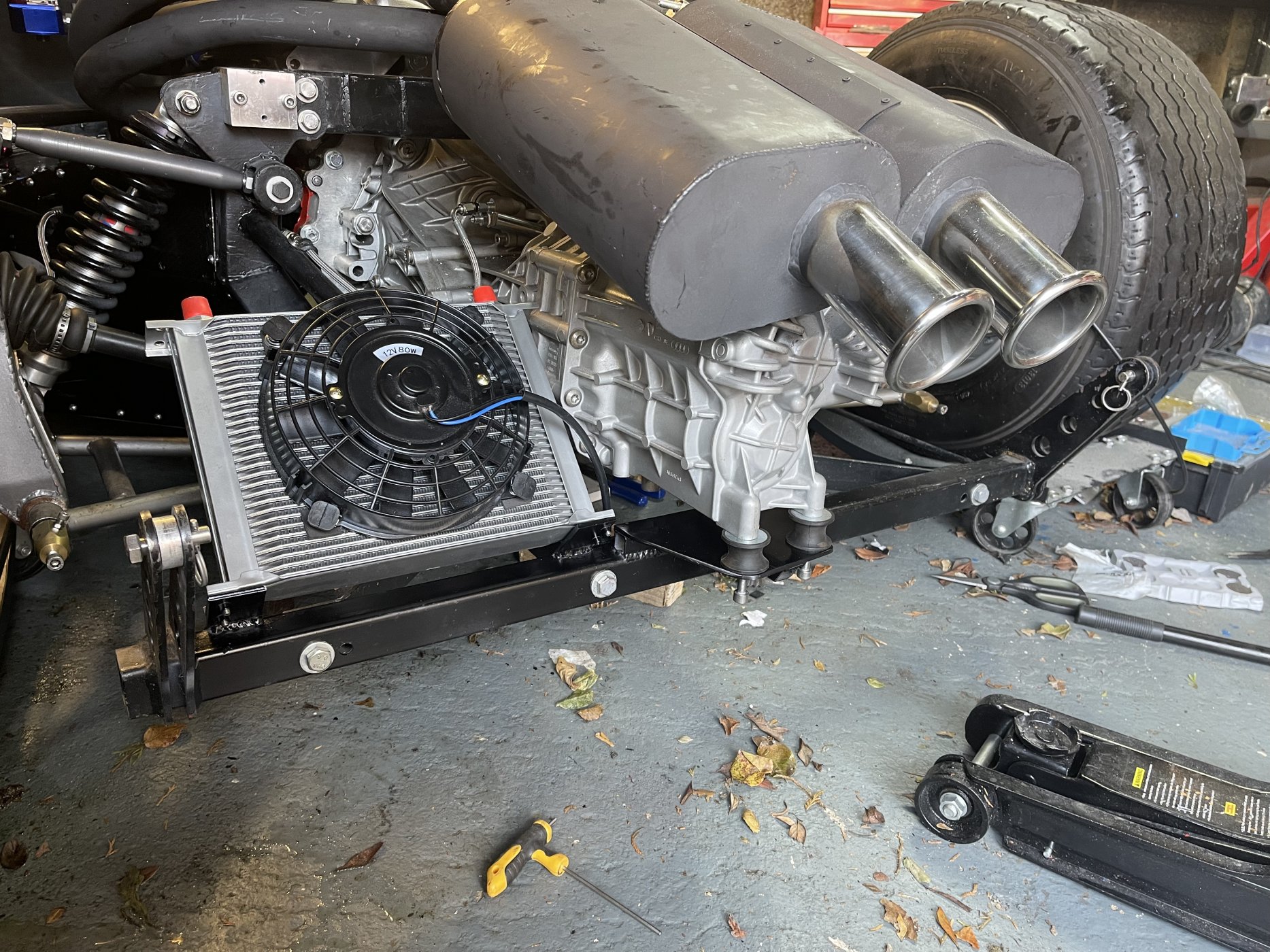

Some good progress since the last post. Gearbox is now back on and I’ve fabricated a new gearbox mount to cater for the 01x. Very pleased with solution. Also relocated the oil cooler rad to the rear to de clutter it’s original position and to also simplify the oil pipe run.
Plan is to go for a full engine test next Sunday and bring her up to temp to check for any coolant / oil leaks before pressing on.

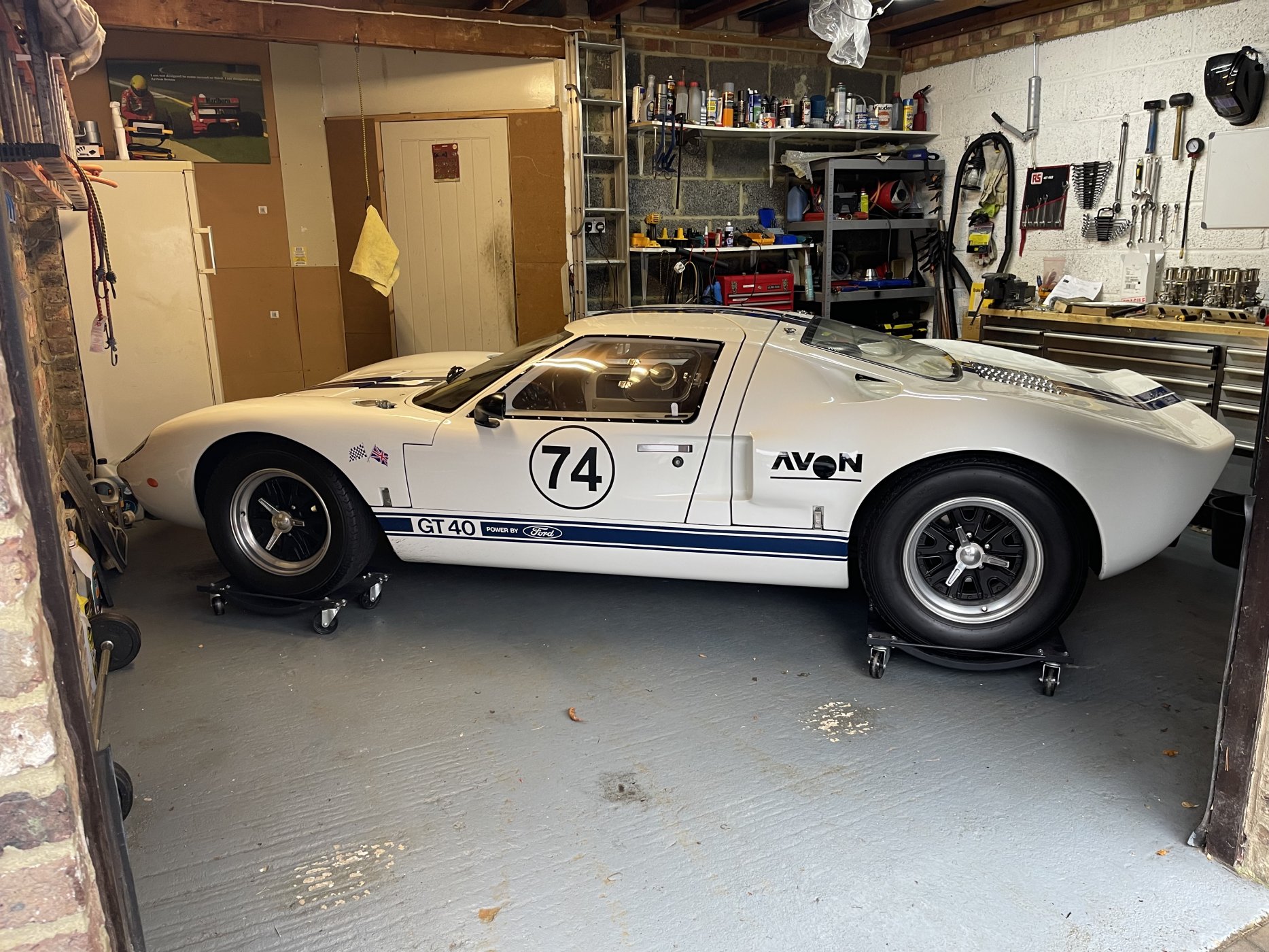

Although my wife and I decided to sell our almost completed GT Forte we opted for the next best thing given our need for flexibility going forward. Hence, we are now the owners of a stunning Mk1 GTD allowing us to live and enjoy our dream car.
With my 60th approaching in just a week, couldn’t be happier. ;-)

Lee Patterson
Beautiful car Nick. Always loved the GTDs. Remember when they were first imported here to San Diego and a couple of them were here. That was many years ago. Your car is quite nicely done. Congrats.

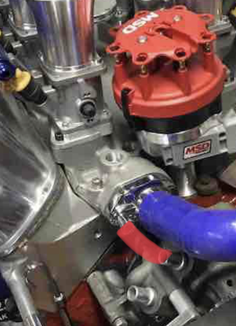

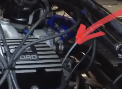

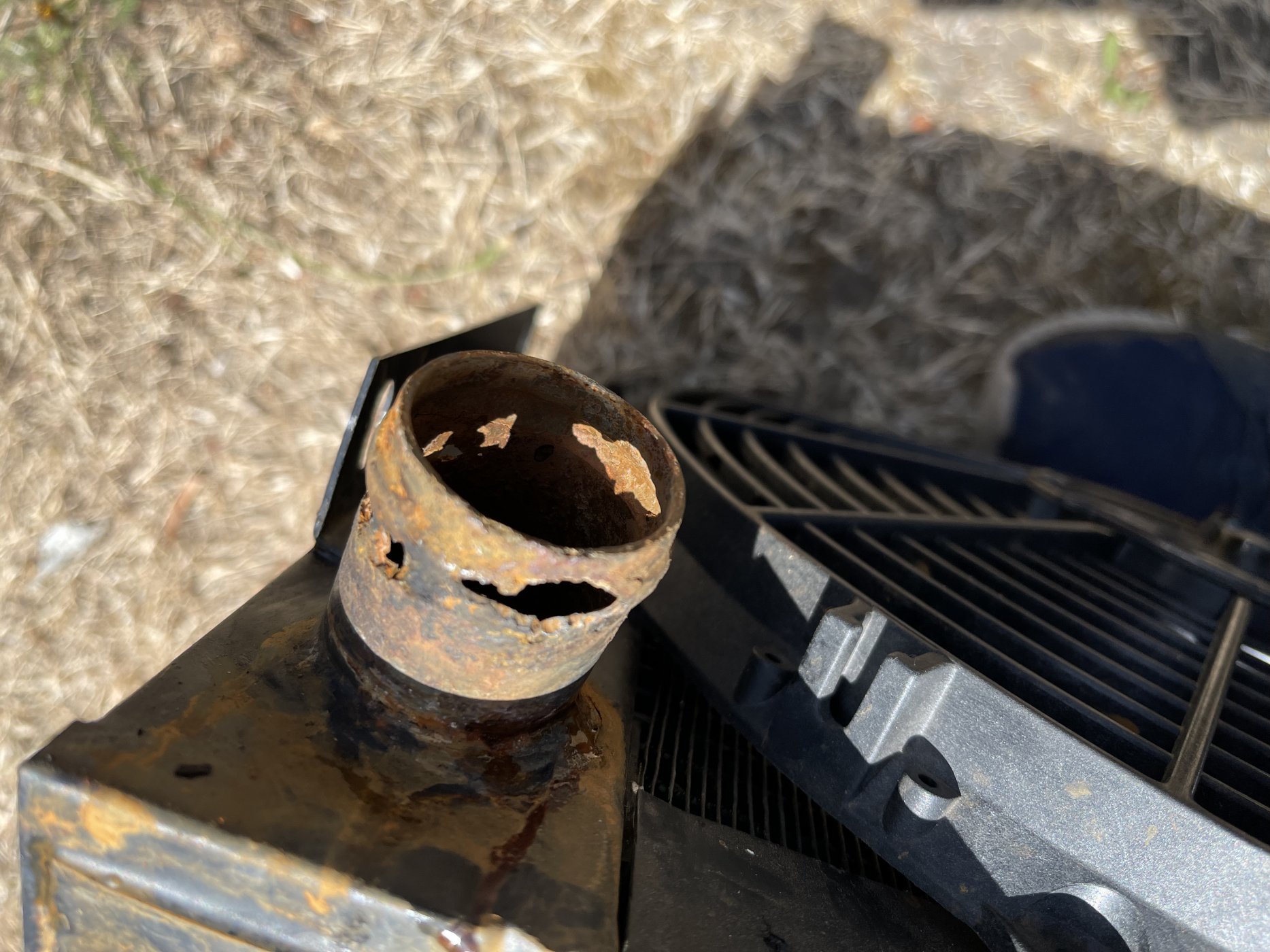

Quick update on my GTD as I bring her up to date.
Video to outline the issues and a pic showing the core problem.
Nick - sorry to hear of the radiator issues.
in regard to the electric water pump and restrictions at 5he thermostat..
It appeared in one of your videos that you did connect the thermostat bypass hose - so this would alleviate any issues in regard to a deadhead stoppage to the electric pump.
Also, if you do decide to drill the thermostat, I do this in the main body of the thermostat, close to the sealing edge of the stat to housing. A single 1/8“ hole works wonders for getting air out of the system.

Hi Bud, those pics are from my GT Forte which I sold on. No I have a complete GTD.
Sorry about the mix up - I just went back a ways in this thread…. Either way, the information given should still work for you.

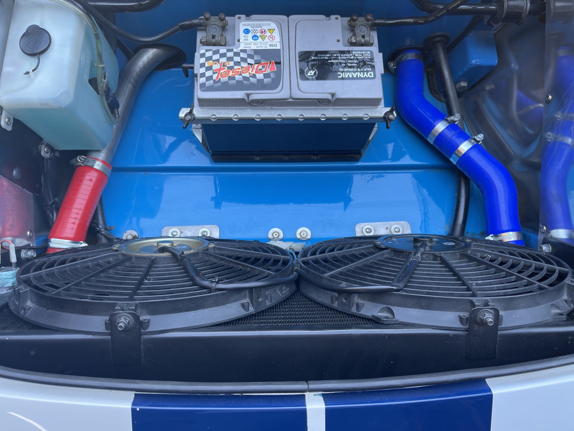

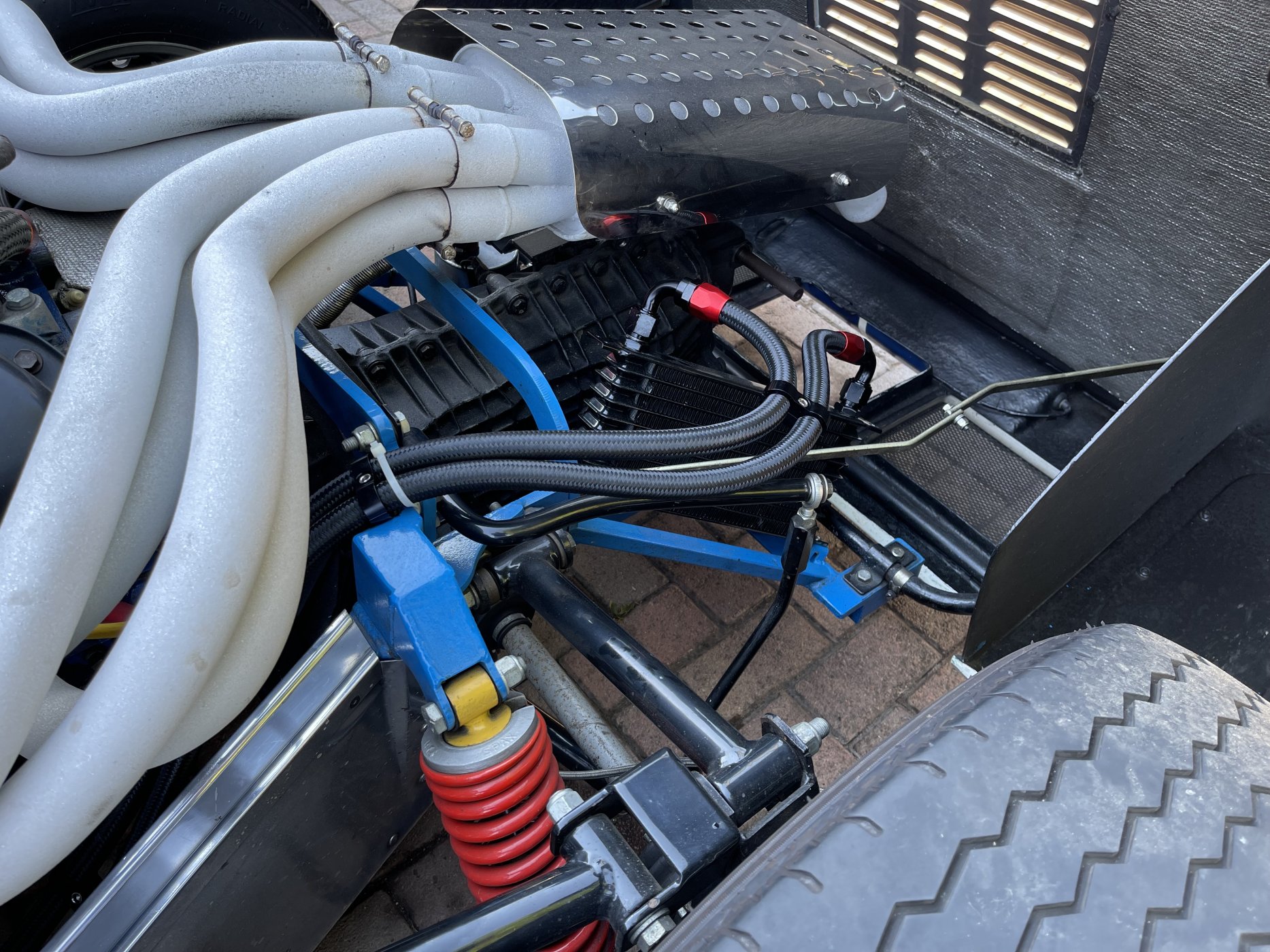

Just a quick update as I get more familiar with the GTD. To help with engine cooling all around I have just completed the fitment of an external oil cooler which feeds from a thermostatic sandwich plate between the engine and oil filter. Had to switch to a slightly shorter oil filter to the original given the tightness for space but all in all, well pleased with the result. As always, the position was a compromise given the lack of options at the back of the GTD combined with me playing it relatively safe.
Other small jobs in progress to slowly but surely bring her closer to my liking. ;-)
