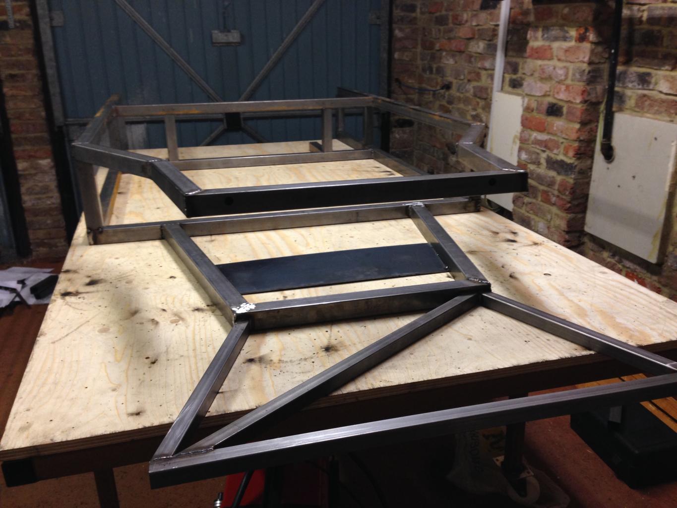

NickD
Many Thanks Dave. Its certainly going to take time so getting underway while the enthusiasm is at max. I've spent the past few hours getting the basic lower level in place as it'll be the foundation so extra care on this first step.
Image attached.

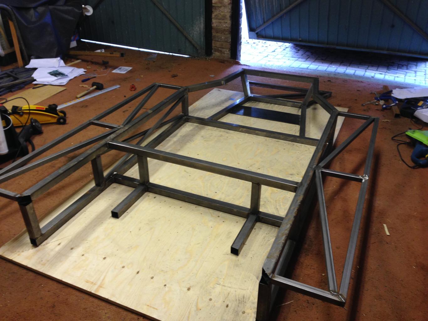

NickD
Thanks Renato,
I've put another 4 hours in Today and have built up to the middle section. Firmed up a few of the welds and checked everything is square and true as best I can.

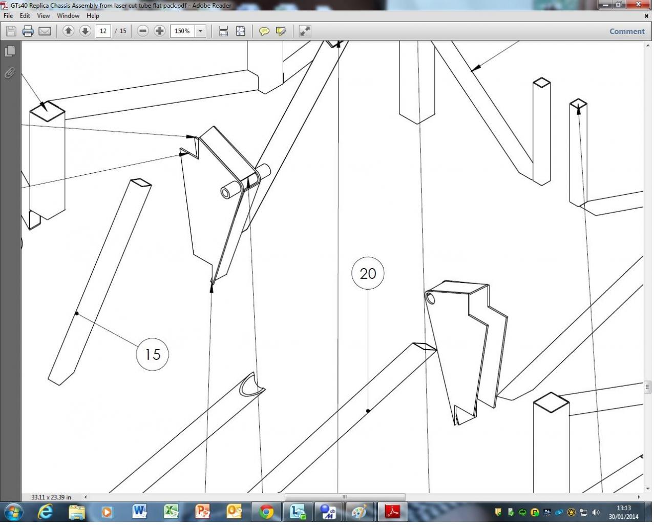

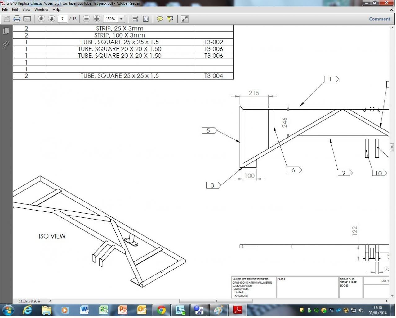

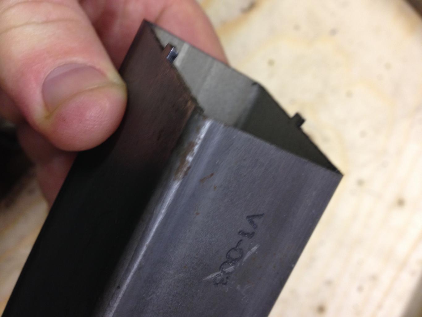

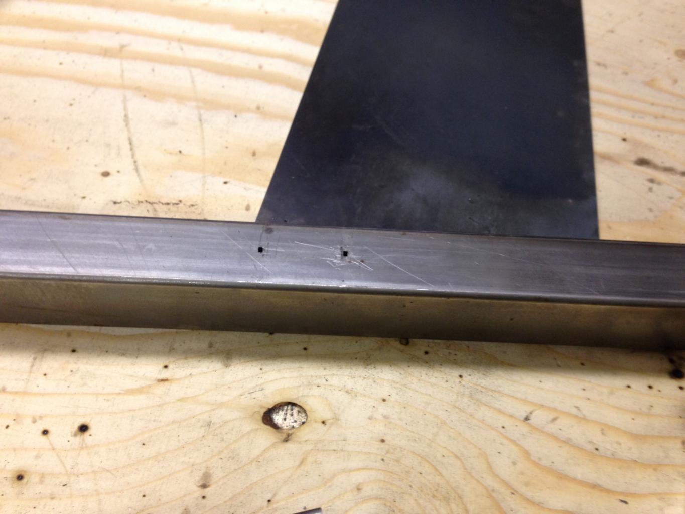

So looking at the Laser Cut Chassis Kit, what did I get and how does it go together.
Approximately 200 separate pieces of Pre Cut steel of various shapes and sizes. Each Part when originally laser cut had also been etched with a component reference. PDF documents showing how it all should go together. Thats about it !
Many of the components have a small Male / Female laser cuts to aid in the positioning.
So, excepting the inevitable "received 2 of one item instead of one of another" and the need to sometimes slightly re-position an item and override the pre-identified positioning, I seem to have got along Ok for a relative beginner, albeit with an Aerospace foundation.
The four images that follow should help clarify the above description:-
Any queries, drop me a message.

Have thrown a further 4 hours at it this Morning so now have the core of the chassis done, now to get the next bit done by next weekend.
Nick.
