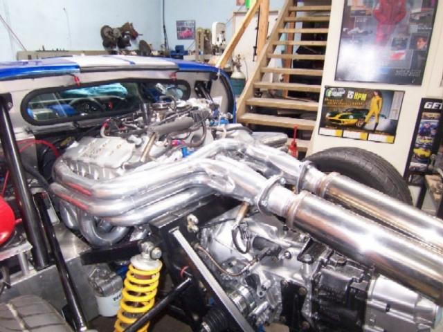

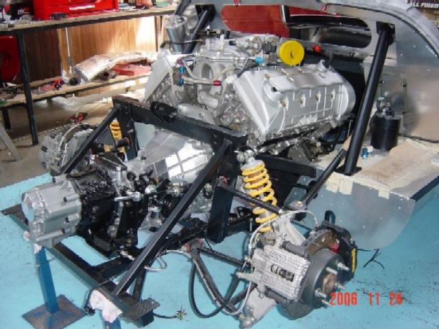

I run a 4.6L 32V Cobra engine (because of OZ emission controls) with Motec M800 management system. The car runs like a dream with good torque through to sixth gear. The cost of the crate engine was and still is quite reasonable (approx $6.8k AUD). I did my time on the older style engine in the 70's owning a Mustang and working on my mates GT Falcons. To my mind the newer engines are a giant step forward.
David
