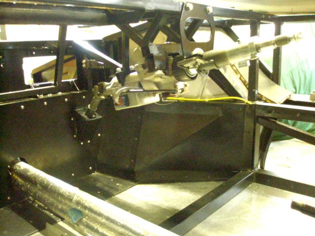

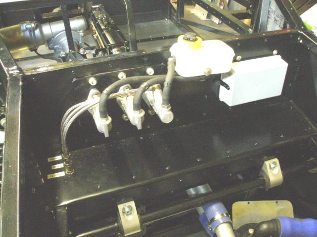

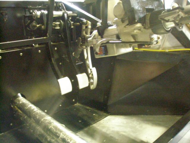

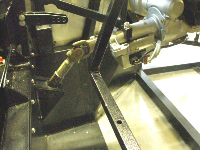

A little more progress; the Steering column and the pedals have now been installed. To improve access to the steering rack etc, I decided to make the front bulkhead removable, so it’s now held in with rivnuts & 5mm screws. The seal around the intermediate shaft has been cut from some 12mm close foam sheet I had kicking around.
Regards
Andy

Hi Andy,
Could you tell me what the steering column is from. I assume its electrical assited. I have been trying to find an assited steering system in Brisbane for my RF for some time and yours looks like it would be ideal. Fantastic build by the way.
Mick
Hi Mick,
The unit I’m using is off a 2001-06 Vauxhall/Opel Corsa (Corsa C) and an interface unit is readily available (from Ebay) to vary the amount of assistance the motor gives. Hope this helps
Regards
Andy

Hi Skeleton,
Firstly please use your real name, as it’s much nicer to know who you are talking to
I used a 2001-06 Vauxhall/Opel Corsa (Corsa C) column and modified the intermediate shaft to fit onto the Ford steering rack. You will also need to purchase the ECU & connectors, but most sellers on ebay include these
The interface unit for the motor controller from rallywiz.com looks like the same unit I have used.

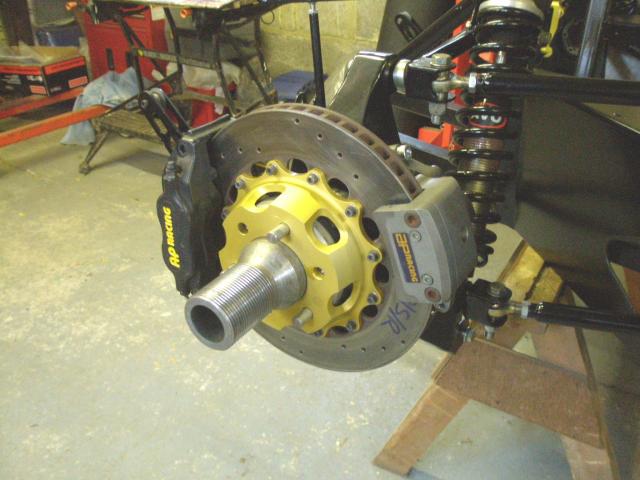

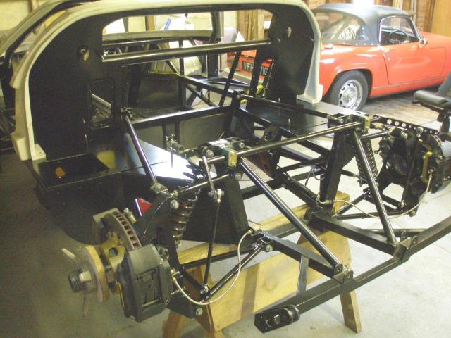

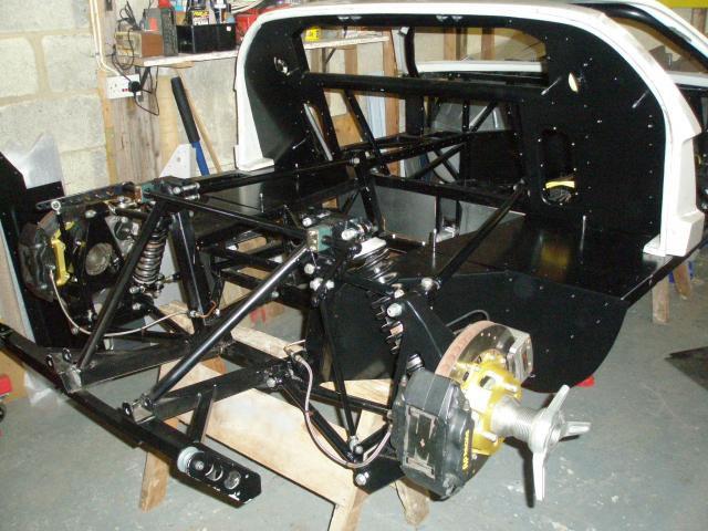

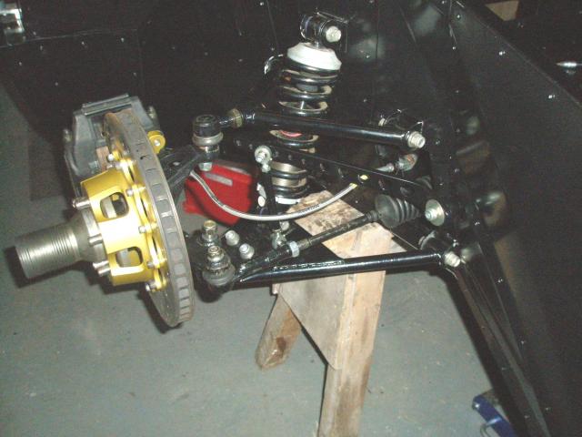

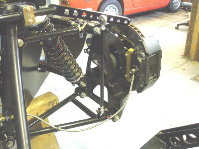

Time for a few more updates. The front & rear suspension has now been built up, which was a very satisfying process. It still needs the alignment setting, however it’s good enough to enable the handbrake cables to be mocked up so they can be designed & ordered. Also wheel offsets have also been established and wheels finally ordered.
Now that the suspension is on, it actually feels like I’m making some progress. Might even have a rolling chassis by the Summer :thumbsup:
Regards
Andy

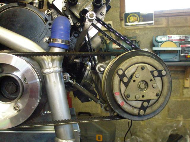

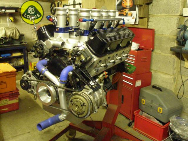

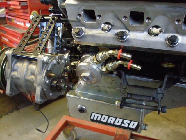

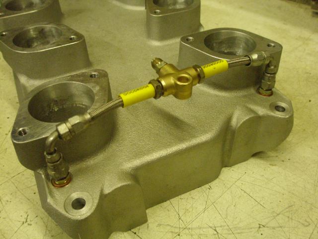

The engine has also now been finally assembled. Steam vents into the cylinder head coolant jacket have been added to the inlet manifold using some old aeroquip brake pipe bits I had lying around. The AC compressor installation has also now been finished. Mounted off the cylinder head, it is then braced back to the fuel pump, with the final belt tension set with a couple of M8 rose-joints and a link rod between the pump & front cover. The reason for the remote oil filter is to clear the fittings on the back of the compressor.
Regards
Andy
