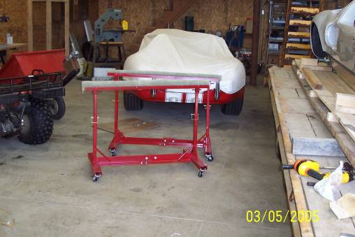

O.K. so its not a photo of the car. I'm building a windscreen closet to protect them (I've got two boys ages 4 and 6) from breakage, and I've been wanting to get the chassis stands finished before unlaoding the car from the trailer. Closet's half done, and stands are now ready. They turned out better than I thought they would, so I thought I'd share the results with a shot of them. Next time you see them, the chasis will be on them.

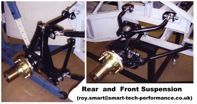

As well as continuing to supply the proven GTD Chassis - Roy also manufactures all suspension/upright parts, from standard, to improved fully adjustable items. (not wishing to hijack thread - just passing detail) /ubbthreads/images/graemlins/cool.gif

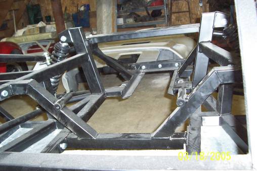

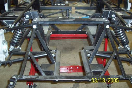

I need to get a few friends over to help set the car up on the new stands. Is there a specific angle you'd like the photo's taken from. What about dimensions, I can get you those too, but need to know exactly what you're looking for. Oh yea, I'm sorry to say you U.K. guys will get dimensions in the dreaded imperial system instead of the metric system. Hey, didn't the U.K. create the imperial system anyway. What the H*ll happened there anyway. I'll try and get some pics this weekend or by middle of next week. Just let me know if you'd like those dimensions. (I'll try and find a metric tape measure)

That's just about it. I can see that the MDA has allowed a lot more room under the rear of the gearbox (R21) and it apears to have raised the pickup point for the single top link on rear. This to reduce bump camber change. The front looks like what I have already drawn and is in front of me as I write this. The rod ends will not only allow good adjustment of camber but also allow for plenty of caster adjustment. Both of these are at the center of the GTD front suspension problems.
Nice job Mark!! Just what the old girl needed!
Hi guys
In my humble opinion I would expect to see a strong chassis member between the inner lower suspension pivot points, under the horse collar (Bellhousing) this area of the chassis takes a lot of strain.
Chris.…
Chris.…

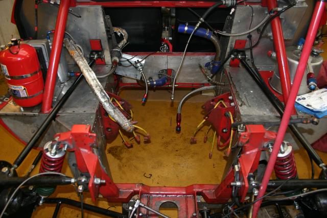

Robert,
do you have a similar picture of this area for your chassis ?
I can understand you may not wish to post it here incase this turns into a mud-slinging match, but it would be interesting from a potential purchasers point of view to see just how similar (or not) the chassis are in this area.
John.
I believe you can see it on Dan Weilacher's RF - check
the Builder's Forum - Roaring Forties #091.
Here's a direct link - you can barely make out the welded in crossmember.
