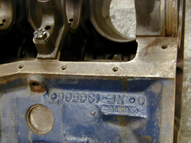

I checked on one of the GT40 blocks that we ventilated last year at the Wine Country Historics. It was an original GT40 race block. The observations that I made are that the main web looks to be standard thickness so I am not sure of the structural differences in the blocks. Most of the modifications can be done yourself to replicate the look of an original. Most of the stuff is standard hotrod stuff but some is interesting. Here are the differenced I noted.
Casting # XE-136505
only other casting # 6L10 near the casting number

All of the five XE blocks that I have seen have 6 L 10.
This apparently is a pattern number used at Dearnborn.
Please see my thread on Original Parts.
