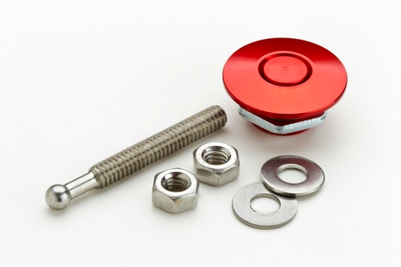

For the front of the nose I bought some Quik-Latch Minis
Installed:
