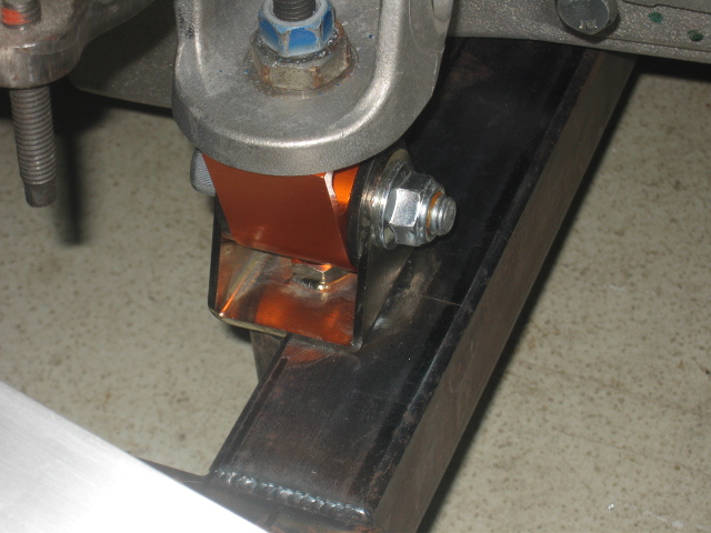

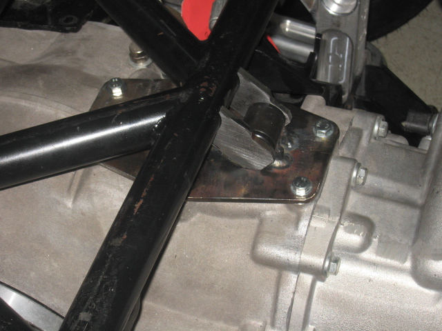

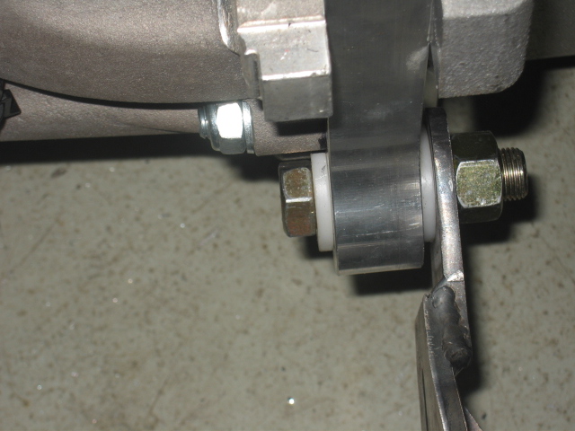

The three things I was holding out for; crossover tube, smooth/quite as possible and center lock wheels. So far 2 out of 3. Crossover in progress (no pics yet) and I just need to finish rear mount bracket of Ricardo. How much this will smooths out the vibrations is unknown. I'll keep you guys updated.

Nice work. Are those pfadt engine mounts? I have a brand new set sitting in a box somewhere. I guess you cut off the square aluminum platforms and mounted these in their place to maintain the stock engine height/angle. I'd like to see how you route the crossover tube with the Ricardo.

I did cut out the alum cross member and replaced it with the RCR supplied moveable steel one. Although I did move motor forward a bit, the PFADT poly mounts are virtually the same height as the alum uprights. Engine height/angle remains the same.
