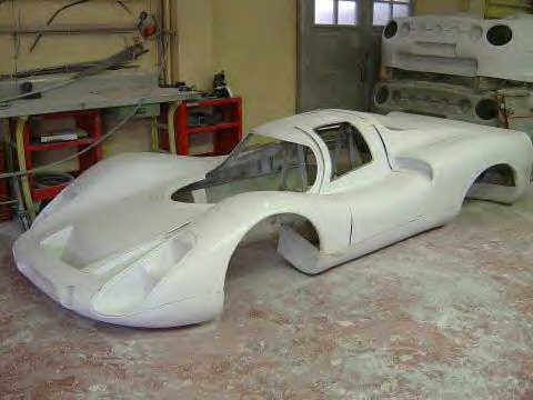

as some of you will remember from last year I got hold of a Porsche 908 body, well things are still progressing with this project and here are pic's of the chassis.

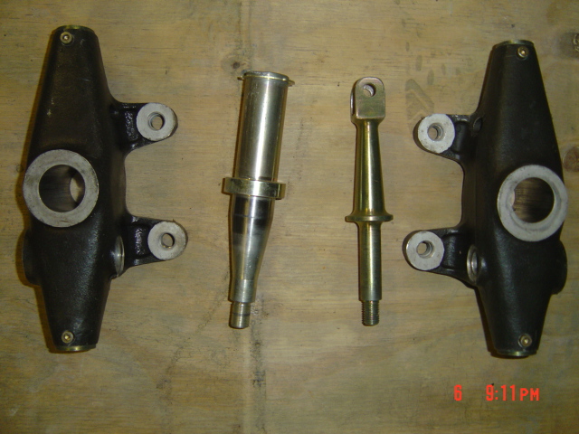

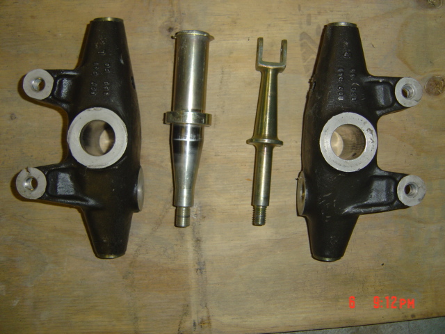

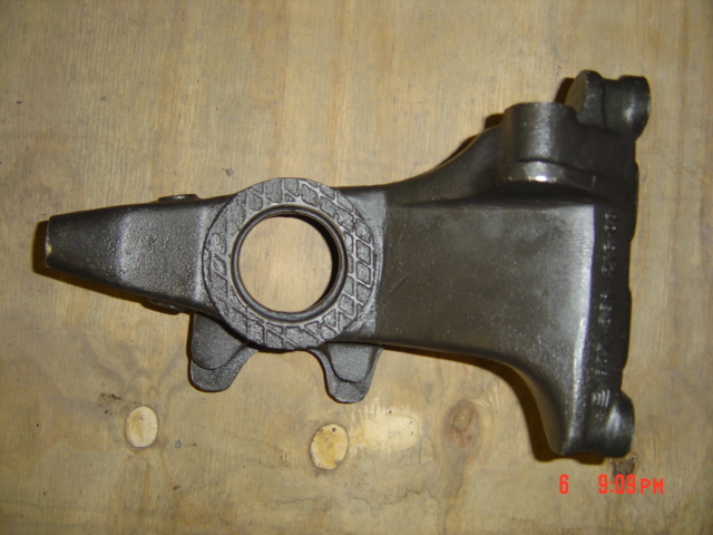

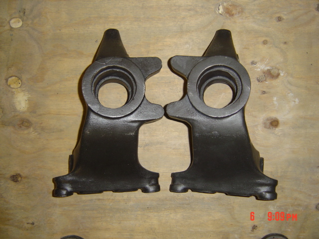

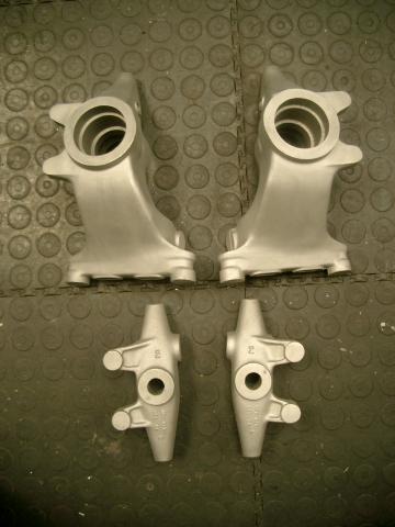

front and rear original 908 mag uprights.

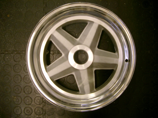

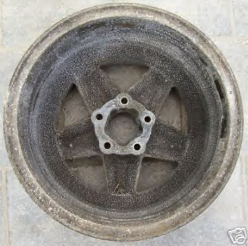

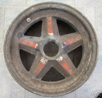

Wheel centres for 908 or 917 will be machined for 15" split rims. I purchased an original 917 wheel from ebay to use as a pattern.

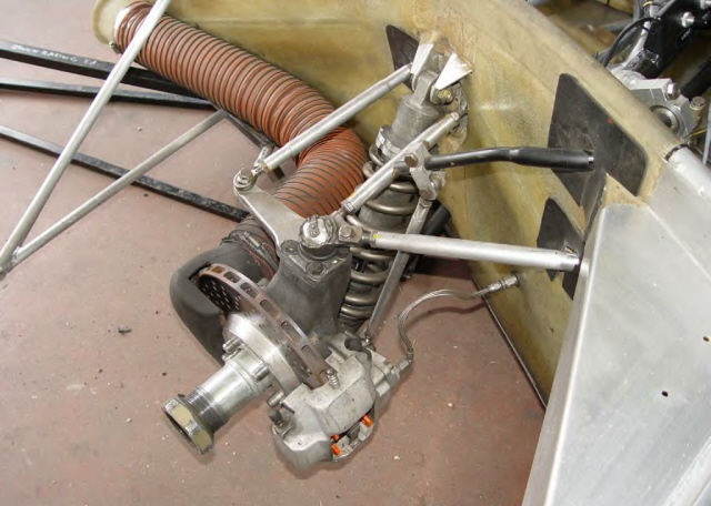

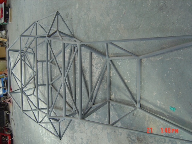

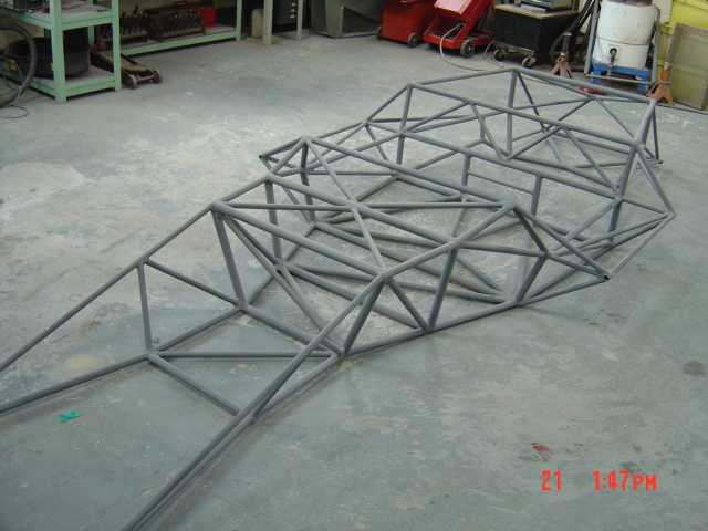

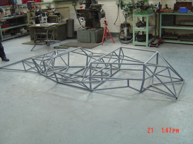

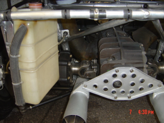

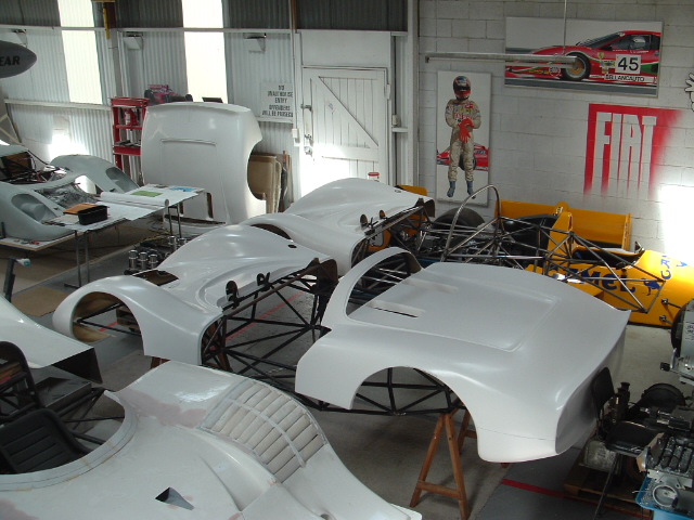

The first pic (rear suspension) the tube work running vertical is that the chassis as it looks like alloy going by the welds.
I was under the assumption it was a steel space frame.
Or am I looking at something not chassis.
Jim
Hi Jim
The first three pictures in grey is our prototype 910 chassis made in steel from original drawings. The photos of the rear suspension is of an original alloy chassis from I believe a 908/3.
We are going with steel for street and track use with 1.5mm wall thickness for extra strength, the original frame on the 910 was only 0.75mm wall thickness.
We hope to make the 910 and 908 available as a turnkey minus ready to take a 911 engine and trans.

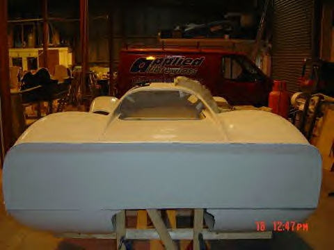

I am making a replica 908 we made the chassis from original drawings and have body moulds to make original pattern bodies. I am getting the uprights patterned also ready to make new ones. The car will be fitted with Porsche 911 flat six and G15 trans.

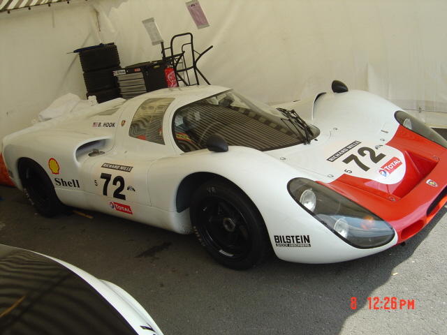

PS.The photo taken of the Hook 908 car was at Le Mans classic this year.

Do you have any idea about the white 908 in photo
and the car of B.HOOK? is -it the same car ?
any idea about the chassis's number ?
