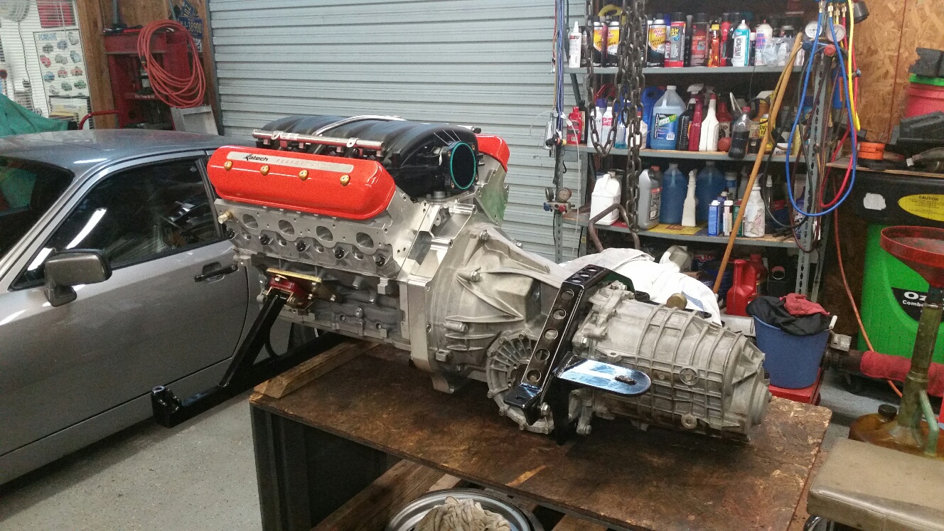

Gents:
Relative to the G86-20 (Boxster S 6-speed)...the mount being referred to in the rear is not for the transaxle - it is for the exhaust. The trans mount location is mid-trans. JFYI.
I have been running one behind a 600 hp LS7 for nearly 3-years on track - holding up very well...beyond expectations really!
Also, the prices have creeped-up over the years - low mileage units from reputable shops are now between 2-4 which is nothing compared with other options (for comparable performance and strength) so it is still a great deal.
A couple of the downsides is they never came with an LSD from Porsche so my Guard unit cost 3300 installed - beyond the trans acquisition. They also have pressed gears making rebuilds very expensive - most owners are better off just replacing the entire unit. Rebuilds will cost 4-5 alone.
One other bit of info...the 5-speeds are trash (weak R&P); the six-speeds are an Audi unit that was developed for a diesel. Therefore, the reason it has proven to be so robust...it was designed for torque.
I hope this clears some of the mis-information up a bit - cheers!
PS: I have attached a picture of the OEM Mount location with our fabbed mount for our installation. The box is shorter than the a G50 (JFYI)...
Tony
