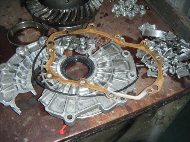

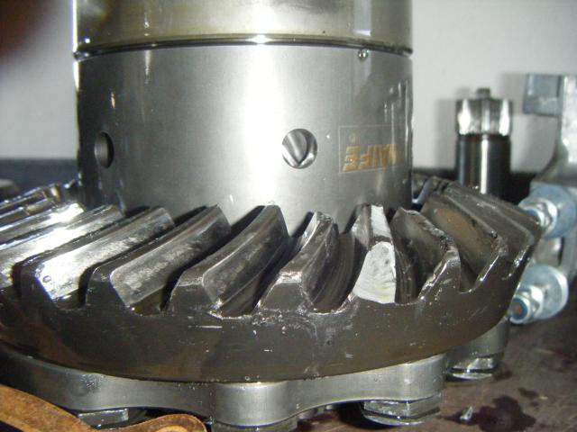

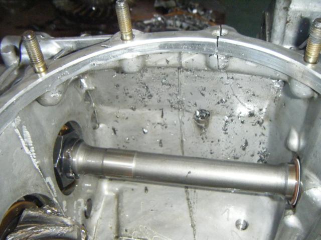

As I am on my G50.50 Turbo, plus a billet side plate and here's why (I believe these were posted before):
Ouch! Ive heard about strengthening the side plate. What do you estimate your power to be around? Could you tell me more about driving conditions, car weight and tire size and type when it broke? The porsche transaxle expert ive talked to recommend billet shift forks and steel synchros as well. Oil coolers also seem to be the way to go. Thanks for your input!
Bill,
Fortunately, those pictures are not from my G50 but only serve as an example of what might happen. I believe that tranny was "handling" 600+ HP. Yes, an oil cooler is a great idea. A few running Porsche transaxles have cryo-treated the gear-sets. But I'll defer to the Porsche experts on what's necessary or not.

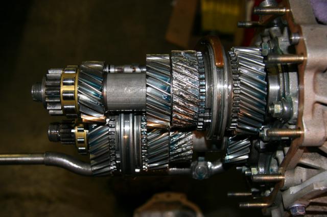

Is it just me or did those gears in the 930 failure pics look very blue? As in too much heat?? I think that was 3rd gear that went.
Yeah my bad. That is 3rd.
Initially I thought the blue was heat but when I looked closer it looked like remnants of blue oil. Swepco 201 maybe?
Hi
It is hard to tell from the picture but it looks like the broken sideplate was a "small side plate".
Porsche has manufactured two different OEM sideplates.
The weaker one is about 13mm high (thick). One can see on the picture that it is thicker in the center and than runs down and gets thinner.
The stronger sideplate is about 21 mm thick and has a stronger webing. They where used on the G50/5x but also on some others ( my G50/05 has had one as well).
According to two gearbox specialist they are as good as billet ones and maintain the OEM look.
Attached a pic of the stronger side plate. It is clearly to see that it doesn´t gets thinner from the center towards the outer circumfence ( compared to the broken one above)
