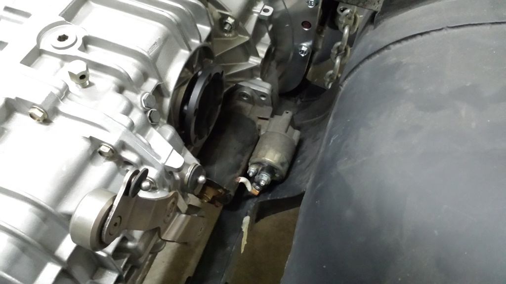

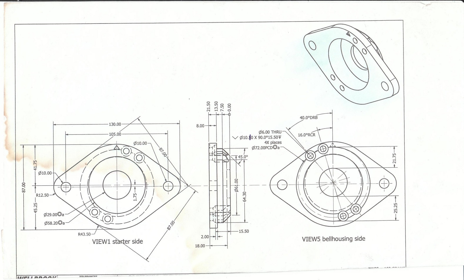

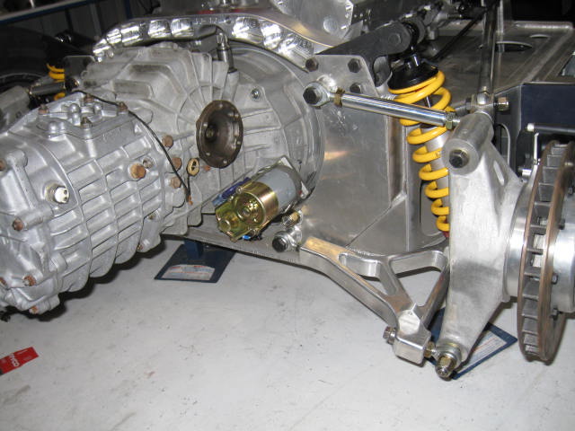

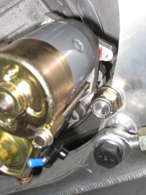

If you take a look at my build site you can see the route that I took. It was a lot of screwing around, but clockable starters were not available at the time.
flatchat(Chris)
RCR T70 similar chassis
Unfortunately -"Titus" the god of spend thrift doesn't apply here :)

I'll happily spend the money for a better starter, but I've read that some have been unhappy with the aftermarket starters and prefer the Bosch unit. What say you flatchat? Is the starter you show in the photos a better starter than the Bosch unit?

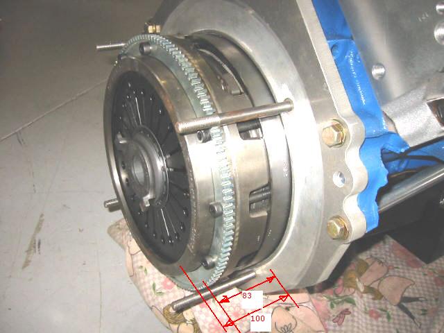

flatchat(Chris)
Flywheel, clutch, ringear --this is the system that we use which works for us --anything else , you're on your own

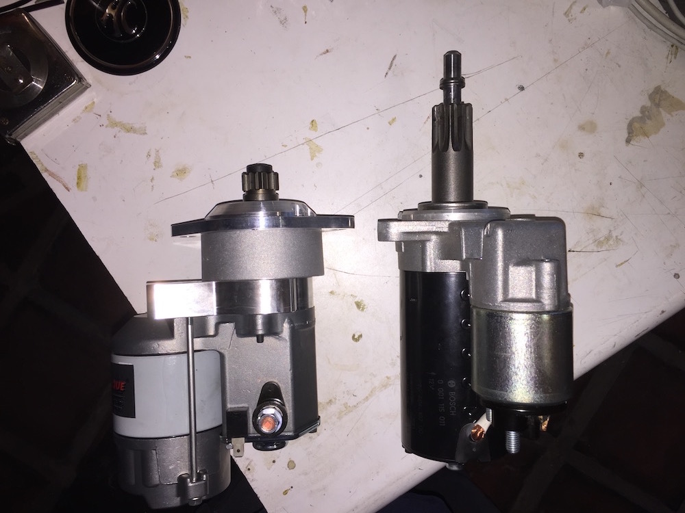

Flatchat,
I see...your setup puts the flywheel deeper in the housing than the stock Porsche position. That allows you to use the 101NL type starter...$300. My flywheel sits in the stock Porsche position so I need a longer pinion shaft. Here's a side by side of the 2 starters. IMG_2347 (1).jpg

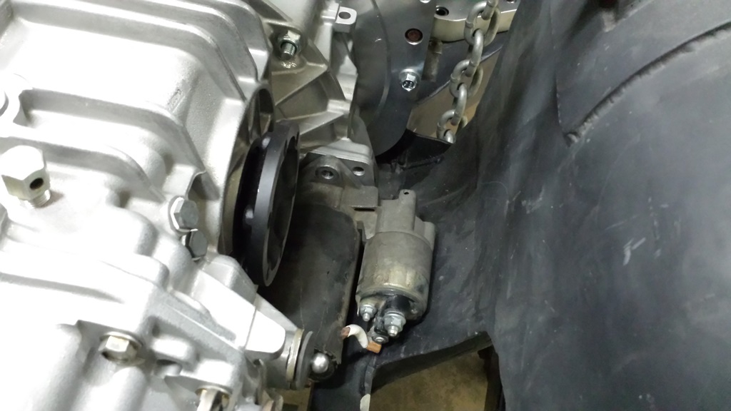

I wish I had better pics, I had the same issue with my LS7/G96.50 swap in my pantera.
The starter solenoid was literally in the frame with the stock clocking, and redrilling wasn't an option for me due to clearances. I lopped off a the starter mount ears, and built a slip on housing which would hold the starter into the stock bellhousing bolt location (solenoid mounted down/under the box), and prevents the starter from rotating on operation. In the pics you can just see the top mount tab peeking out from under the shifter arms on the box. Came out pretty clean looking.
Haven't tried it out yet since I was missing a fly wheel when I was doing this work, if this fails I'll go the $$ route and buy a clockable starter.
