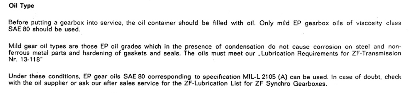

ZF Manual recommends initial change after 3000 miles, then subsequent changes every 12,000 miles. Initial fill 2.7 qts, subsequent fills 2.5 qts.
Brian Stewart
These are scans from the Dash-0 manual (first picture) and Dash-2 manual .

So at the risk of sounding like a moron... it's just plain old 90wt gear oil? No friction additive? Are these not limited slip axles?
Brian Stewart
Yes, they are limited slip. I've bought an SAE 90 formulated for use in LSDs for mine.
The reason for the recomendation of non or low EP rating lubricants is that the transaxle by design has to use the same lube in both R&P and transmission sections, While the high EP rating might be desirable in the R&P it will have an adverse affect on the synchro cones etc and affect shift quality. Same goes for clutch type LSD units which sometimes require the friction modifiers mentioned.
