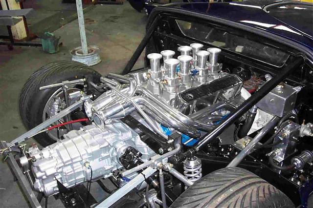

I did my trailing arms / a-arms / uprights / rear body struts with a silver ceramic coating (eg JetHot, etc).
It is way more durable than powder-coating, & will polish up nicely with any good metal polish paste - looks like polished alloy. If you try real hard, you can scratch it, but you can hit it with a hammer & it will not chip.
Maybe worth a thought ?
Kind Regards,
Peter D.

Still can't get over those rear steamrollers - I love it! That's a lot of work Bill but it's going to be worth the effort when the car is re-assembled and painted. Looking forward to seeing the progress as you go - wish I was that far along! ;)
