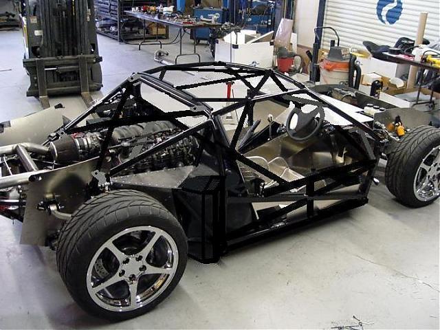

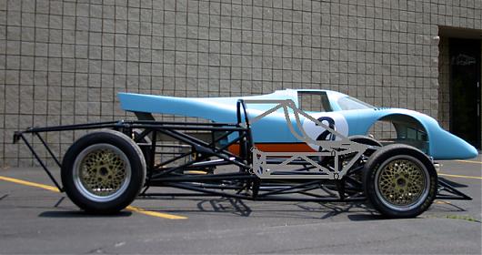

Thanks for the input guys. I have read the rules and for every car I'm interested in, those include all of Frans cars and the GTM, the first thing I do is design a roll cage based on those rules and all other safety considerations. The reason I like those classes is you can have your cake (917) and race it too.

I think I attached two photos or files. We'll see!
