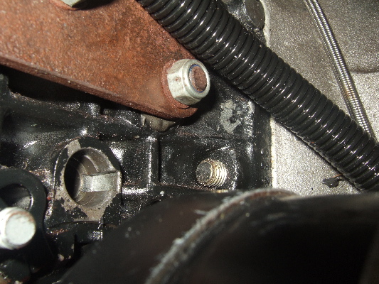

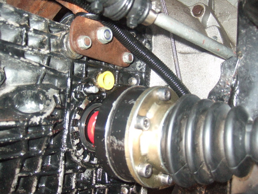

I'm still losing oil from the gearbox - sort of limits my desire to drive as I reckon it could dry our pretty quickly!
Problem is after a drive there is oil all over the outside of the case - and I cannot decide from where it came!
But there is this yellow plastic plug on the box - right hand side and above the drive shaft line - took the press fit plug out and it was covered in oil so or could be the source.
Can anyone confirm what this is for and what should be in the hole?
First pic general position and second a detailed pic without the bung (but you could probably have figured that put yourself!
thanks

Ian,
This is a WAG, but 1) I don't think the yellow plastic plug was made to be there, and 2) I am going to guess, based on its position, that the orifice accepts a speed sensor that triggers off of the crown gear.
I am sure someone who knows these boxes will tell you for sure, but that's my best guess. Confidence is high on 1).

Ian,
It could be that I suppose, but judging by the way the boss is cast with the case and the way the slot on the side looks as though it might accept a snap in type 'something or other' is what led me to believe it was for something a little more common. That was the reasoning anyway behind my SWAG.

Iain, it isn't the mechanical speedo takeoff, the mechanical speedo takeoff is the larger hole angled downwards, to the left of your upper picture. I dont know what the hole is, but it doesnt appear to be plugged in mine, and it doesnt't leak. Have you looked in the Gearbox Manual .pdf?

Ian.
the hole is for the speedo senser,which was fitted to the renault 25 box
the 21 has a cable drive and has a much larger hole,best bet is to purchase
a senser to plug the hole
best of luck Brian.

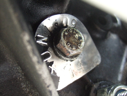

I just went out and took a picture of the tag UN1-09 (on the bottom it also says 14
I cannot find that one anywhere - any ideas anyone.
I'll contact Chris Cole for the sensor to bung the hole
thanks

I just tried with a clean screwdriver and it is definately open into the innards of the box.

pdf in mail. I guess that, putting together what Brian said, the casting is the same for the 21 and 25, but for the 21 they finish machine and break through for the mechanical take off, for the 25, they finish machine and break through for the sensor.
If you don't have either, where is your speedo drive?

My speed sensor is 2 magnets araldited to the CV joint with a pickup on a bracket. So nothing mechanical.
I had a quick look on the PDF and on page 1 pocture 1 for UN1 there is a cable thing that looks like it goes to this area - what is that for - perhaps reverse lock out.
Also nobody has answered - what is a Tyoe 09 UN1 - I seem to remember this was said by somoene to be a works rally spec unit for the Alpine. Could be interesting internals!
At least I think I have now sorted out where the oil comes from - no wonder it goes everywhere - drip out of the hole onto a spinning drive shaft an it will move everywhere

This is the hole for the electrical sensor for the speedo on an 84 on Alpine as all the rest have cable drive or the sender is on the front nearside hub...I can seed you an old sender.. have something made up in ally because it is held in with a special clamp...& will only leak again..also the gearbox oil seals are very prone to wear.

He is also able to send me FOC a pick up sensor that has had wires broken #(I do not need it as a sensor just a bung) along with clamp, new o ring and bracket. Many thanks chris - the car may me more usable in the next day or so. Time for driving fun!
Ian Anderson
Many thanks to those with the knowledge re the speed sensor.
I received the sensor from Chris Cole yesterday (fantastic service - thanks Chris) and fitted it last evening.
Topped up the box and did a 10 mile run.
Parked he up over clean newspaper and this morning no drops!!!!!!!
So either she managed to empty the whole lot on the road (that would be a record) or I would suspect the problem has been cured.
