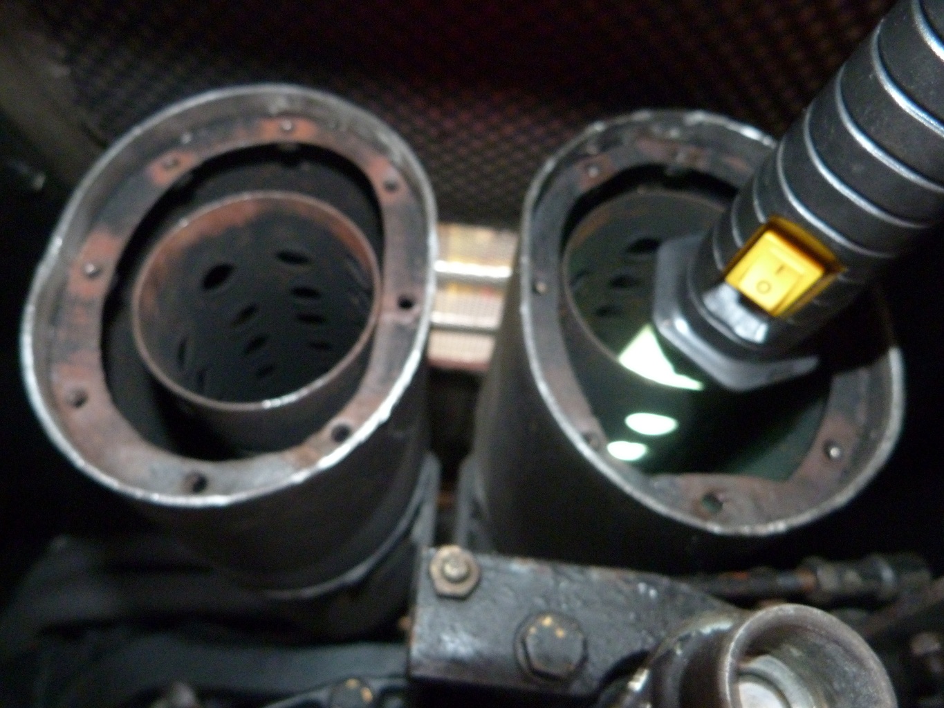

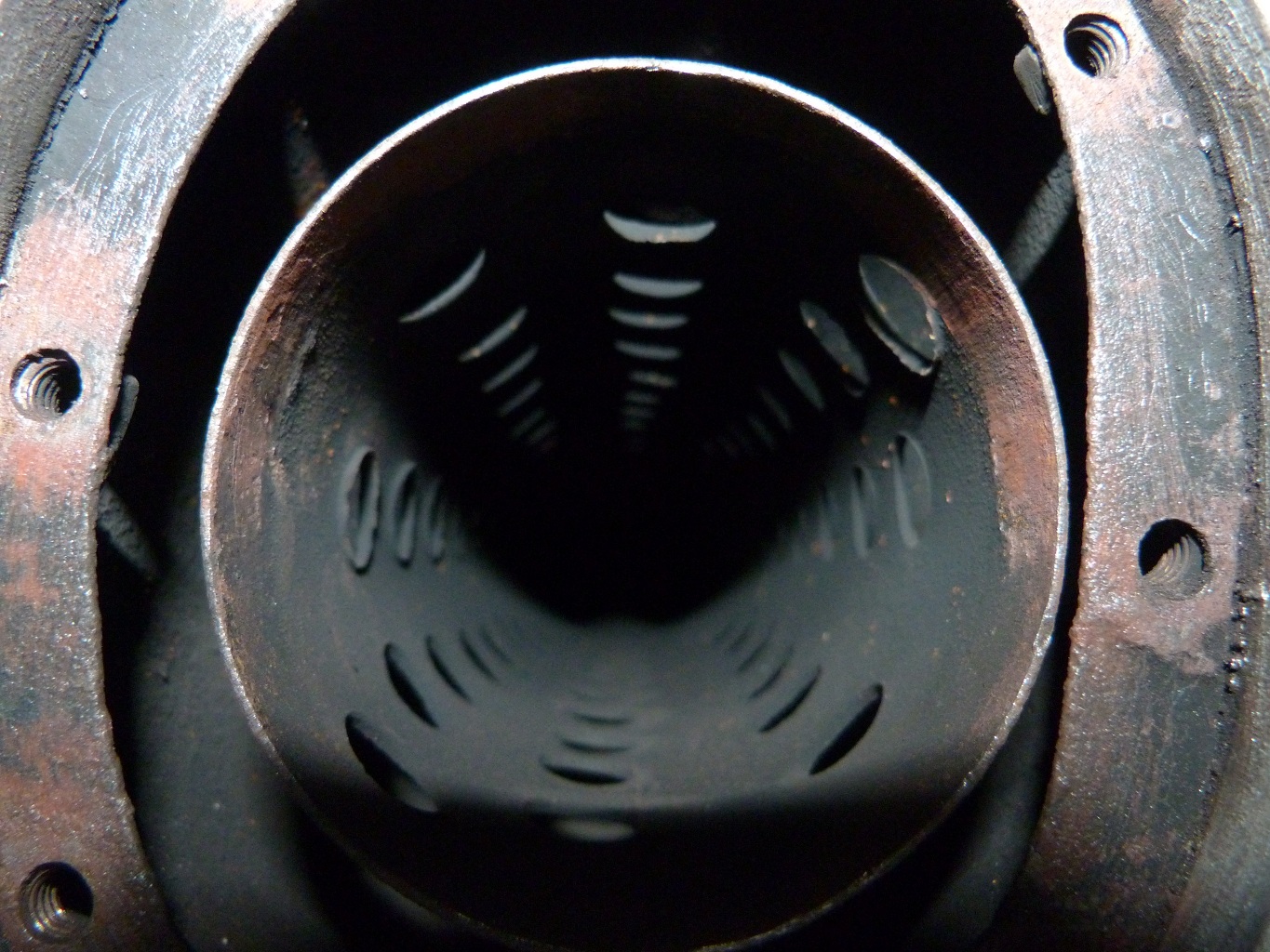

I repacked my GTD silencers with acoustafil 2 years ago. From memory I got a 4 or 5 dba reduction, which put me just below the crucial 105 dba in the standard noise test.
When I took the back off the silencers to put the acoustafil in ALL the original packing had gone (see photos).
I checked the packing last month and the acoustafil is still there and looking fine after a reasonable amount of track driving.
