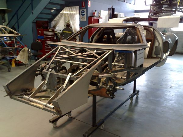

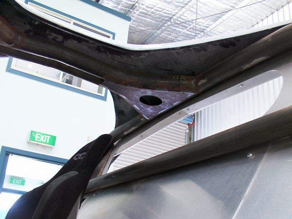

I only have two photos, here it is minus front clip, doors etc.

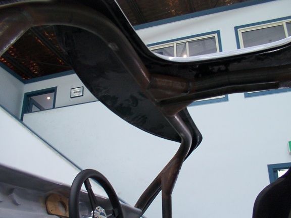

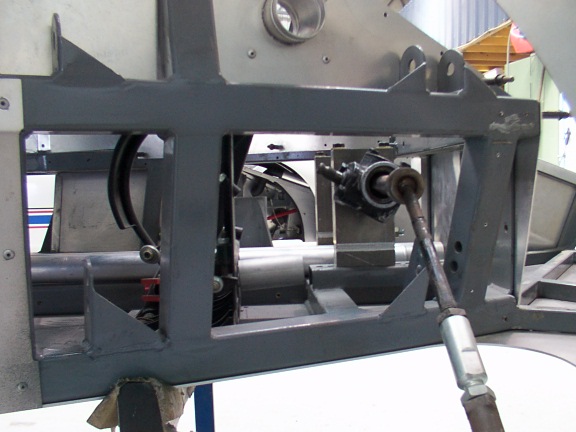

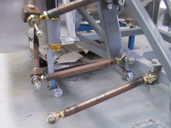

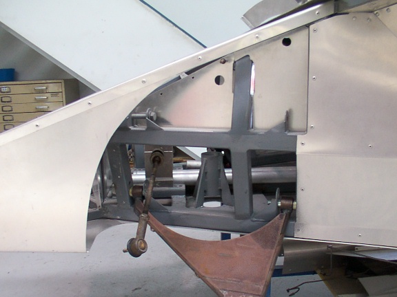

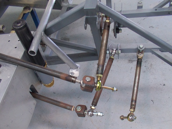

Welcome Troy, I wondered what ever happened to RL's racecar.
Last time I was down that way (few years ago now) I took a few pics of it.
Clayton

re: RF #12 "Race" Chassis
Thanks Clayton,
Excellent, thats the one. Looks more finished then than now!
I look forward to hearing from anyone else who has seen it / taken pics of it at any point. I hope these photos jog some memories.
Troy

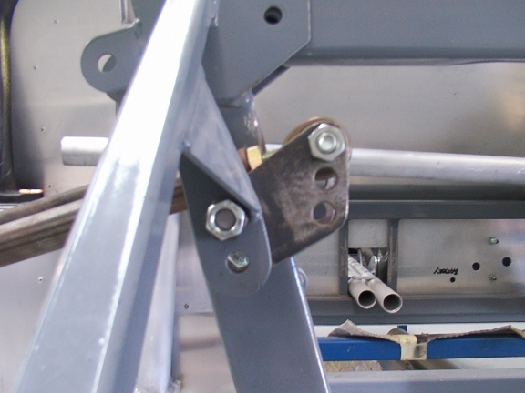

The suspension has been changed in some areas Troy.
Upper arms
Rack hieght
Lateral lower links in rear.
Roll centre adjustment at rear upper link.
Jim

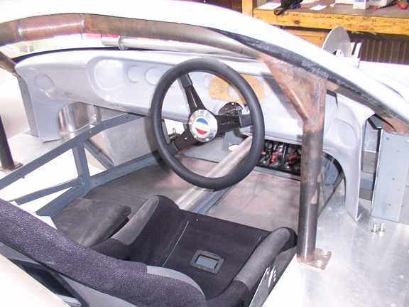

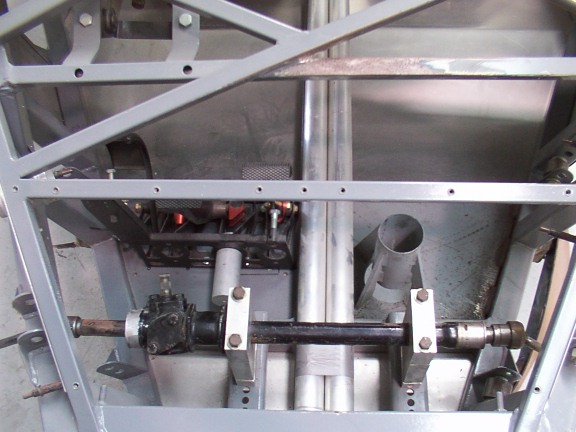

No probs Troy
Whats your plans with it, full time racecar or convert it back to road config ??
Clayton

I was wondering which steer rack is mounted in that chassis?
Phil
Hello Phil
That is a good question and one that deserves careful consideration... To be honest, I don't actually know! I have only just purchased the car and it was already installed. I will check it out and post here.
Where in NJ are you? I just got back from 3 weeks there as my company's HQ is in Mapel Shade. Now that is a long flight. 5 hours to Singapore, then 19 hours non-stop over the north pole into Newark. iPod copped a belting!
Hi Troy and Phil,
The rack is out of a local Mk2 Escort (per UK versions)
The reason for choosing this was the availability of a quick ratio version (2.25 turns lock to lock)
I have some more pics I'll send you as the car sat at old RF during the suspension development.
And guys, thanks for the nice comments about new RF, makes it all worthwhile.
Regards Paul B
Hi Troy,
Regarding the seats, in the RF GT40'
Did they come with the car?
Do you know what make?
How wide are they?
I have a few photos of your future Chassis, if it was the to be race GT40 at RF.
Only problem the photos are high res.
Thanks,
Neil
Hi Niel,
The seats are COBRA brand, however I'm not sure of the particular model. I will have to check it out and let you know. They were part of the deal. As for the pics, would love to see them. My pics are all hi res too, but I just googled "photo resize" and clicked the first result, I think it is www.shrinkpictures.com. They take the pic, copy and then resize it on the website, then save it back onto your PC. Very quick.

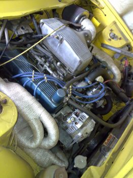

While I wait for my crsate to arrive, I thought I'd re-visit some comments on another thread.
Here is a pic of the TR7 V8 we throw around on the track. Super fun, short wheelbase toy that has been known to get all croosed up and back into the massive haulpac tyres at the entrance to Bag-a-Lego raceway here in Perth. (Will have to find a way to post that video.
