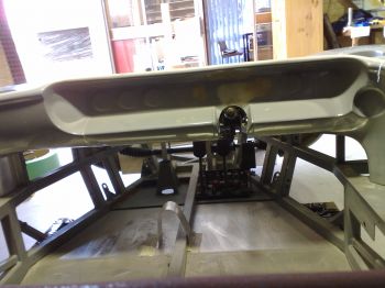

The dash has been modified to accept the Motec dash unit, however I'll shape it back to standard to suit normal dials.

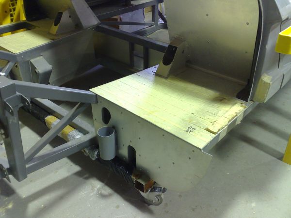

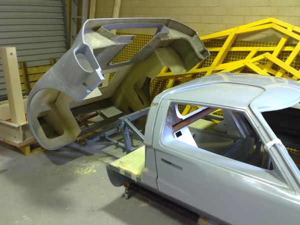

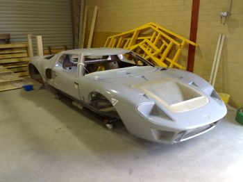

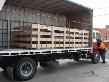

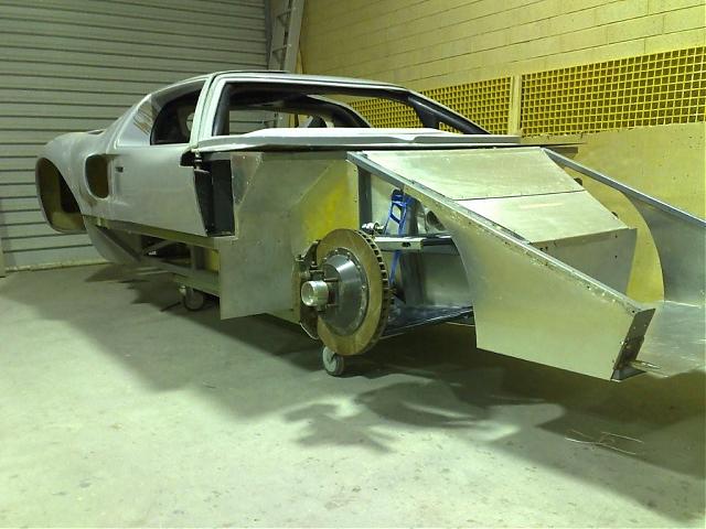

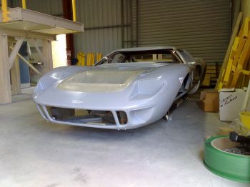

Here are a couple of pics, it only arrived on Monday. First one is in the crate leaving RF factory. others are just a couple of random shots with panels just sat in place, minus the sills, of course...

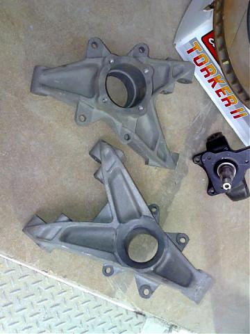

A few more pics...
The brakes
The magnesium rear uprights
A couple more body pics

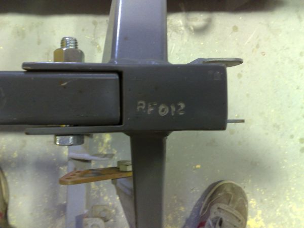

And the Chassis Number (RF012)

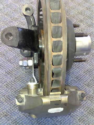

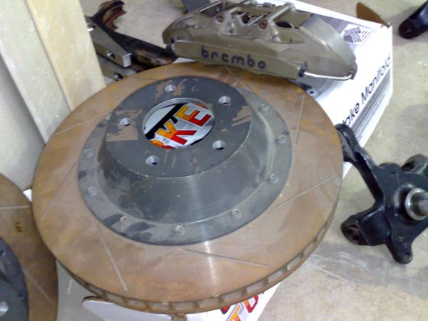

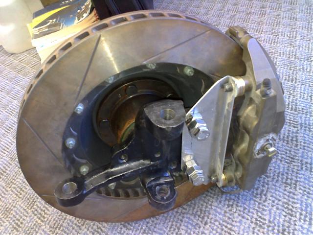

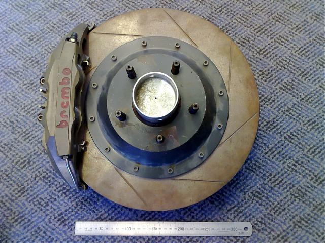

I've started piecing the suspension together, and am thinking about different ways to make the Dogbones to connect the front callipers to the uprights.
At the moment, it is an aluminium plate used as a template.
Is anyone else using Brembo callipers? Or ones which connect at 90 degrees to the upright mount holes?

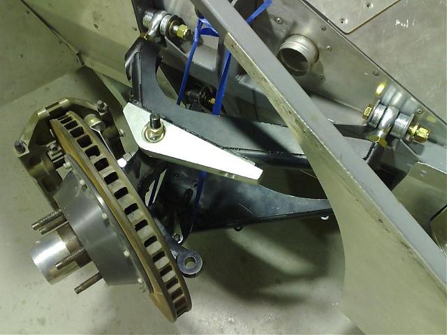

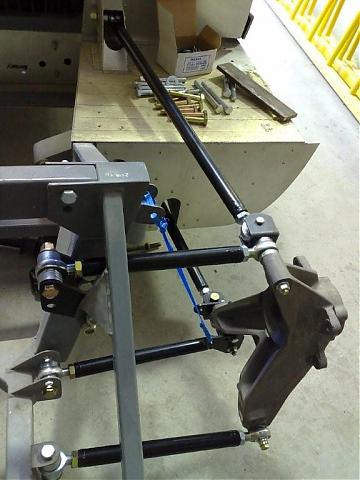

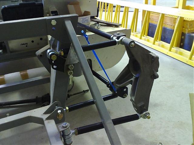

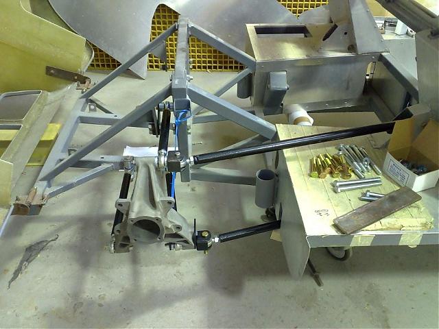

I have finished the aluminium panels now, and now I've started fitting up all the suspension components.
Here are a couple of shots of the rear set up, with the adjustable lower control arms. The rod ends are fairly beefy, although this presented a few issues that have now been overcome.
I have fitted all the parts using washers as spacers. Plan is to machine up these from solid material once I work out some settings and also exactly what goes where!
I'll post some shots of the panel work shortly, as well as the front end set up with brakes fitted.
Cheers.

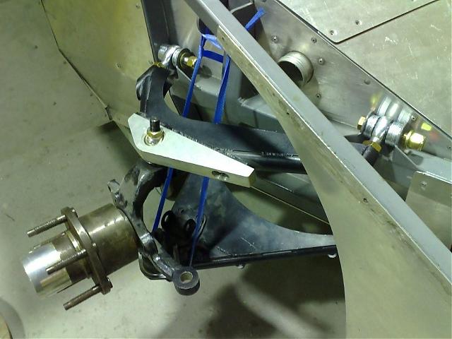

Front set up, still some tweaking to do. Panels around front wheel arch were not so straight forward, chassis having been revised for 18" wheels (not my decision!).

re: RF #12 "Race" Chassis
Looking good Troy,
You are doing a great job of it and moving along nicely time-wise too.
We can make the dogbones for you if you want, a couple of basic dimensions (per your sketch of the upper bearing brkt) and we're away.
The front rotors need to swap sides - had to add that mate !
Regards Paul

Looking good Troy,
Regards Paul
Troy,
I think the callipers are on the wrong side as well.
It looks like they have blue and red labels.
Blue = right = starboard
Red = left = port (all the short words are together)
The Second hand mono-block Brembo race callipers have probably been stressed by being used in a previous rotational direction as well. Just insuring that the calliper bleed nipple is at the top is no guarantee as they can be swapped with the link pipe on the other end.
Regards Ryan
Cheers guys, thanks for the input.
To be completely honest, I just grabbed the first rotor and calliper from my storage shed and bolted them onto the car for the pic.
Ryan, the give away for me that the calliper was correct is the small directional arrow on the outer side of the unit. Otherwise, I love the nautical theme, as I am a marine engineer and a Master Class 5 skipper!
I'll swap the rotors when I have a chance, but for now I'm more excited because I have just purchased the engine. More on that later...
