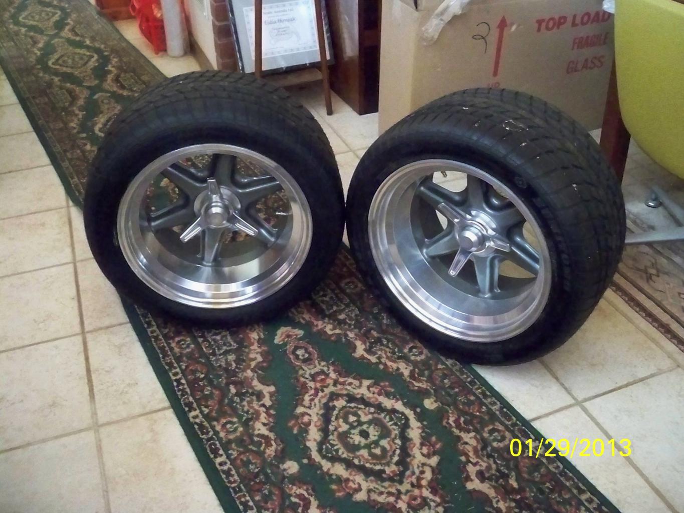

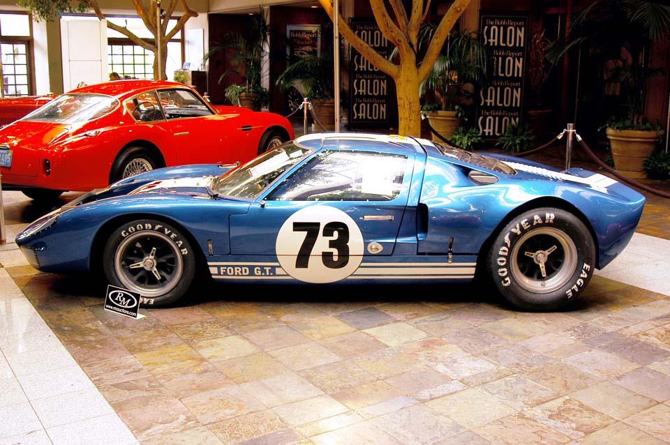

Check this picture below. I love the look of the baggy tyre walls.
I am sure the wheels are the wine glass style in 16inch diameter.
I am hoping someone has fitted similar to an RF style kit and also
I am hoping some one can give me a link to buy similar looking tyres and wheels.

Looks 15" to me, but could be wrong.
Not a good selection of 16" rubber out there. The widest I've found in 16's were 255/50/16, not the best look on 9.5" rims.

Those tyres in pics are goodyear blue streaks.
Race only and a cross ply.

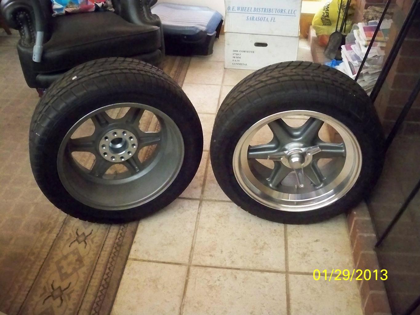

Jim can I ask your wheel widths and offsets? Your wheels seem to fit perfectly.

These team 3 wheels should do the job except with a satin black centre in 15inch. I want to go away from knock ons and back to wheels studs.

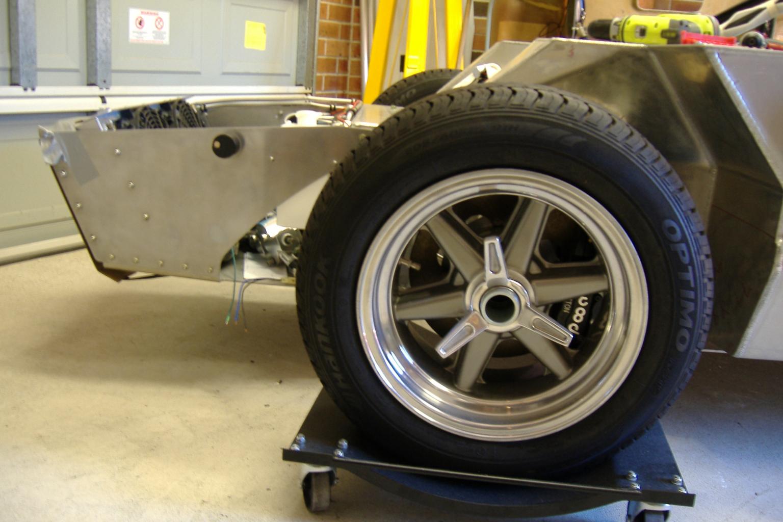

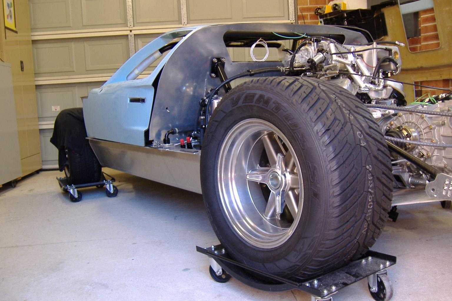

Hi folks,
Here are photos of the 295 / 50 / 15 Hankooks (108V) I'm using on the rear of my RCR and 205 / 60 / 15 on the front.
Smaller brakes - yeah, but I go for the original "baggy" look.
Maybe not a very dignified way to make my long overdue debut here, but there we go.
Regards, Glenn.

Welcome Glenn, looks good, baggy is good.

Looks like image wheels are the go. I was thinking I would get a side profile laser cut in the back space I want to see how it clears before I order. With satin black centres
