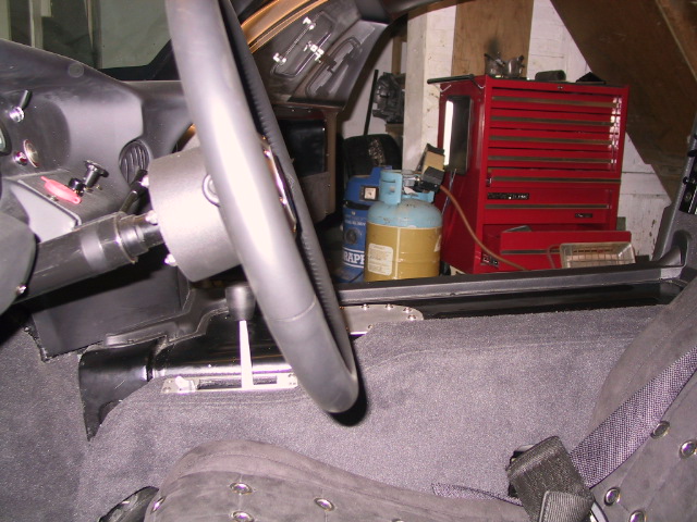

As you know, I have been trying to post pictures in the past without success, so am trying again in super low resolution this time. For those of you who enquired, this is the shifter system we have installed to the two SPFs ( Mark 1 and Mark2) seen in the major shows in the UK, based on accurate reproduction parts of the original cars. Frank

Frank...Looks great....You must be using two "passenger" seats /narrow drivers seat to allow room for shift and rod? How bout some pics of rod as passes though firewall and at the ZF. Steve

I'll echo the others: Fantastic job! What you've done is exactly what I'd like to do for my SPF Mk I. Not knowing the mechanics involved, is a similar installation possible for a LHD center console shifter?
Kim
More importantly, to me, will the shifter mounted next to the sill on a RHD SPF GT40 offer significantly better function due to a more favorable geometry to the ZF transaxle?
I know Frank's operation probably doesn't get many requests for center-console shifter installations for RHD sports-racers, but is there anybody out there with experience on this with the SPF GT40's? Or any mid-engine sports-racer with the same general layout?

Nice job Frank, looking at the pics there seems to be a very short throw of the lever for the gears or is the angle of the phots.? How did you manage to do that?
Murray, all of the parts used are exact copies of the original gt40 parts, therefore the change gate is exactly the same, useing the ZF gearbox. This of course is fitted to the SPF mono chassis, again a precise replica of the original, so all of the clearances etc work just as in the 60s, and nobody complained then ! The change set up we have just installed works faultlessly, , Frank

I suspect the "straight shot" from the sill mount to the engine compartment will be the simplest, most straight-forward and trouble-free. Of course, not every SPF wrencher is going to have the wherewithal to exactly copy the original gt40's shift linkage.
Does anybody know what support or provision Hi-Tech Auto is providing SPF and its wrenchers for the shift-linkage installation?
