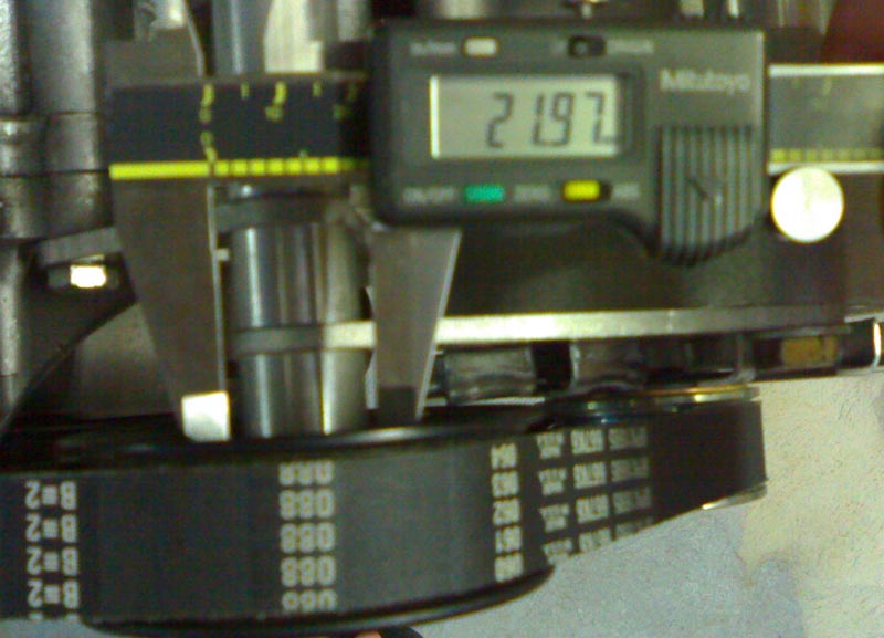

Since you have just done the front dress on the engine perhaps you could answer a question for me. What bearing do the idler pullys ride on? I can't seem to find anyting that fits in the bags of parts for the idlers.

Hi Peter
The 2 idlers came with a whole bunch of nuts, bolts, brackets, a belt and 2 aluminium bearings for the idlers. The bearings were a very simple push in type, slightly different in length. I'll take some detailed shots and post for you
Bill Hara
Old Hand
Peter
I checked the bearing and the boss that it rides on. The bearing is made by NTN Japan, part no: 6203LH
The boss is 21.97 millimeters in diameter. The drivers side idler on a LHD car has a slightly longer boss, which extends out the back of the idler by exactly 20 mm. The other one extends 12 mm.
I've attached a photo - the measurement is accurate.:D
Hope this helps

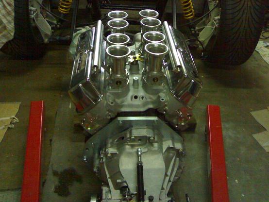

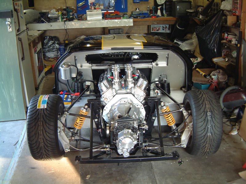

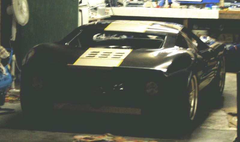

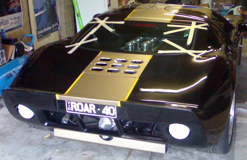

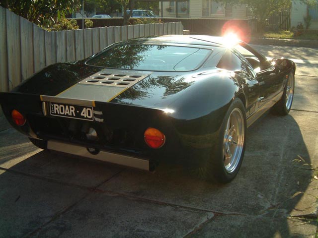

Well, the engine install took longer than I anticipated - I knew it would...
Thought I'd post a few shots to show its new heart....:D

Nooooice!! Looking good Bill. I bet you are getting itchy for a drive now. Had a drive of mine today: the lenght of my garage! Got all the gears, a/c working, temps nice. Looking good for launch sooon. Race ya!

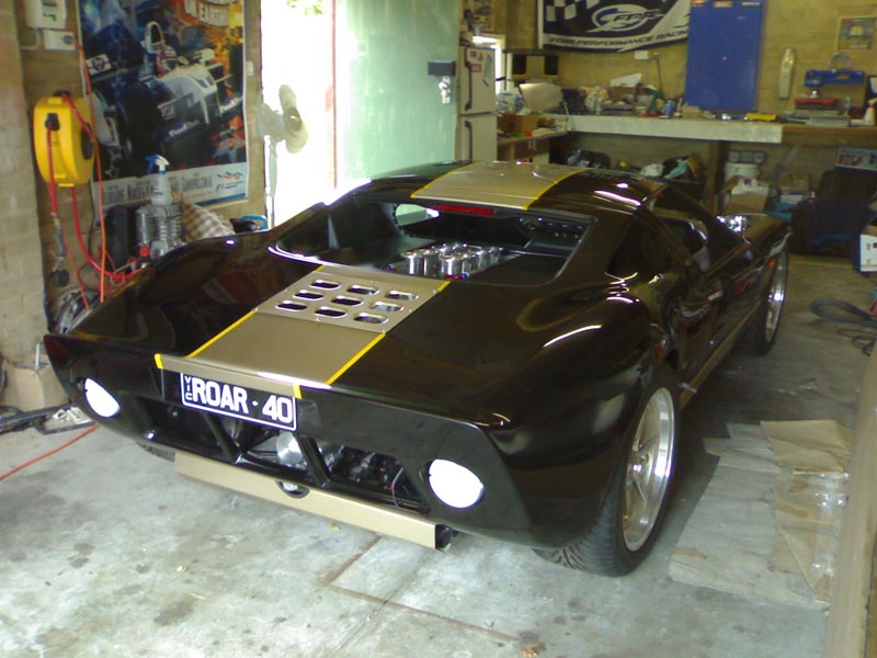

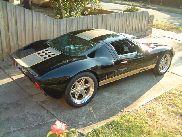

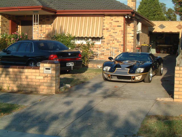

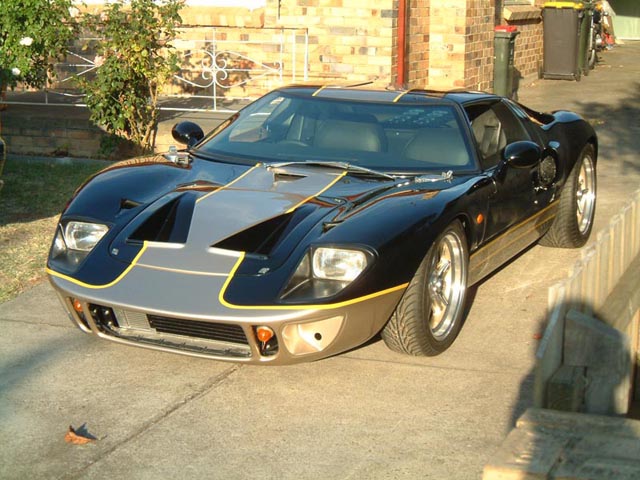

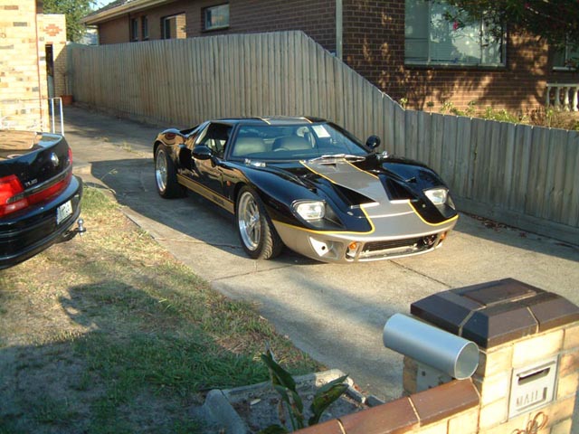

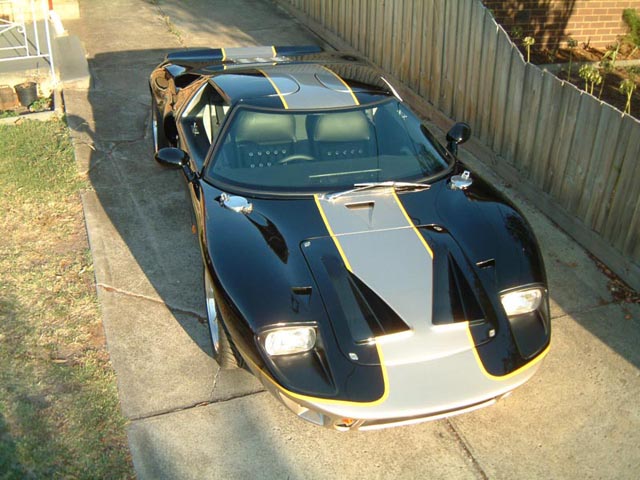

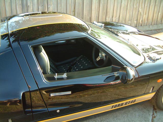

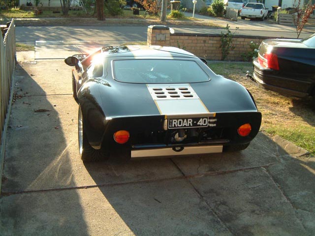

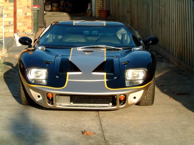

Well the car moves under it's own power now and I am on the verge of putting it on the street for testing.
It was perfect conditions to take some happy snaps, so whilst the car is not yet fully complete, this is what it looks like:

Peter Delaney
Bill - "How sweet it is" !!!!
Congrats on a top-notch build - it looks superb.
Do the plates (how cool) mean that you have rego ? If so, why do the pics show a GT40 in your driveway instead of just 2 wide black stripes ? :D
Way to go !!
