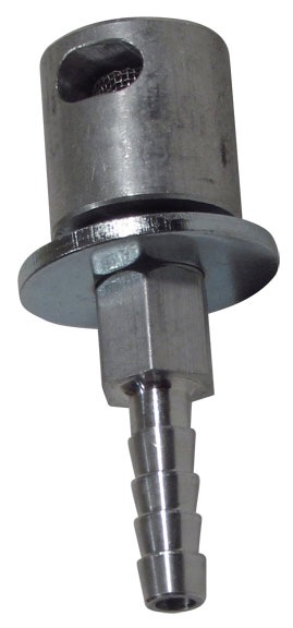

I chose this rollover vent from TANKS INC.
Remote Mount Rollover Vent Valve
This will mount on the cowl just under the front clip not far from the fuel fillers on each side..
