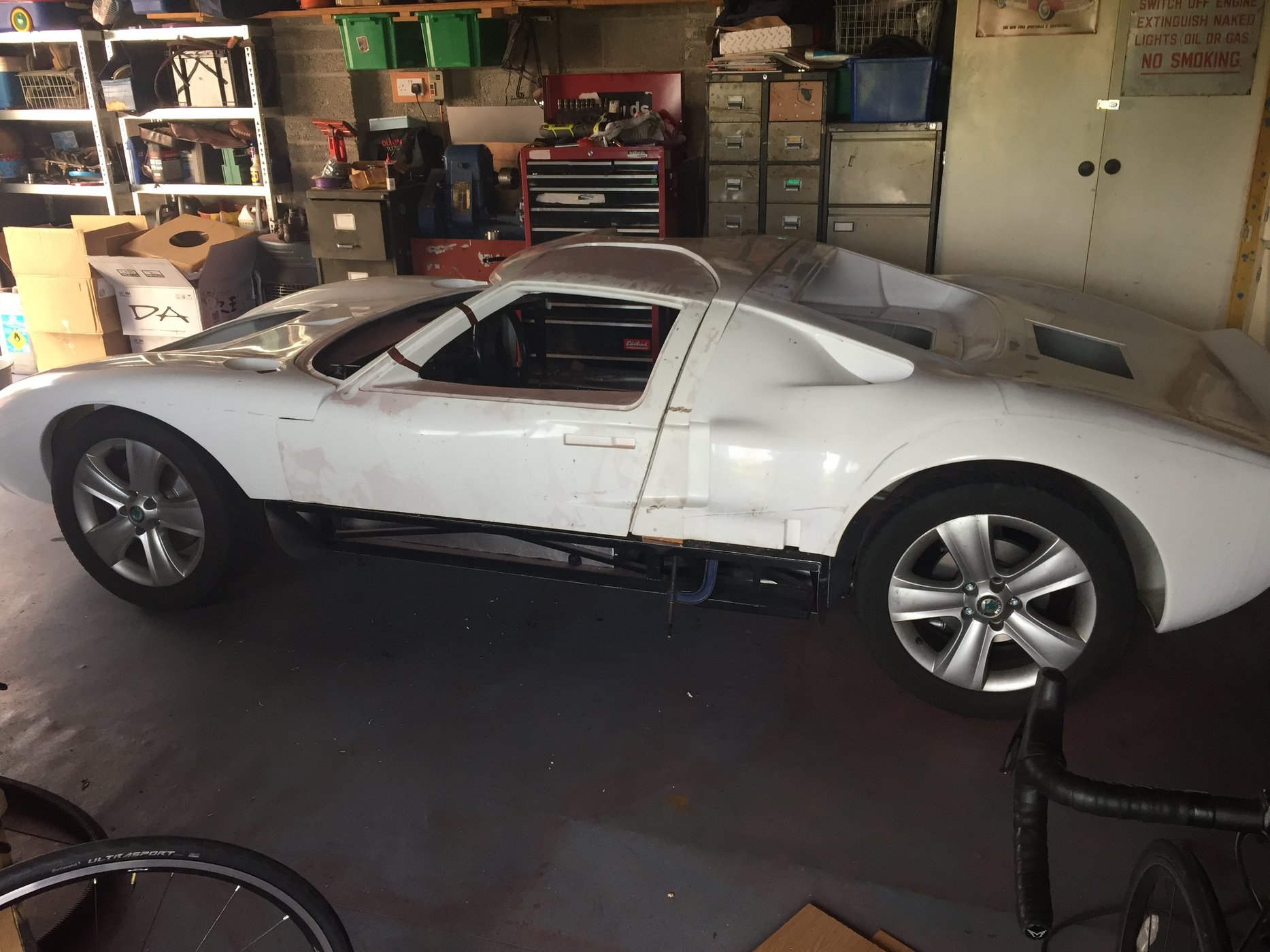

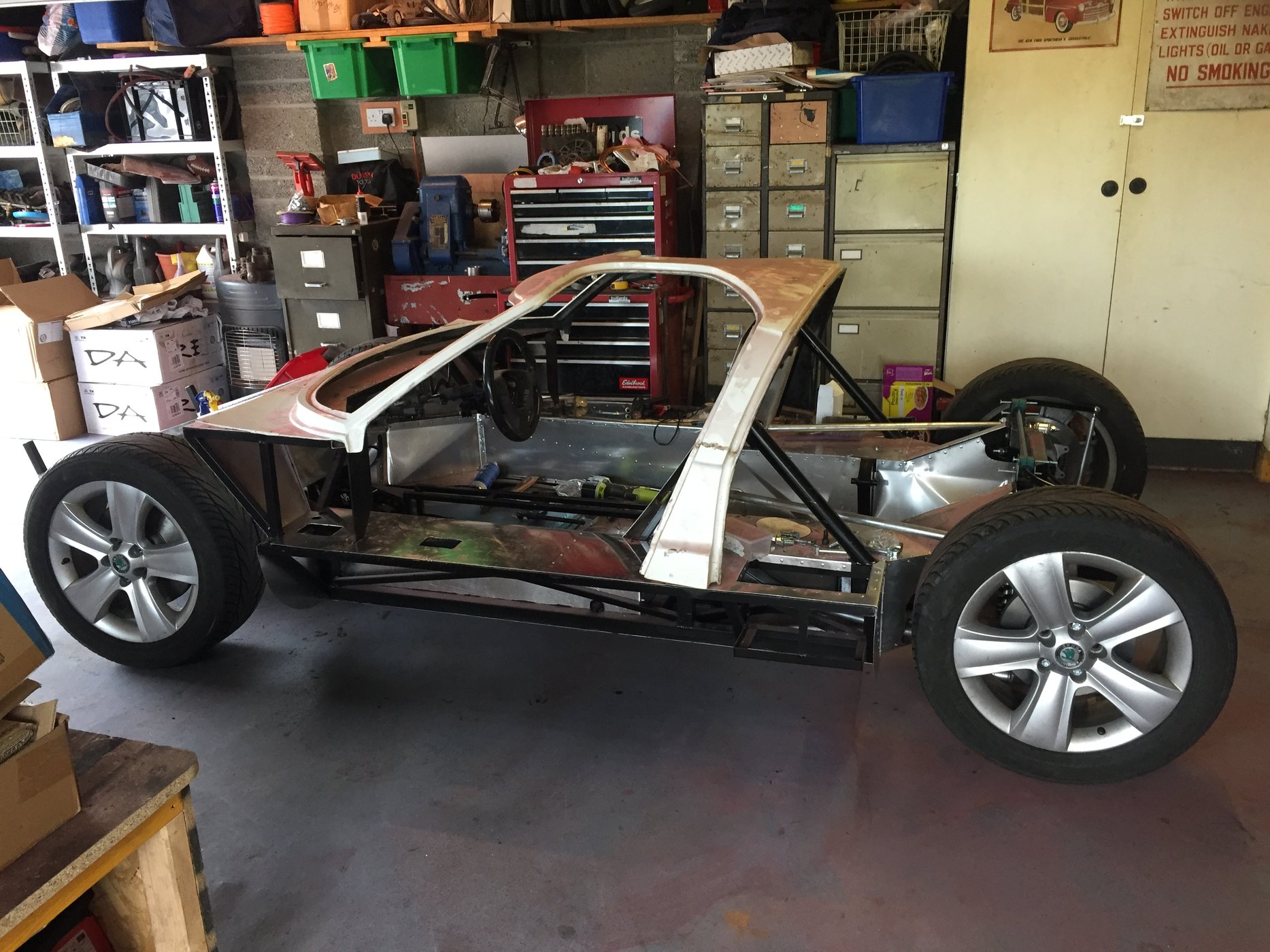

Though I had better do an update

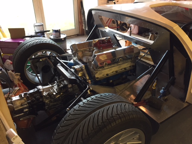

This is from July 2017 and I got the chassis rolling and trying the body work on.

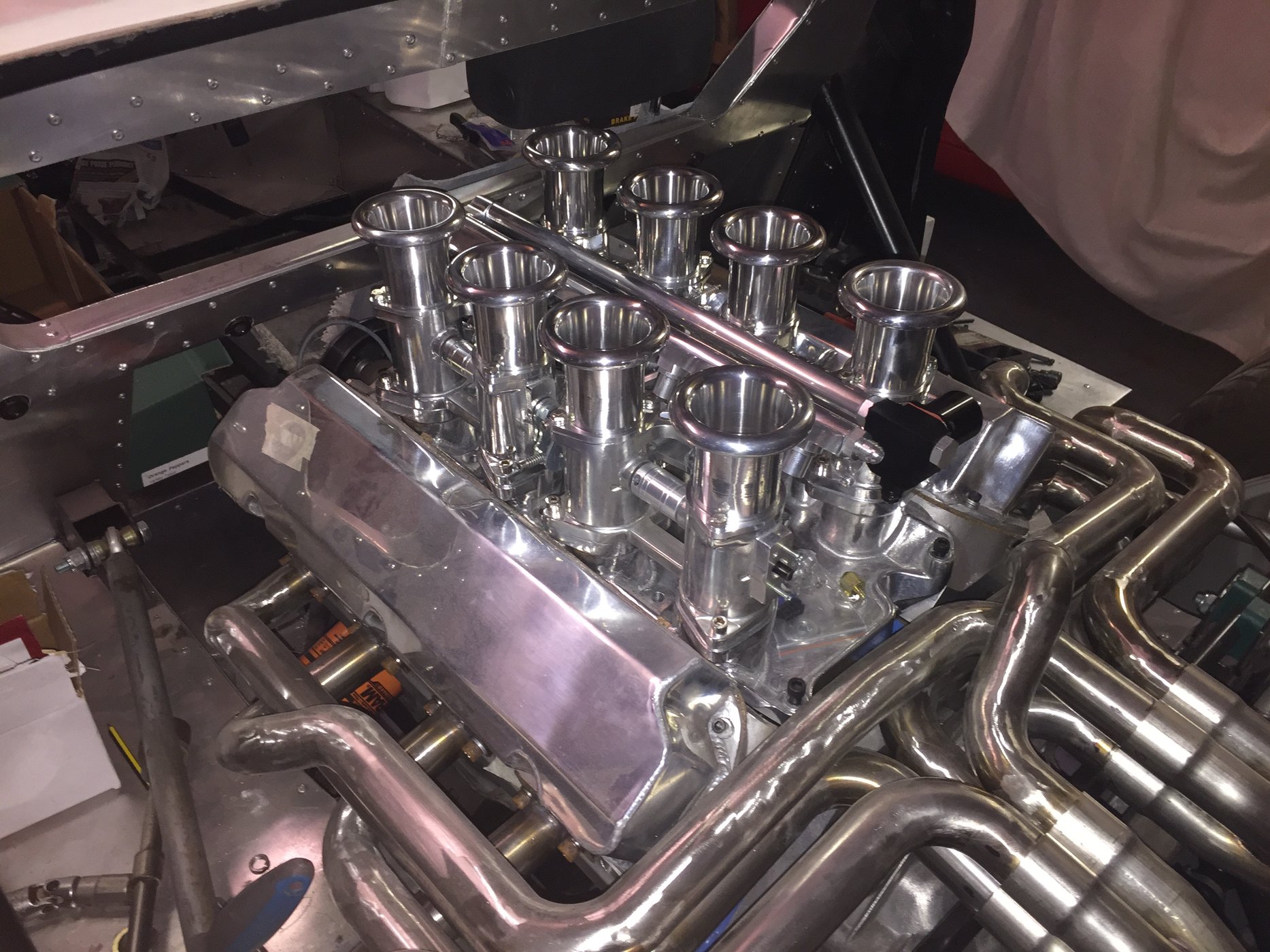

I am very pleases with the Xmas present of the 8 stack throttle bodies I also received the dash board just before Xmas so will be concentrating on getting that positioned to allow for final position of steering wheel. and then the gear shifterThrottle bodies on engine.JPGNew cam sensor.jpg

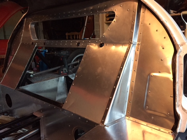

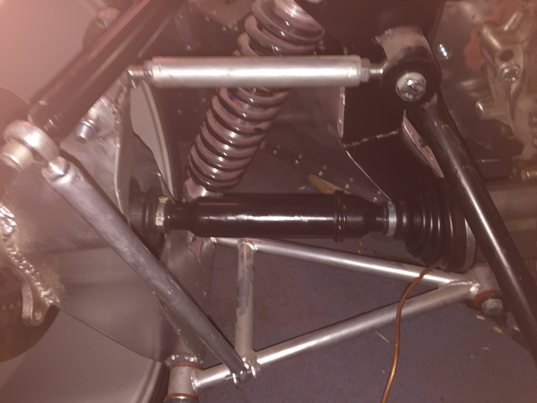

Got a delivery on Monday the suspension parts arrived. So have been busy painting these and mocking up the parts to check the fit also the steering rack and the steering column are fitted also peddle box position has been determined. The front and rear uprights never came so will have to chase these up so i can confirm all is good with the moving parts. The Anti roll bar fixings I am not sure of the final positions for the drop links so will leave these until I get the uprights. I will continue with the panelling again now.

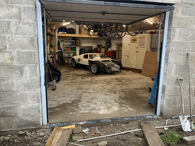

Hi sorry for the delay in reply but busy with house extension at the moment when not working so car is taking a back seat for a while but on the up side the car has a new home as knoking the old garage down for the extension.

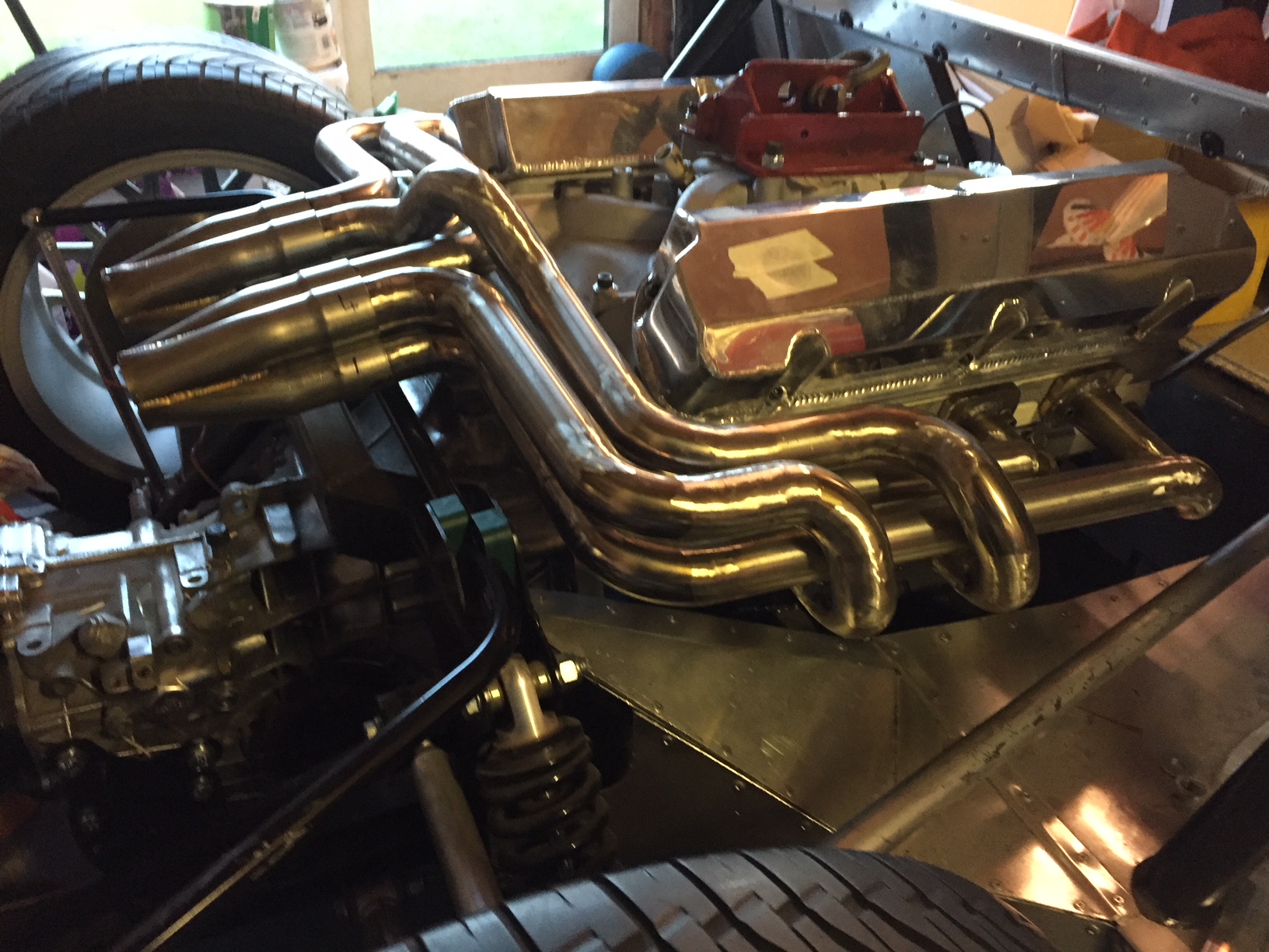

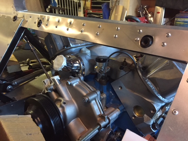

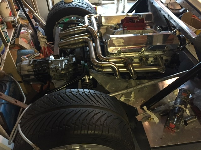

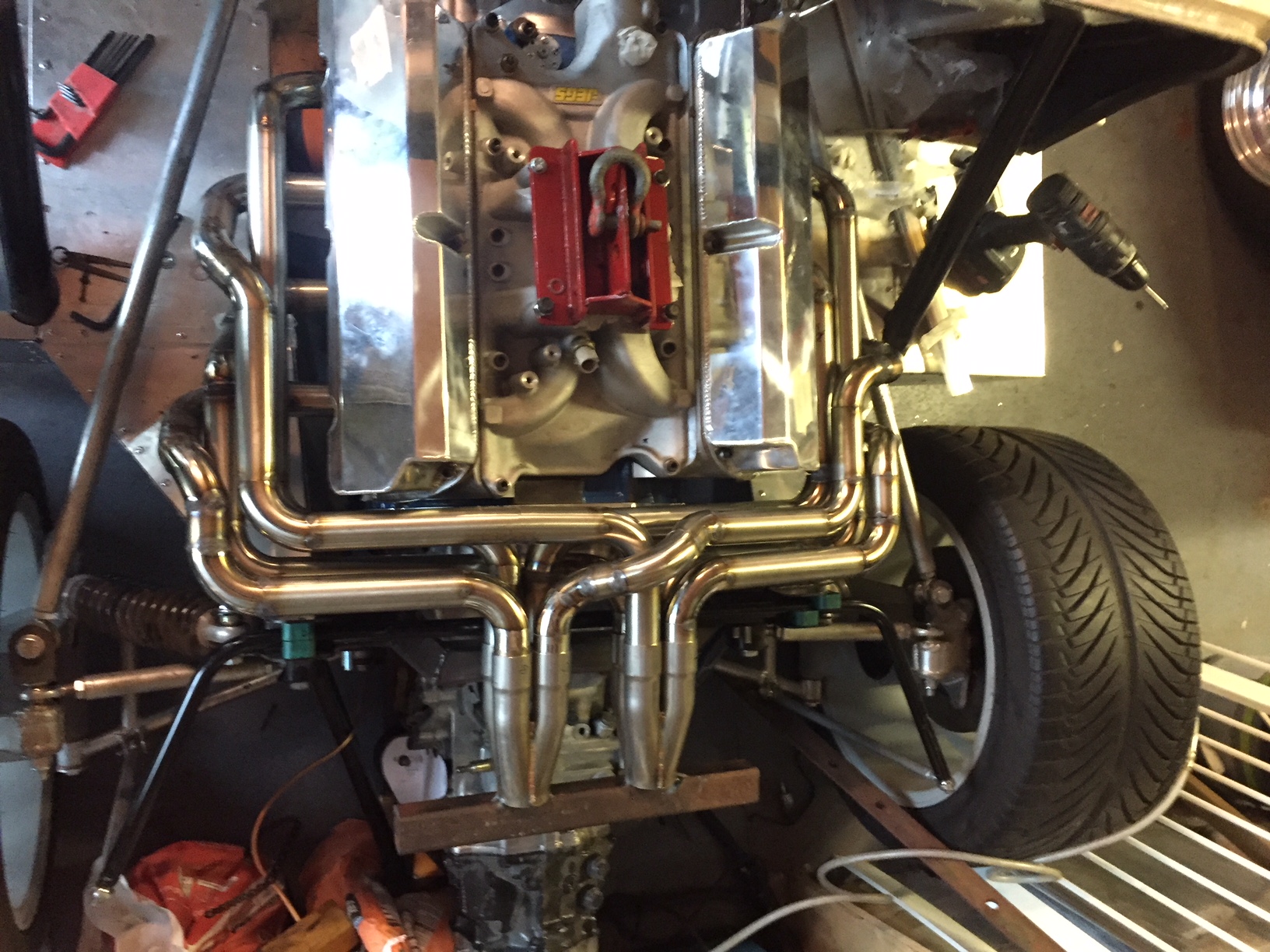

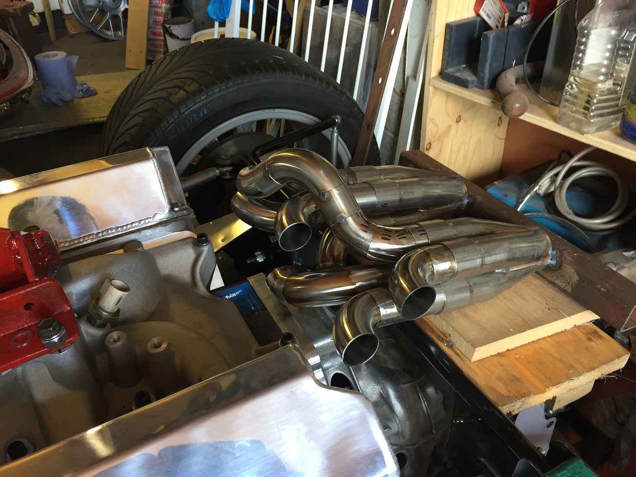

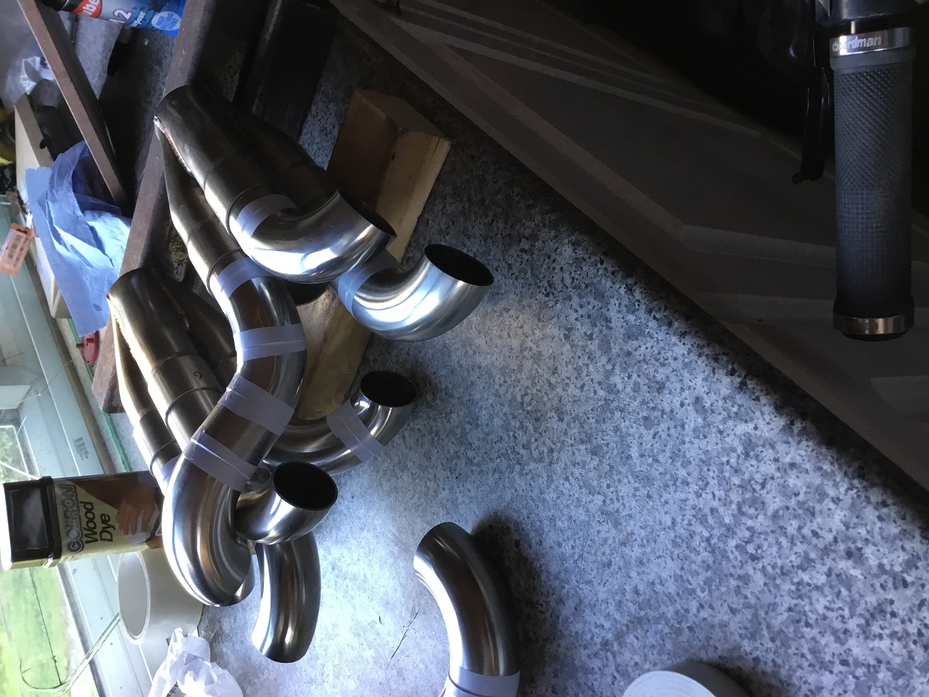

The headers I made myself from 316 tube and bends.

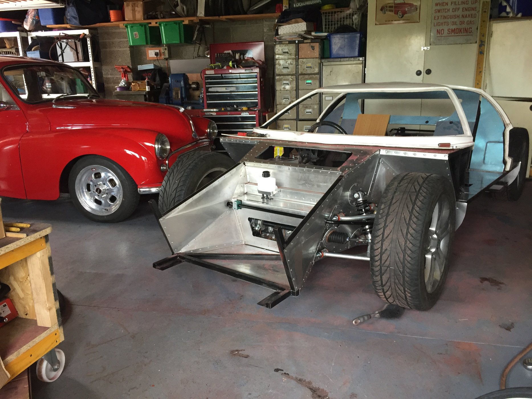

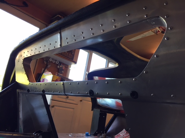

As for painting the panel I haven’t given this a lot of thought as was originally thinking of leaving bare Aluminum but if this is a bad idea l would probably have to go for an etch primer and painted Finnish but think I would end up with an Aluminum silver colour if I did.

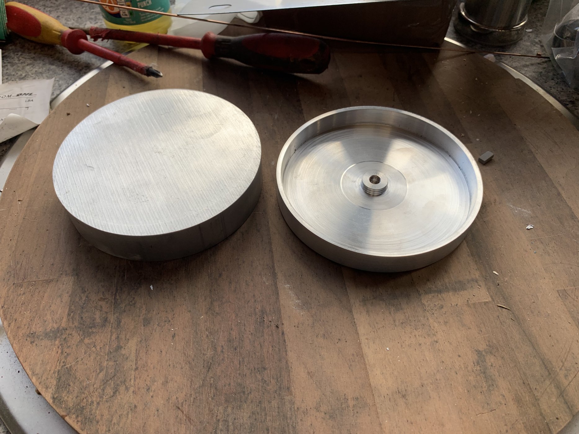

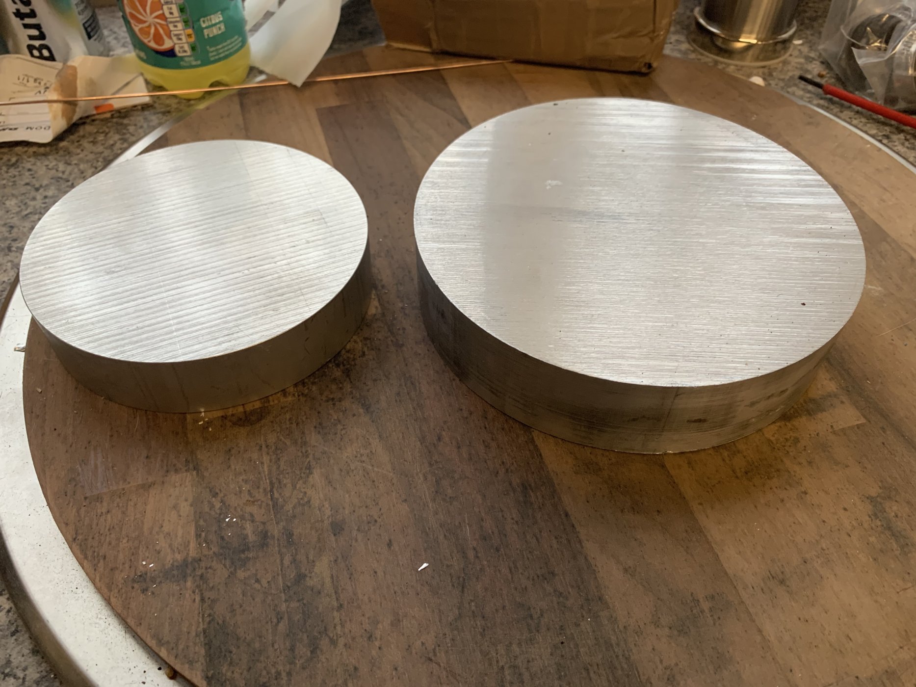

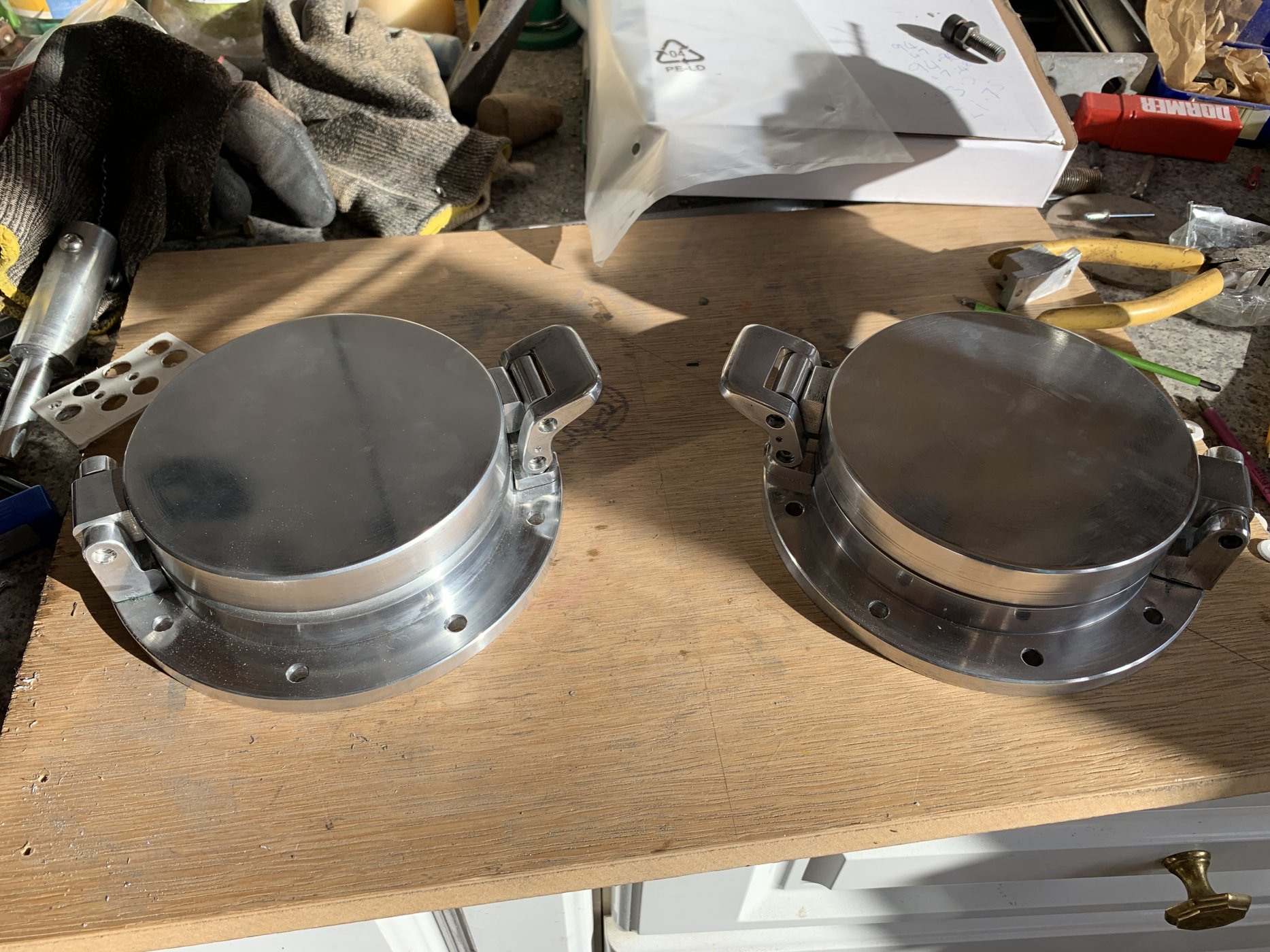

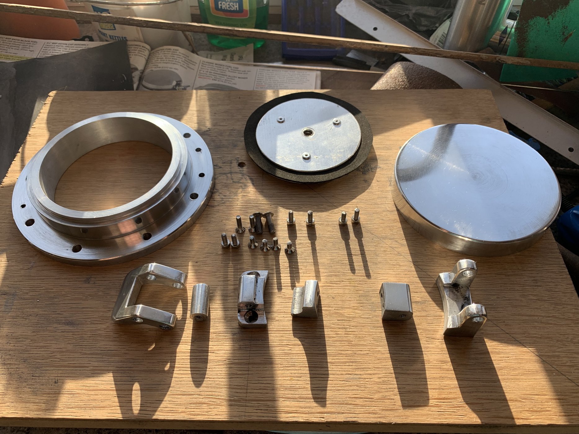

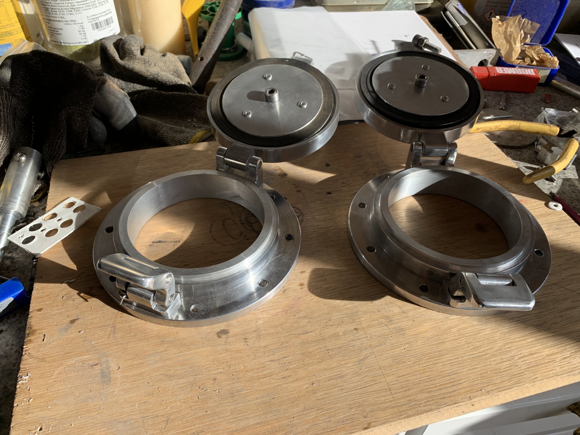

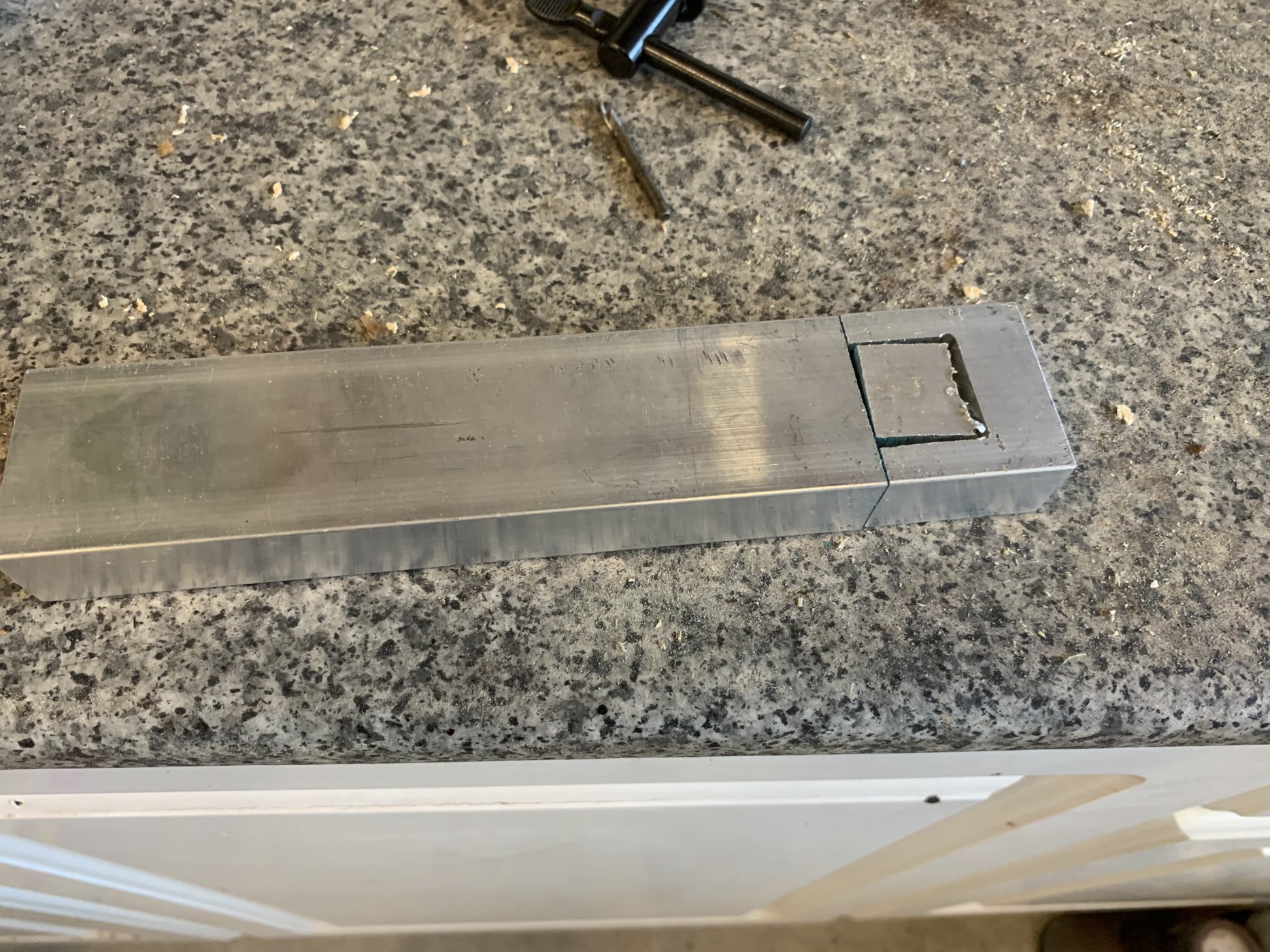

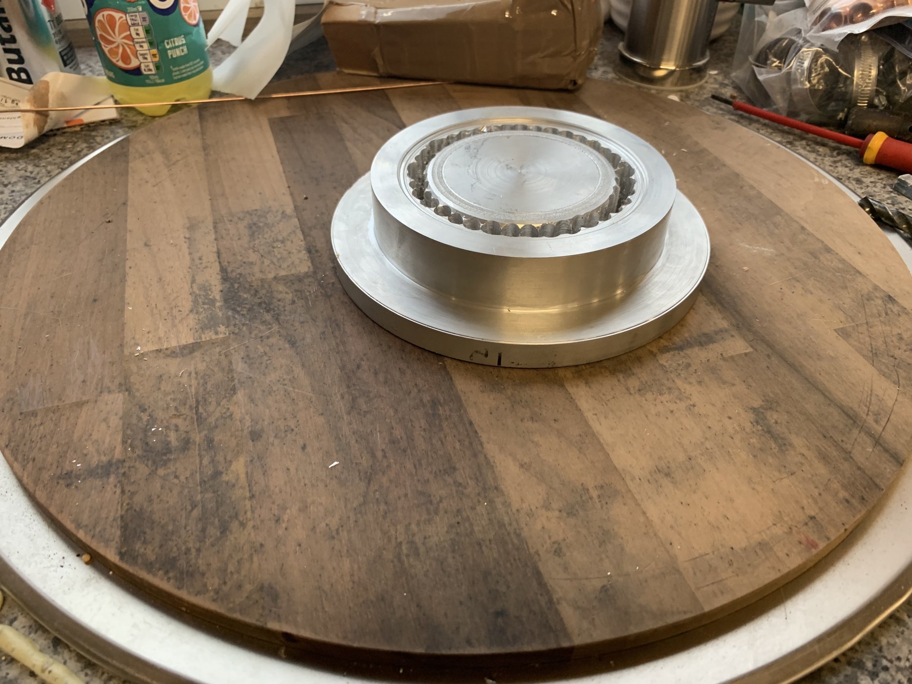

Well far too long from any progress but house renovations now completed spent the last few days making fuel filler caps as couldn’t bring myself to part with the amount of money they cost for the two of them. So bought some aluminium billet off cuts and a few days on the lathe and cutting and filling and very pleased with the results.
