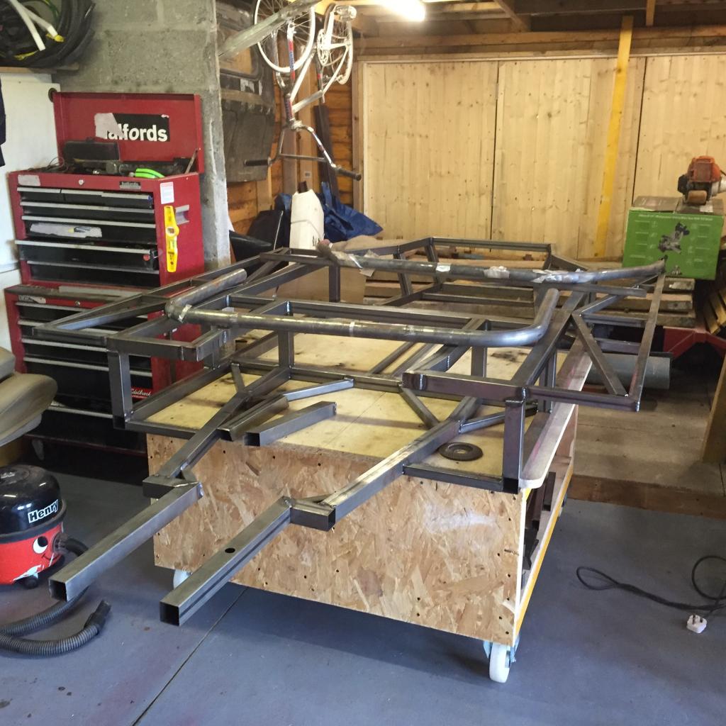

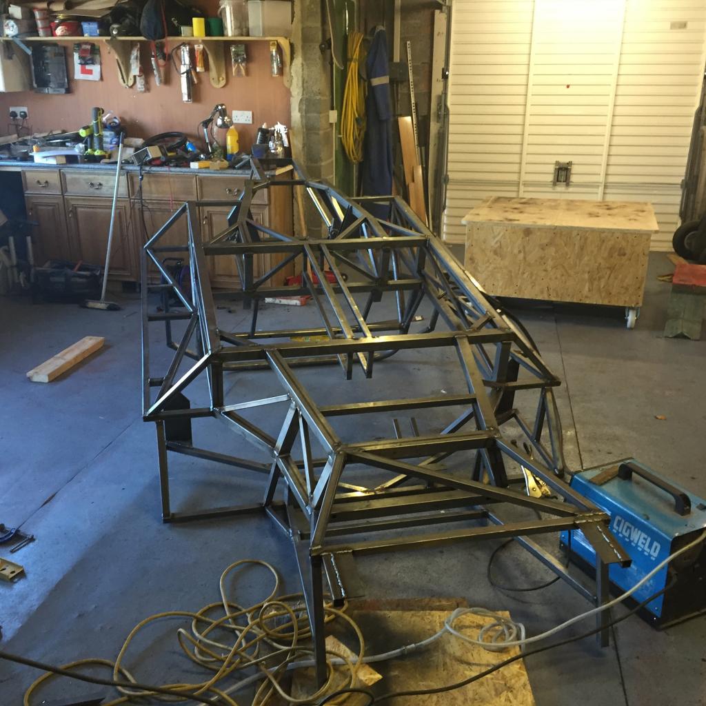

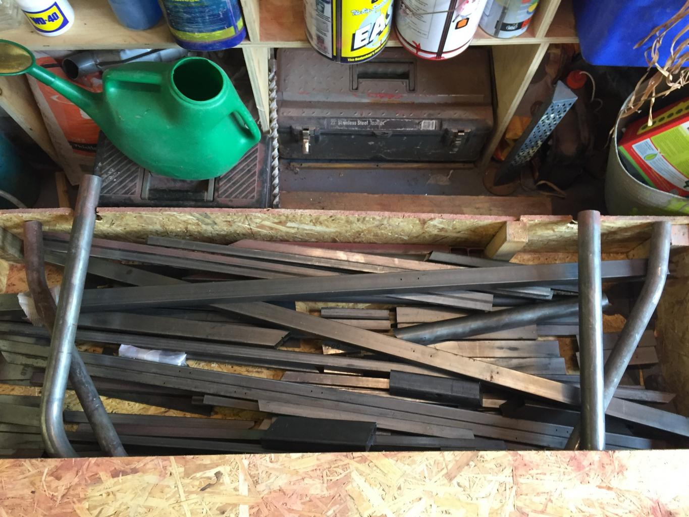

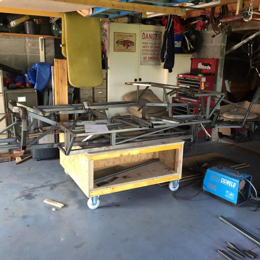

started with a wooden crate of parts and a level and square base to assemble the chassis on. Then sitting on trolley to provide a good working height and fitting the various parts lots of checking of dimensions but have to admit it fits together well and has remained square from tacking through to welding completion.

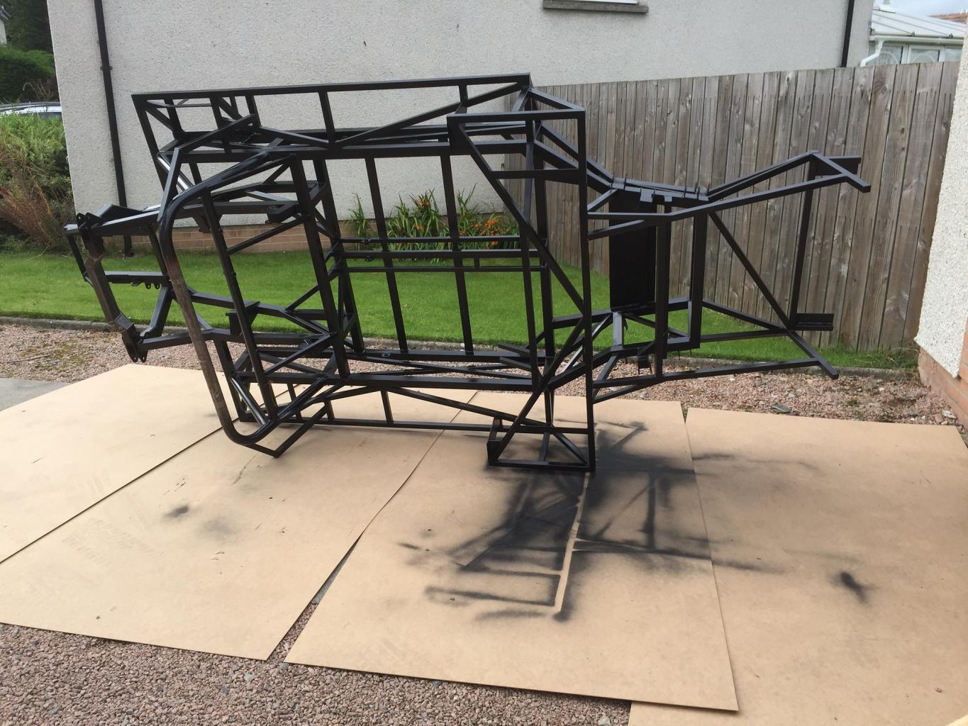

My second post now brings my build up to date I started in April and that is six months gone already.
The chassis is almost completed just the front roll bar to sort out when the body work is here. Also still to fit brackets for anti roll bars and I am sure there will be a few more. I am expecting all the suspension parts tomorrow from Darren at GT Forte. I think i should have ordered poly bushes and rose joints but will see what comes and then see what I need.

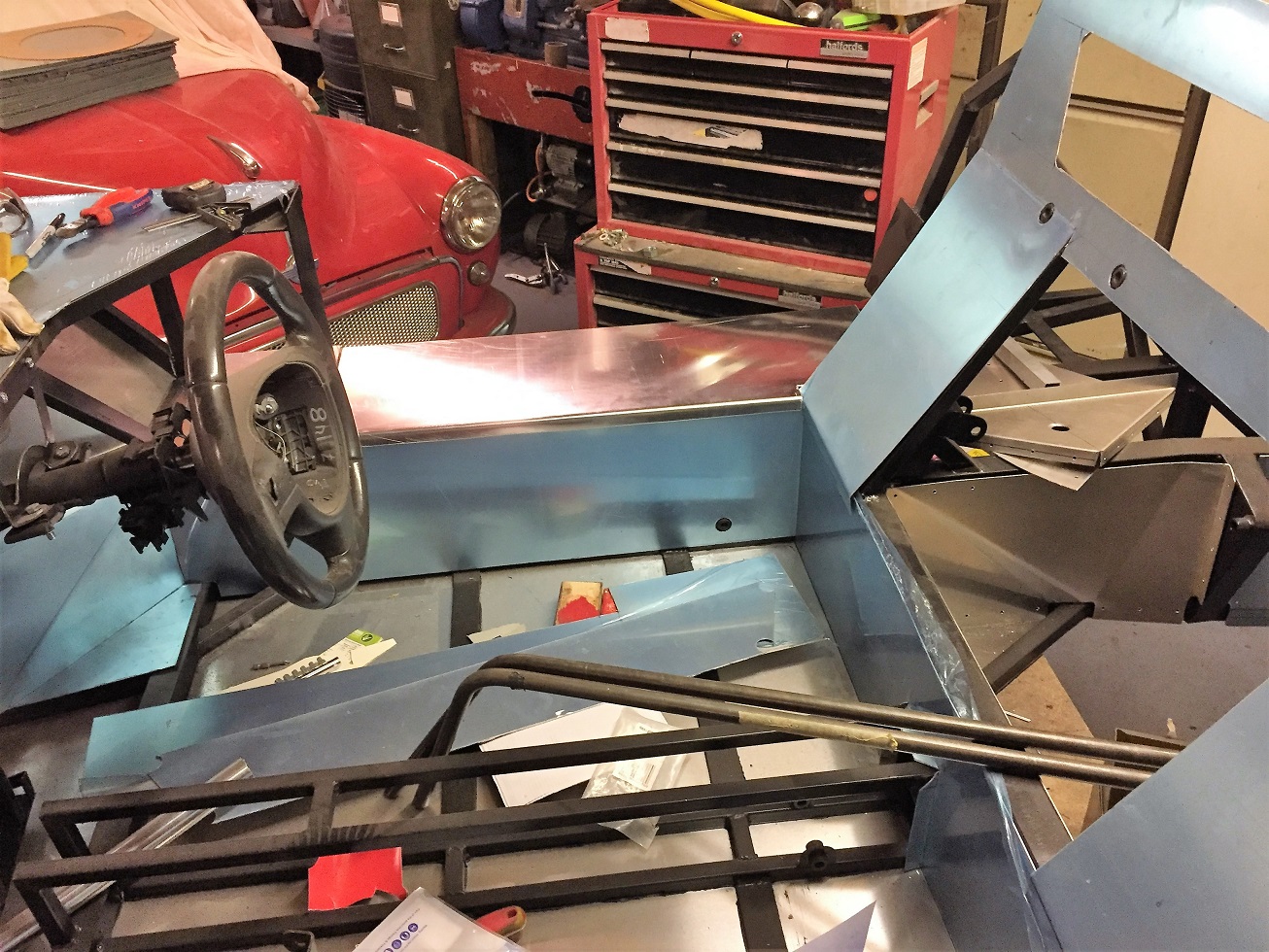

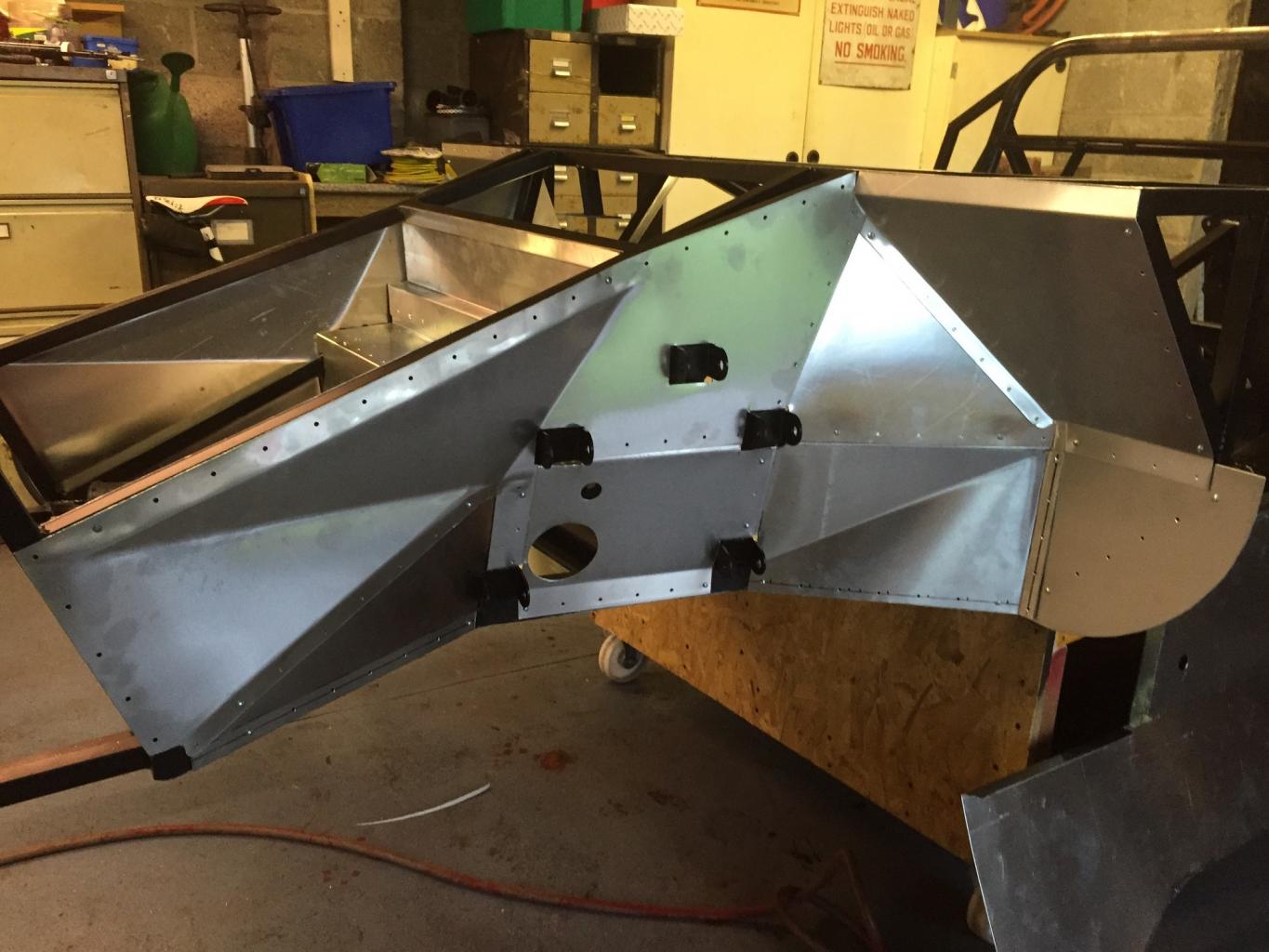

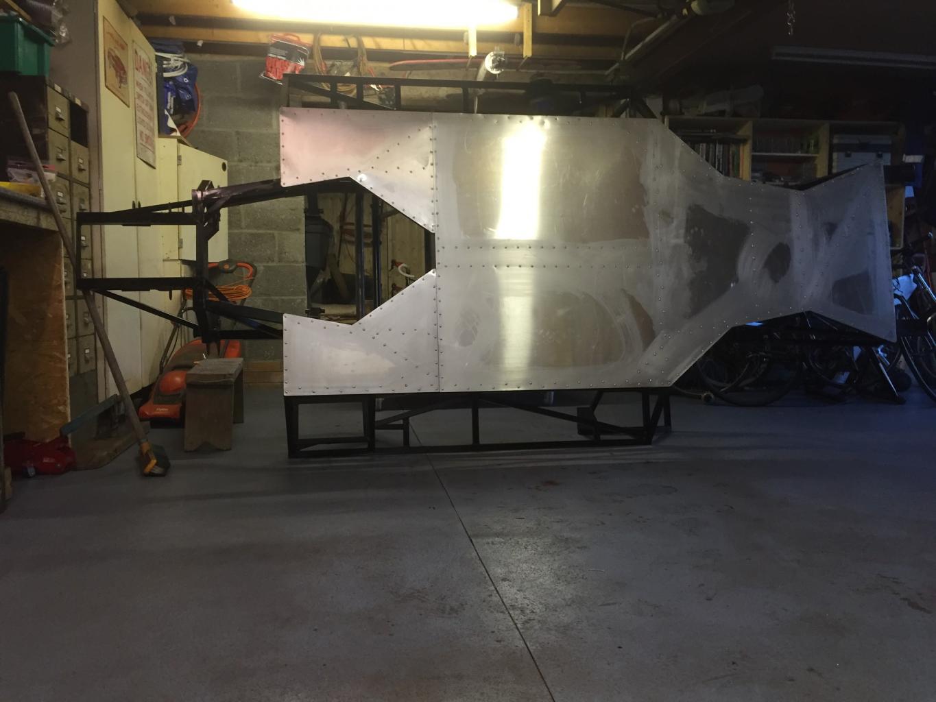

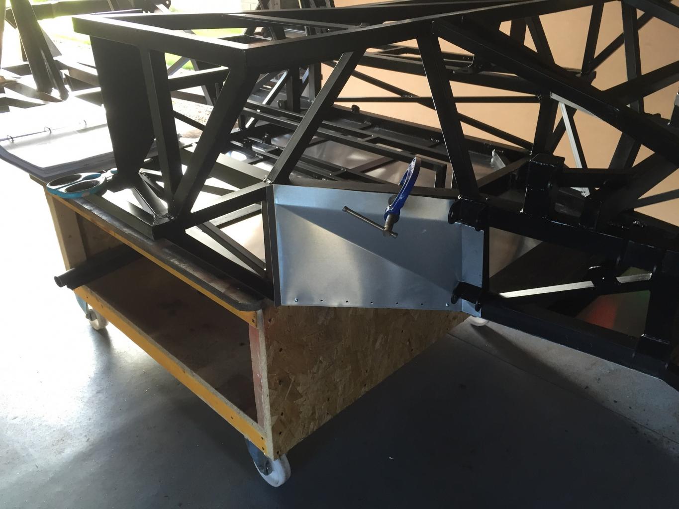

I have been panelling the front end and just temporarily fitted these panels with self tapper screws. My plan is to complete the alloy panels with the exception of the engine and cockpit bulkhead as I will wait until the spider is in place just so I am not guessing edges or piecing in bits.

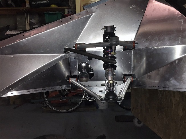

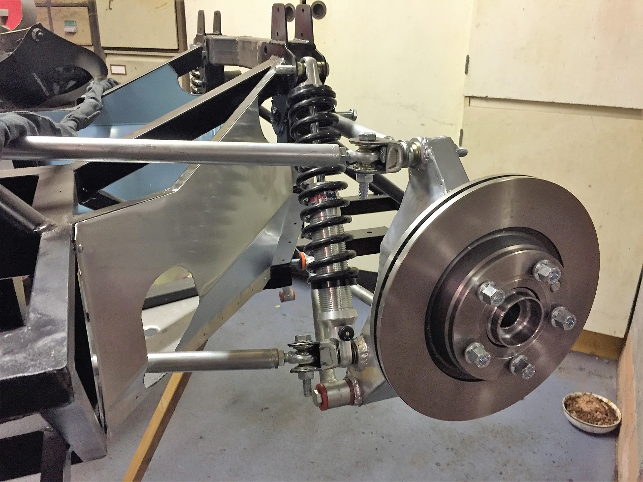

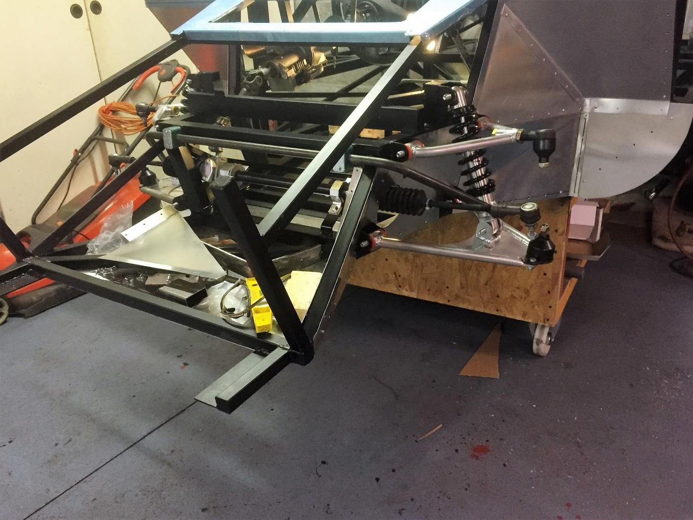

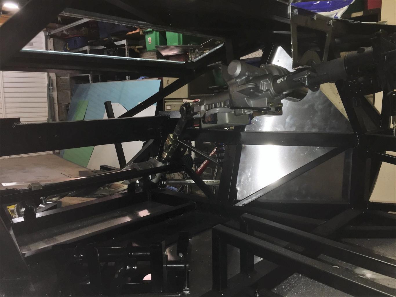

Got a delivery on Monday the suspension parts arrived. So have been busy painting these and mocking up the parts to check the fit also the steering rack and the steering column are fitted also peddle box position has been determined. The front and rear uprights never came so will have to chase these up so i can confirm all is good with the moving parts. The Anti roll bar fixings I am not sure of the final positions for the drop links so will leave these until I get the uprights. I will continue with the panelling again now.
Sandy

Sandy, just having a look at your pictures....
Think the angle of your steering coloum through the top U joint looks too great, believe it sould be less than 30 degrees but more than 10 (IVA manual, Protective Steering Section 14), maybe the picture is mis-sleading but yours looks more like 45 degrees.
Andrew

Having looked at mine I think the issue here is the difference in length between the Corsa "B" and "C" type columns, the "C" being much longer whereas with the shorter "B" the UJ sits much further up and hence is a much lower angle.
NickD
Sandy,
Would you forward me a pic of your front suspension side on to the car, i.e so both upper and lower ball joint nearest the camera ?
Thanks.
Nick.

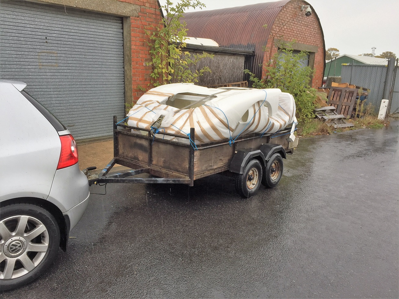

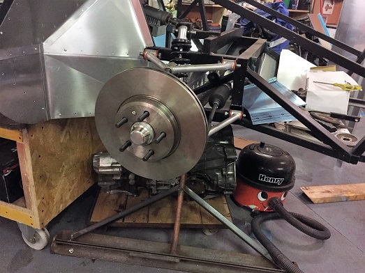

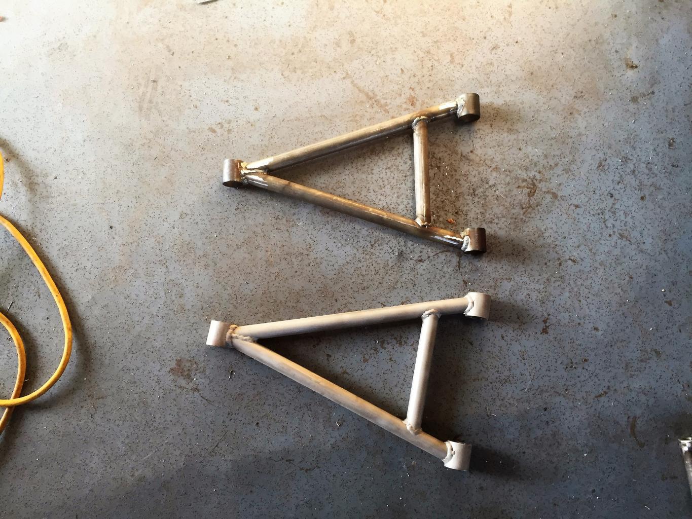

Hi thought I would post some updates time has flown past the last 3 months with little time in the garage but managed a few hours.
Collected the body work from Margate that was a 11&1/2 hour drive each way.
Made up the 2 rear uprights.
Mocked up the front and rear suspension with hubs and brake discs.

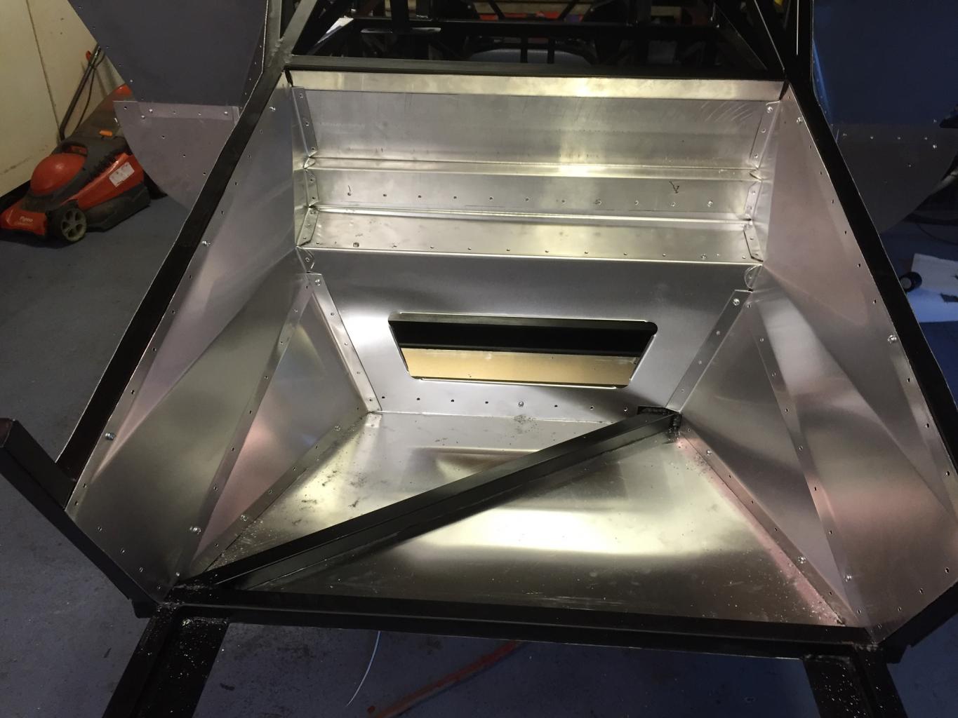

Been doing some more panelling.

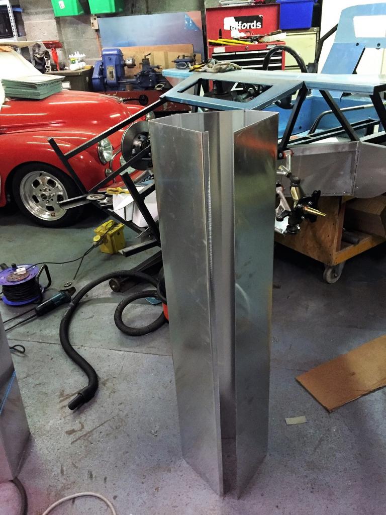

folded up some aluminium sheet to make fuel tanks

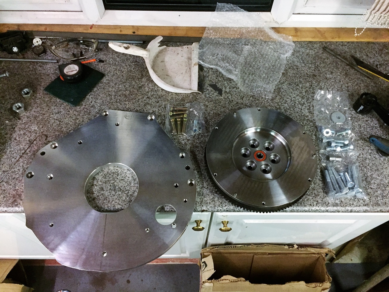

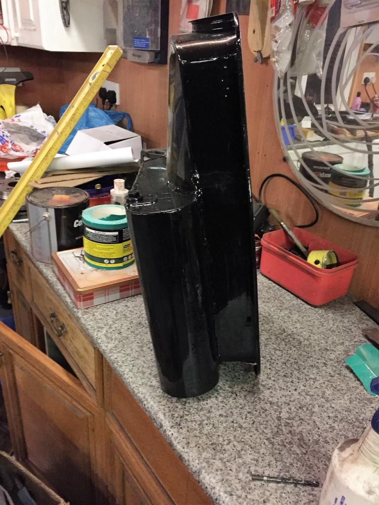

I have also been collecting the drive line I now have a 302 engine with the bottom end rebuilt I'm not sure if i want to go 8 stack yet but going for injection set up with no distributor so no need to worry about clearance for that. I have also manged to get an Audi 01E gearbox and have received a gearbox adaptor from Kennedy engineering. I have reworked the sump with a larger capacity and fitted trapdoors to keep the oil around the pick up.

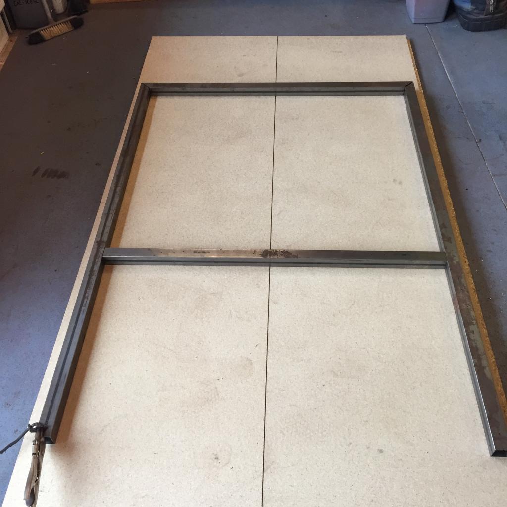

HI
I had an enquiry from a member regarding my build table but I couldn't figure out how to attach pictures to the forum email so I have put some drawings I created of my build table here they may be of some use to others.
Sandy
