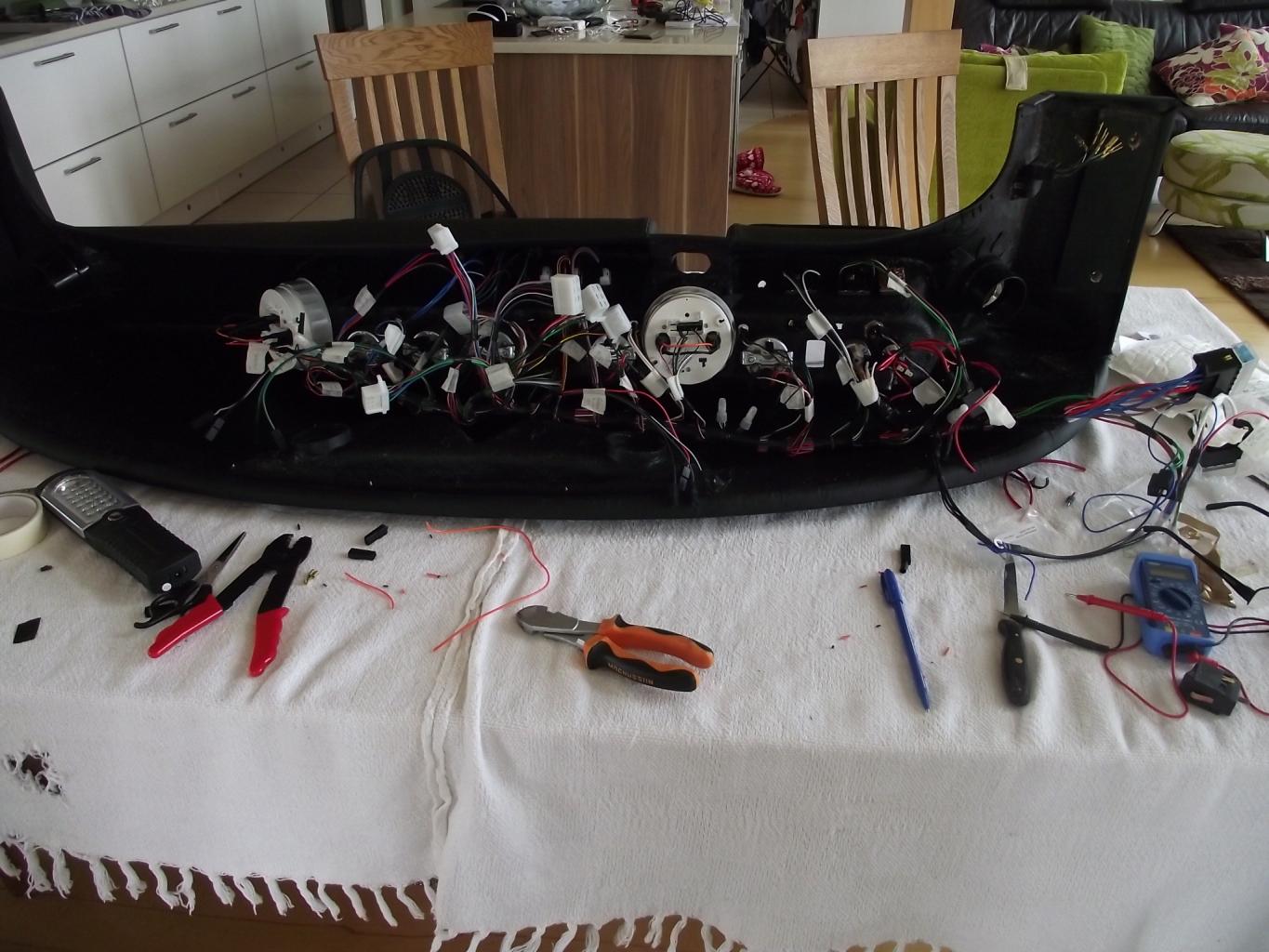

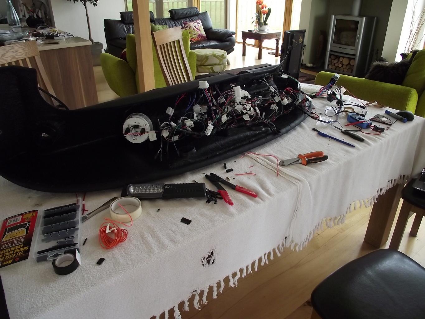

Connected up the dash loom this weekened. Also extended it for the A/C, for the wing mirrors, the courtesy light, a 20Amp socket, and for a clock and sound system that I'll install after the IVA.

Hi Ian,
You must be in the wife's good books to be building the dash on the dining table!
I ended up fitting 2 aux sockets, one on the drivers side for the SatNav & one passenger side for phone charging etc
Regards
Andy

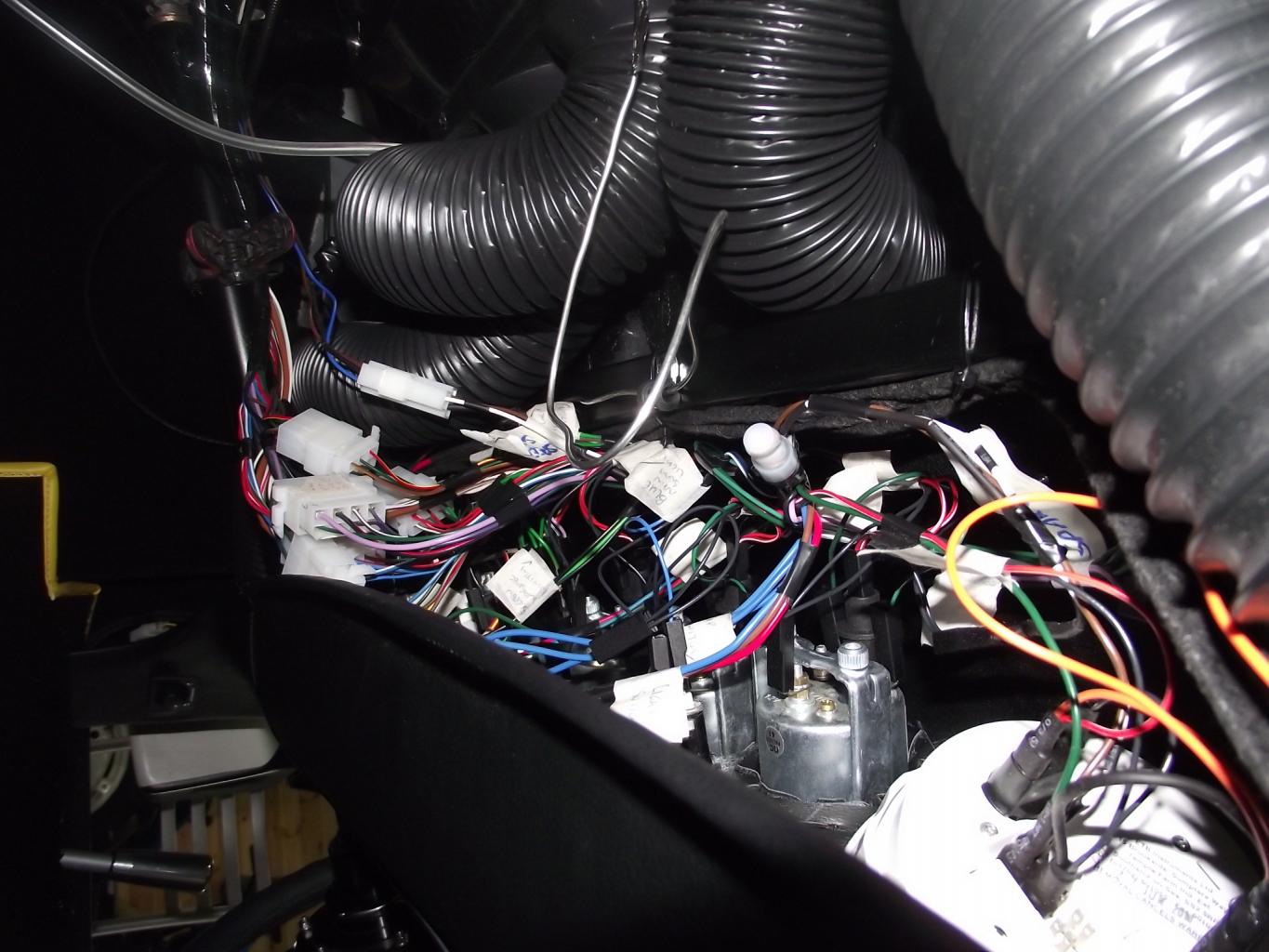

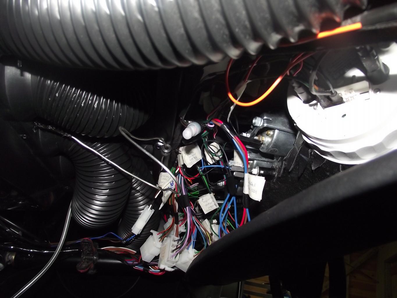

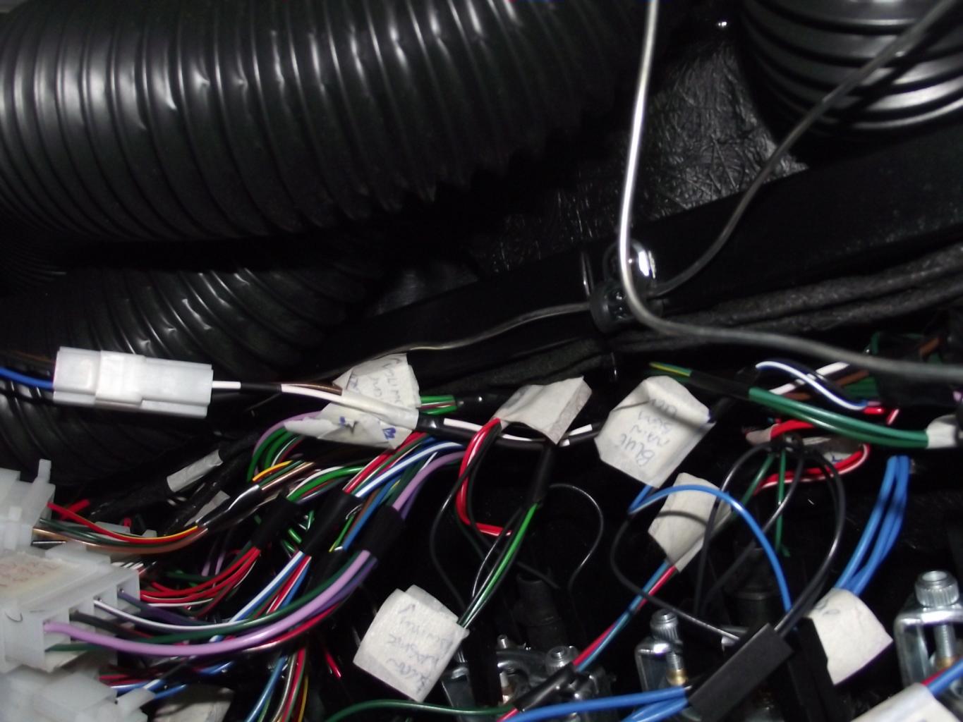

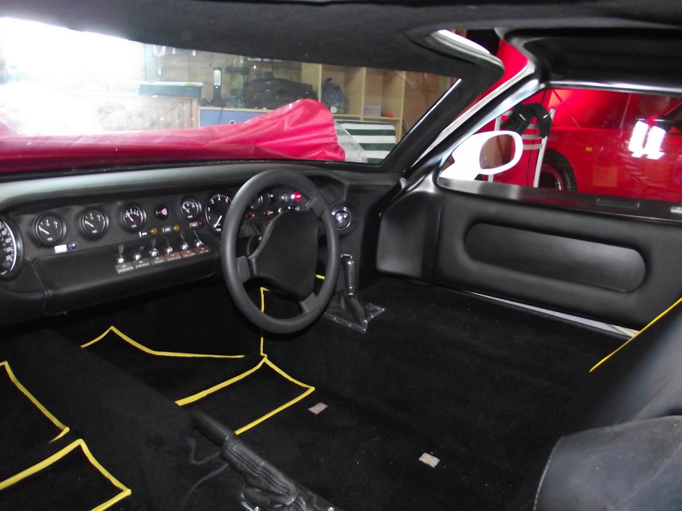

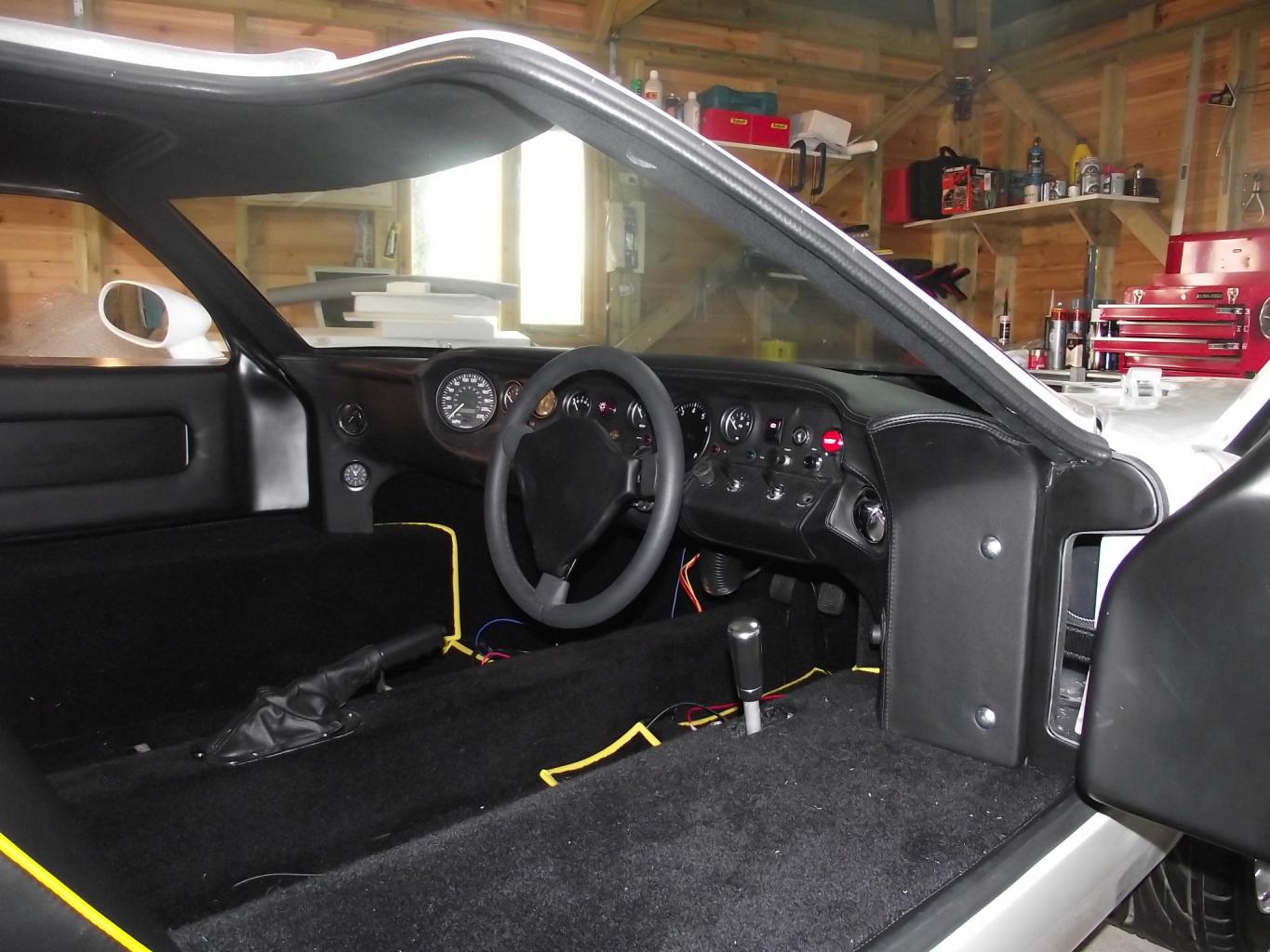

Dash fitted back in place and the complete car wiring is now fully tested and installed with the exception of one final wire for the A/C thermostat to the trinary. I also connected the dash vents and temporarily conected the blower motor to a battery to check its function; all works well and the motor is pretty fierce so hopefully no windscreen misting. Spent the weekend under the dash connecting the loom and extending it for few other 'bits' I'm adding, dont wont to do that again in a hurry! Lots of little bits and pieces to tidy up now and then all I'm left with is the engine and gearbox installation.

I remember only too well the spagetti of wires.
It makes you think why they made everything so compact especially around the engine area.
Maybe it should be a little longer and taller " GT43 "
I don't know if your A/C unit and wiring is the same as mine but you should have a relay that pulls the fans on when the A/C requires it, triggered by the Trinary switch.
Mine did not come with this relay etc.
Looking good though mate, wont be long

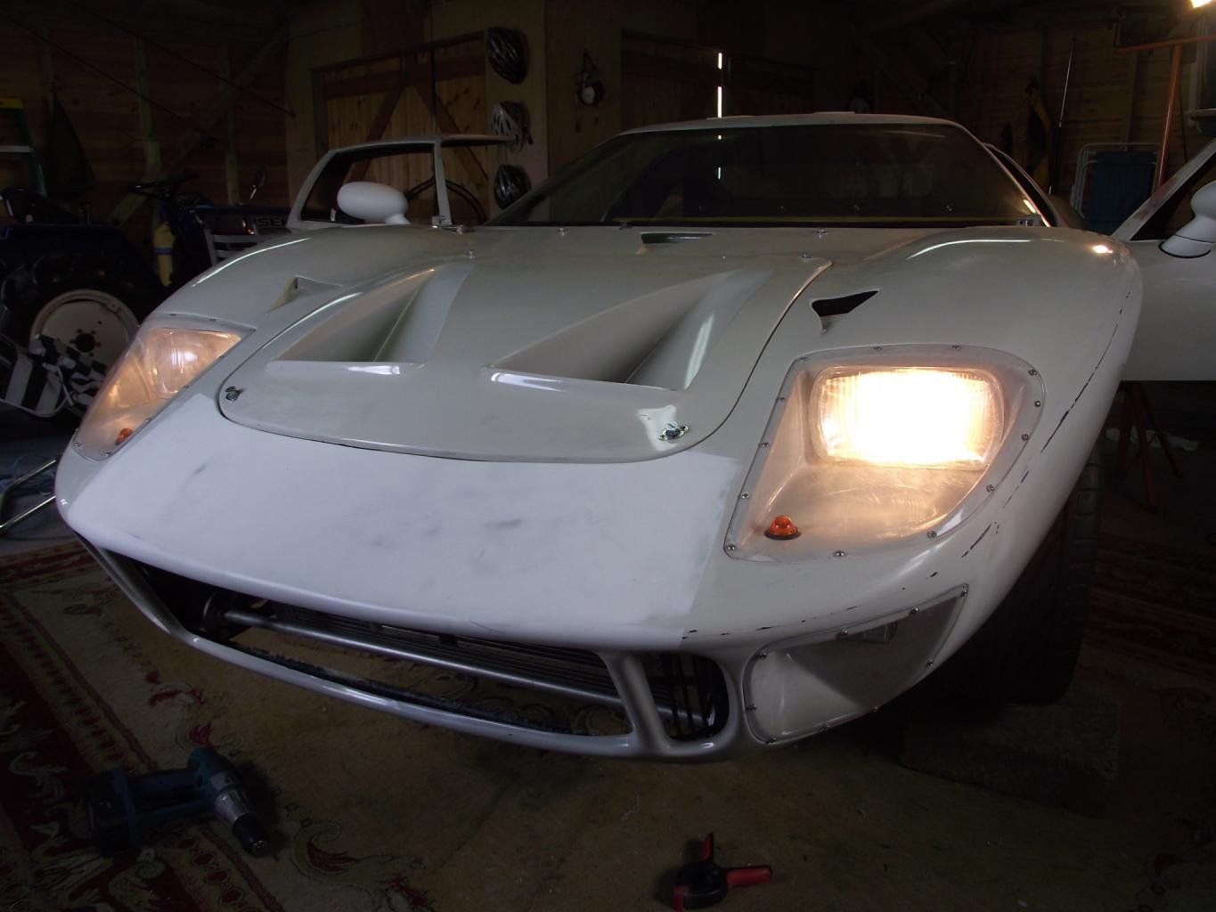

Ian, Just a thought, I was talking to SGT and one thing the IVA were pulling up down there way was the 2.5mm radius around all the fibreglass panels.
worth checking them out maybe.

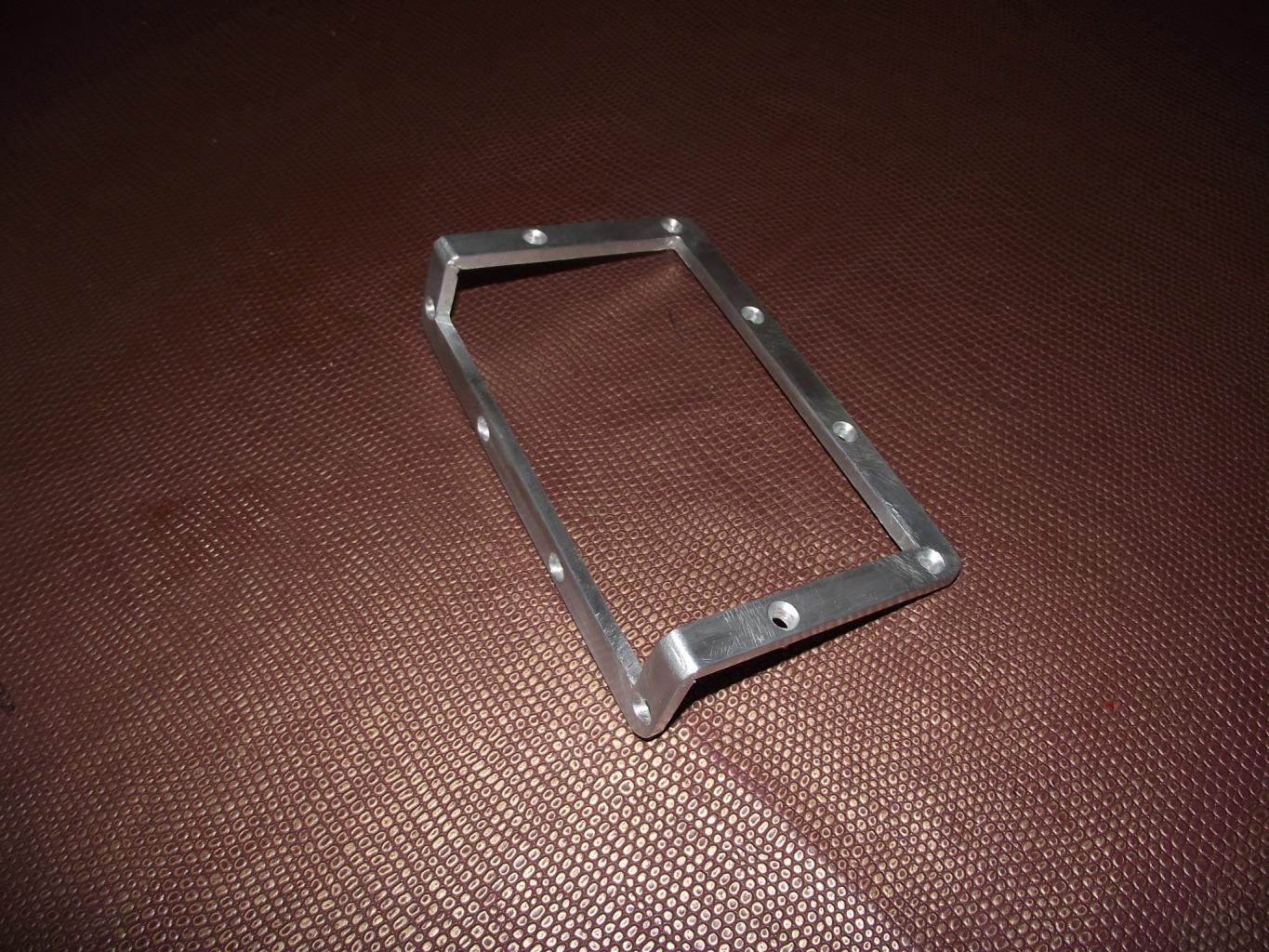

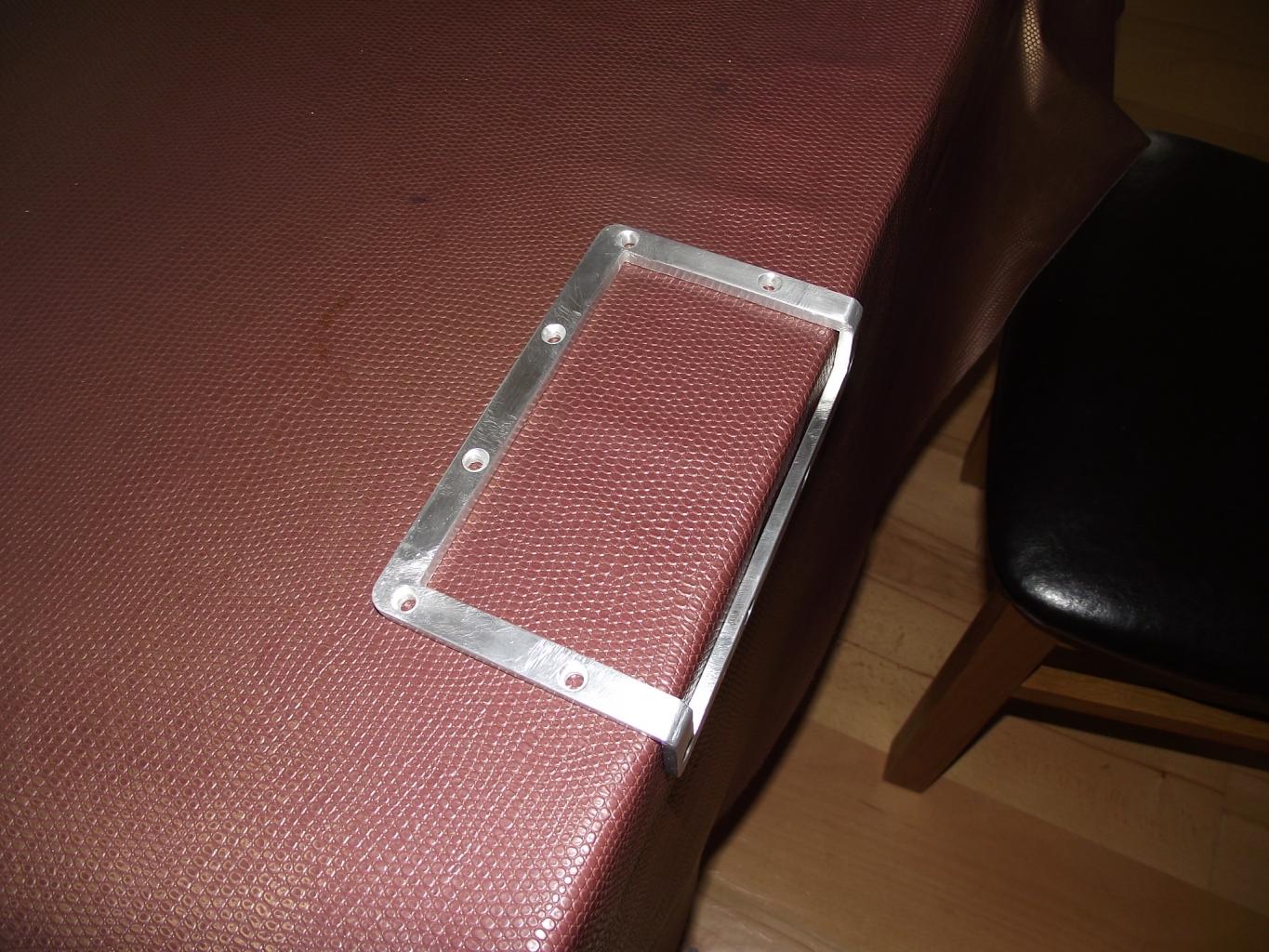

Made up a gear surround out of 5mm thick aluminium plate. I'll fit it to the car this weekend, then will send it off to be chromed.

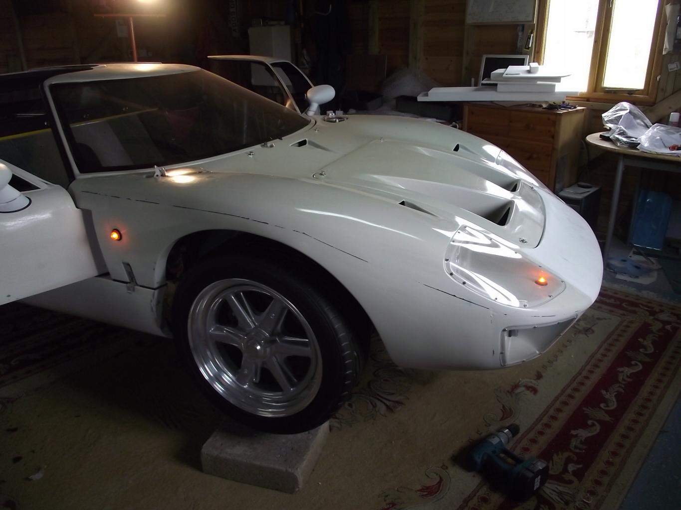

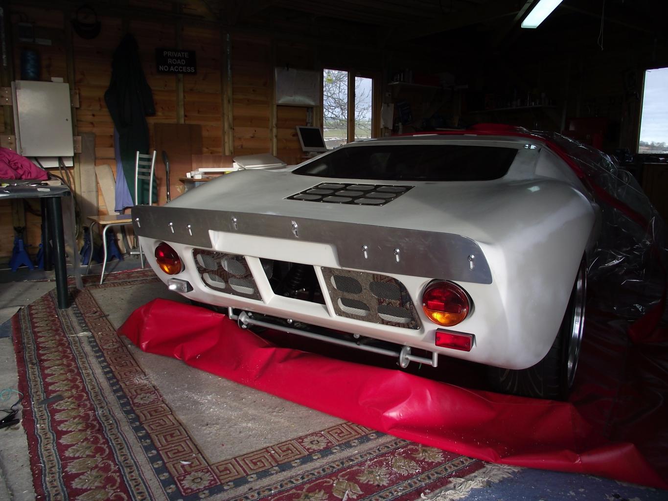

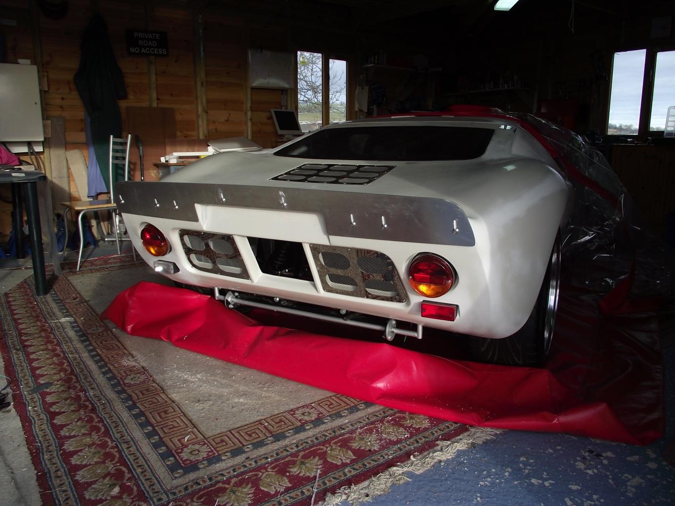

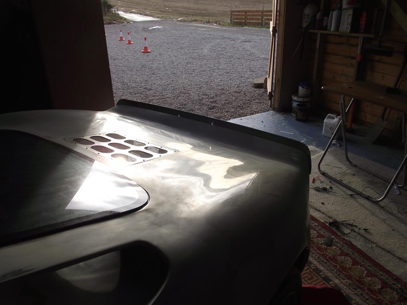

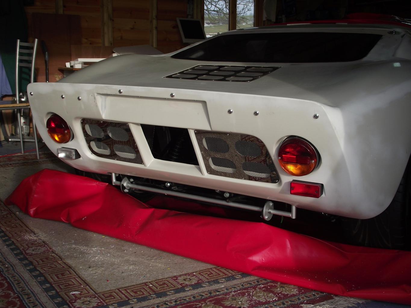

Its been a while since my last post...still waiting for the engine, but its been promised for delivery to me next week. Once thats in, I'll send the car down to Andy at Tornado for the final bits and the IVA. Meantime, I fitted an adjustable spoiler.
Hi Ian,
Those front and side indicators are same as mine but they are not ok for IVA .
Also something to watch out for ,if IVA see holes where the Perspex is they will assume something goes there and it will need to be e marked. I filled all those holes back in and it was presented without Perspex ,same for side Perspex . Don't waste time, do them after IVA .lastly I recognise that rear wing its from e bay as mine was, good value as well at £85 ish
That 9 hole grill will need to be blanked off as well
Andy Sheldon
Tornado Sports Cars
GT40s Sponsor
Indicators and light covers are fine for IVA.
Mesh in the gulf vents is also fine.
Reverse and Fog lights may need moving.
Spoiler will be an issue.
Andy
Keith, yes the spoiler was from eBay 80 quid delivered, very well made but had to cut out the two centre slots as only 6 were included. As Andy says I have mesh under the 9 slot grill so it should be ok for the IVA. By way......your car looks fantastic.
Andy, I intended to leave off the metal spoiler for the IVA. If the rear fog and reverse need moving, I will leave it to you to move if needed when you get the car.
