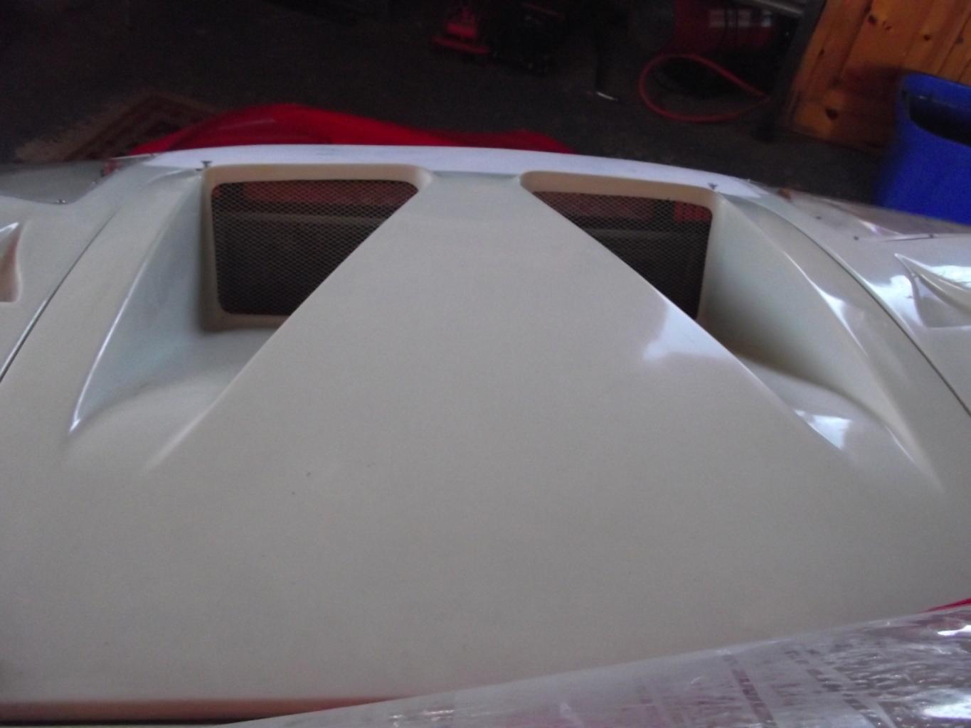

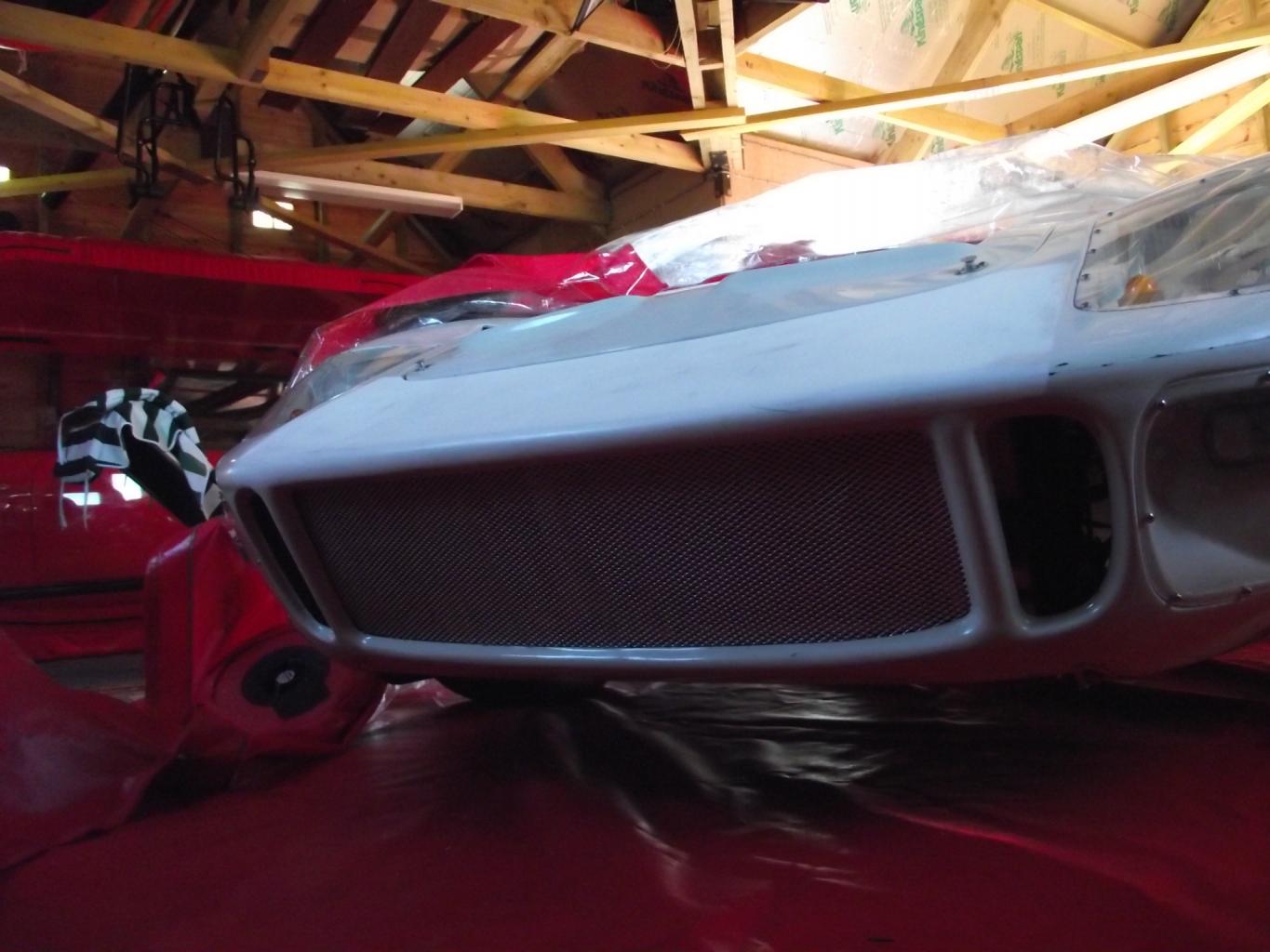

Fitted mesh to the nose and to the front nostrils ready for the IVA. Do I need to cover the small NACA ducts in mesh too?

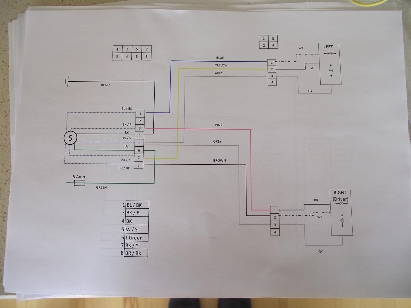

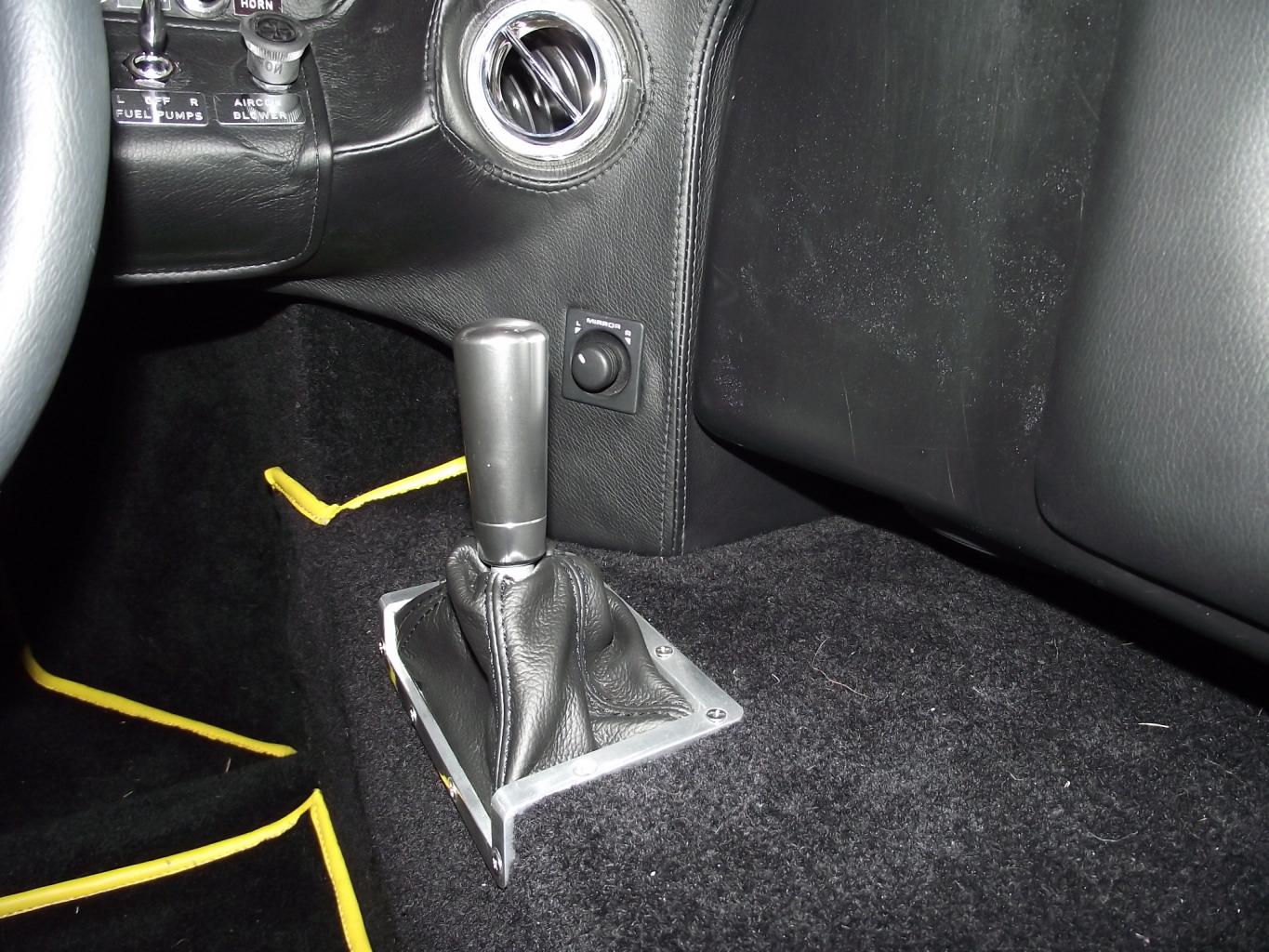

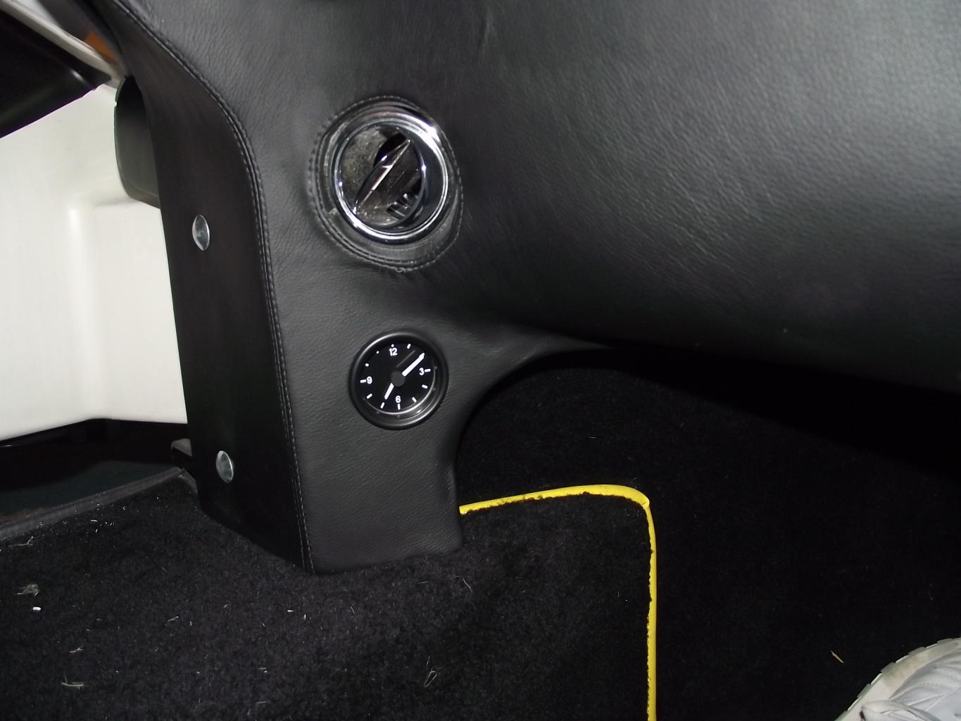

Brett, I used a Rover switch, photo attached along with a wiring diagram I made up for the switch. I didnt bother running the mirror heater wiring. I fitted a clock on the other side to balance the dash.

Hi Ian, just an observation relating to your nostril, not accounting for the english weather you will find the cabin will get excessively hot after a short drive. Your Nostril is similar to the RF design it cuts the radiator in half so heat from the bottom of the radiator washes up under the front clip and radiates into the cabin. I modified mine so the nostril now sits at the base of the radiator and expels all the heat straight out. Really made a difference with the AC it actually works.

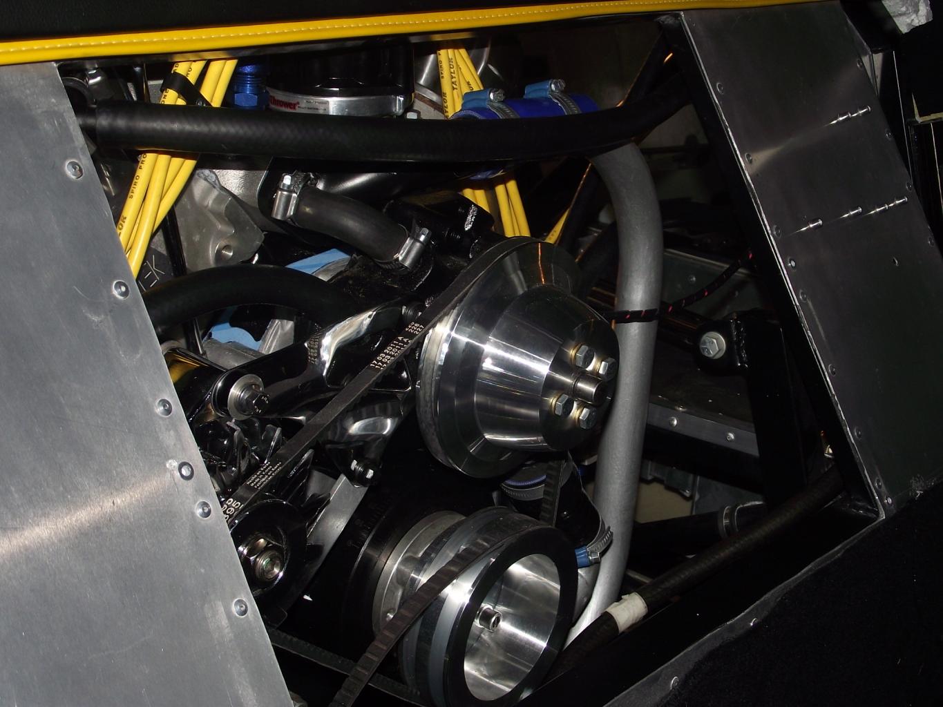

I too added the deep nostrils to my car. I have to say that virtually no heat gets to the main cabin. I also added insulation to the paneling at the foot wells. You can make the alterations with a stright shot to the top of the nostrils or a curved one. I opted for the curve. Have not noticed any build up of heat in the cooling system at all. I am sure some air isn't getting through due to the shape, however I think the curve looks much better, and temps stay in the 160-180range at 75mph on the highways with temps in the high 60s low 70s.
Currently I only use the fans in stop and go traffic. One of my additions this winter(time prevailing) will be a controller that will operate the fans and the flow of the electric water pump. Right now it is a manual system. Have to keep an eye out on the temps for now. These pics were in the early stages.
Since mine has the water inlet at the top and the exit is a curve piece at the bottom I have to make allowances for that. to keep the heat out of the bonnet, I added a dam of 1/8" rubber stock to the frame member and I am very comfortable in warm weather with just the window(s) removed.

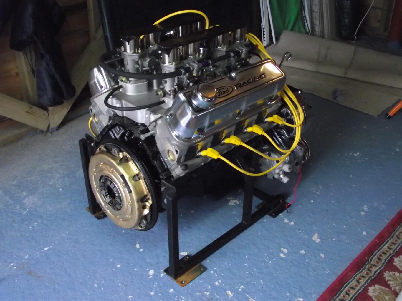

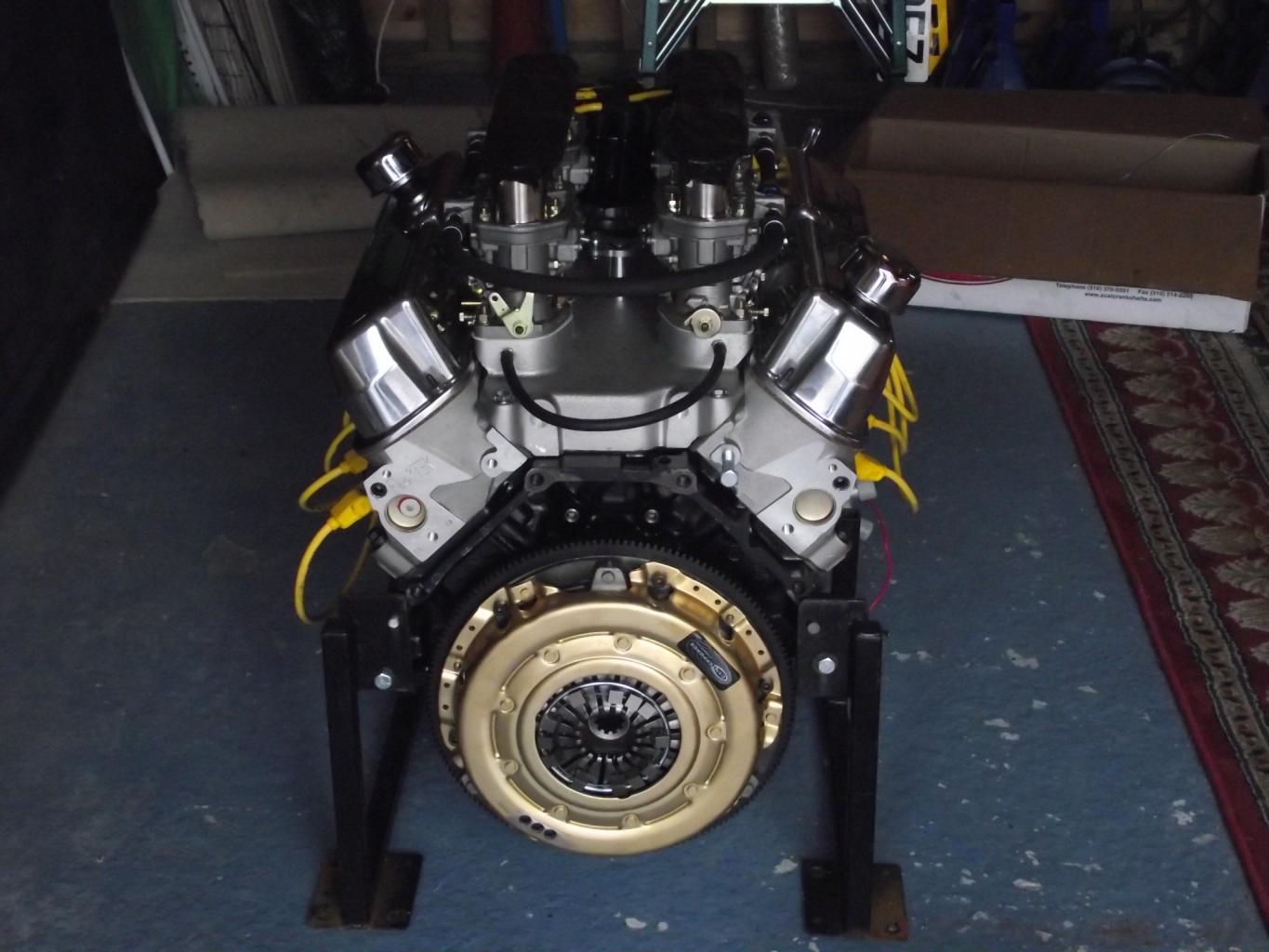

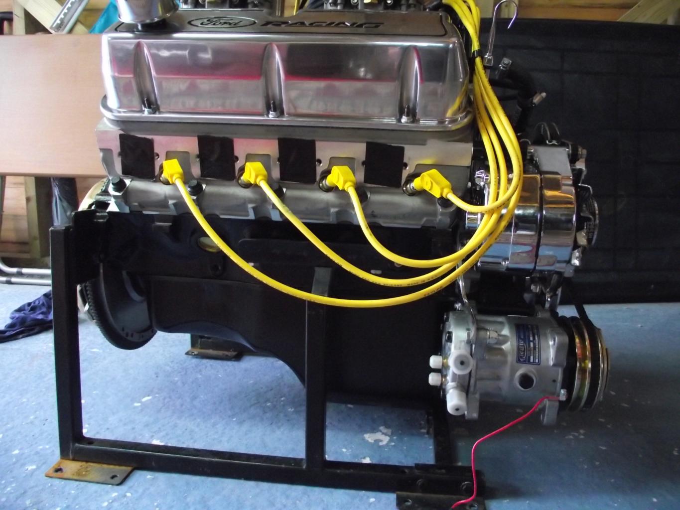

Finally got my engine today, was Dyno tested at around 430 bhp at 6000....woo hoo....Plan to get this fitted and then get the car off to Andy at Tornado for the IVA.

These were the final numbers from the Dyno test; it made 430 BHP @ 6000rpm with 412 FT LBS torque @ about 4000 rpm and virtually the same torque numbers from 3500 all the way to 5500....cant wait to get on the road now

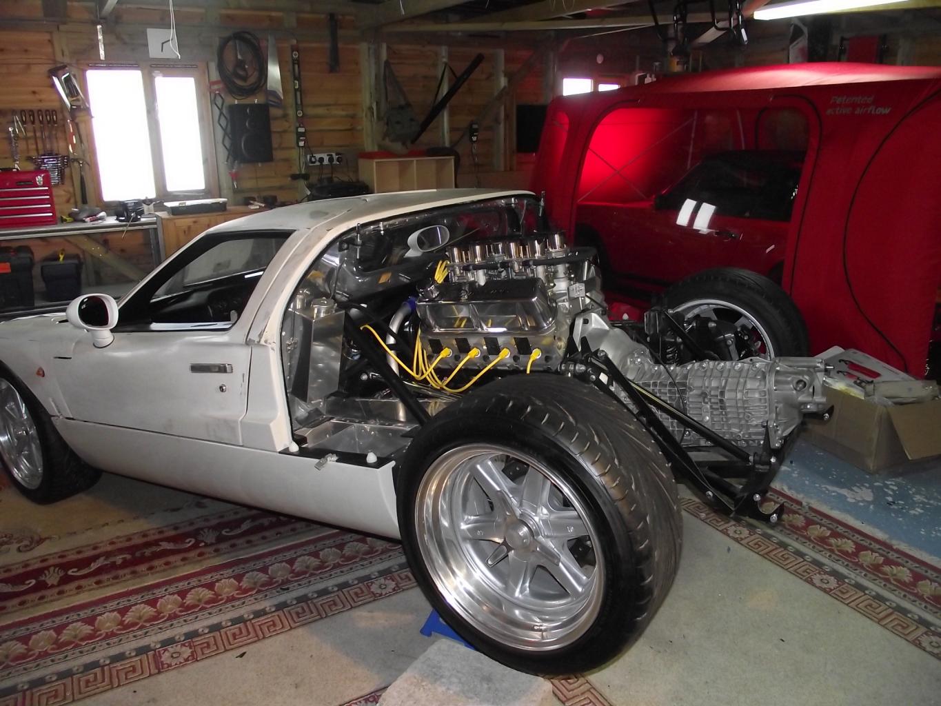

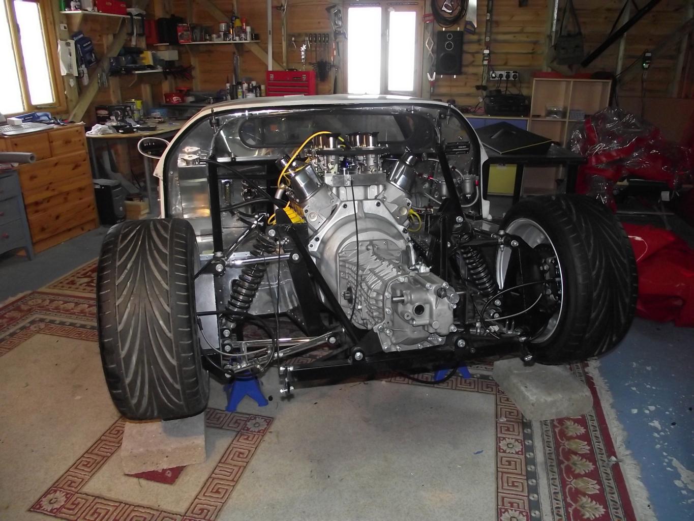

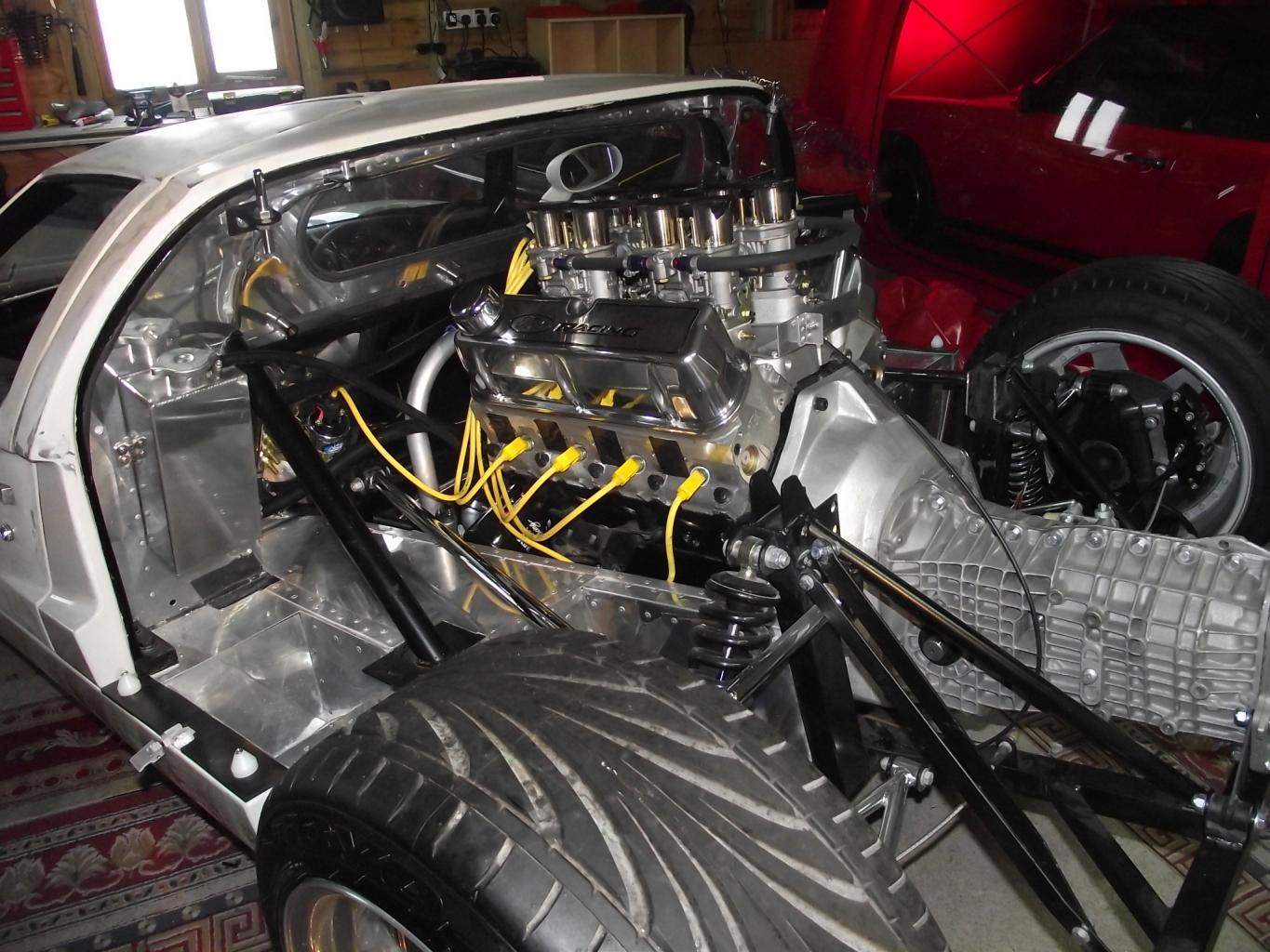

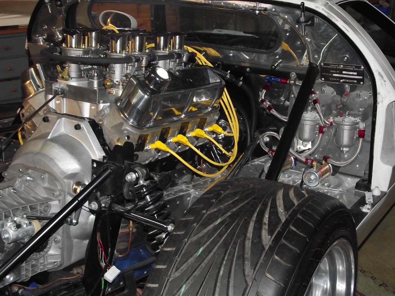

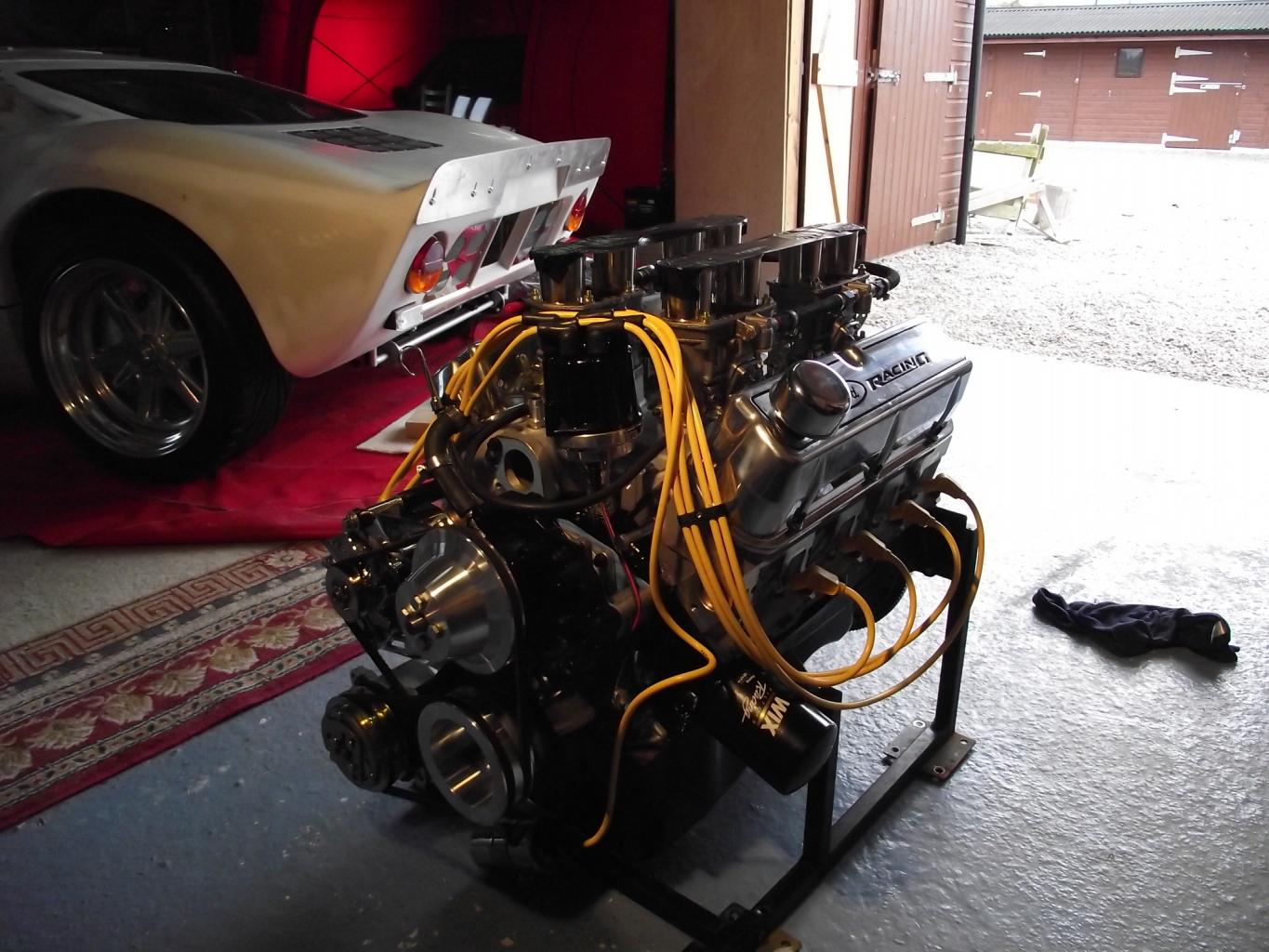

A milestone weekend.....on Saturday, I managed to drop the engine in with a mate of mine. A bit tricky it has to be said, but got there in the end. Had to remove the oil filter, the front pulley, the a/c compressor and the distributor cap to squeeze the engine in, but finally got there. Spent today plumbing in the engine. Not finished yet, but almost. My plan is to send the car down to Tornado in April for its IVA......
