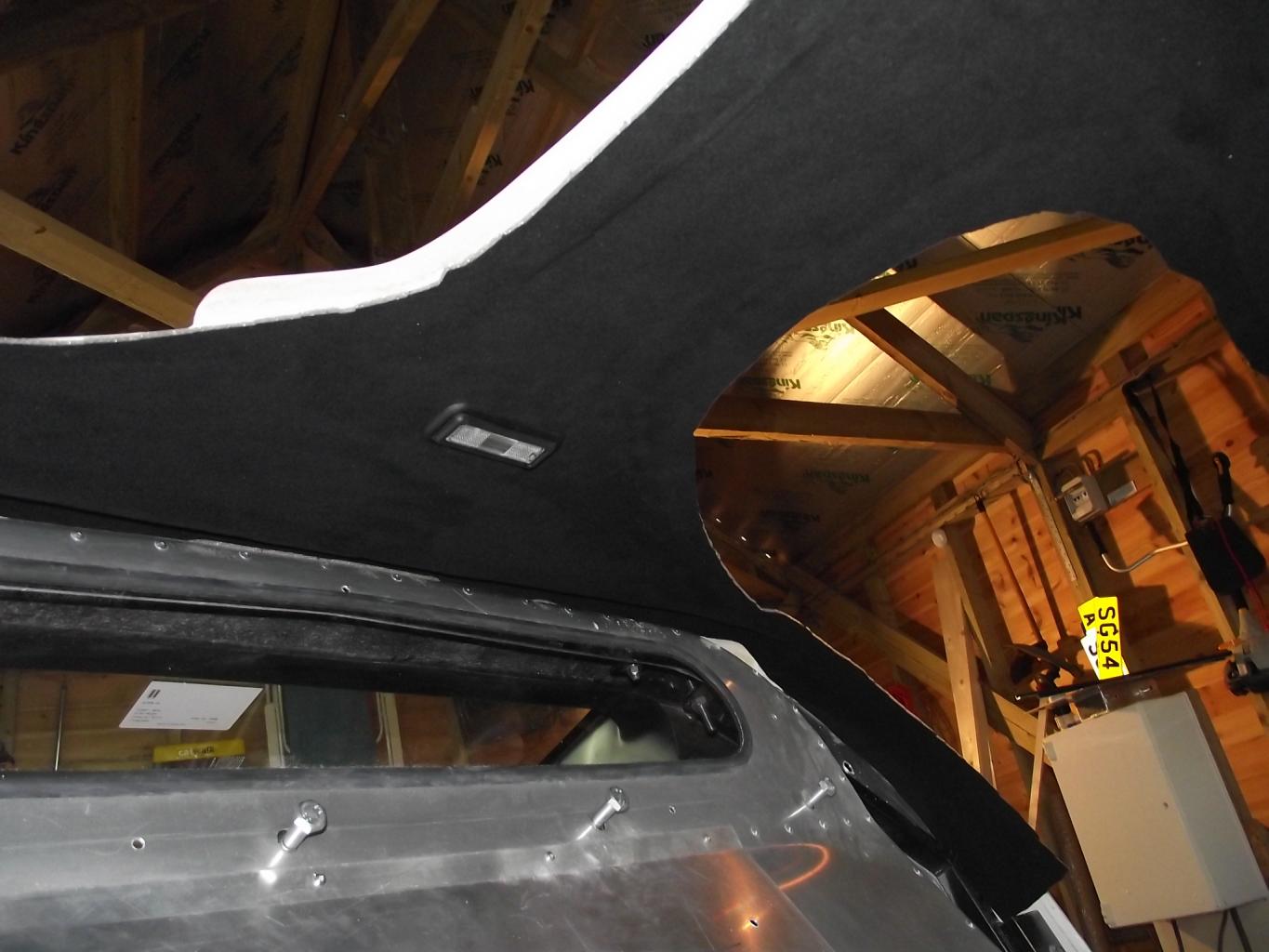

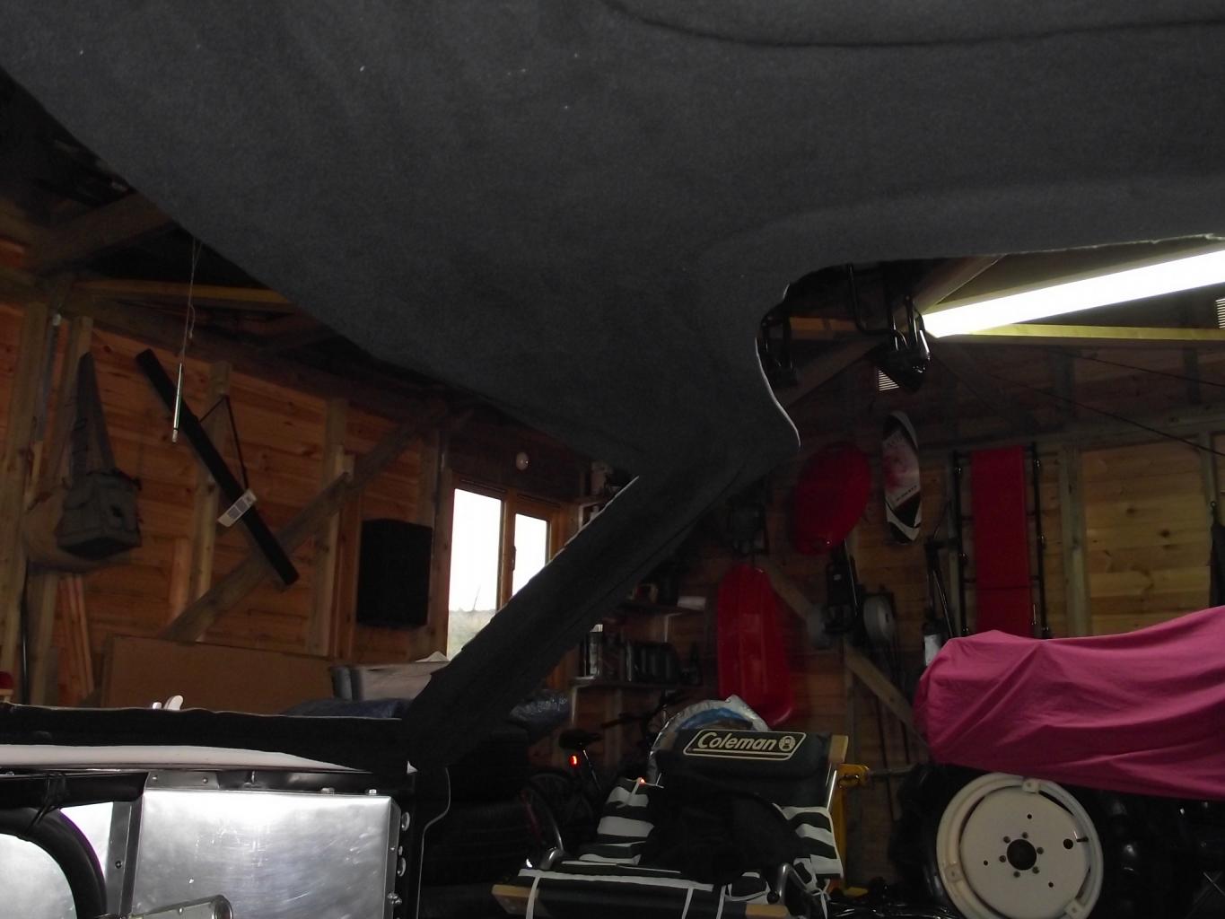

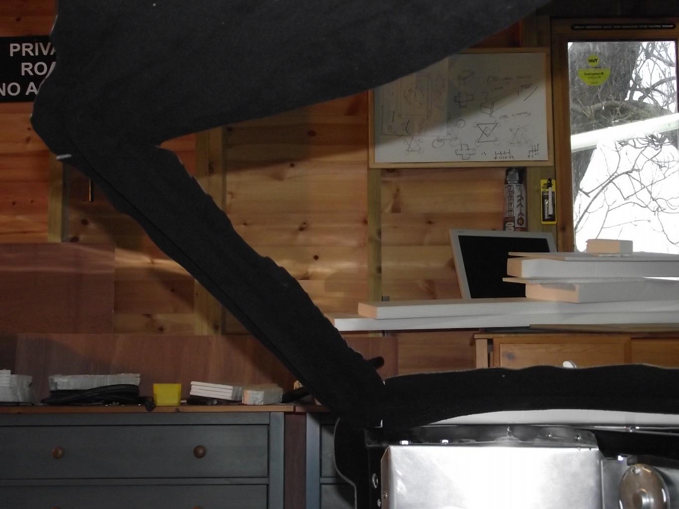

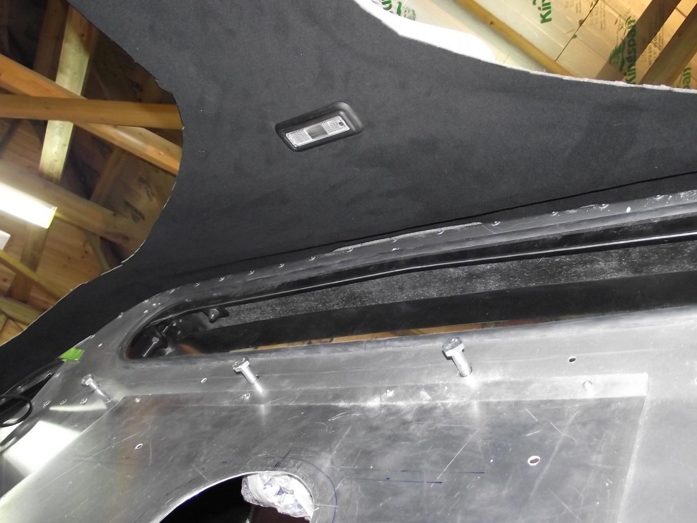

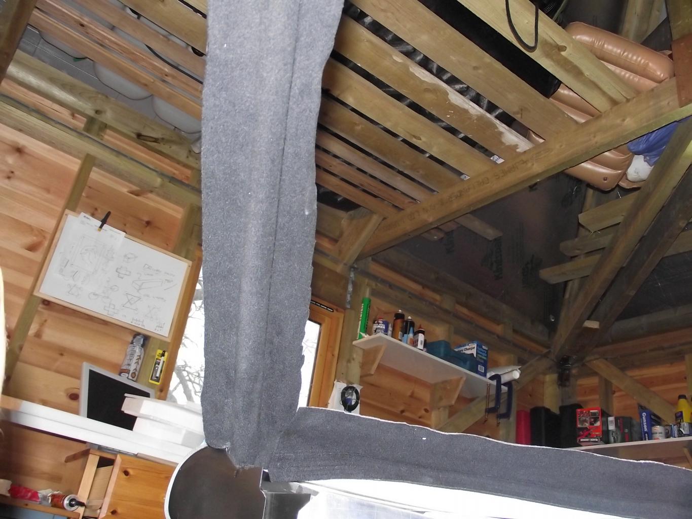

Fitted headlining to the roof today and the spider pillers. Just need to trim edges back to finish off then refit the door seals to the headlining. Also fitted and wired up a ceiling courtesy light. Now on to the carpet then I can fit the doors back in which I have now painted satin black.

Looking good Ian, That spider covering looks like it follows the contours nicely.
You could surely be belting down the motorway next year.
But Carpet, ceiling light. sounds like all you need is a comfy chair and slippers and it's home from home. Where will the Labrador sit.
Make it sound agressive:
Interior fireproof protective covering , High intensity Interior light.
I bought some headlining from Martrim and some spray contact adhesive, made up a template then cut the headling to suit. It was actually quite an easy job compared to a lot of others on the car. The headlining molds well into the contours and looks pretty good when finished. Just have to make sure you keep your hands clean when you push out the air from it otherwise the glue gets everywhere. I have some black hidem banding which I'll probably fit on the join to the door seal.

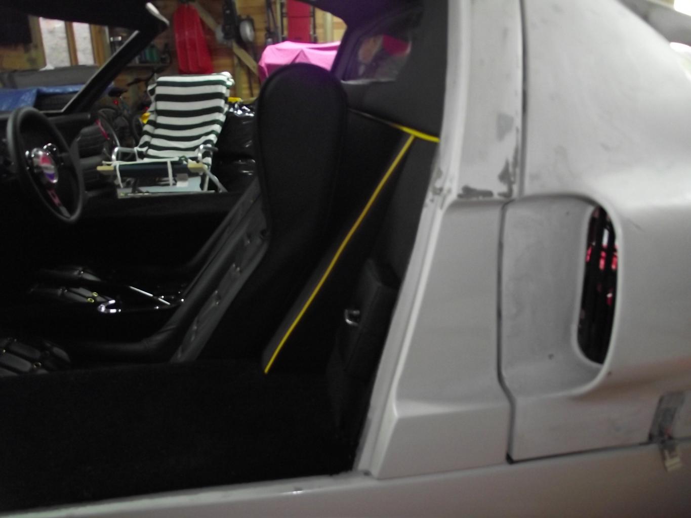

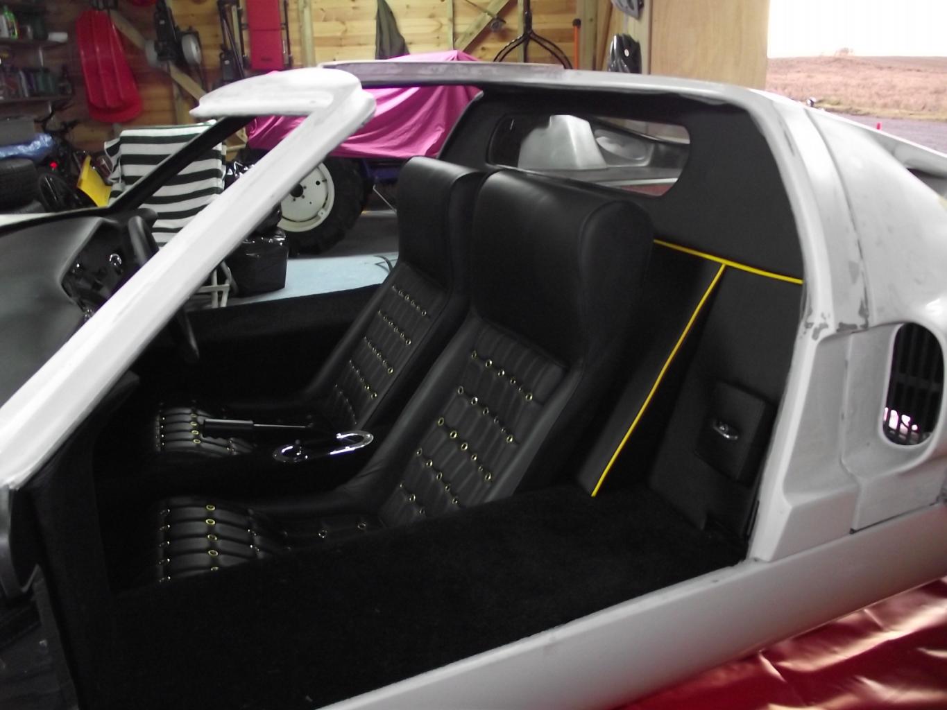

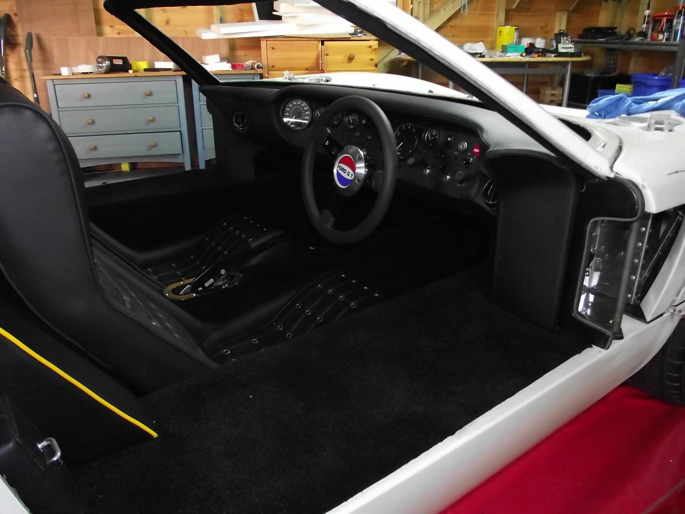

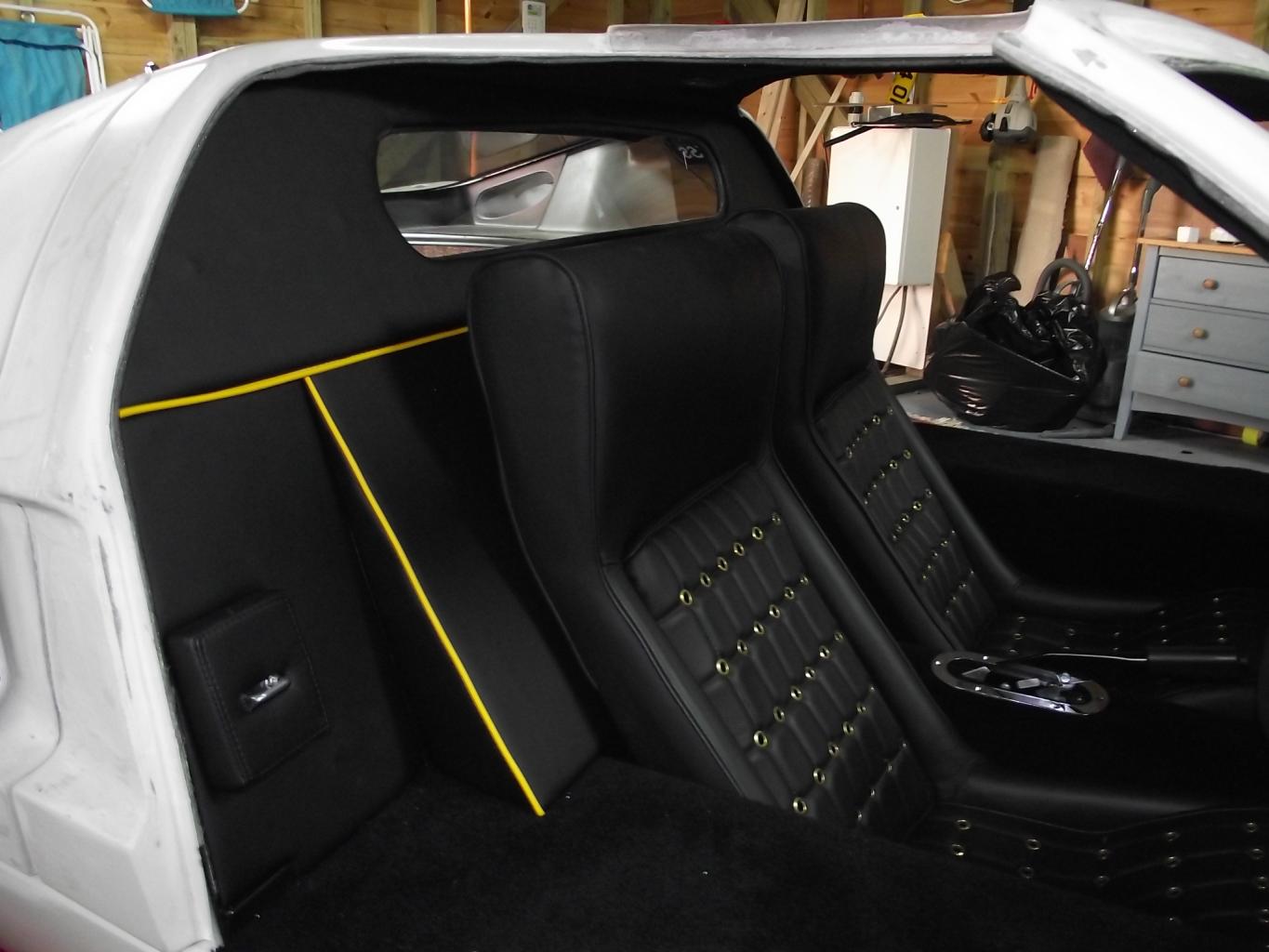

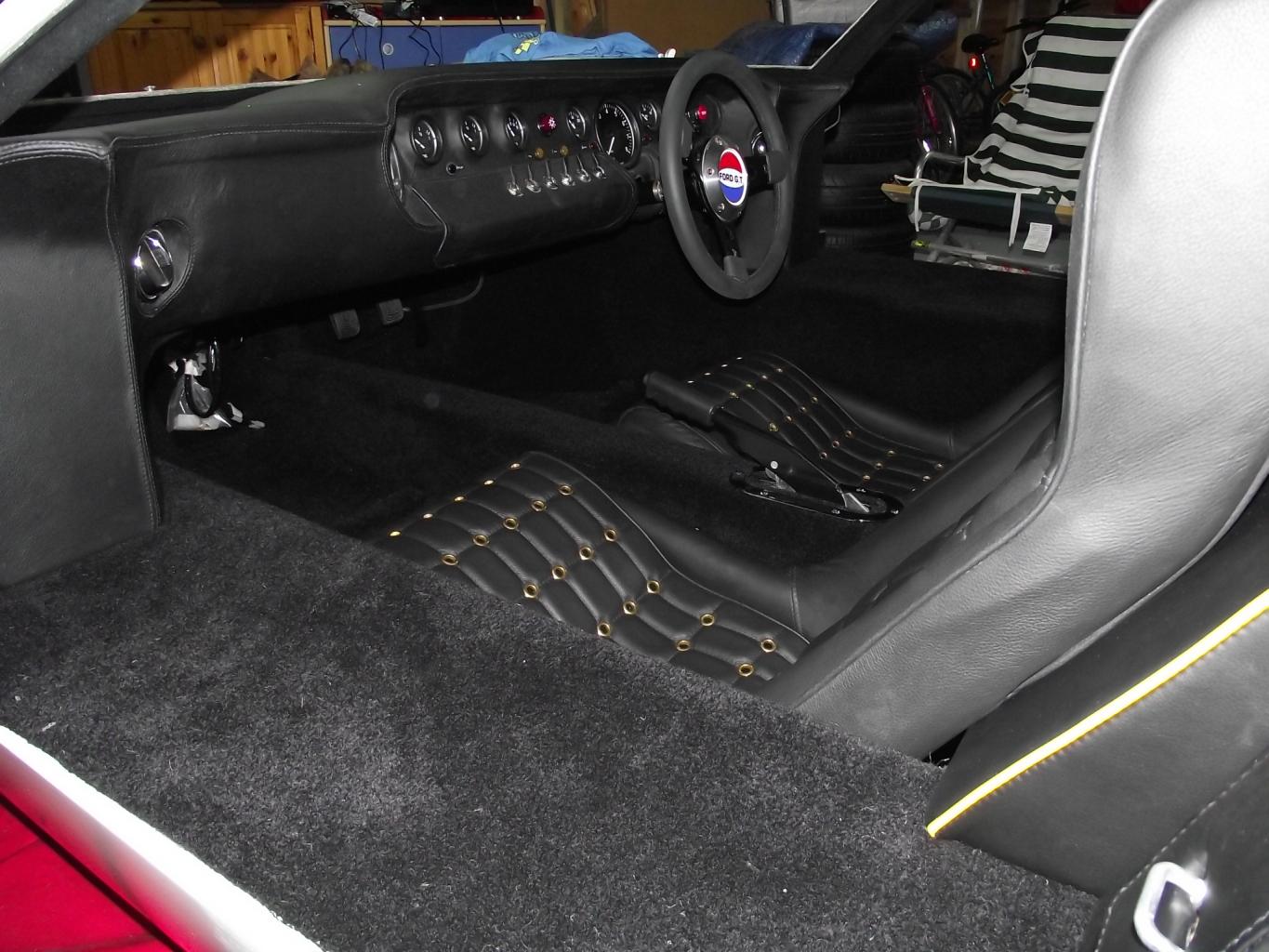

Carpet fitted.

Ian, very nice indeed, glad you decided against the zebra stripe option in pic no. 5:)
I just noticed that the stitching on the dash looks just like that on my Dax
Dave
Hi Ian
Great job, the build is looking fantastic.
Just wondering what seats you are using. I know there are some IVA rules regarding headrest size. Are they the new "IVA proof" version Tornado are making?
Jason
Thanks. I bought the seats from Tornado and they are IVA compliant provided they are bolted to the steel cross member rather than to the aluminium floor.
Thanks Ian, thought they were the Tornado ones. I didnt realise IVA compliance needed them to be mounted to steel cross pieces. Ive got my own Tornado kit on the way but its got the lowered floor so hopefully that will comply.
Jason
