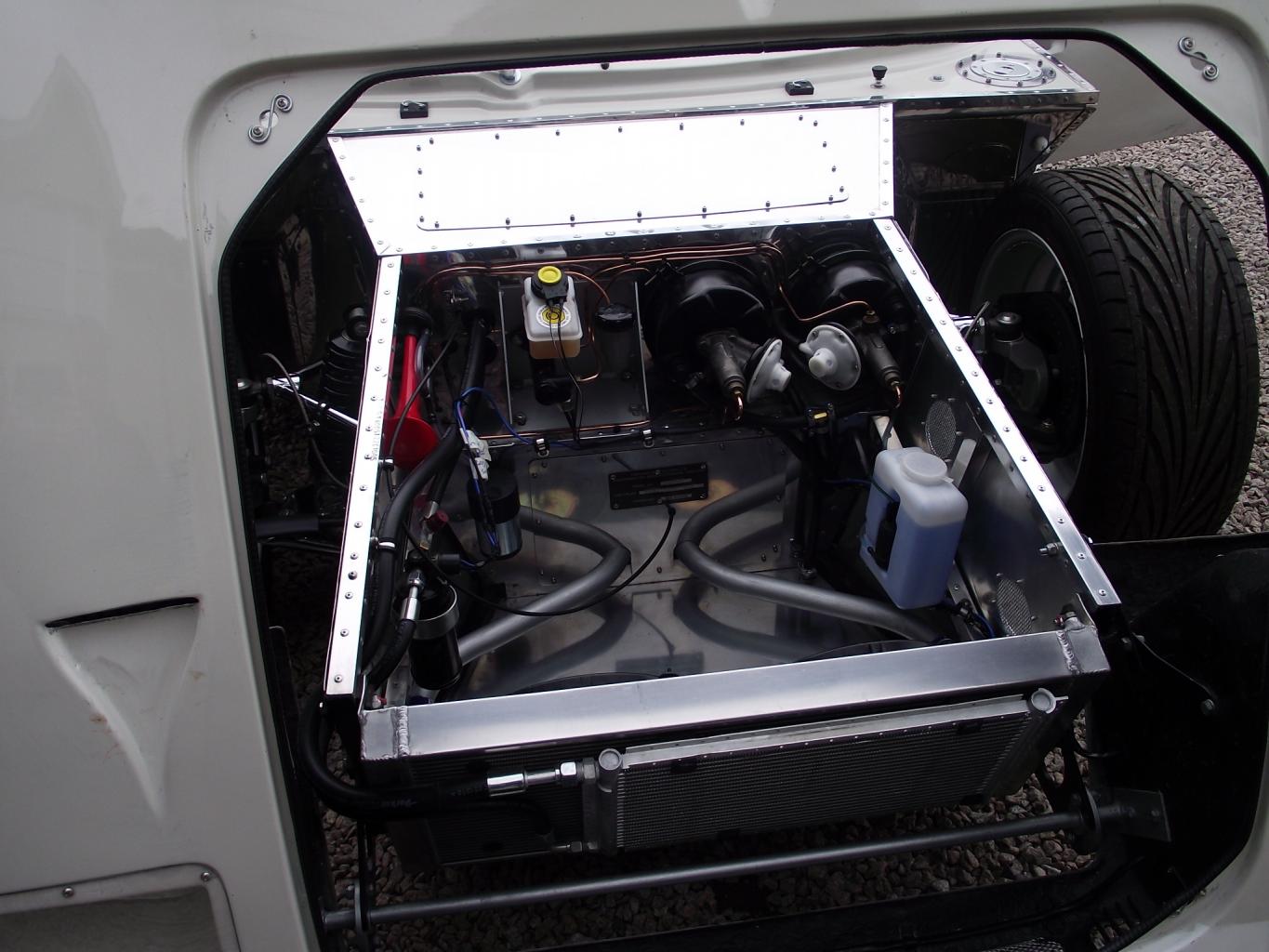

I'm finishing off a Tornado with double nostril, which like yours is half depth, rather than mod the nostrils, I was thinking of putting an ally deflector place at the bottom of the rad to push the air up and close off the air flow to the front bay. I also plan to have vanes to deflect the air in the centre (of the plate) over to each nostril, what do you think?

If you do as you say it will decrease the flow of air through the radiator. I am sure my setup is decreasing some flow, but yours only goes down about half way. Mine starts the curve further back and the air is better allowed to exit. Take a look at my pics again.

Would love to see more pix of yours, i noticed (i think) a small deflector flap you have at the bottom of the rad. I realise that fundamentally the nostril size is an issue.

Here are some old pics that I came across. They are from the "construction' phase just before it went to the painter, and some other shots I came across.
Notice that the nostrils have been cut back further than the original opening. You want the slope to be even and not steped. The one thing you don't want to do do is create a situation whereby you cut down on the amount of air going through the radiator. I don't know how tight your bonnet is, so if you create a dam to not allow the air beyond the nostrils, you will be blocking any "alternative" pathways that are present without the dam. Mine is pretty tight and at one time I had rubber seals between the upper rails of the sides of the frame that sealed up against the bonnet itself. So I had little else to expell any air that didn't go out the nostrils. Thereby making them as big as I could. My dam is there just to block the heat transfer to the footwells. It is made of 1/8" thick rubber mat. I used common L brackets to support them. I also super insulated the footwells with Dynamat 1/2" I believe. On long trips my feet don't get the least bit warm.

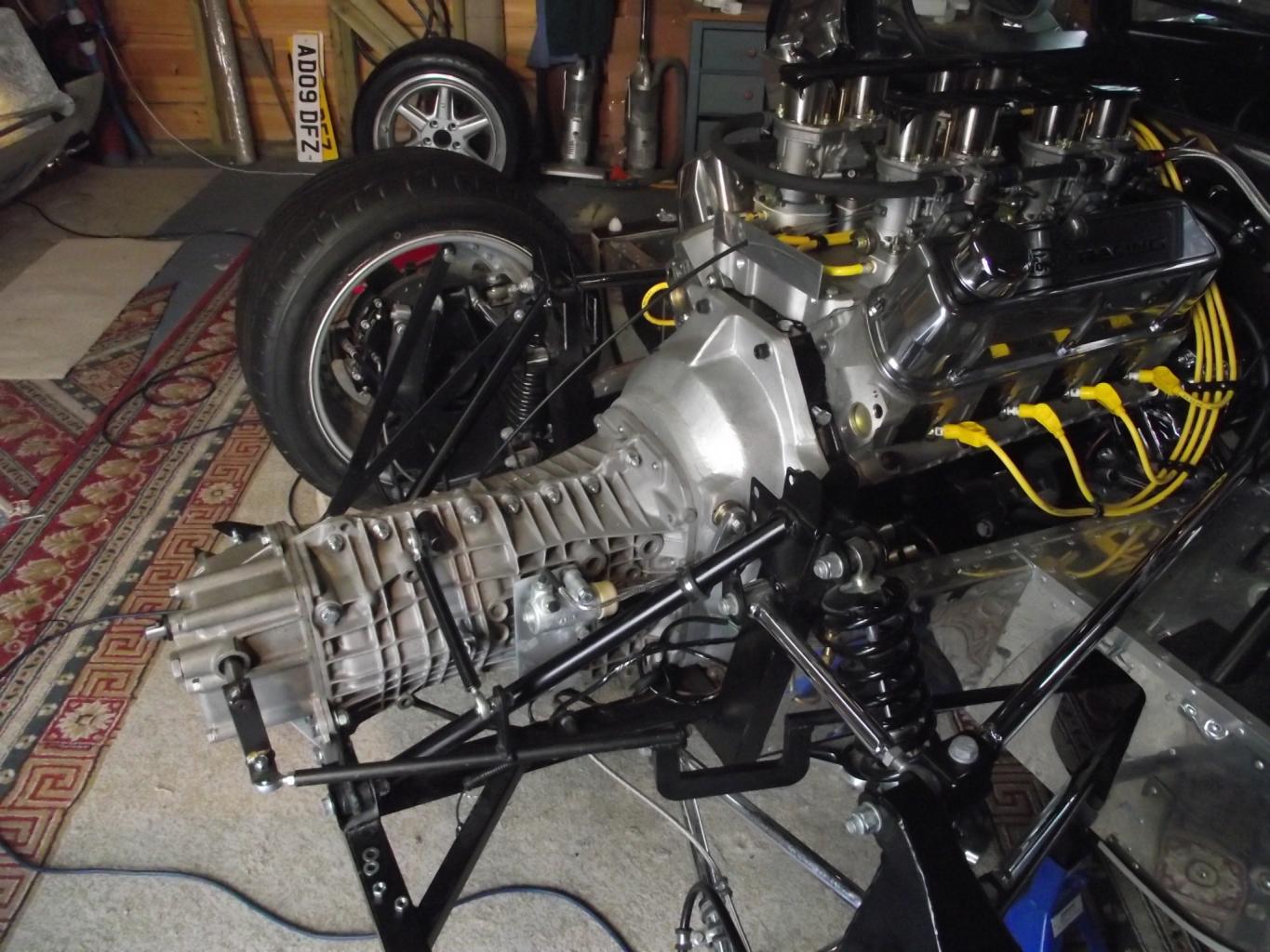

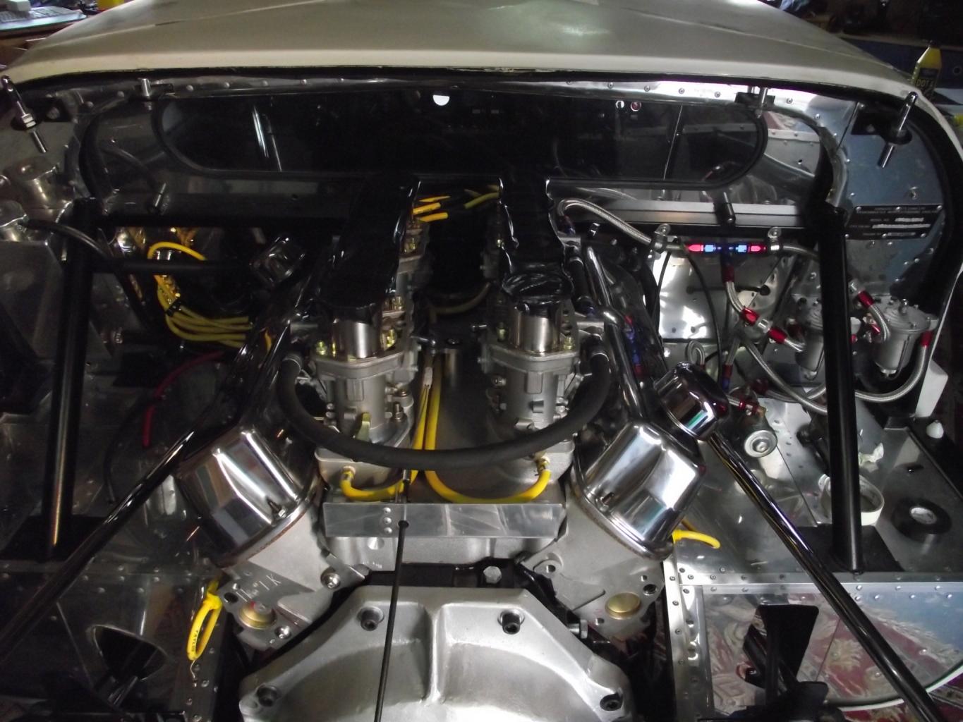

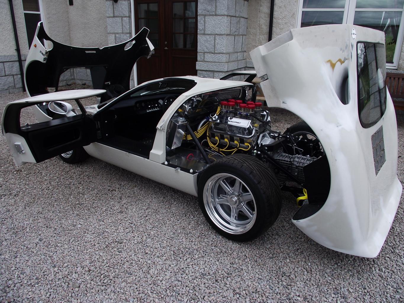

Gear shift mechanism fitted, all working nicely. Filled the system with Castrol 4Life water, took around 17 litres. There were a few leaks as I was filling up but they were limited to a few loose jubilee clips only, once tightened all leaks went. Filled up the offside petrol tank and calibrated the level sender. Started to fill the nearside petrol tank and realised I had a leak, but again it was a loose jubilee clip on the fill nozzle; harder to fix but fortunately I fitted access holes in the front wheel arch section so this made it more manageable. All final wiring is now hooked up and the car is pretty much ready for its first start. Apart from the noise, heat (and toxic gas accumulation), is there any reason why I should not start the engine without the exhaust e.g. can the lack of backpressure damage the valves/engine?

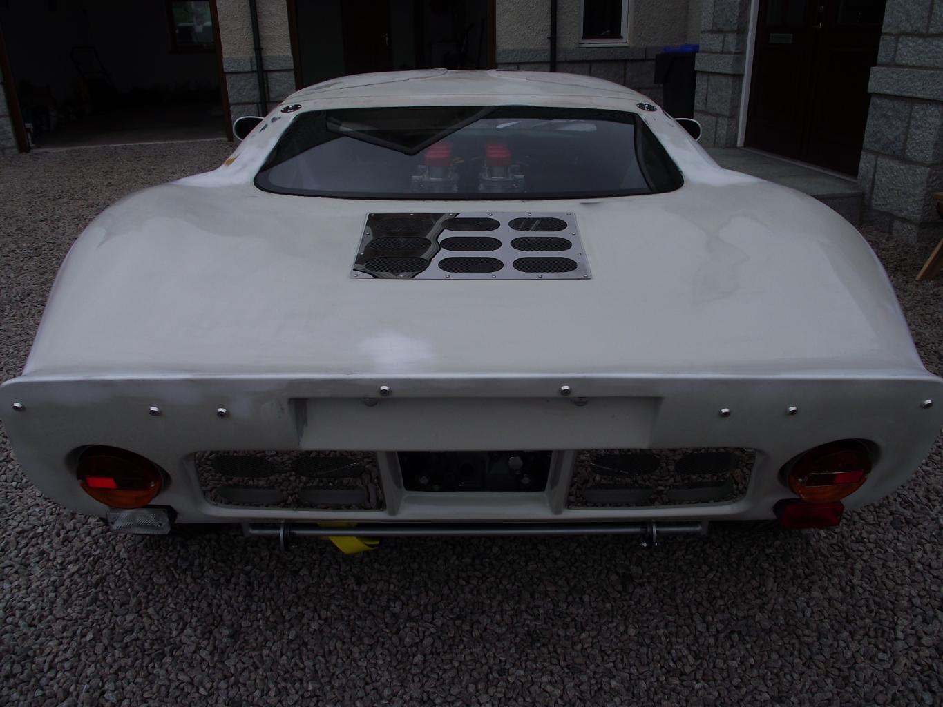

What did you use for the rear clam locators?

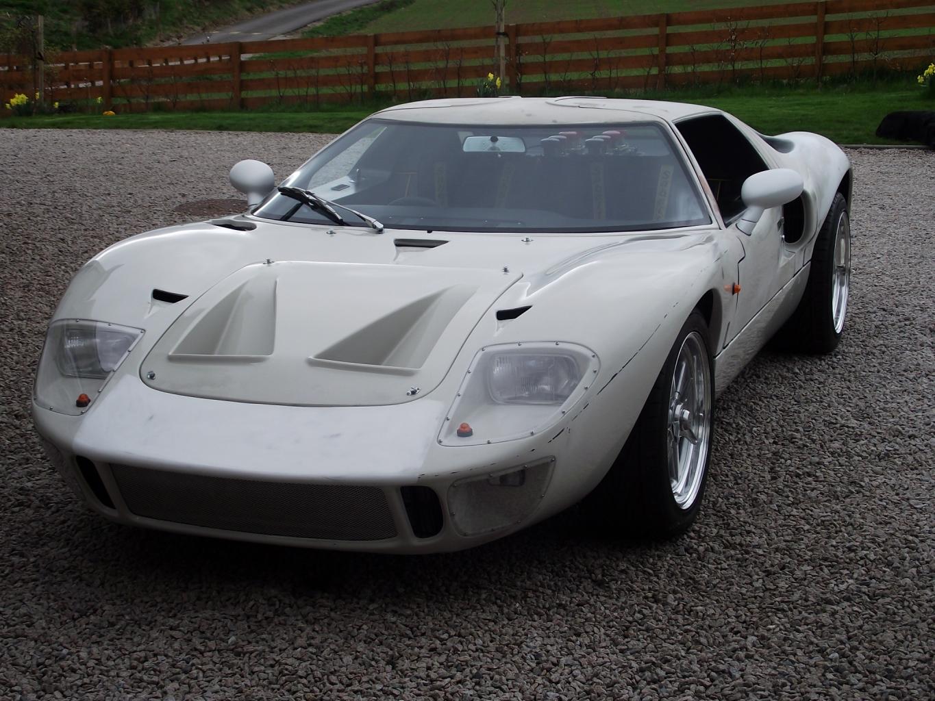

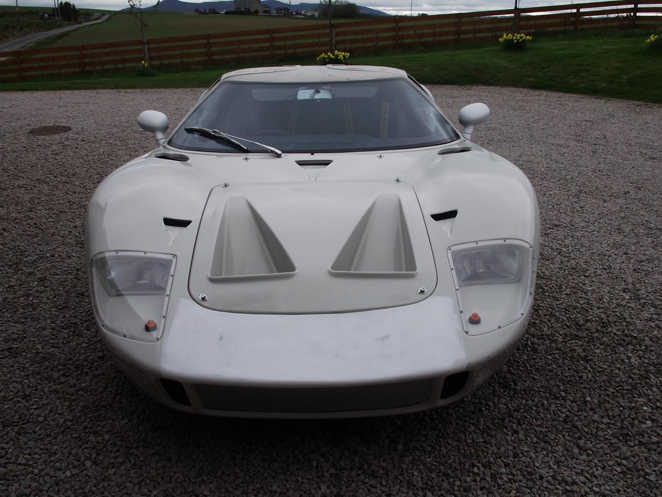

In a couple of weeks the car will be sent down to Andy for its IVA. He is also going to fit the exhaust, drive shafts and change out the valve cover for the Gurney cover that Tornado supply. All I'm left to do is align the headlights..........meanwhile, the car has now moved up from the workshop to the house:pleased:
