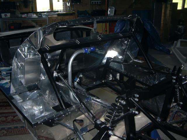

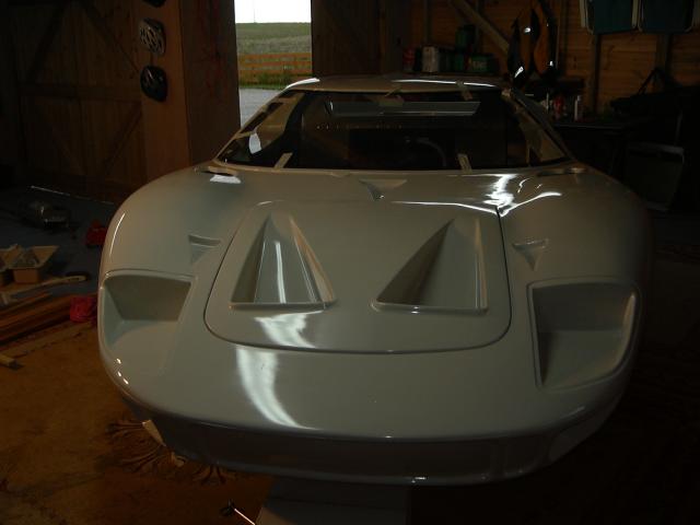

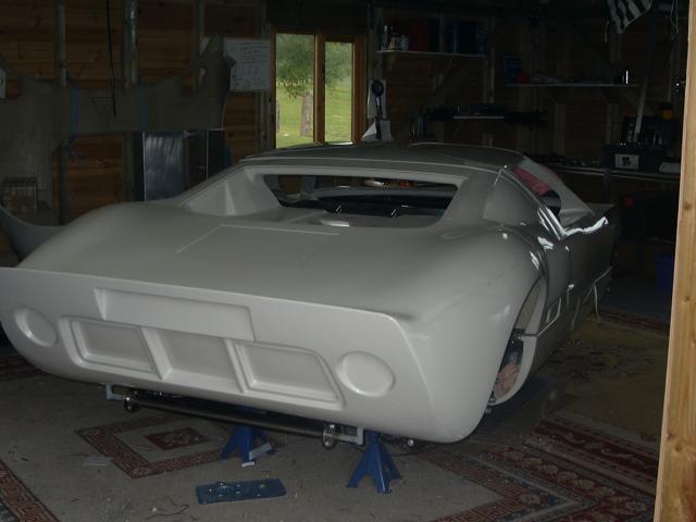

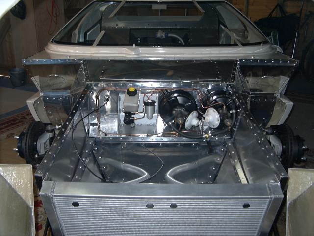

Got the rear clip fitted yesterday although I still have to bolt the roof spider to the top of the roll bar plate. Also rough trimmed the doors ready for fitting the front apron and then the front clip.

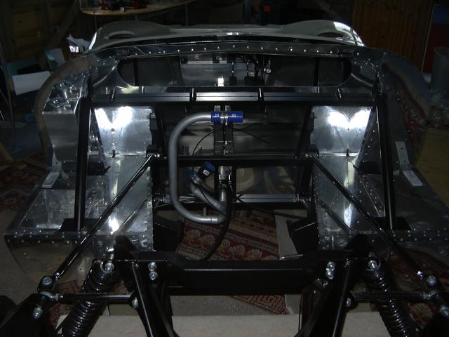

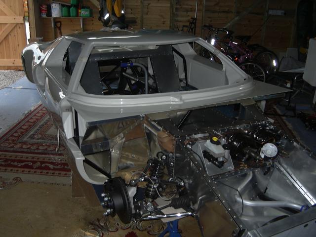

Fitted the front clip last week which required to temporarily locate the front windscreen in position. This weekend managed to fit the rear bulkhead panels and the water expansion tank. Was a little tricky to fit around the rollover bar so pushed my petience a little..........

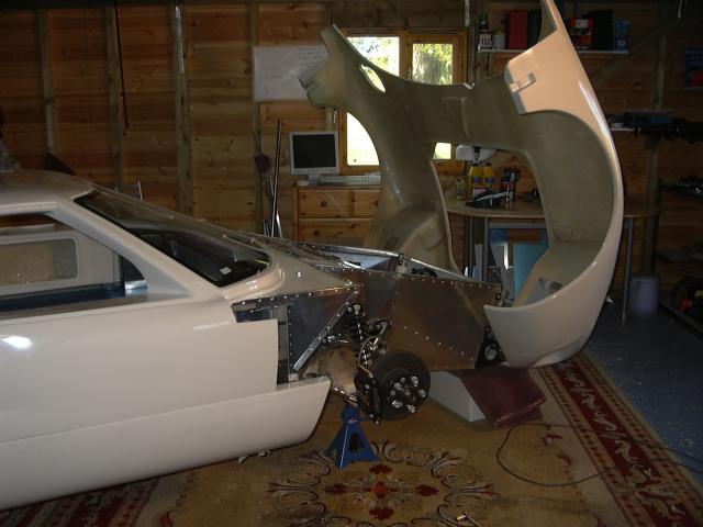

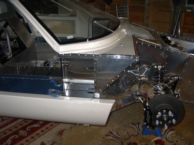

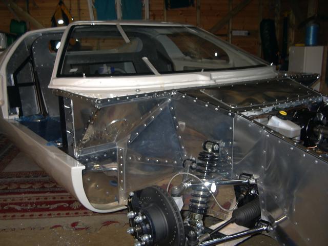

Finally got the rook spider fitted and the apron riveted in place along with all the aluminium angle to tidy up the finish. Fitted a couple of access plates to the wheelbay front panels as well which will allow me to access the fuel tank caps so that I can remove when the car is painted. Also prepared the door recess panels but wont install these permanently until after I have fitted the doors.

Hi Ian,
For the IVA test you’ll need to panel & seal the fuel filler neck area from the passenger compartment. Make this panel(s) removable and it will complement the access panel you added to the front wheel arch panel.

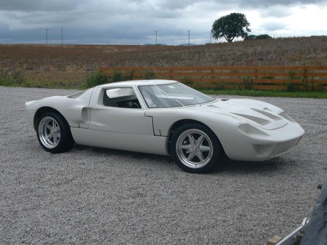

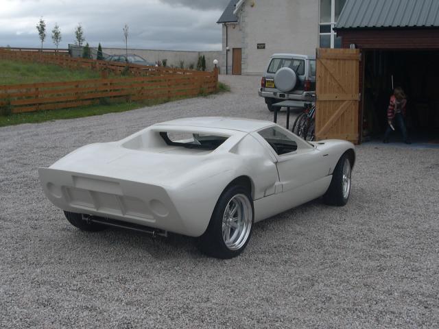

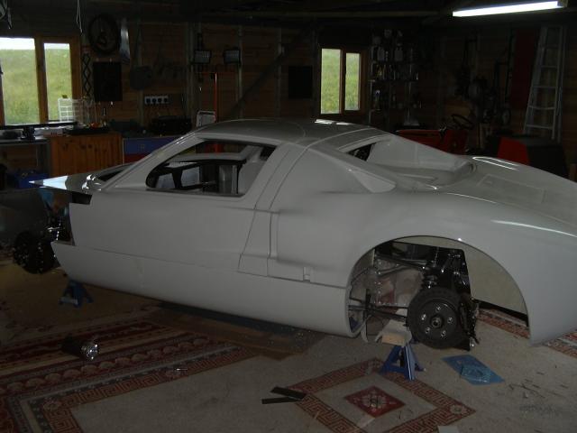

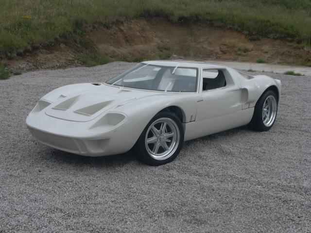

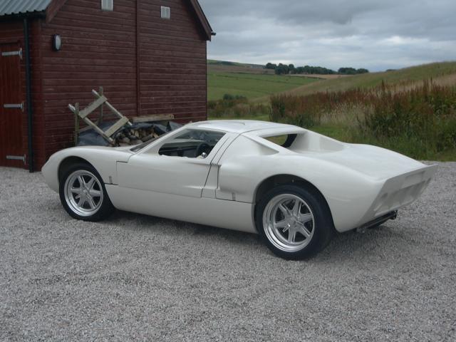

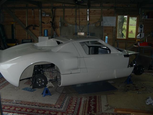

The car took its first glipse of the sun today, well almost! This is Scotland so its all relative!! It means that I can move it now to make space ready for the body work which is my next job.

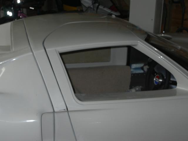

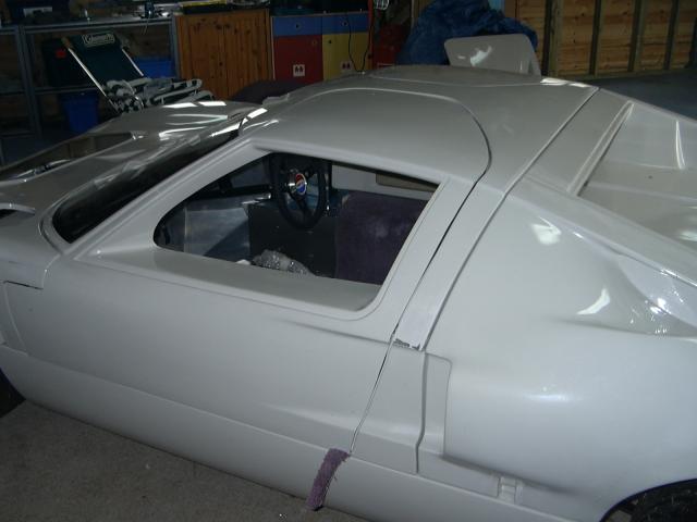

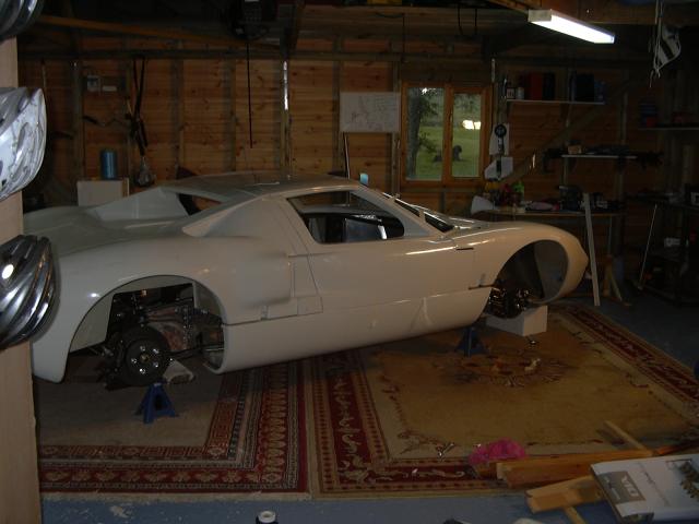

Got the doors prepared this weekend using 'the bits of old carpet' technique! A bit of finishing off still needed to some of the edges but I have decided to do this after I have hung the door then I can match the gap to the door frame. I'll hang the door after I have installed the door latch.

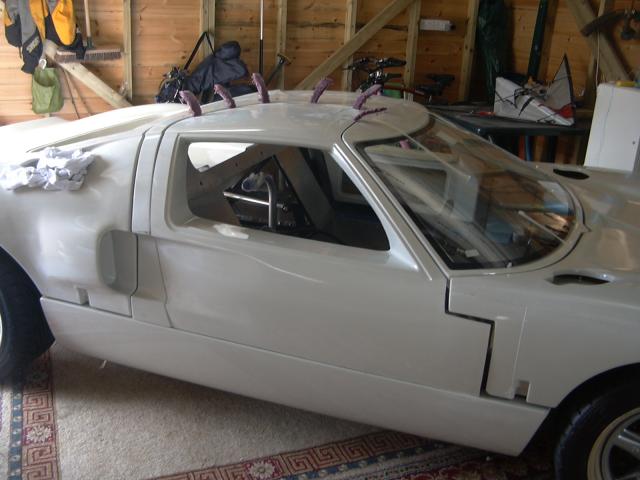

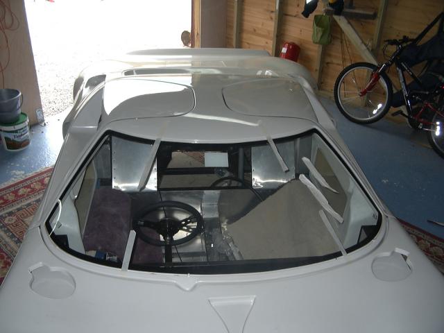

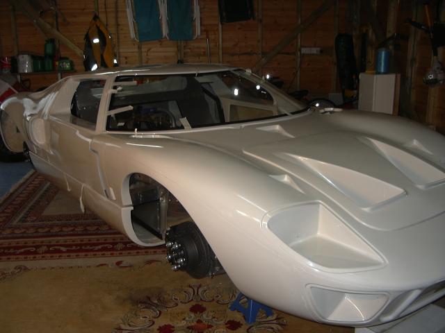

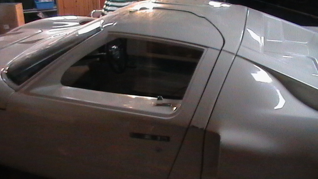

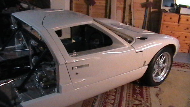

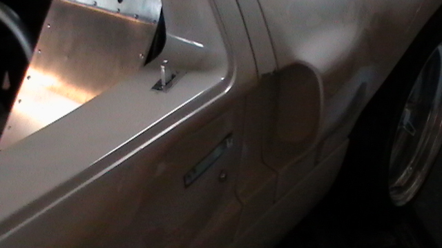

Fitted the door catches, locks and release handles. Also prepared the roof top ready for fitting after the door is hung. That'll be my next job.
