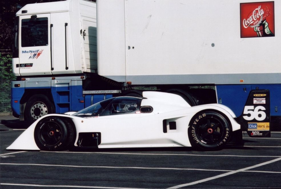

Once the rear wing is mounted, I can get alot better idea of what will look best to fit in the space. I still really like the rear fin idea. More similar to the scg003 though, than a true LMP car. I believe you were mentioning something like that awhile back.

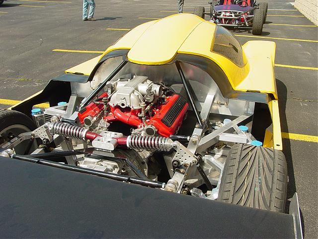

Where it all started.....
I certainly took that a different direction! Haha. I wonder if mine is the original body. I figured out the yellow must have been a wrap. I am thinking my center section was replaced at some point. The returns are certainly different. My front and rear clam reveals where they meet the center section was a bit wonky too, making me think corrections were made to some of the pieces.
Much has changed on mine since those pics!
