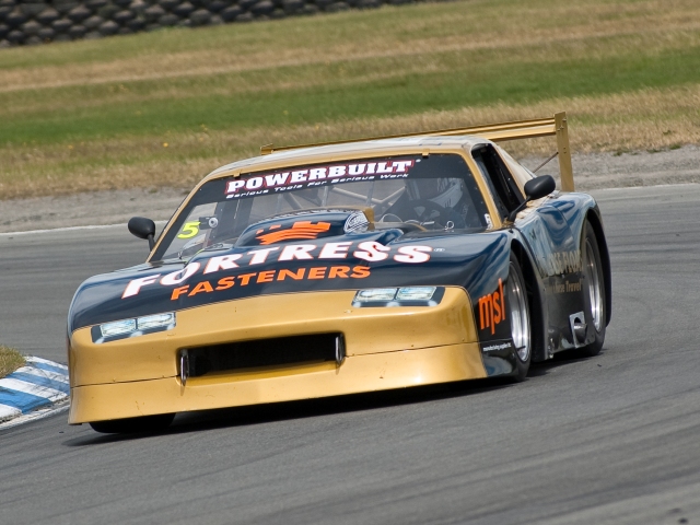

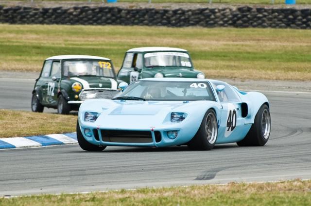

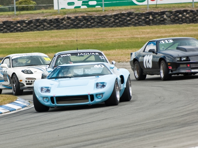

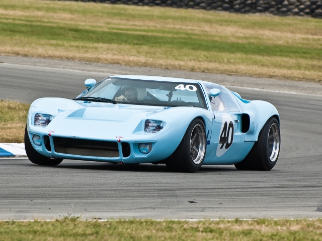

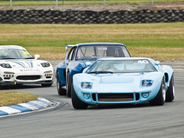

Pics from the Dec 13 Ruapuna meeting. The white RX7 is no slug and was always in close attendance as we came through the field. The car gets better with every race as we continue to dial it in.
Last pic is the fastest car in the field. TransAm Camaro about 1985 vintage, I think, and super quick. I'll have to sprout some serious aero and slicks to get anywhere near him! This is the sort of machinery I'll be up against in the OSCA races in a couple of weeks.

Great job Russ!!!!
Loved the shot of the two Minis dueling for the corner behind you..
Those lights on your car - Decals?

Great progress on the car. That first pic of coming through the corner with a little squat and power on is my most favorite pose of any GT-40!!
Russ,
Bill,if you have a closer look on the 2nd photo, after cornering you will noticed that the door top starts to lift once it head on the straight. :shocked:

Yes Randy, good eye for detail, they are indeed decals that we fitted the night before. Still doing the finishing touches along with sorting out the problems and setup. This week I hope to tidy up the body a bit and give it a Navy Blue stripe and moustache as well as getting the drive train and suspension re-installed and de-camber the front wheels a little more.
The guys in the Minis are out there every meeting going hammer and tongs. They have a ball!
Bill, I like that first pic too, and the car feels as good from the inside as it looks from the outside. Have emailed you a hi res copy of that one.
Most of the pics are taken in a slowish right hander, maybe 60mph and there is no door lift, the pic with the door lift mentioned by Lim is coming onto the main straight at about 85 mph. The lift is probably a lot greater at the end of the straight which is about 160+ mph. I'm not really sure of the actual speed as the sweeper off the end of that staight is a bit bumpy and it's more important to try and keep it on the track than to distract my concentration by looking at the tacho!
The interesting thing is that the door lift is totally un-noticable from inside, I'm not sure whether to do anything about it, or leave it as is, since there must presumably be a beneficial effect on cockpit cooling and ventilation.
