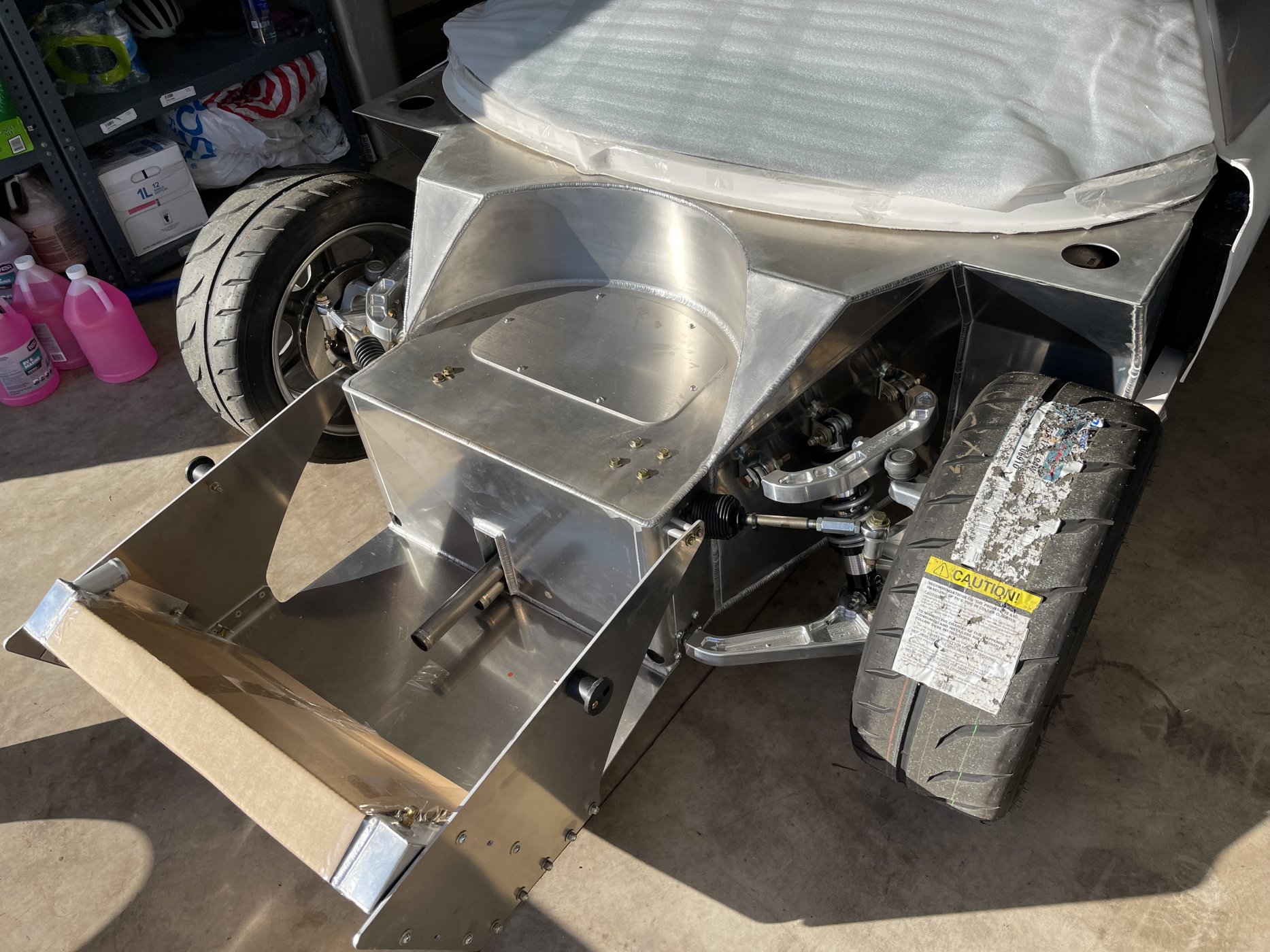

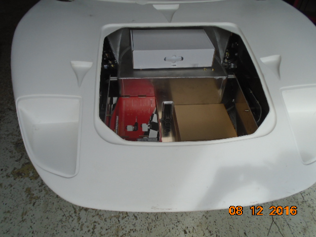

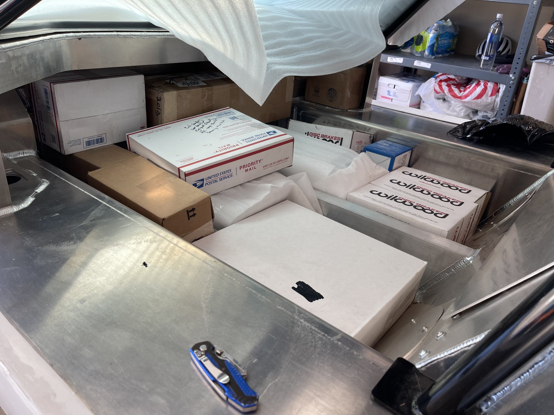

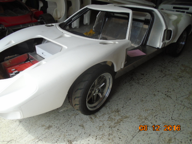

Im pretty excited today. I finally got an email from RCR stating that they are waiting on 1 fuel tank and then packaging the car to ship. Bill was nice enough to send me a couple pictures.
Chet Zerlin
Sean, congrats on your car being so close to ship! Wait until you see how Bill packs everything into the car for shipping. I don't think he leaves any air inside!

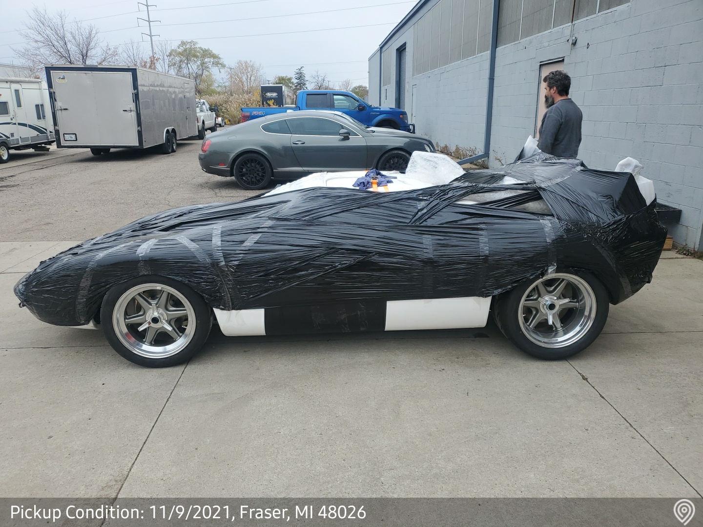

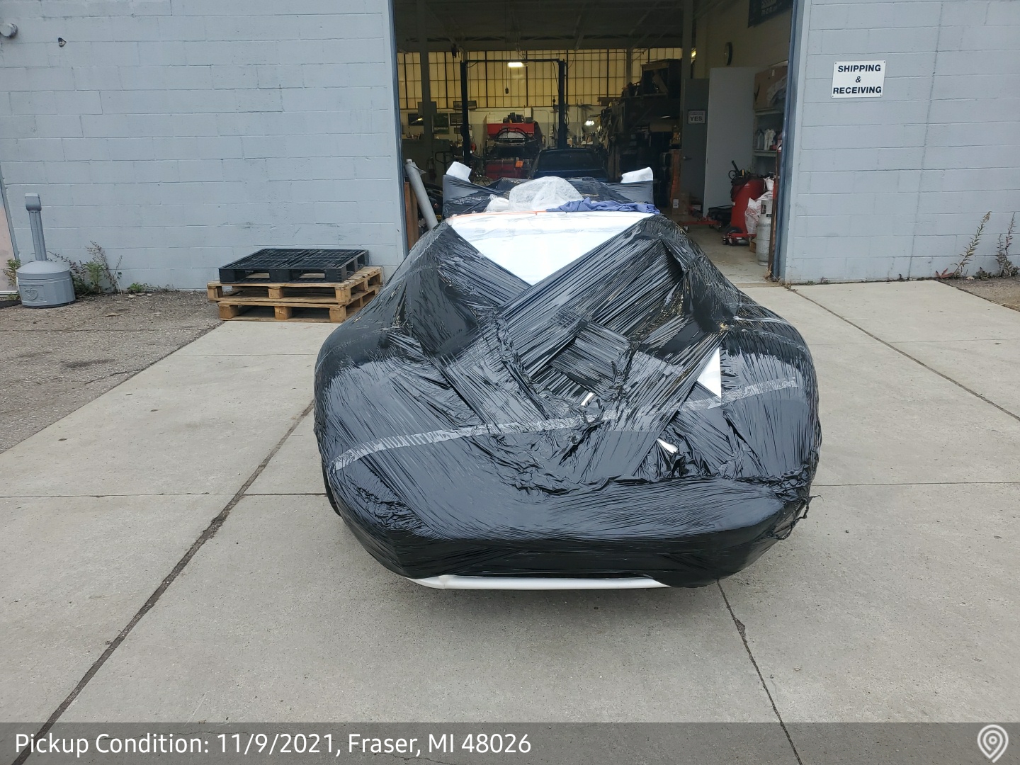

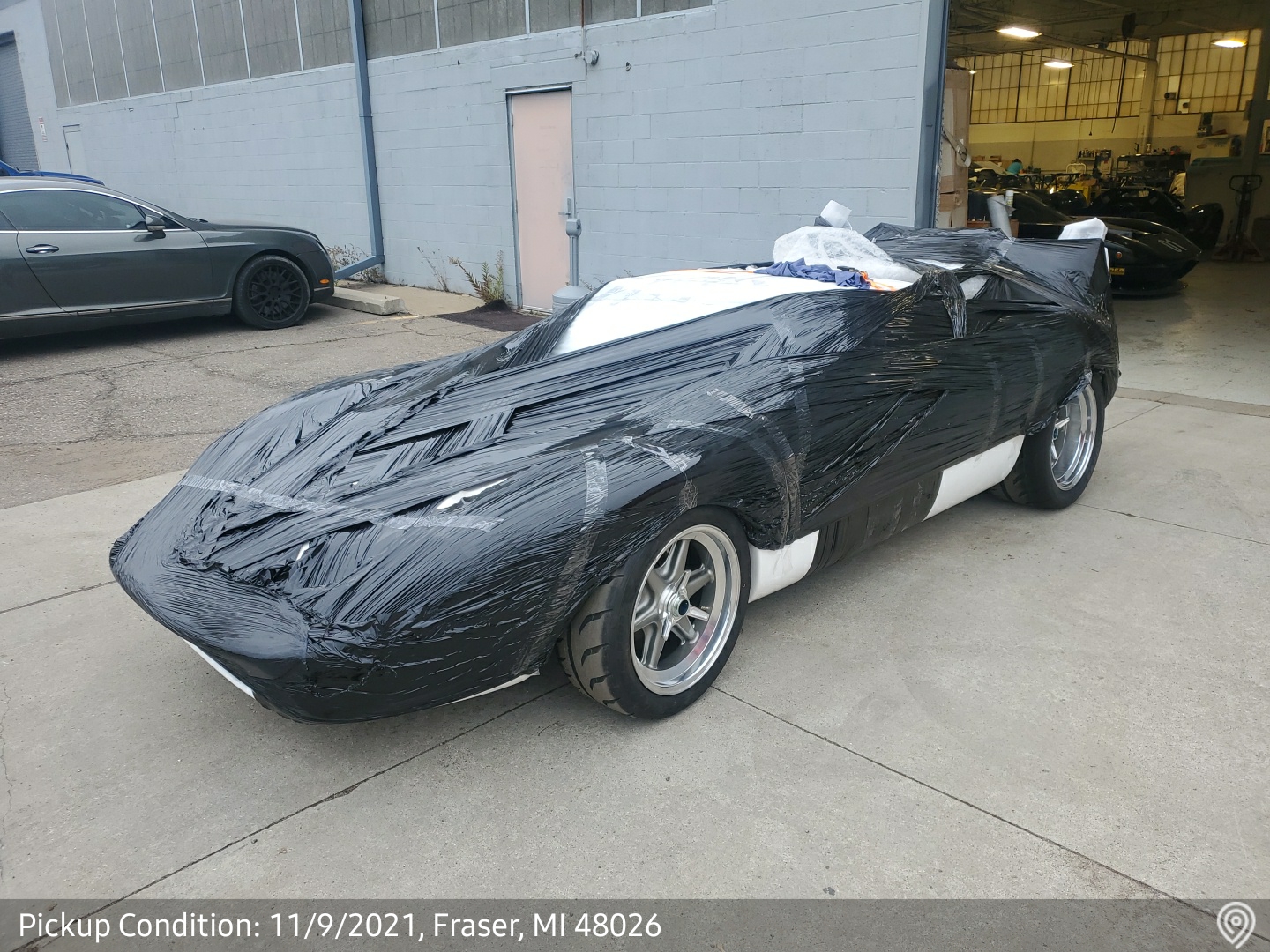

Well its taken a long time, but she is finally loaded on a truck heading my way. Hoping to take delivery tomorrow evening.
I would definitely suggest John York with Beacon Shipping Logistics if you need to move a car. He kept great communication and got it picked up in 4 days.

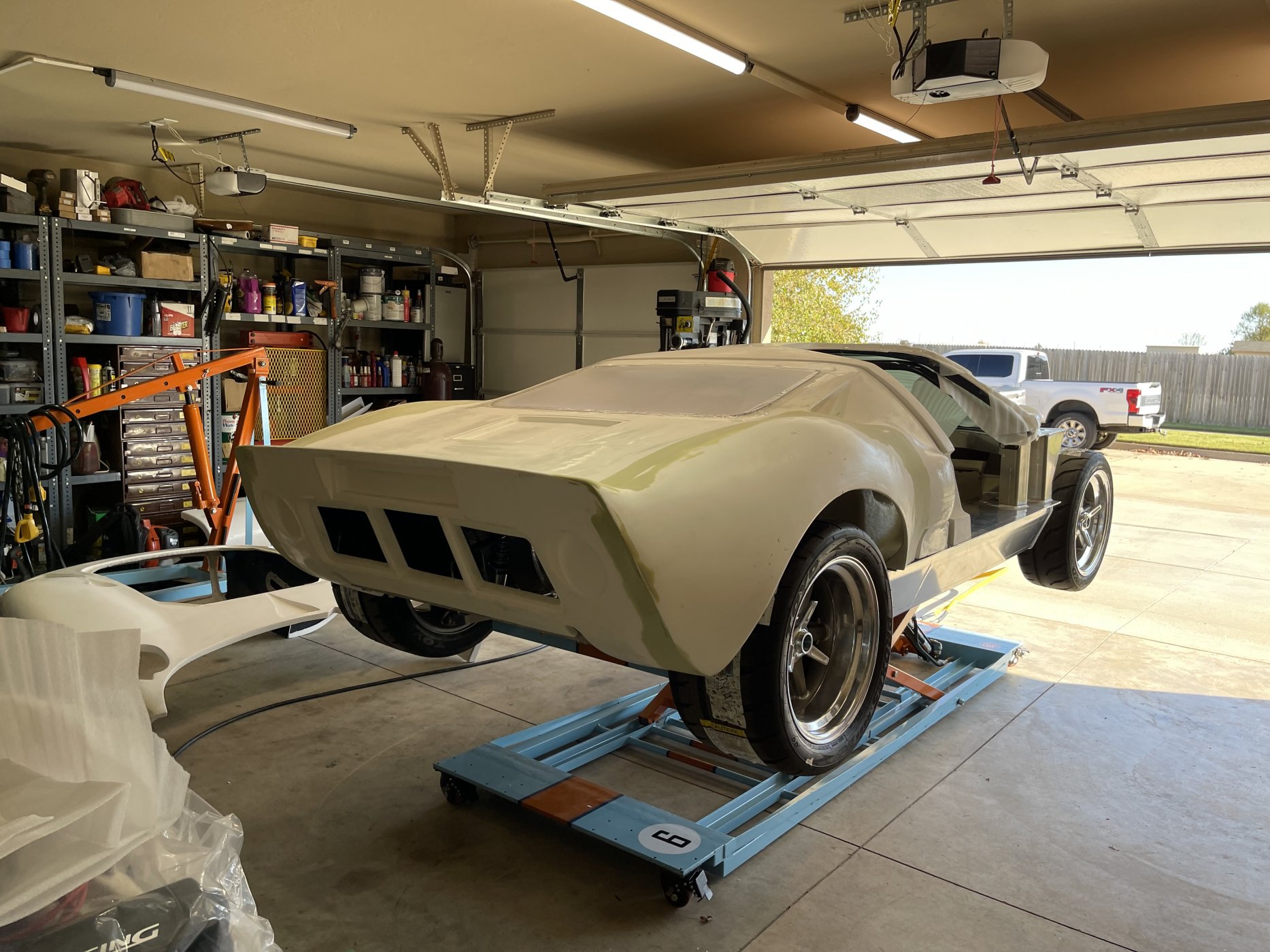

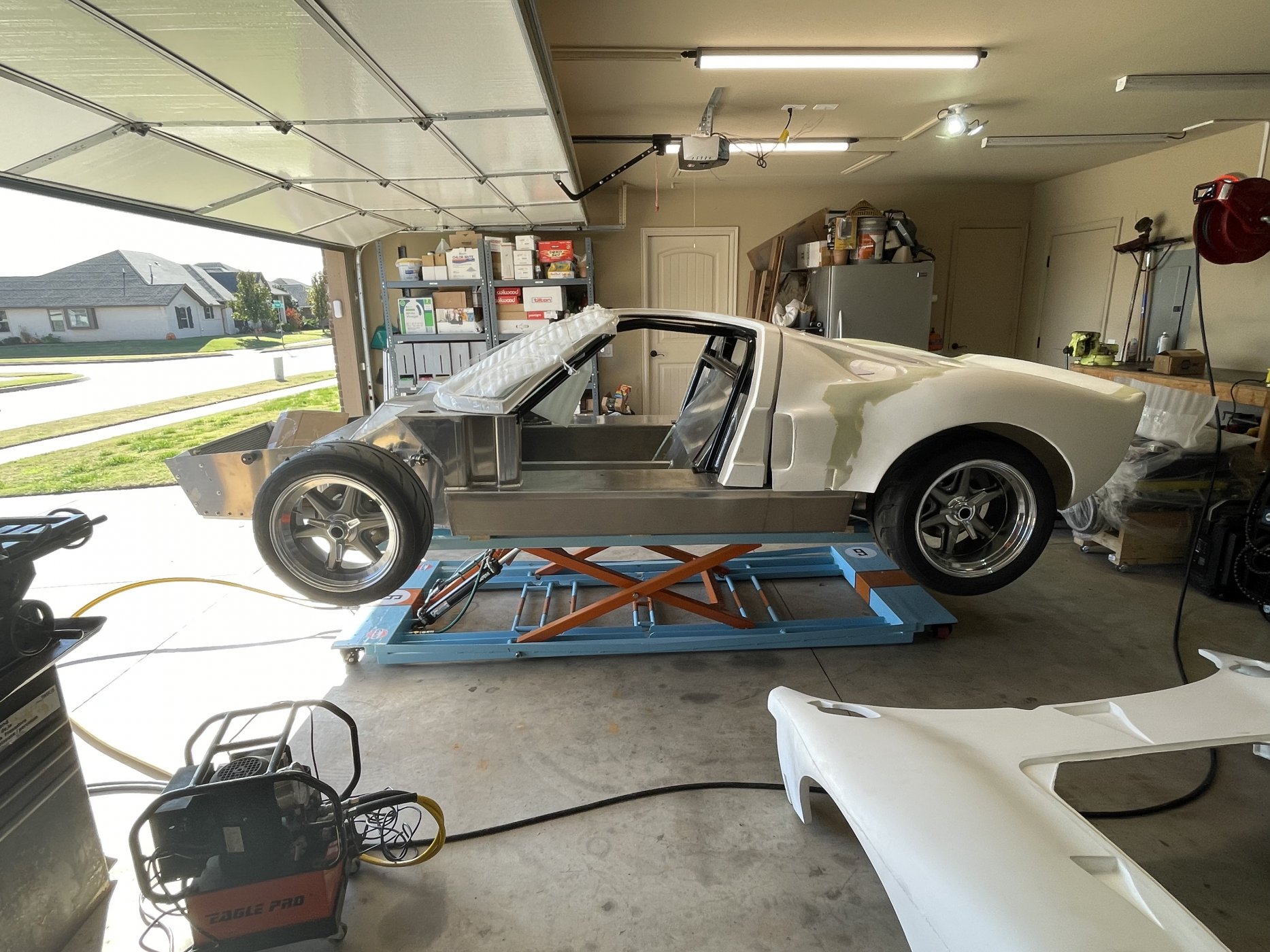

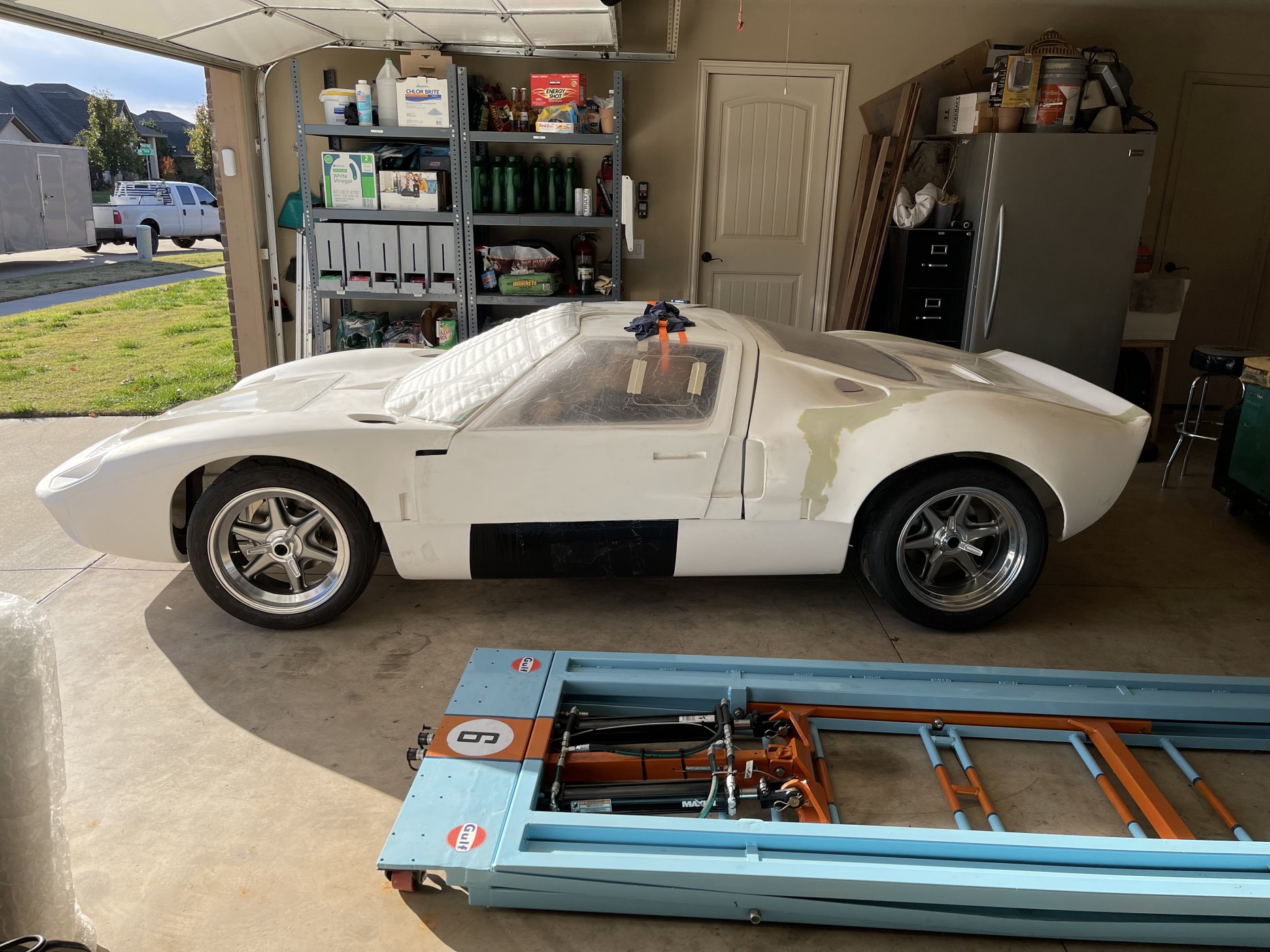

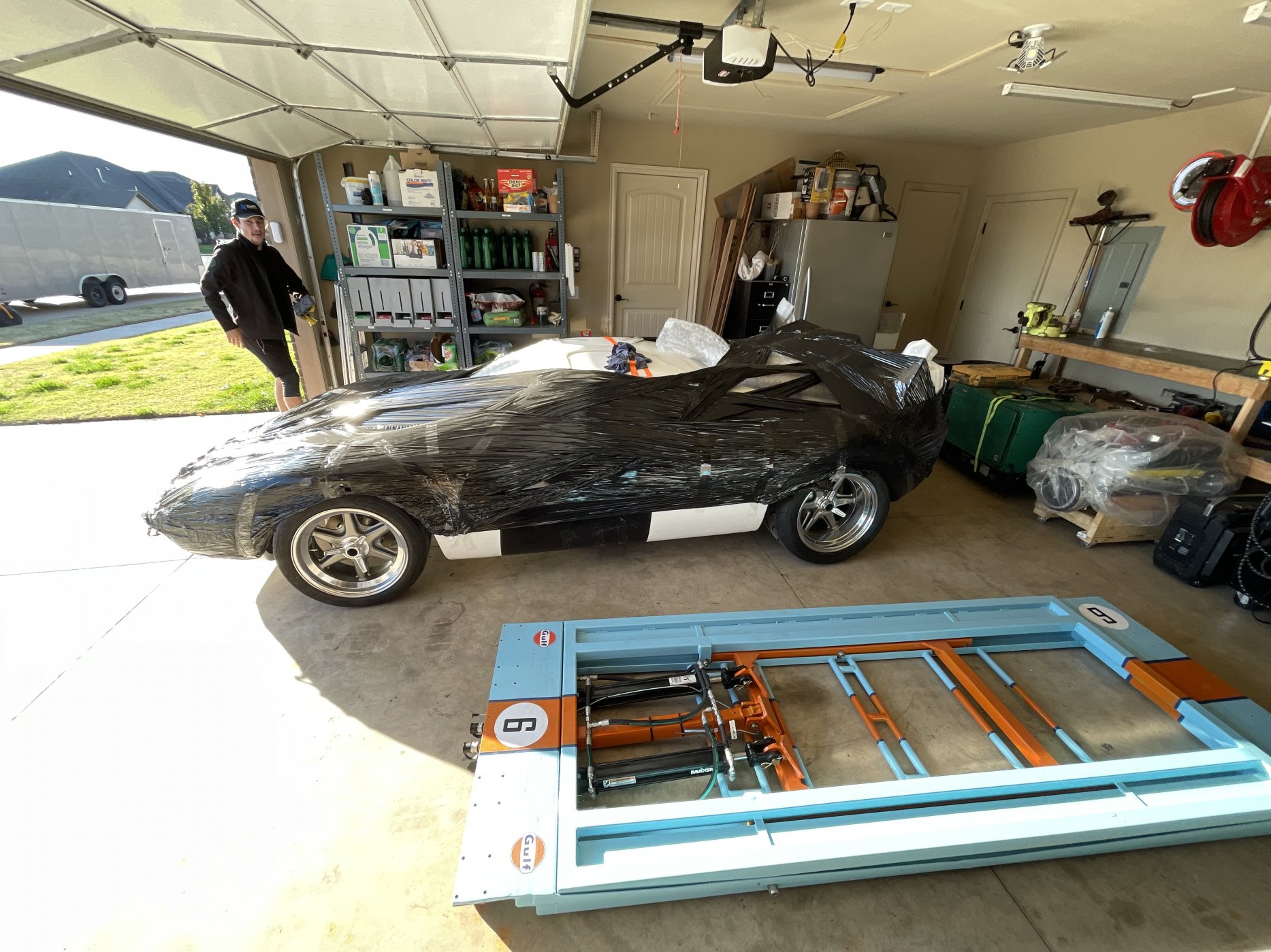

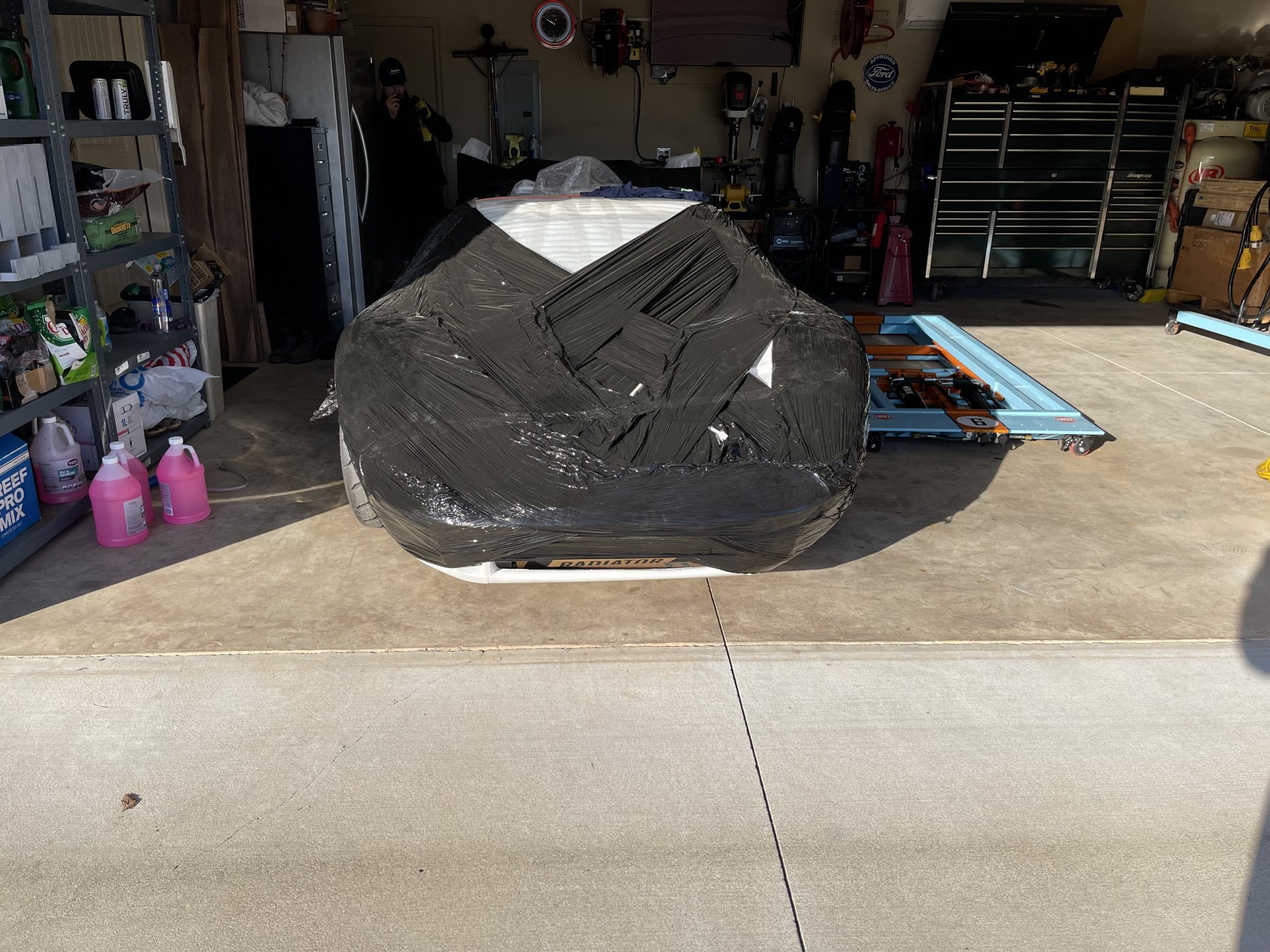

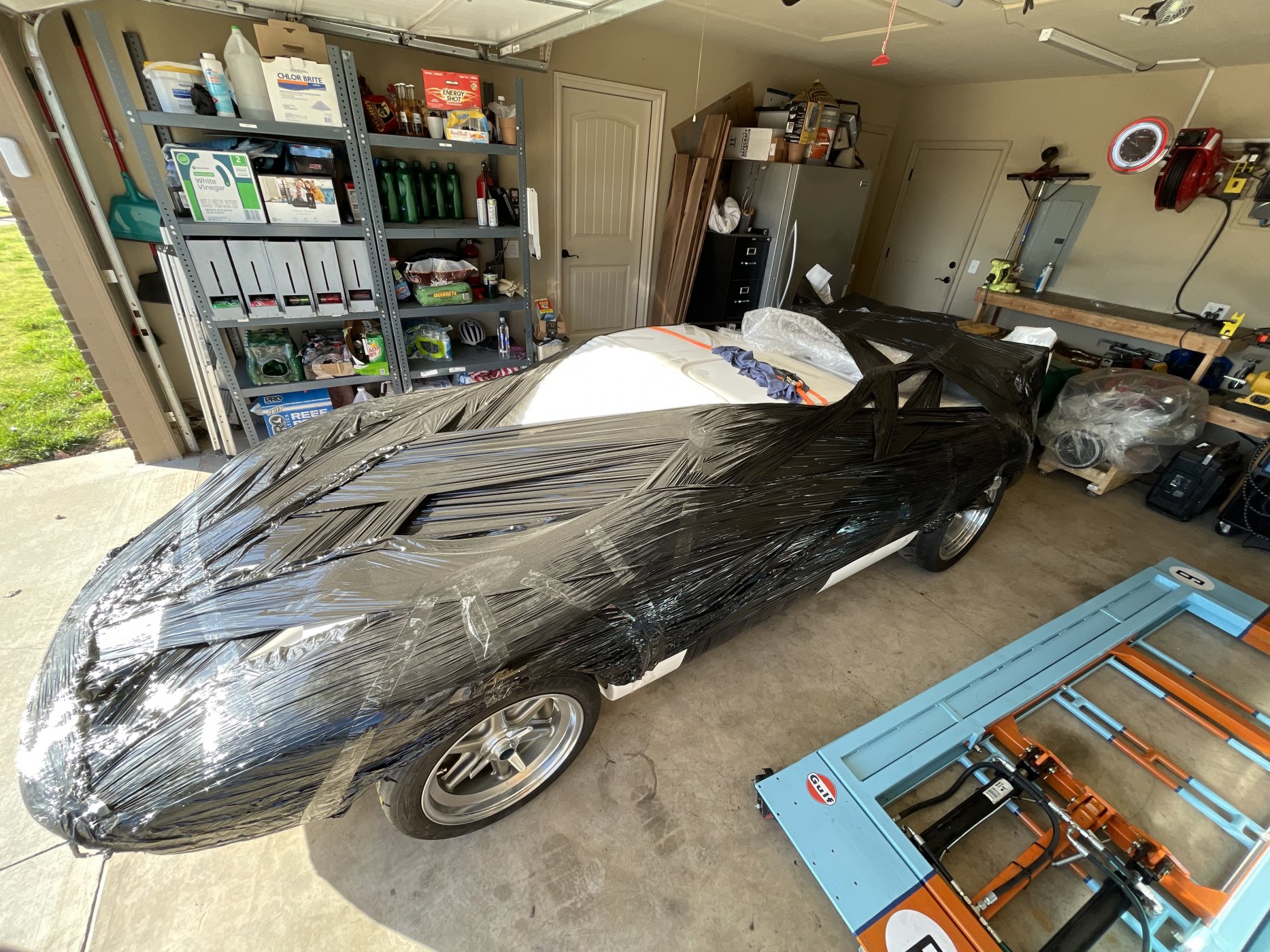

Sean Starkey

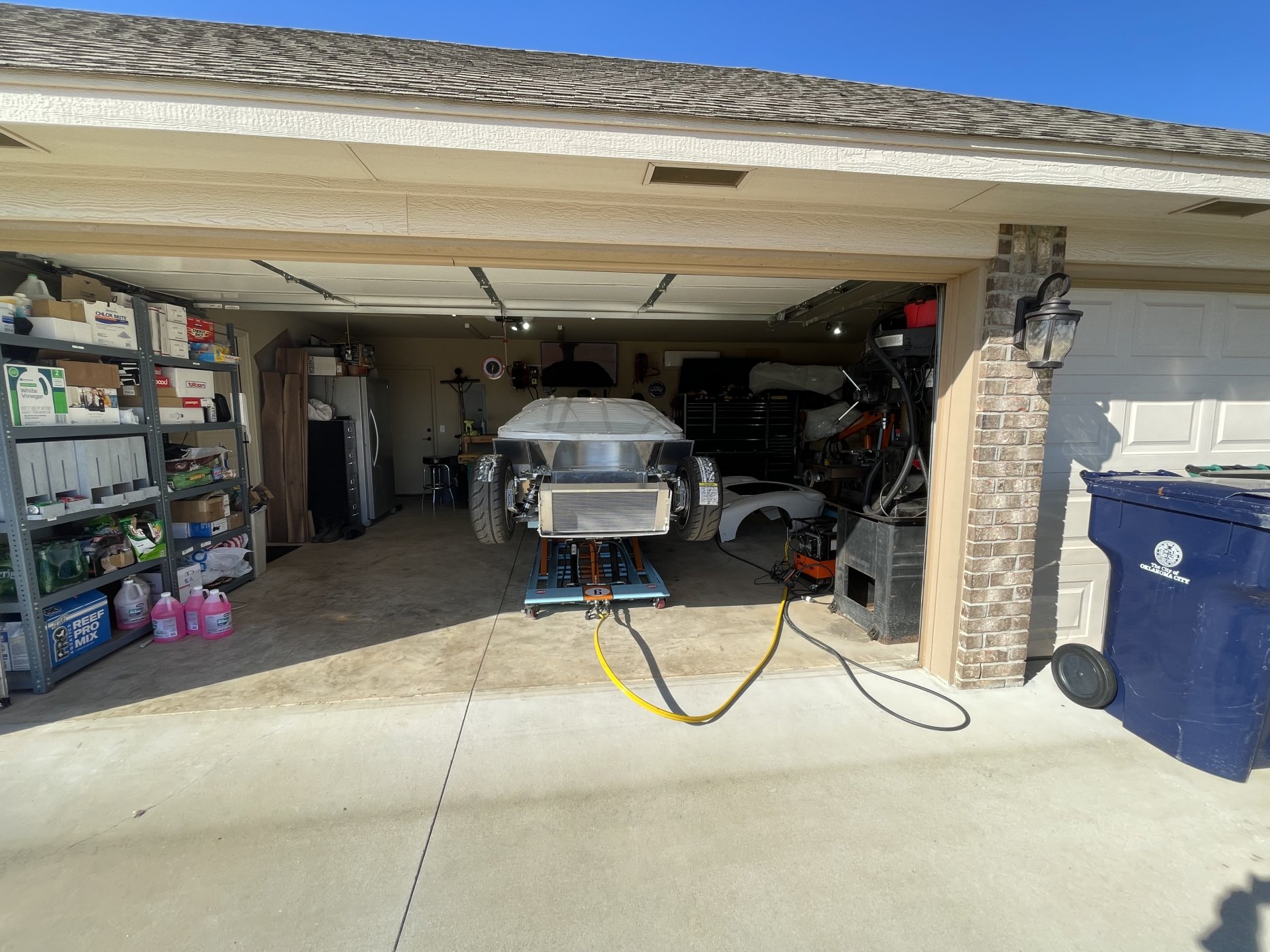

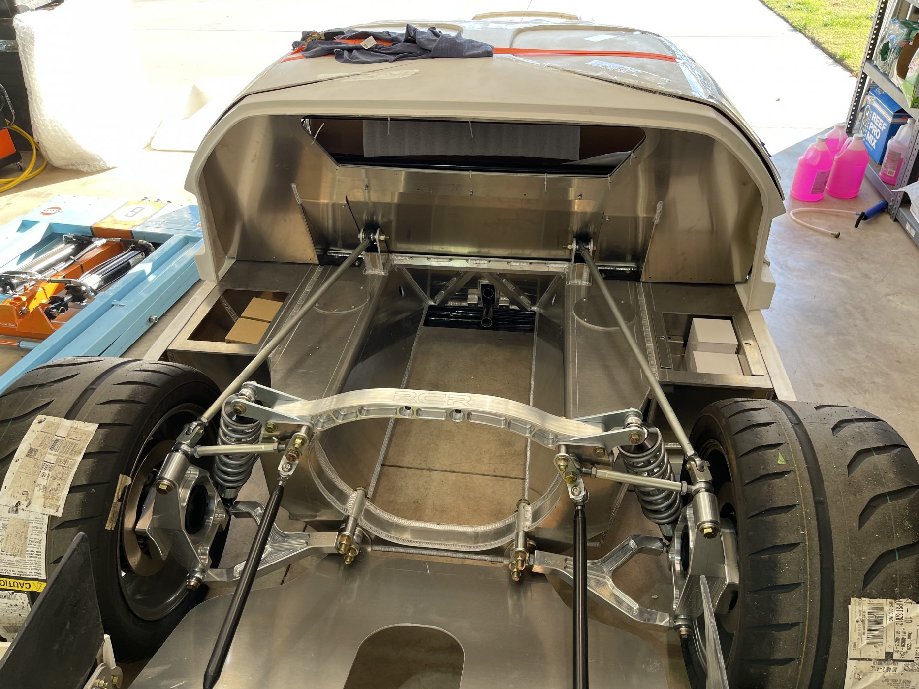

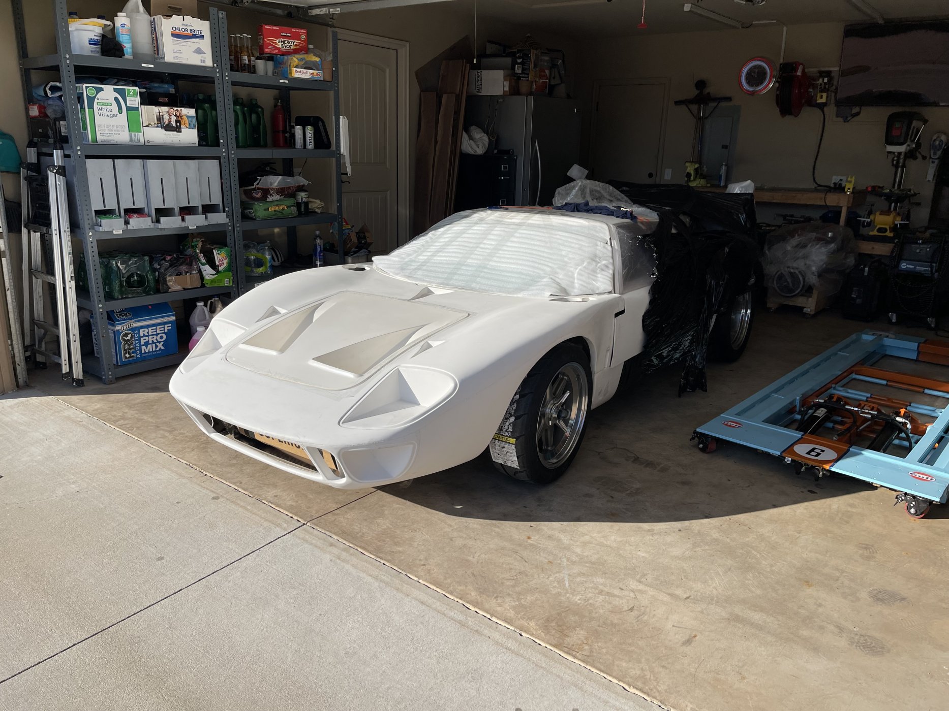

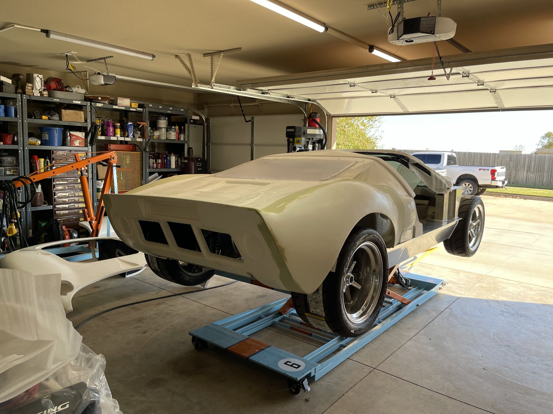

Its been a long wait, but now I can finally say that I own one.

Congratulations!
Don’t wait too long to put a support brace under the center of that spider or it will sag and take a set - causing you no end of frustration later..

Thank you Randy, I hadn't thought of that. After reading your build site it looks like you had a few headaches with it.

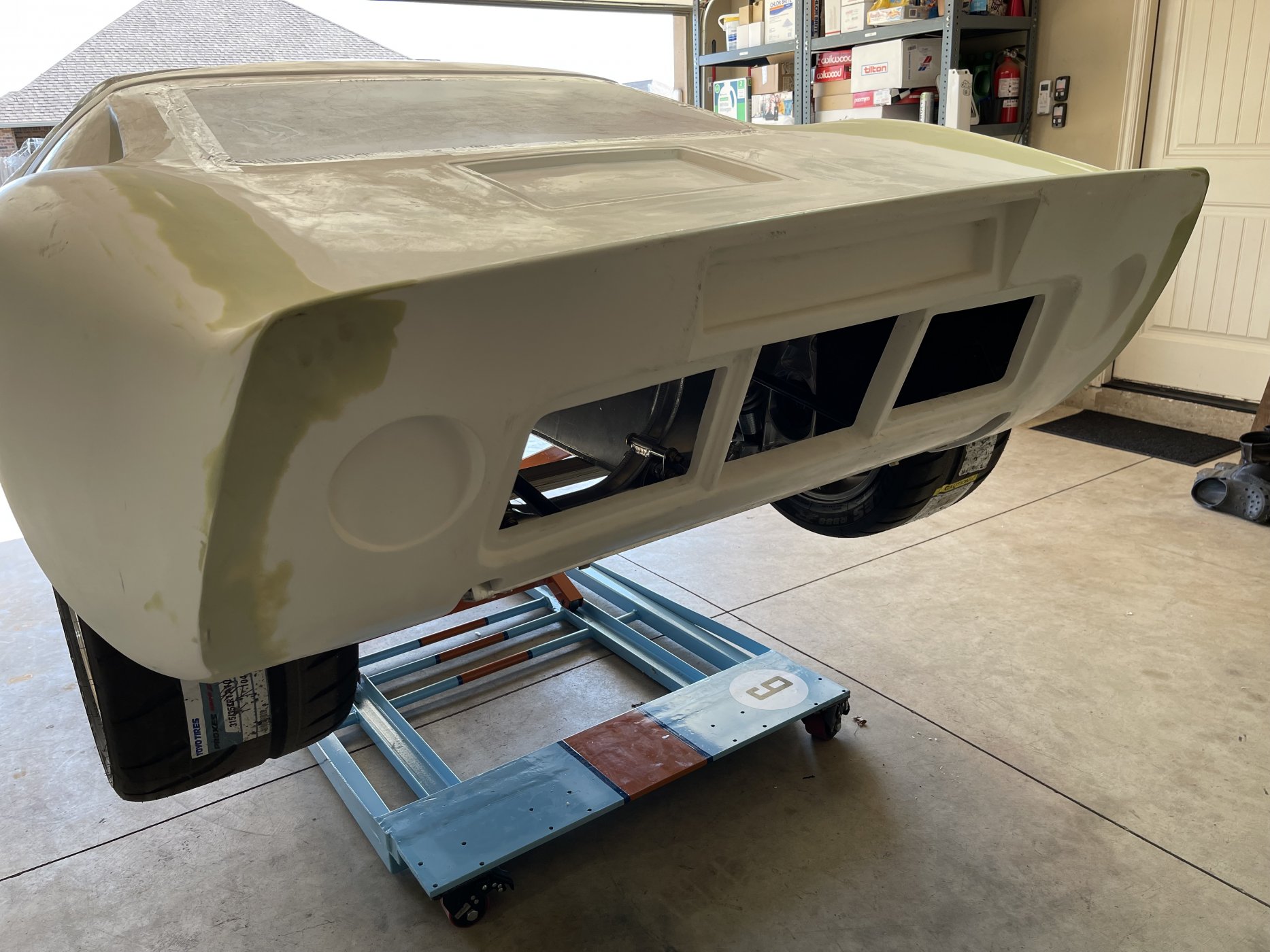

Are those rear fenders wider? What’s the biggest width tire you can get under those?
Hi Kyle,
I had RCR add the +2" Gulf flares on it. I dont plan to have the wheels widened on it. I am hoping to be able to set the wheels farther out on the rear of the car to match the fenders.
Sean

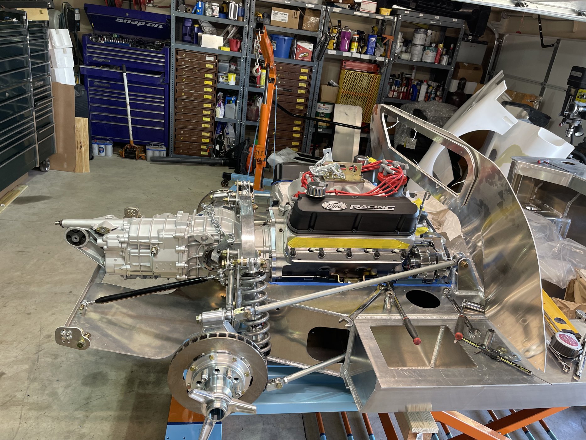

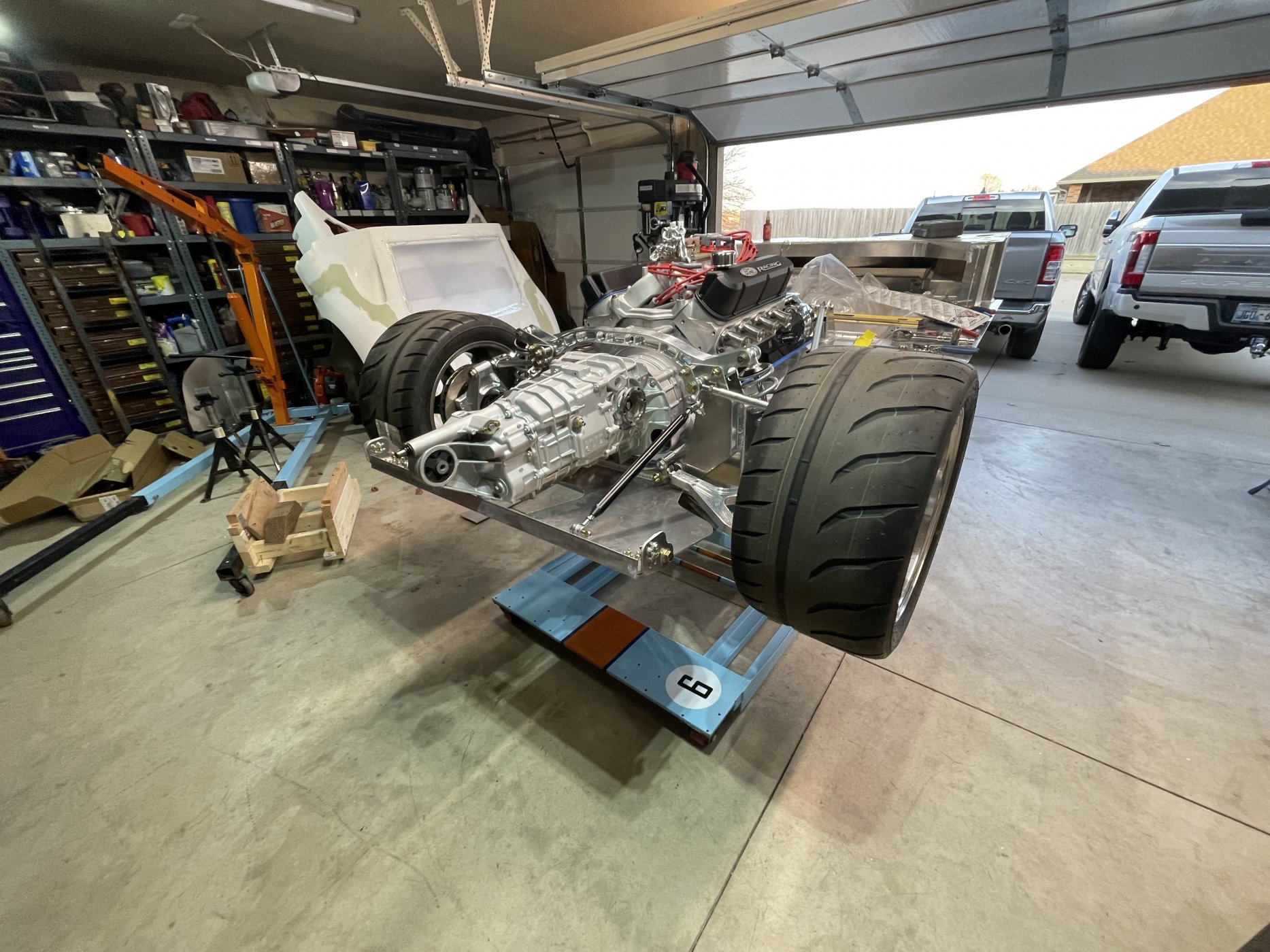

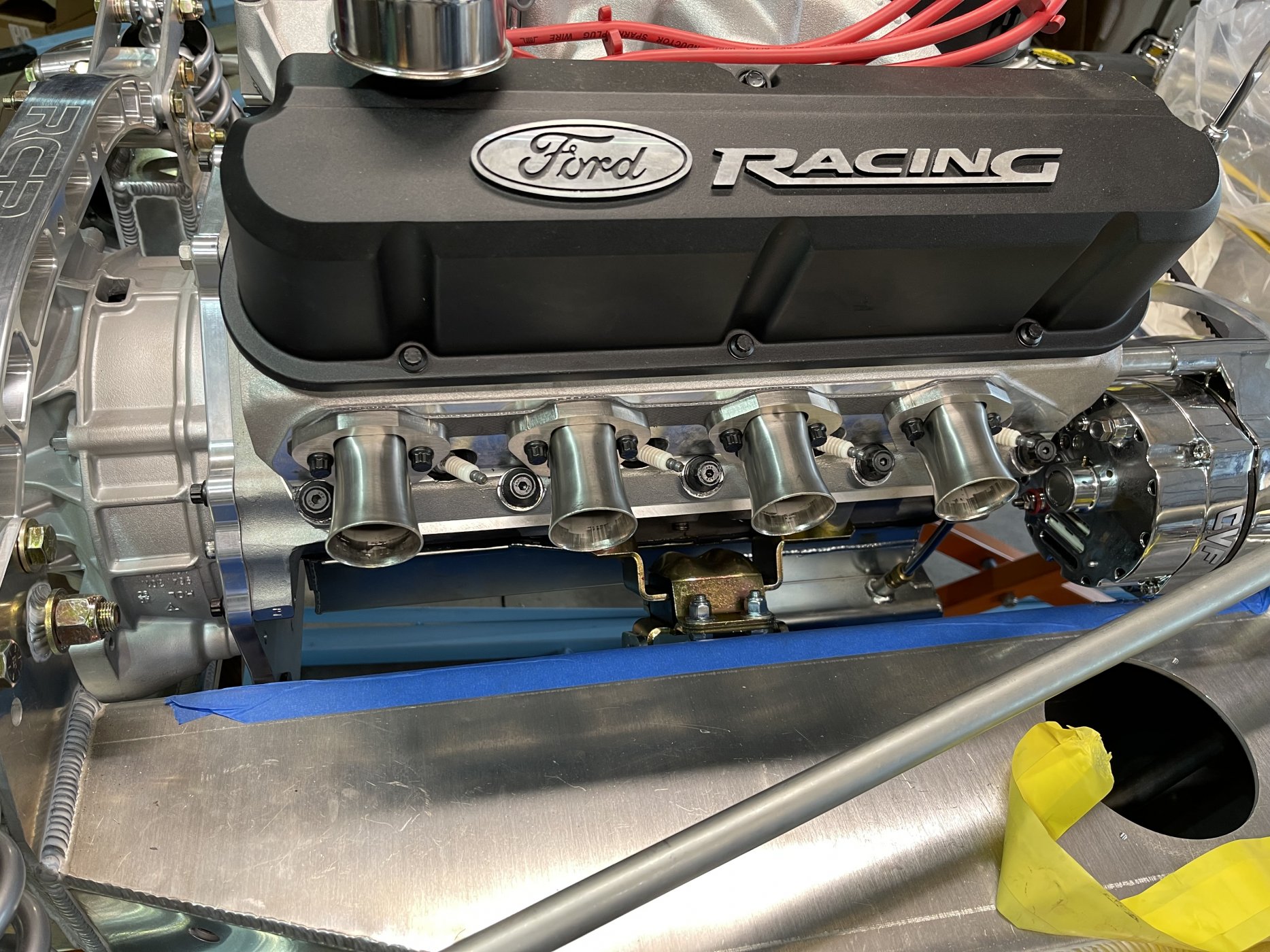

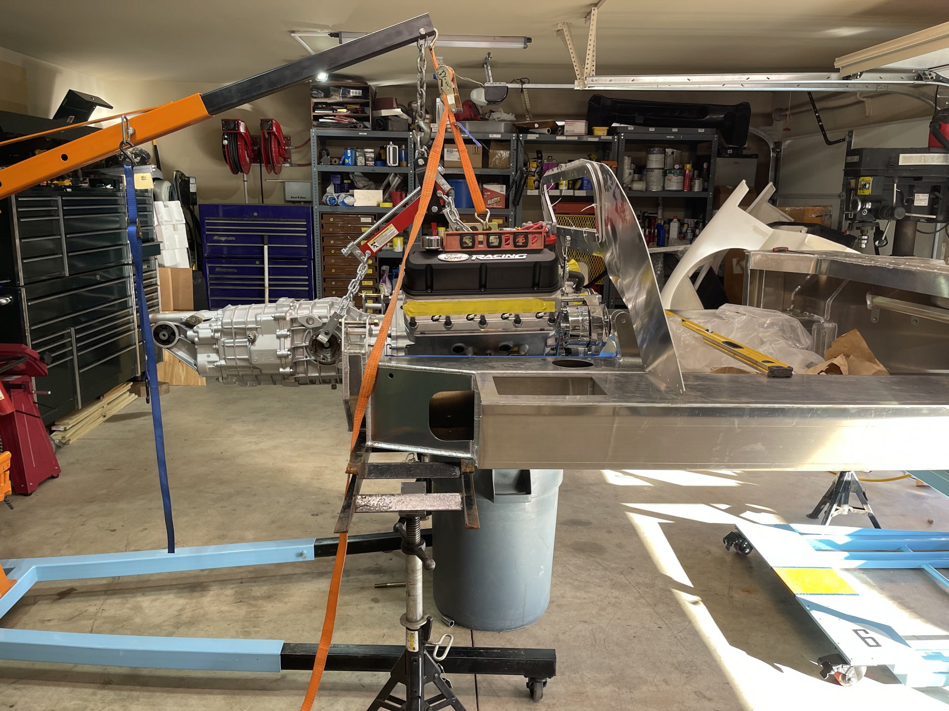

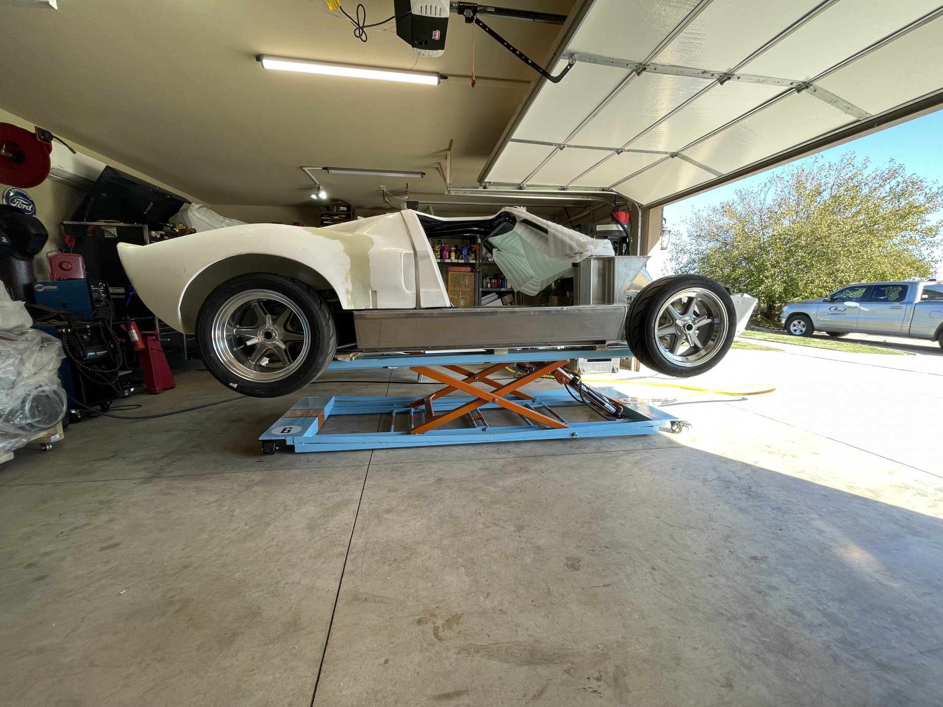

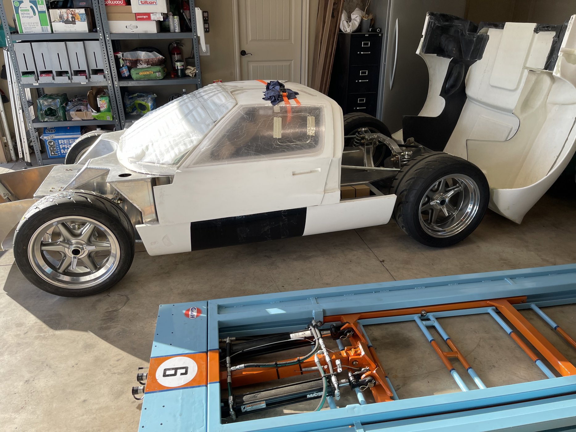

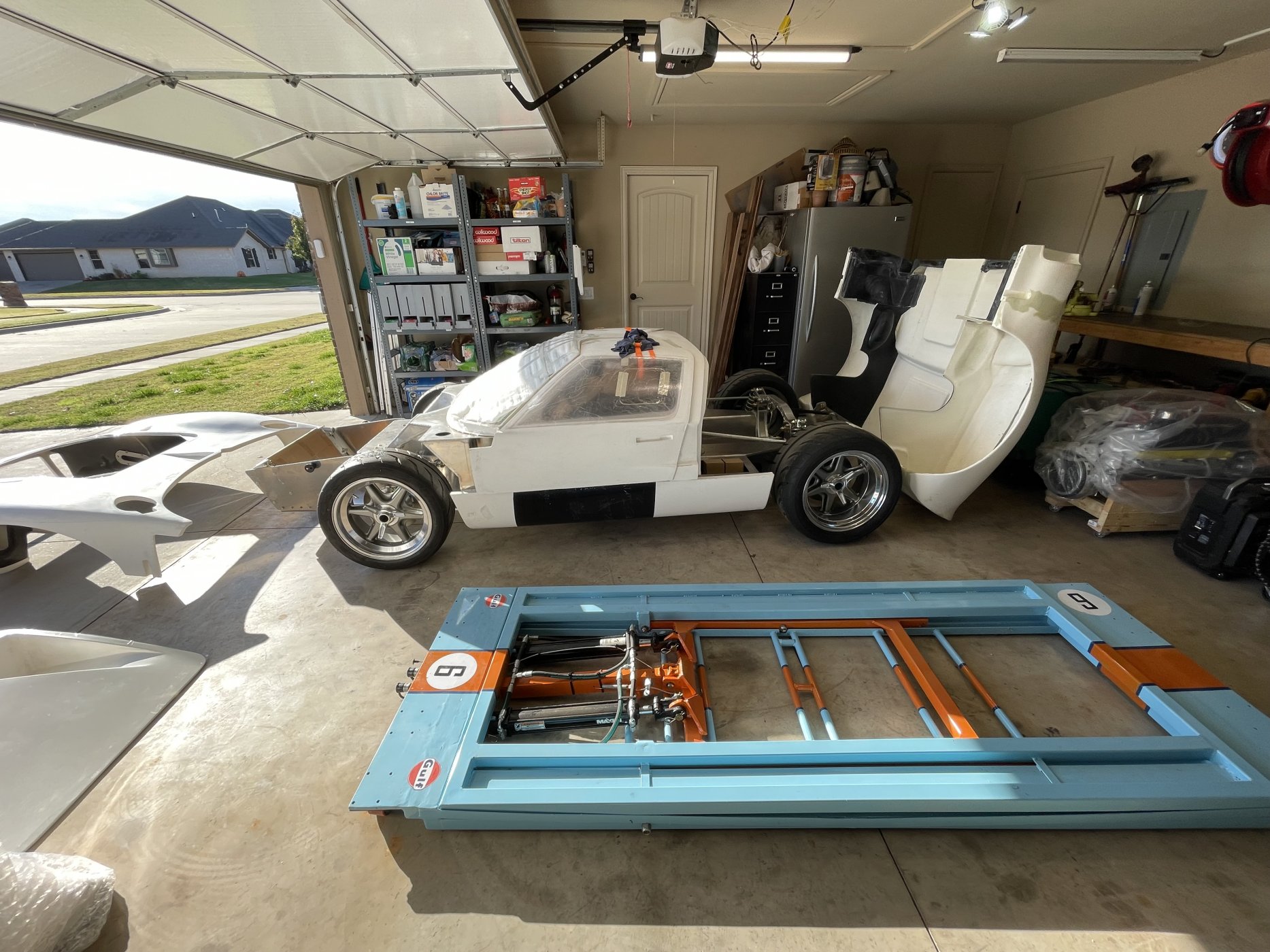

Ive made a bit of progress despite a crazy work schedule and a vacation.
I got the engine and trans-axle mounted, this was a very tight fit. I am going to need to look at changing the alternator mount, it is very close to the upper suspension support. Pictures corrupted so I will update later showing how close this is.
I fabricated some supports and spacers for the trans-axle adapter plate, pictures were corrupted, so I will update later with some pictures. I have a preliminary setup on the rear suspension, I will need to get it off the lift to dail it in.

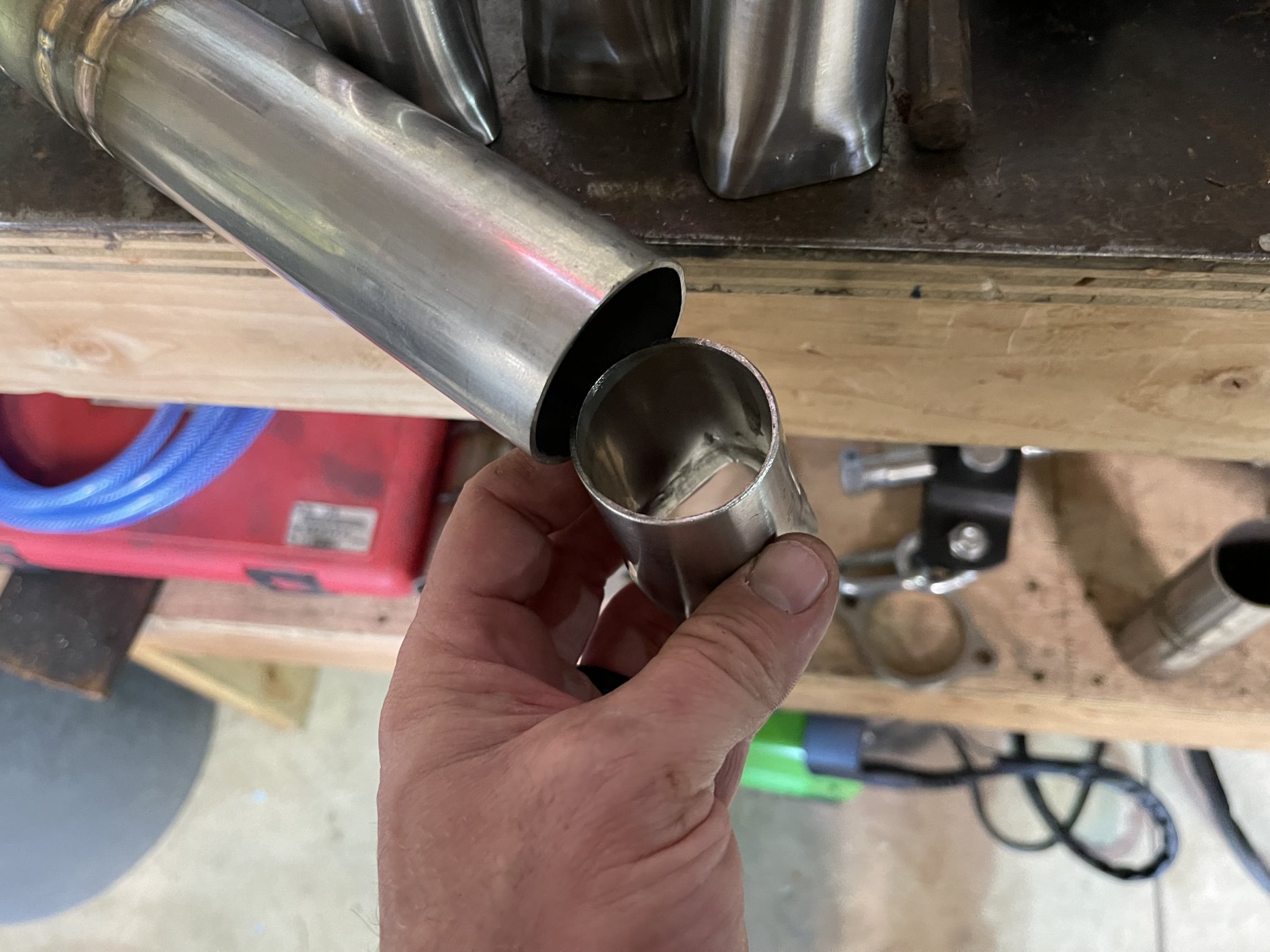

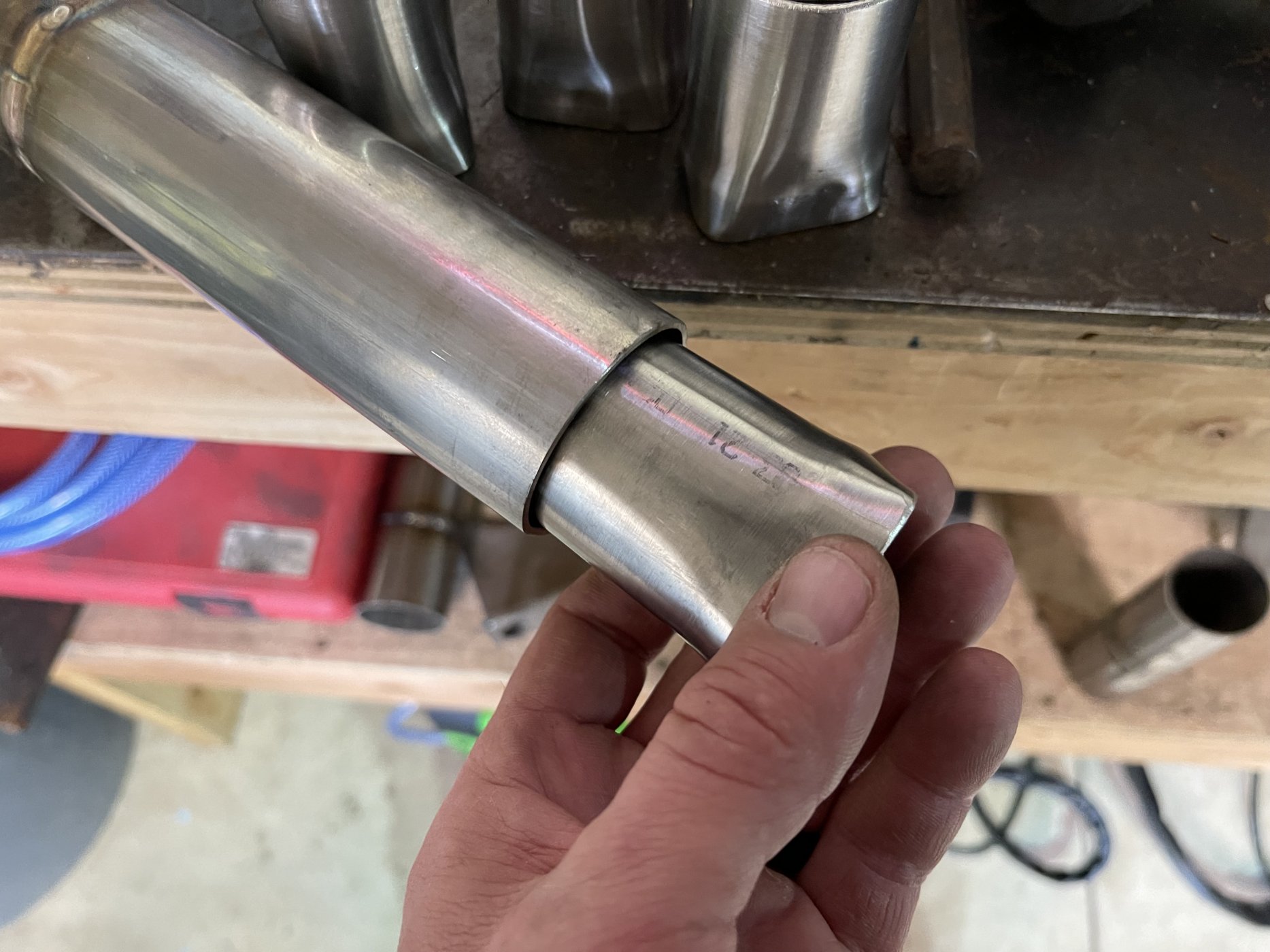

I am going to move forward with fabricating the headers. I have a friend that is going to let me borrow a IC Engineworks header mock up kit. I will need to get a preliminary body fitment done to make sure I know how much room I have right there. I have the stubs and flared them out myself vs buying transitions(that are 2" long) to mate with the 1 7/8" primaries.
