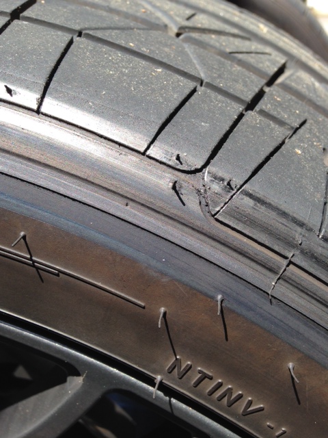

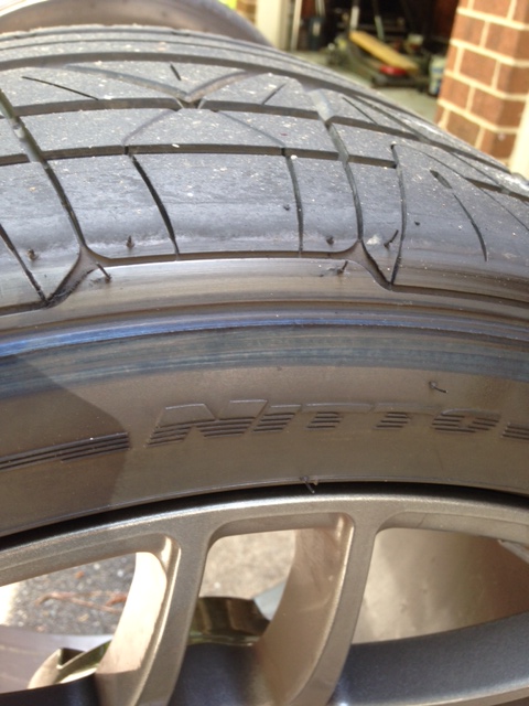

Yep, got about 2 finger gap also. I noticed more rub (I could smell the rubber) when I had the shock compression settings softer - less so now but still get some rub under certain road conditions re: dips/depression in road surface or under hard cornering. I'm using the standard Z06 sizing 18" frt. & 19" rear. Pictures are of my L-S Rear tire and then R-S Rear.

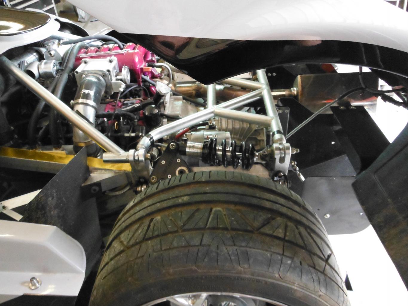

Sorry, here are the pictures, before with 650 lb and after with 750 ride height the same, might be a couple hundred lighter then a LS motor

Before and after pictures. Went from a 7" 650lbs to 8" 750lbs. I'm using the heavier Ricardo box.
The black springs are made by SWIFT. Part number is 080-250-750
