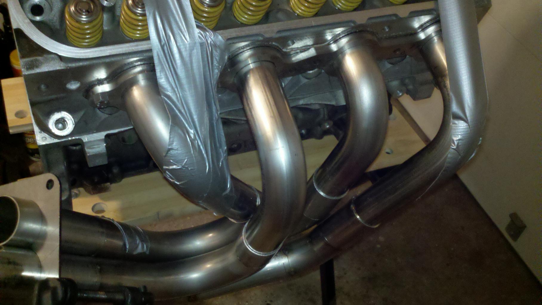

Spent the day on Sunday working with my custom welder. I basically helped hold things in place while he worked some magic and got the whole system tacked together. The exhaust will be exited downwards through the diffuser for some sound lessening and looks. The system includes custom headers, cats, and race mufflers.
