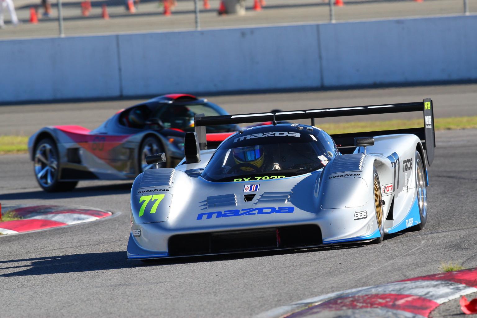

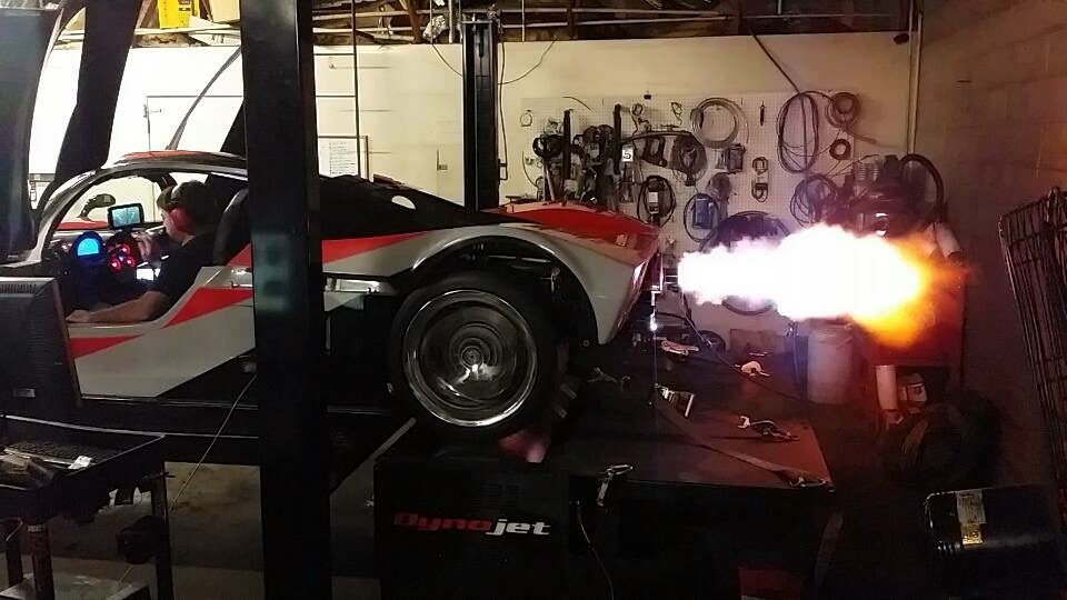

I have been driving it for the past 2 years, took it apart again this winter changing some more stuff on it. New dash, changed the ECU, wiring, etc.
Had it out at Sevenstock, a rotary engine event out in Ca. We were at the Autoclub race track, did 170 on the straightway, was on the rev limiter at half way down the front straight, after turn 2 its a road course for us, then out on turn 4, straight away was boring tho.
Cant wait till spring, and I think ill go back to Ca for Sevenstock again.
My car at the Auto Club race track in Ca.
