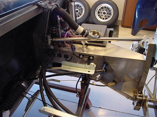

thanks David, I will try a new bracket. On a side note, I just recieved the parts for emergency brakes for my car(they were not on it originally. Do you have any pics of how it is hooked up? There is a large u shaped bar with the connecting cables running through it and I have no idea where it goes.
Hi Chuck,
Please ignore the drift in this thread but here are a couple of pictures that may help with your emergency brake question.
thanks Bob, it looks like that thing just sits in mid air attached only to the for and aft cables. I am missing the handbrake cabla, I suppose I can have one fabbed.
No problem Chuck. Glad to help. Drop me an email if you need other parking brake pictures or measurements. However I will mention that Wilwood has some very small light weight parking brake calipers that can be adapted and are much lighter than the stock CAV units.

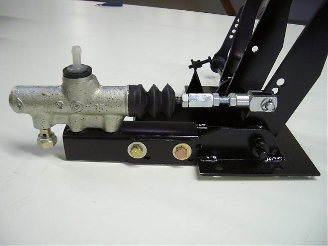

Hi Chuck,
If you find the clutch effort remains high after changing the slave, you may want to look at pedal ratios, there's a modification for that as the Ford clutch pack is harder to lift than an Audi spec unit.
Basically it involves dropping the mounting height of the clutch master so you increase the pedal ratio with a minor increase in pedal stroke. A new hole is required in the clutch pedal too for the push rod clevis. I can send you the dimensions.

Hey Chuck,
Ian is right on with his recommendations, especially the cautions about the bell housing.
Also changing the mechanical advantage of the clutch pedal itself gave me much more precise control over the sweet spot when shifting. Here is a picture. I made two holes below the stock attachment point and moved the master cylinder back so the angular change of the push rod was minimized. The net result was slightly farther pedal travel, wider engage/disengage sweet spot, and less pedal pressure.
