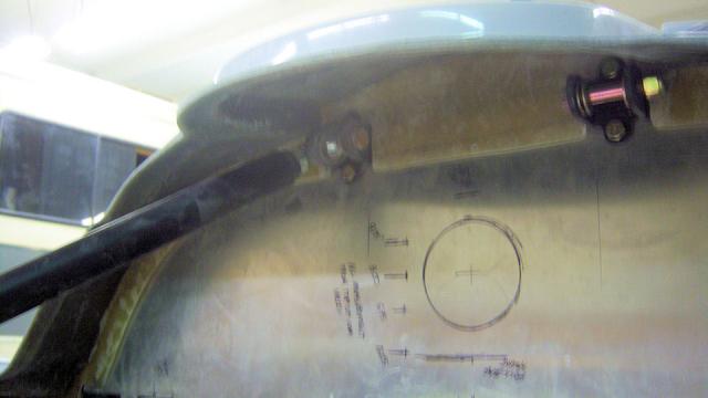

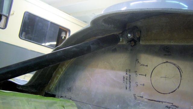

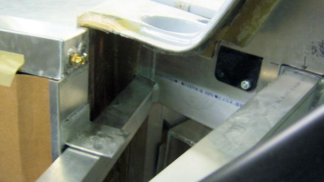

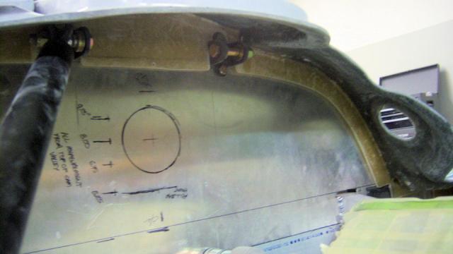

The flange actually lines up with something :) <bonus>
The stock body has fairly wide gaps between the sides and sides of the chassis in the range of 4 inches, along the top edges the gaps are in the range of .25 to 1.00 inch depending on location. So either one would need to make a flange of the appropriate width or they would need to be supplied by RCR, due to some of the obstructions a bulb seal alone in this area would not suffice.
Nice that RCR continues to develop and fill out the components catalog which will make the car that much easier to construct for future purchasers......... And for the guys that have not come to this bridge yet, I am pleased this post has helped bring the factory solution to light.

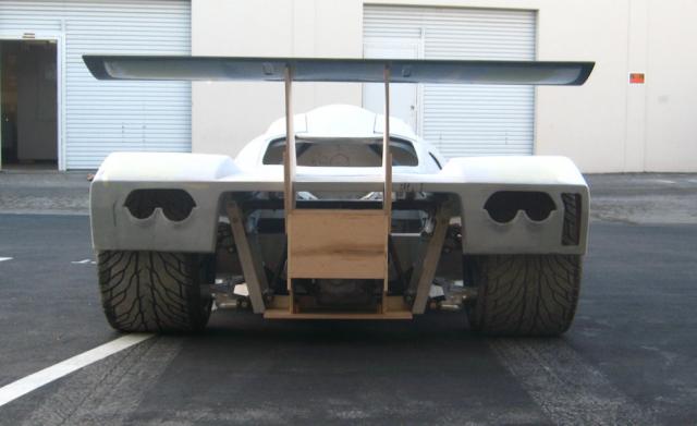

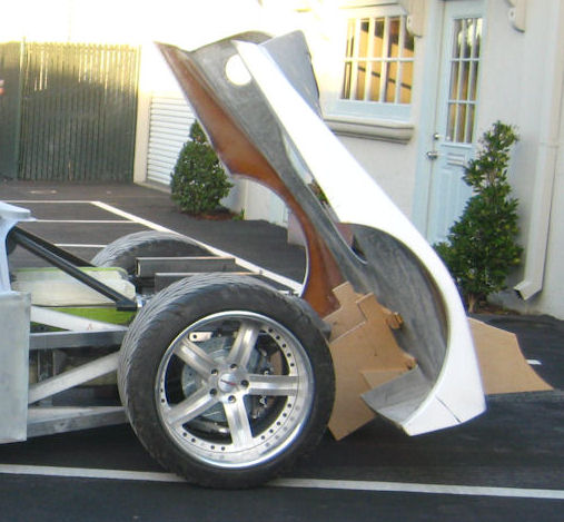

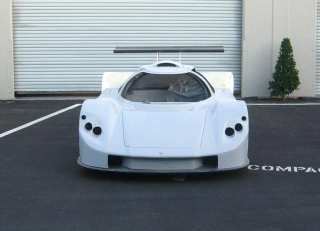

I was fiddling around with the wing position and the pivot points. It has been a goal to make the tail and the wing move in one motion. Jack had a good idea in that the assy should pivot at the base so I went there first, I like the idea that the assy move rearward as it opens offering nice access to the engine bay. Unfortunately the clip moves back rather quick on initial movement and will fowl the tops of my rads, so I will need to move the pivot point up the assy more to prevent that. The wing is really high in these shots but it's easy to make the mock up shorter...kind of hard to raise it. The assy will be all of a trellis design not solid as shown in this mock up work, the clip will need to be slotted and reinforced to allow the canards to go through uninterrupted.
Still looking for wing height to rear view mirror information. What is the best wing height on an SLC to allow best rear vision. At this height one would look under the wing. Cam had given some feedback. Anyone else have real world recommendations?

Have you looked at a rear view camera instead? That way you can record everyone dwindling in the distance when you step on it ;)
