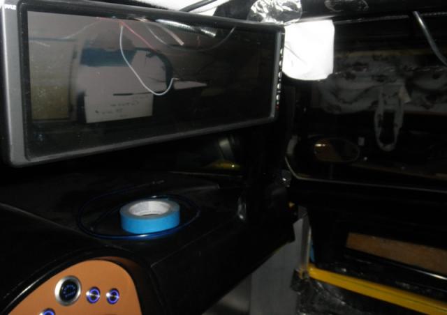

One more post about the camera, sorry to hijack the thread. I put the Pyle camera/ monitor in and it is pretty good. I wired it on all the time and it sorta doubels as a rear view mirror. but back up camera were designed to look 20 to 40 ft behingd you. the image gets blurry 50 to 100ft, but better than nada. I got the 380x60 TV lines which ain't great resolutoin. Pyle now has 420 lines but I'd bet there are XVGA cameras out there. OH, in the pic is my superbowl prediction. Green Bay +7, but you can barely read it.
