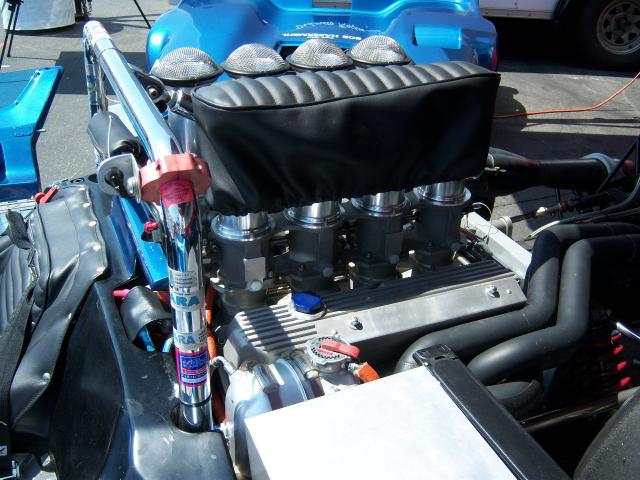

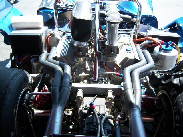

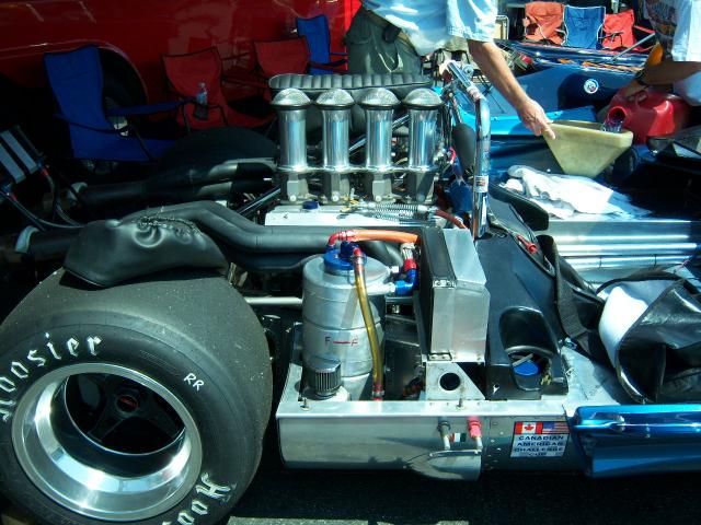

Hey Jac...I found something to warm your Ford blue blood at Laguna yesterday (I was a die hard Ford fan in my teen years) this engine looks quite huge compared to the standard Can-Am Chevy fare. Obstical? I don't see no stinking obstical.....

Thanks Mesa, Joe Di Loreto always seems to have a bunch of FORD powered stuff, had a 427 cobra & GT350 Shelby back in the eighties that were tested in Road & Track, same issue had tests on a Daytona Coupe & the 'Super Coupe along with one of the first 'kit' Daytona's .( Damn magazine has cost me a lot of time & money since! :) )
Didnt happen to run into Jim Herlinger or Irv Dickson with the old Baldwin or Kellison specials did you, both Flathead powered.
Obstical/Obstacle is something you can SEE and take avoiding action from, if you FEEL it , well its just bad.:)

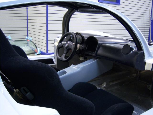

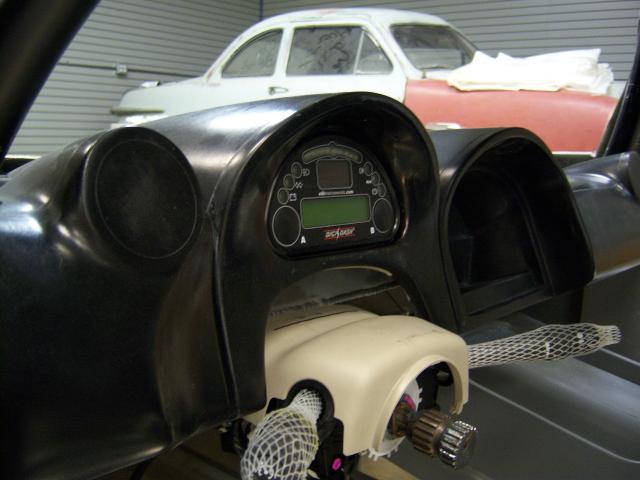

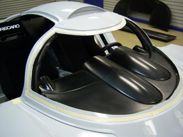

Today I rough cut the windshield opening, trimmed and installed the dash then placed the readout, seats and wheel for effect. The dash clears the top of the foot box 3.5 inches at the near edge and a good 4-5 inches near the windshield (the sculpted areas will allow even more room). The reason I mention this is that others thought maybe there would be a lot of room under there to install stuff, like maybe electronics and such. The only trick will be to set up the dash to allow access. There are defroster slots molded into the dash but, I don't know if the defroster "manifold" will be included in future shipments. If not, once I receive the A/C heater unit to judge configuration I'll make up some manifolds.

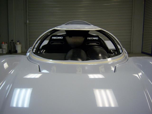

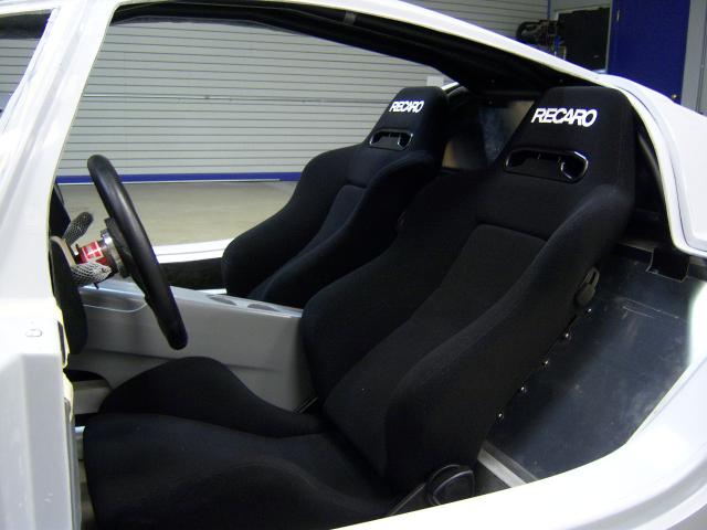

As noted earlier - I was looking for some articulating seats for the car as I wanted to have maximum adjustability and comfort, I also feel driving a "race" car on the street with limited suspension travel would (IMO) get a little old a little quick. None of the seats I tried would fit without modification (Sparco, Recaro) and the one that would (Corbeau) was a little low on finish quality. So I ended up choosing Recaro because the chassis is pressed clamshell style that will lend itself to modification better than tube frame construction. The modification will be a fairly simple shortening and re-contouring of the headrest area to clear the roof.
Enjoy today's pictures

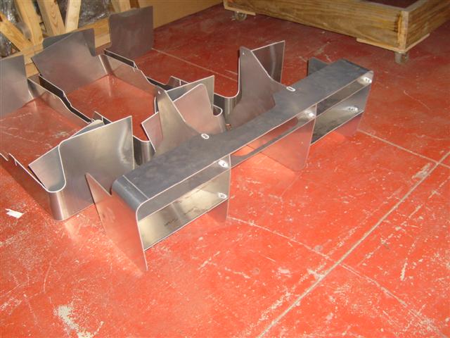

We have opened up the diffuser , differing from the shots of my black car to allow the hinging tail, but also to allow more cooling capacity for airflow through and above the diffuser...you big HP guys know all about heat....and it allows us to mount the exhaust lower to facilitate the hinging tail...its all a trickle down deal..one small change needs many accompanying ones to make everything work..
These are the aluminum rear diffusers shown in my pics elsewhere...

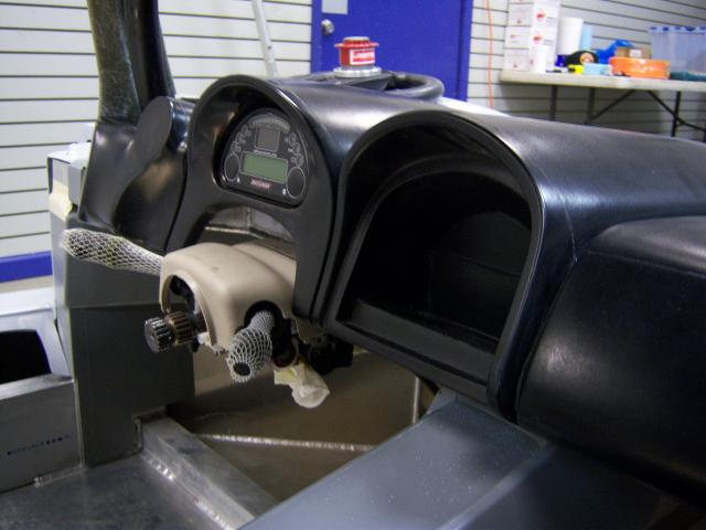

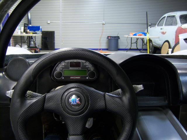

I inset the readout pod a bit in order to help keep glare off the display (as opposed to the surface mount as delivered). Could be set back as much as two more inches, I'm considering going further in by moving the entire flat surface of the bezel inboard more.
