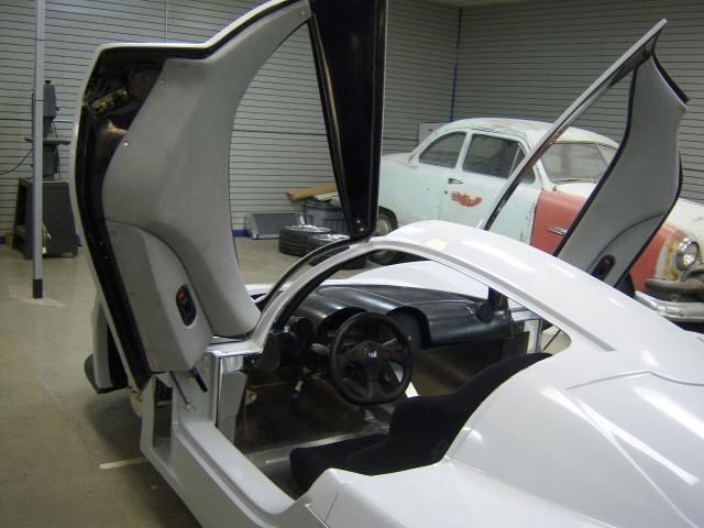

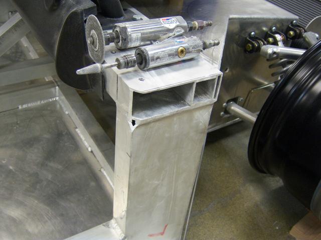

Here are some of the items covered so far in my adventure.

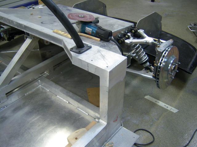

A) Capped the open ends of the upper frame member that makes up the dash crossbar, same for the upper ‘’B’’ post rail

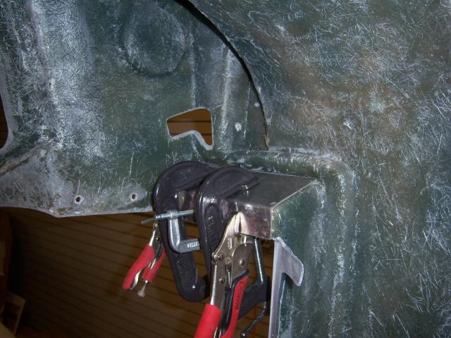

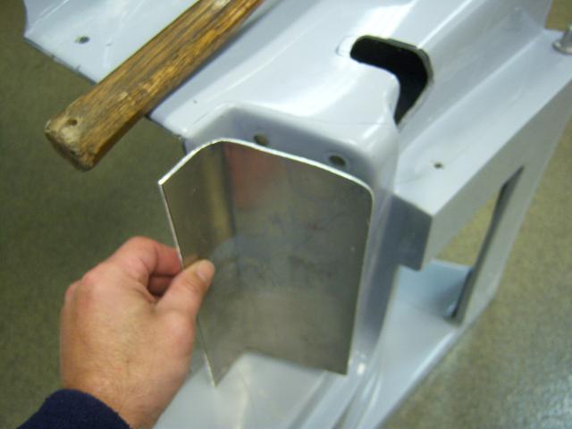

B) Cut lower door hinge openings, leveled and reinforced the area behind where the hinge bracket mounts to the body to help guard against possible long term stress cracking.
C) Made and bonded in aluminum reinforcement plates to strengthen and level the body jamb area where the lower door hinge mates to body
D) Installed doors, mounted inner trim panels, made brackets for inner door handles, installed outer handles, made linkage
E) Designed and executed a gas strut solution to hold doors open

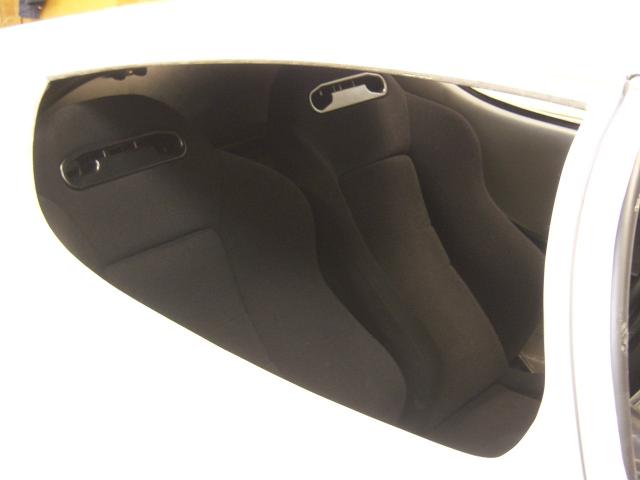

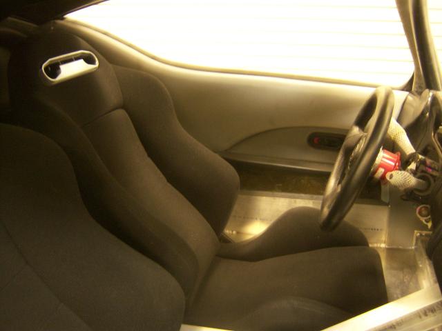

F) Had Recaro seats modified (shortened) to fit in car, mounted seats

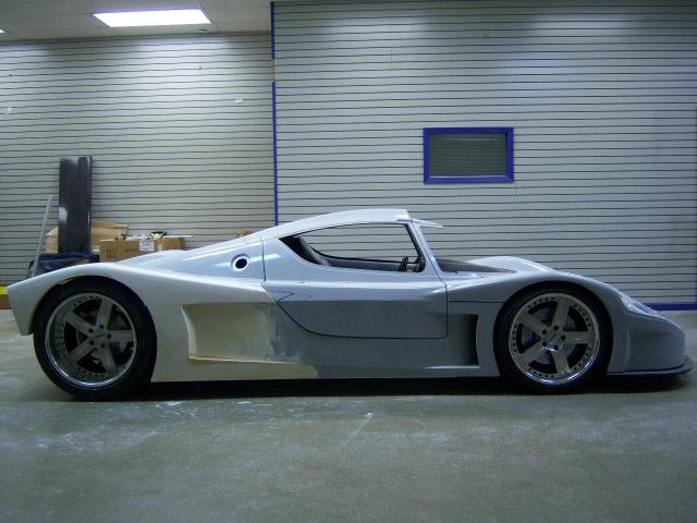

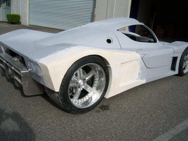

G) Trimmed rear wheel well openings larger dia. to install rear wheels
H) Designed and building wider rear “fenders” to cover wider than stock rear wheel combination

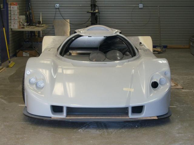

The "fenders" are just the rough body plugs at this point, they will get vents installed and transition a little on the door before molds are pulled off of them to make the final product.

For someone who doesn't have a lot of time available it looks to me like you've been busy! The wheels look fantastic and it looks like you have the bodywork taken care of to cover the extra wide rears - excellent. I really like the Recaro seats too - are you mounting them so they will be adjustable or fixed? What model did you use and what was involved with shortening them to fit? From my experience with Lotus cars, your reinforcement of the fiberglass for the doors is an excellent idea - fiberglass that is stressed will crack - eventually. At some point I'll need to get the details on your door strut solution as well. Looking good my friend - and don't worry about responding soon - we are all busy.

Exceptional job! +1 for the door struts. Most of us will probably want to go that route. Your photos and comments are greatly appreciated by current and future SL-C owners. They will certainly help out our builds. If you take your time as you are doing, maybe someone will be able to "overtake" you in parts of the build and you can have the favors returned!
Take care,
Dave L
The seats are the Recaro Speed model with the high thigh bolster option, I was going to use the fore/aft tracks but found that range of travel un-needed. The tracks also cost 1" of headroom so they were deleted. I do make good use of the tilt and recline function as this allows access behind the seat and more driving position options. There is steel "roll hoop" that makes up the headrest area that needs to be shortened and reshaped, then the foam padding that ''clam shells'' around it needs to be shaped from square to round and the covering sewn to match.

You might want to look at the Racetech seats. They have one that is laid back and works well in the GT40s. It fits right up to the bulkhead. It too is a little tall, but it doesn't hit the roof as some you describe. It comes out of Australia and I can't remember how much I paid for mine. It uses a lot of the strech fabric which will pickup a lot of lint etc., but can be altered to a lether type if you have a good upholsterer(sp?).If you search for them it will be in the Racetech America section. I seem to remember the U S agent is in the western U S. They give good dimensions on their web site. I'm 5-9 at around? 160 and it fits me like a glove. My concerns were the width of the seat. Most of the others were too wide for the 40 and left barely any for the console if at all. Their seats are set up for the 6 point harness with pull throughs for the shooulder starps. If you look back in my build thread(DRB#5) I think there is a pic of them. If you neeed any other info on them let me know. I am at work right now or I would find the info. They come with a mouunting track/rack with many holes for selective mounting. There isn't an adjustable mechanism. It would have to be fabed. I may eventually get a set of regular seats for show.
J - Thanks I spent quite an amount of time getting all the measurements just right, even took delivery of the rears first so I could better decide on the front measurements. I am waiting the arrival of the remaining trim pieces from RCR,which should really finish the interior to a nice level.
Bill - Thanks for the info but, the pictures posted show the seats after the modifications were made. Although others here may be able to use your contribution, cheers.
