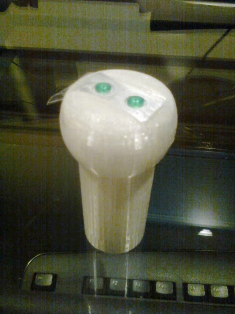

Its been some time, currently trying to actually finish this car (what a concept) it's mostly nuts and bolts now, with a remake of some of the hard brake lines (thanks Will). Cary is helping me with the wiring and there is a shift knob done in 3D print that might be of interest but, then I'd have to take a picture of it now wouldnt I?

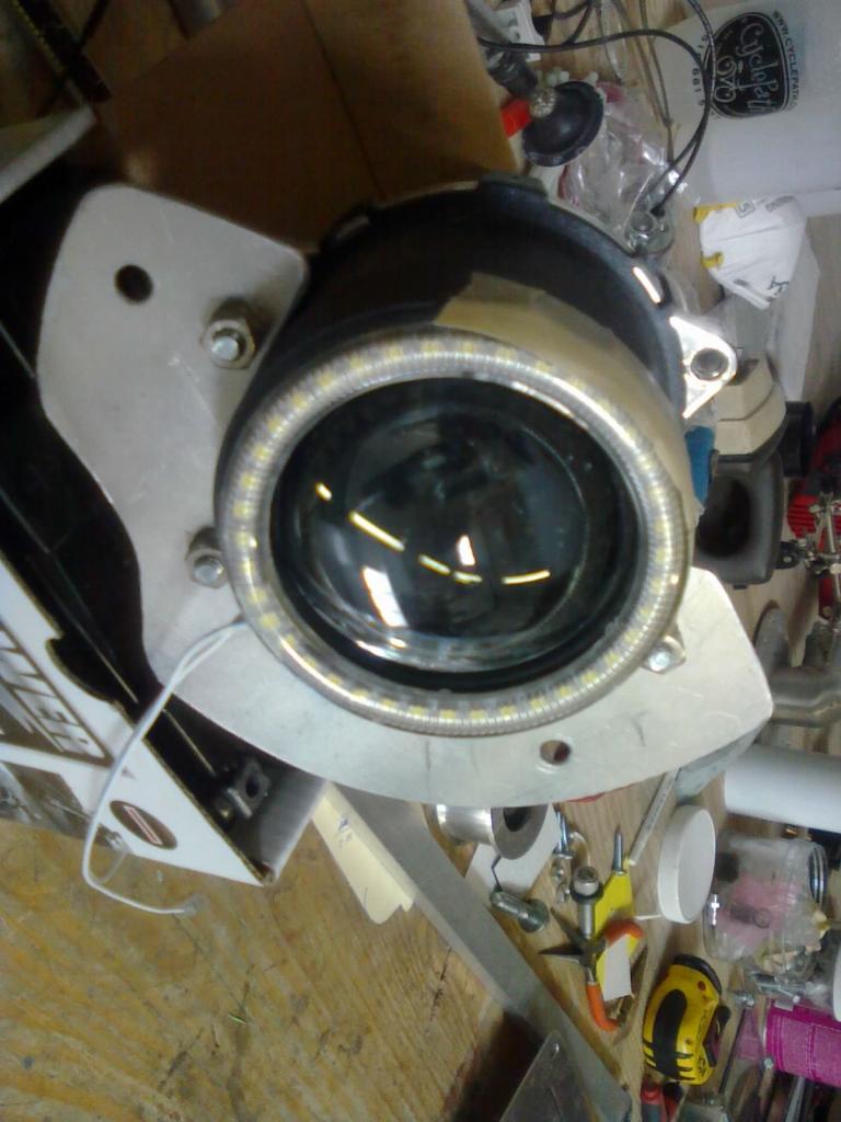

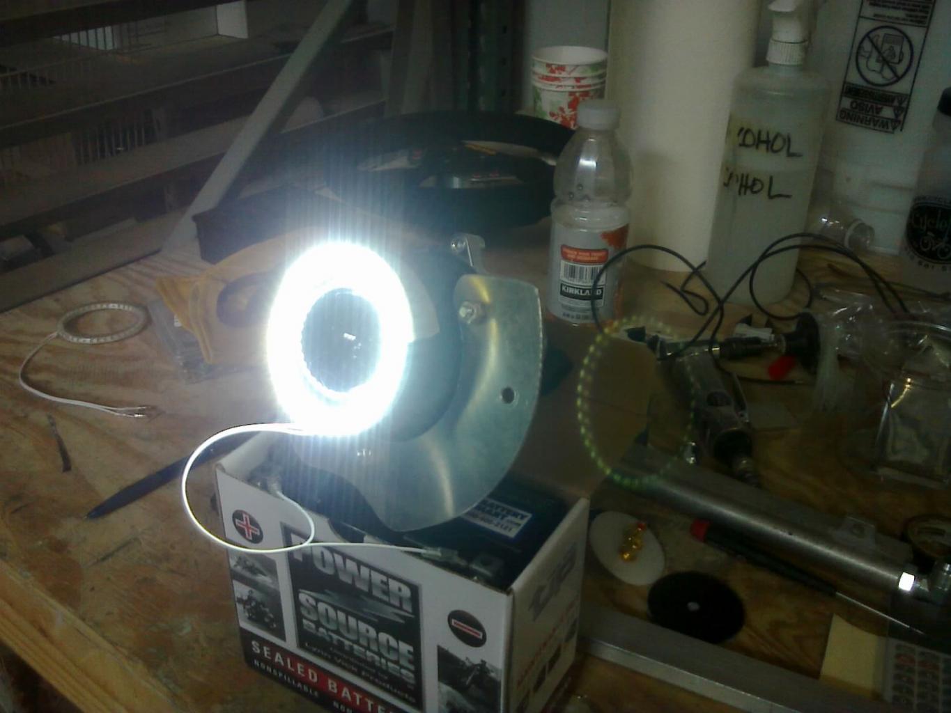

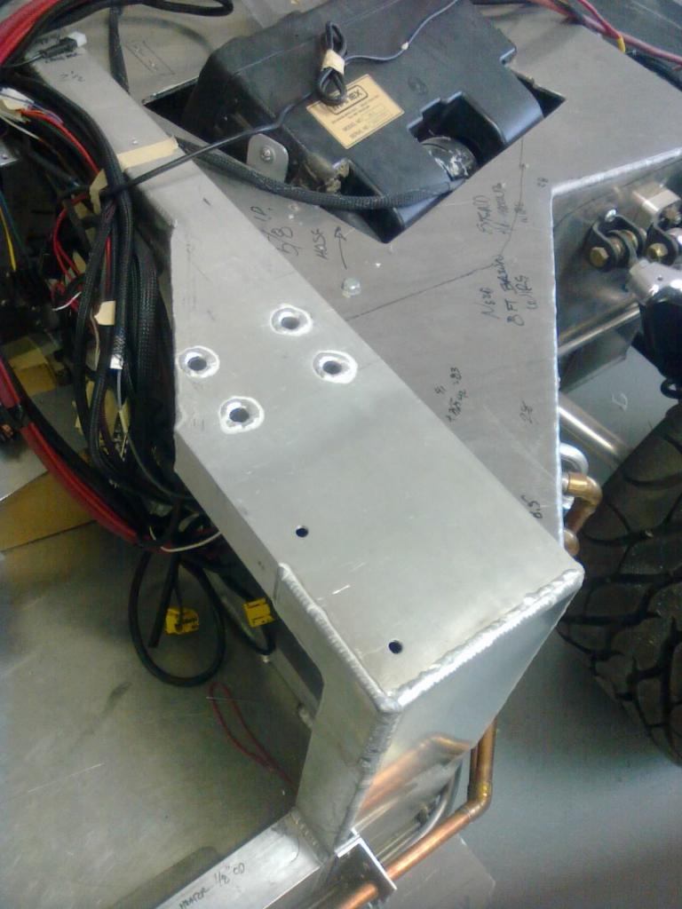

Those are the 60mm high beam units (now an option from Superlite, I think) with an addition of a 60mm halo light ring. The headlight is made by Bosch if I remember, available from Susquehanna Motorsports (however u spell that??)

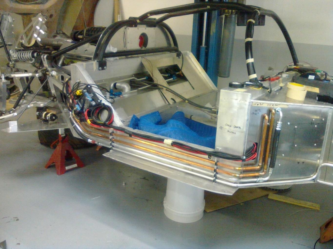

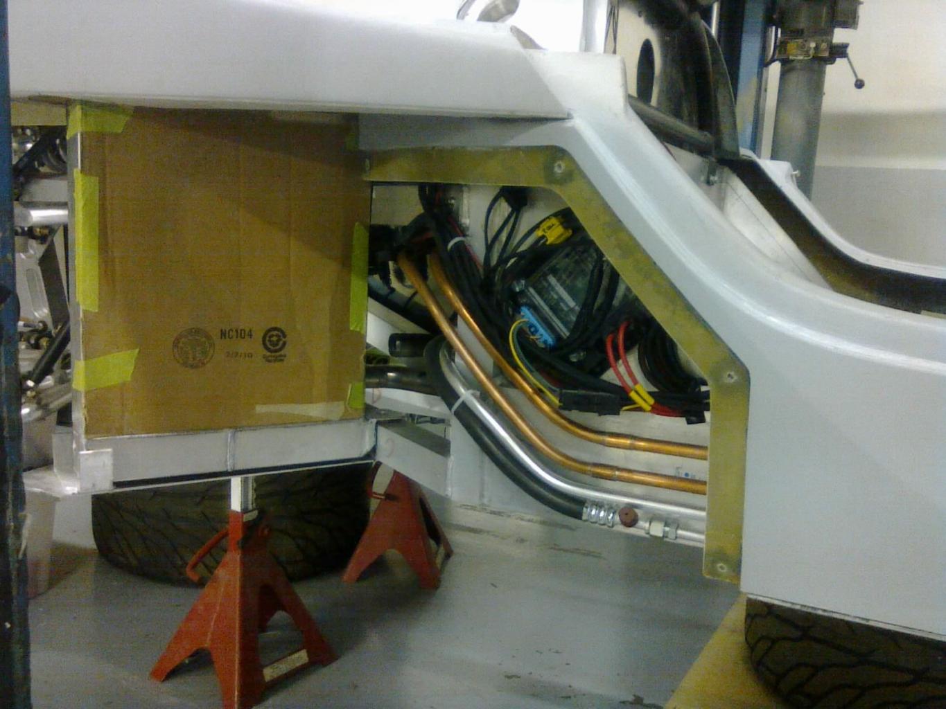

I'm wondering about the copper pipe you are using for the heater lines. I've always heard that copper is a no-no.
Con:
  • Copper gets "work hardened" under the stress of vibration found in vehicles and could eventually fail.
  • Aluminum is susceptible to galvanic corrosion when in contact with copper, particularly when the two metals are in contact with an electrolyte like warm water. Anti-corrosive additives (i.e. anti-freeze) slows the aluminum deterioration. Adding a sacrificial zinc anode in your cooling system helps as well. See this article on corrosion
  • My understanding is that the FAA & DOT don't recommend copper lines in vehicles.
Pro:
  • Many heater cores are made of copper
  • Old time hot rodders say they have used copper for fuel lines without a problem
It may just be a matter of how much copper you use and how well its supported/cushioned against vibration.
HHhhhmmmm. Thanks bill, I figured that shot would elicit comment. The heater core is copper or at least it has copper connection pipes. Since I now have an accurate model in copper, possibly I could have it made in aluminum or stainless.
I wanted to avoid having a bunch of AN connections in that line so I prefer to have the line welded together.
Thoughts?
PeteB
I'd be more worried about the soldered connections failing than the copper pipe itself. Heater cores are made of copper, but they do fail usually before anything else in the cooling system. I've replaced many heater cores, and usually it's been the solder joints that have failed. Then again, you're probably not going to put 100k miles on your SLC.
