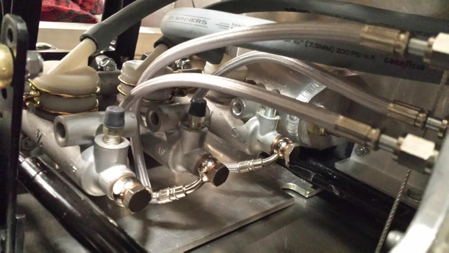

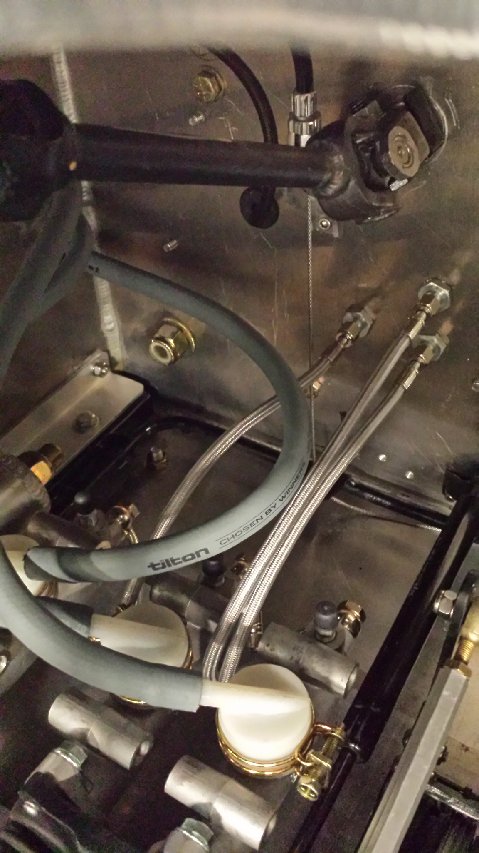

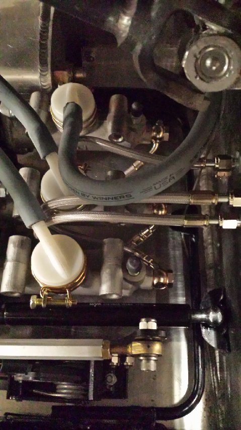

Getting the masters connected to the chassis was a bit of a task, in such that the braided lines needed to have enough length when all the way back yet the fittings needed to clear the front of the footbox while not fouling or kinking when stuffed all the way forward.
Note: For simplicity sake I remade the front brake hardlines to allow locating them on the outside of the footbox.

When I do some changes to mine this winter, I am going to put the reservoirs back on the master cylinder, I have the slave that way now, but back there the space is not used. If I have to add fluid, or bleed, I have to take the front end off, not a big deal, but its more then just adding the fluid. I have changed mine once already, it was pretty grey. Id like to see hanging pedals also, I will look hard at that this winter.

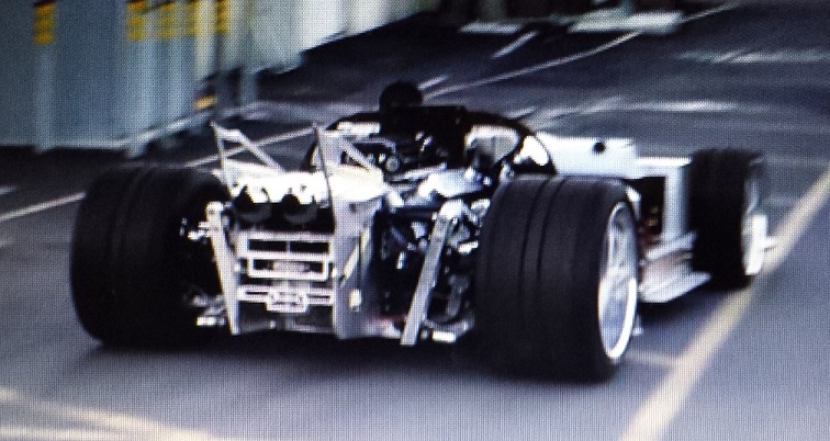

This project moved under it's own power for the first time two days ago. Relatively speaking, not far to the finish line. Sorry for the low quality, although somehow it has a certain appeal.

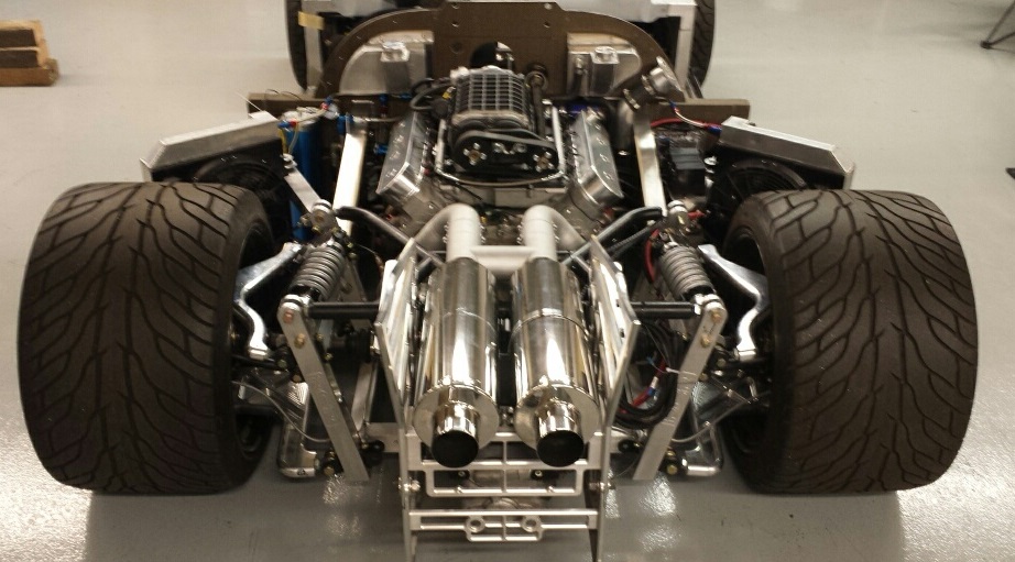

Had to go look back on page 4 for your answer Pat
"The rims are 16W x 20D and the tires measure 15.5W x 28.5D"

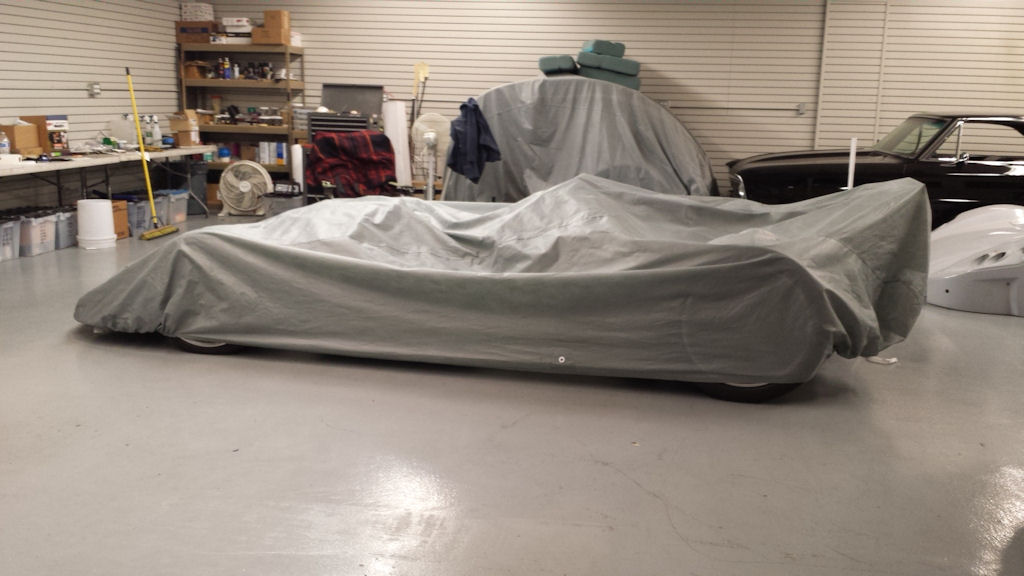

Tucked away after it's monumental first 100 yards on the road ;)
