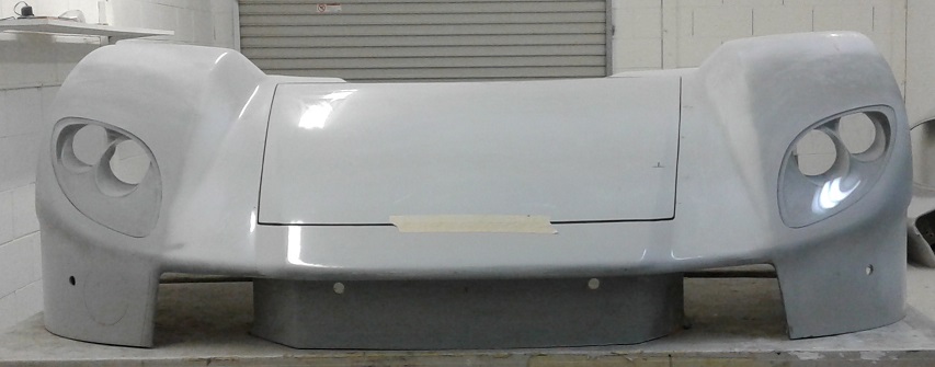

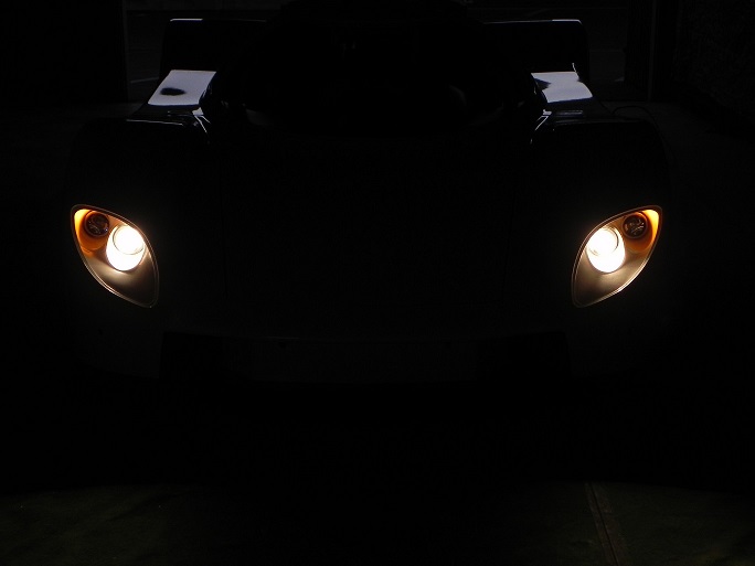

I always liked a lens, but when I saw the Pagani, I became a fan of the sculptural look of the open headlight. In my opinion yours look even better than the Pagani. Good luck making this decision.

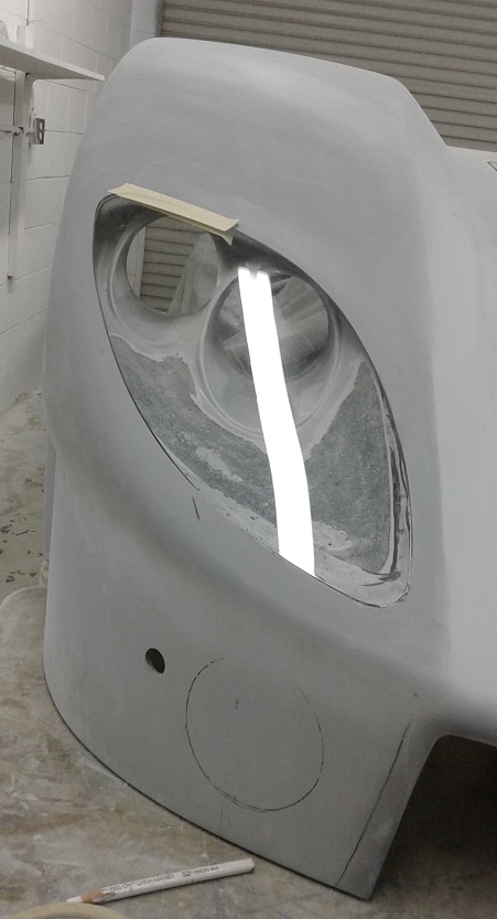

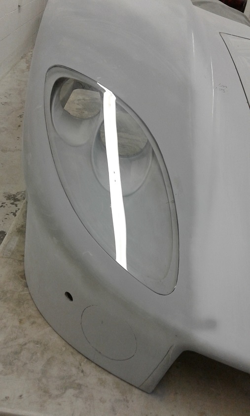

After a bit of a learning curve to get .25 lexan to conform to a plug that in the beginning warped and cracked and in the middle had the lexan blowing bubbles in itself (need a convection oven), we have these. The goal of .25 material was to hopefully have enough stiffness to allow some area of the lens not need a flange for support. Leaving a cleaner, less obstructed opening as a result. Unfortunately it didn't work out that way.
Sad thing is I really don't like how the flanges clutter up the opening and .... I'm not sure I'll use them. Possibly I'm just suffering from a marathon build day hangover.
Maybe I'll warm up to the idea.
Thoughts?

Looks like you are coming along pretty good with them. I would just paint the inside surround black, so you don't see the flange itself. Kind of finishes the part off imo also..

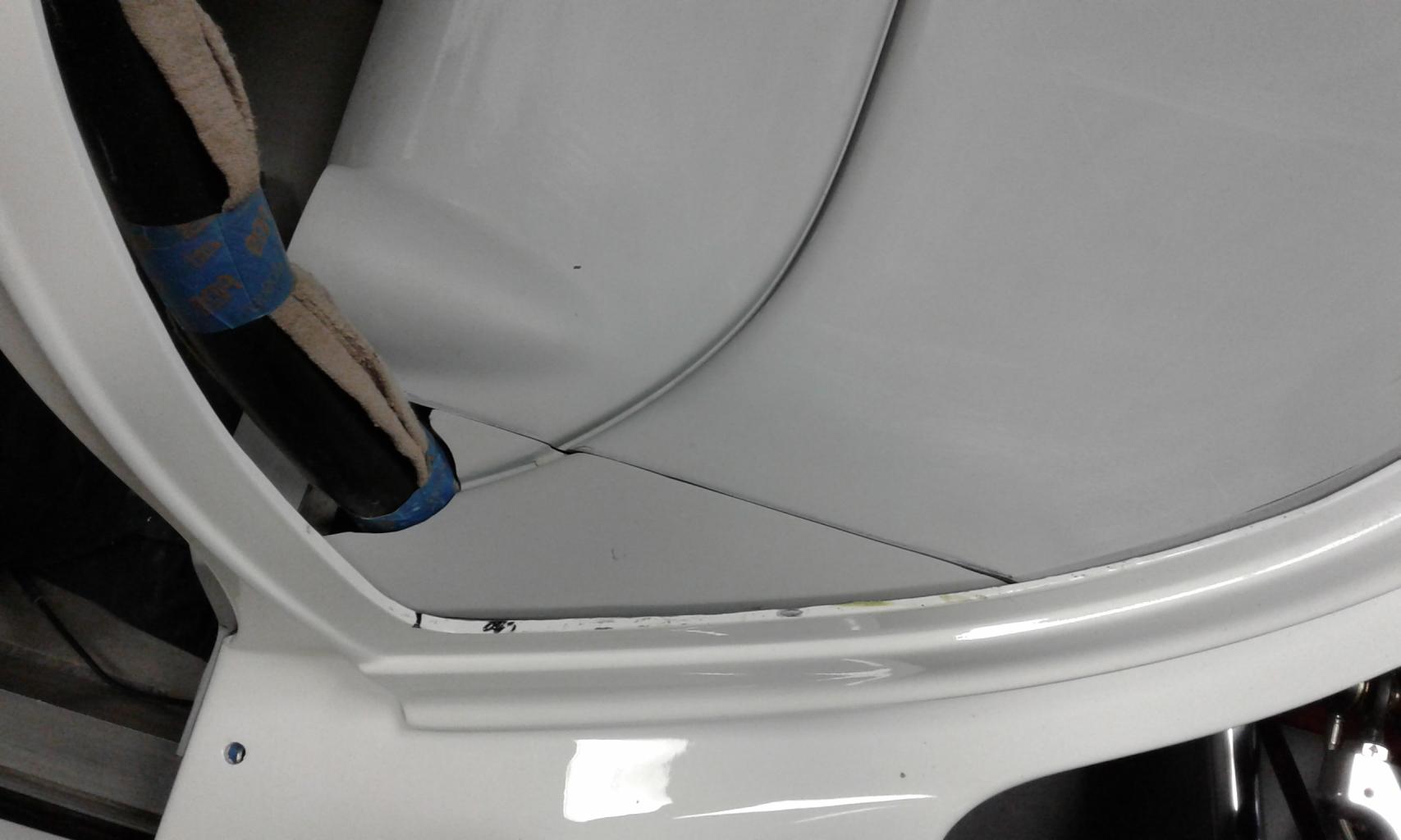

What are builders doing to hold the dash top side inserts in place (allowing dash past the roll cage)

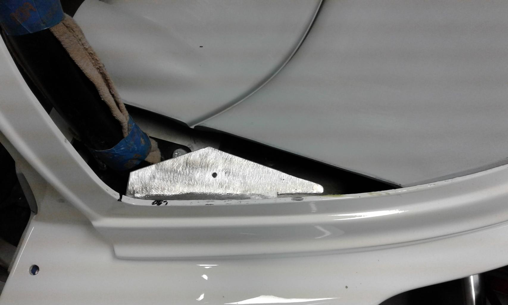

Allan reminded me that the standard method of filling the voids left by trimming the ends of the dash for front roll hoop clearance is.... Installing the A post covers. Which of course I donated to someone way back.
Here's my fix.

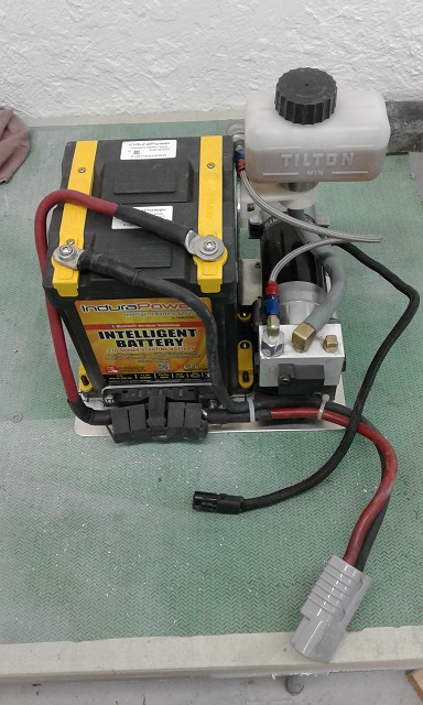

Some time ago I had decided to place the battery in my car in the passenger foot well. This brought some concerned comments by the assembled masses as to the possibility of death inducing vapors presenting themselves at some point. At the time the battery of choice was the Braille 21, this was the strongest unit I could find that would fit in in the limited space available. As it turned out the Braille just didn't have the snort to turn my engine over unless it was at peak charge every time.
Enter the search for the long term solution. I had been looking at Anti-Gravity brand lithium options (among others) for some time but, never got the warm and fuzzies that they had an offering which was suited to a real street based car. My search continued and fortunately the answer presented itself with a call to Indura Power. Turns out they had an option recommended for big rigs, hhmmmm? that should start my car. After a very informative conversation with James (their tech), I was sold.
According to him, if your Lithium battery does not have a minimum voltage safety cut-off circuit you stand a real chance of killing your battery as Lithium is non-recoverable once the voltage goes below 9. As it was, this feature already saved my battery twice from the clutches of the grim reaper in the month I have had it. As most of us know it's very easy to run your battery low (in this case low = DOA).
On to the good stuff. This thing is a MONSTER when it comes to cranking over the engine, first time, tenth time. All the same. It also features a tip over switch which as the name implies - cuts the power to the terminals in the event you should, uh, tip over.
14 pounds, 1,100 CCA, 40 amp hours, relatively tiny. NO VAPORS.
Here's my fix.
I need to do something here myself. I'm not a big fan of the A post covers, they are bulky and I like being able to handle the bar getting in and out. Did you make a mold for those two insert pieces?
How pricey was this solution, $800-$900? I know some of these lithium batteries can get pretty expensive with all the protection circuits (which is the smart way to do it!)
My dash was delivered with the 'wings' still attached, fortunately I saved them. It would be my guess that the current 'as supplied' dash has them cut off before they are shipped.
I grab the vertical portion of the roll hoop to get in and out too.
At the time I ordered my Indura it was $650, it may still be that price on their website. Good price considering the competition is more of the range you suggested.
