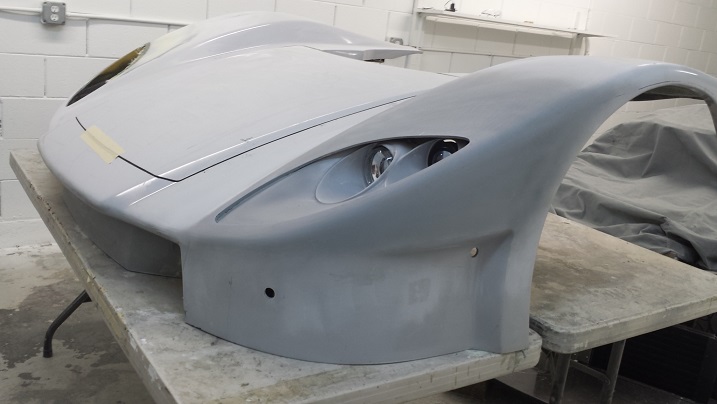

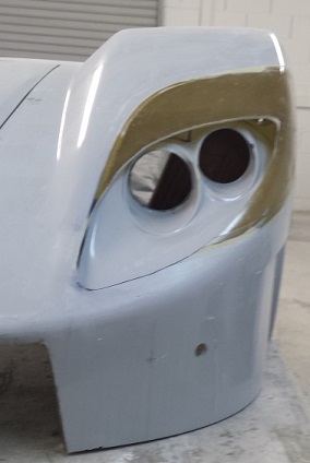

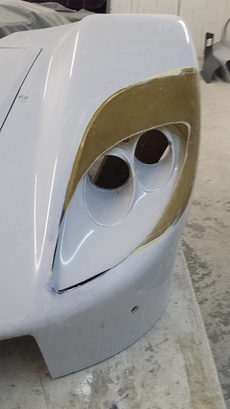

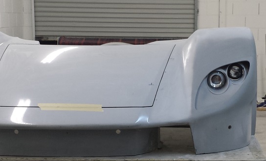

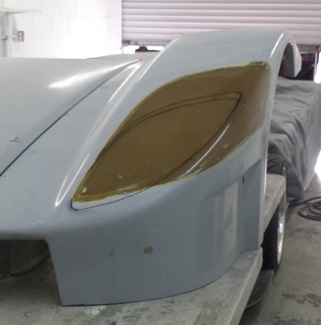

Think so, although I am also going to look at making the covers out of thicker lexan. Reason being I'd like to have limited flange areas just in the corners, be able to fasten it in just corners and not have it crack or be floppy as a result. Goal being - easy to remove, less busy via less fasteners and less flange area for a clean open look without the need for a black border.
We'll see how it goes.
Scott started later, cuts faster, cuts more, cuts deeper. The guy is a freaking buzzsaw. It's damn near a sport just watching what he'll dream up (and actually do) next!
I never met a piece of fiberglass I couldn't cut! Haha.
Like the new headlight design. The over hang effect in the back is a cool look.
Thanks guys for the positive input (negative is welcome as well).
I realized that I've been drawing cat eye headlight openings since, like, 5th grade. Funny there would come a time to put all that 'work' done in Mrs. Barns class to good effect.
The headlight bucket will be held in with 'click bond' fasteners supplied by Jack, as they will need to be out of the car in order to paint them. Another benefit is I can make an alternative bucket that hold some other type of light or style and then just bolt them in.
Now for the next question: Do I make a lens for them or leave them open? Opinions welcome.
