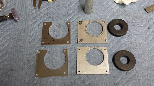

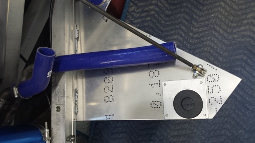

But wait, there's more...
Took some time to get all this stuff, uh, stuffed in...

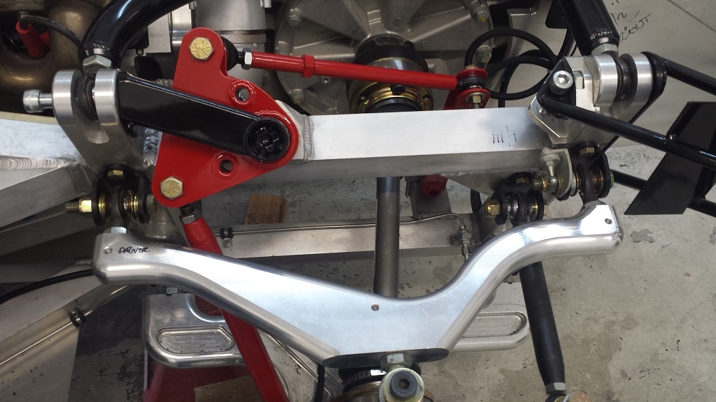

photo 1) My version of the bellcrank double shear support bracket pioneered by Ted and Don on the Blue SLC racecar.
photo 2) "And the hip bone is connected to the leg bone"

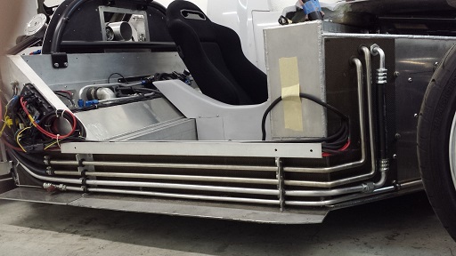

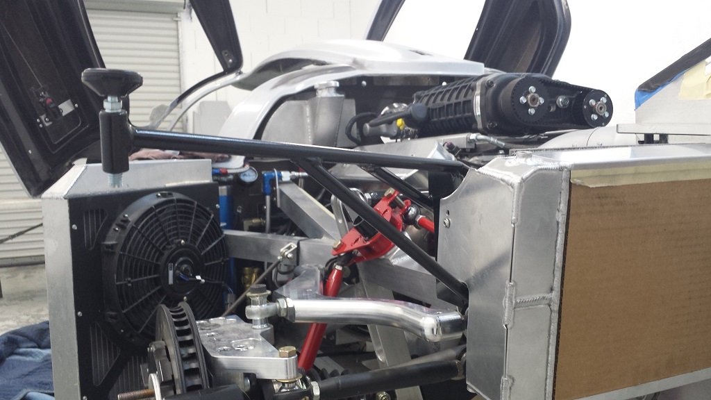

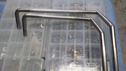

Understandably there was some concern over the copper heater lines. Well, a really good tube fab company was stumbled across and since it would have required me to remove the body or cut a whole in the side of the car if these things ever leaked .... Walla' seamless stainless tubes for the heater system.

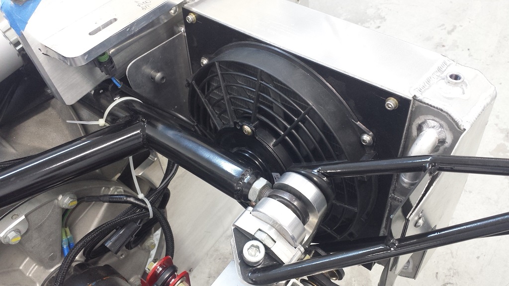

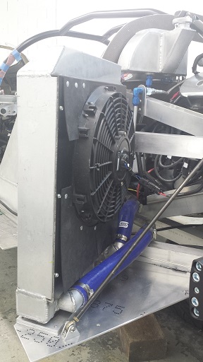

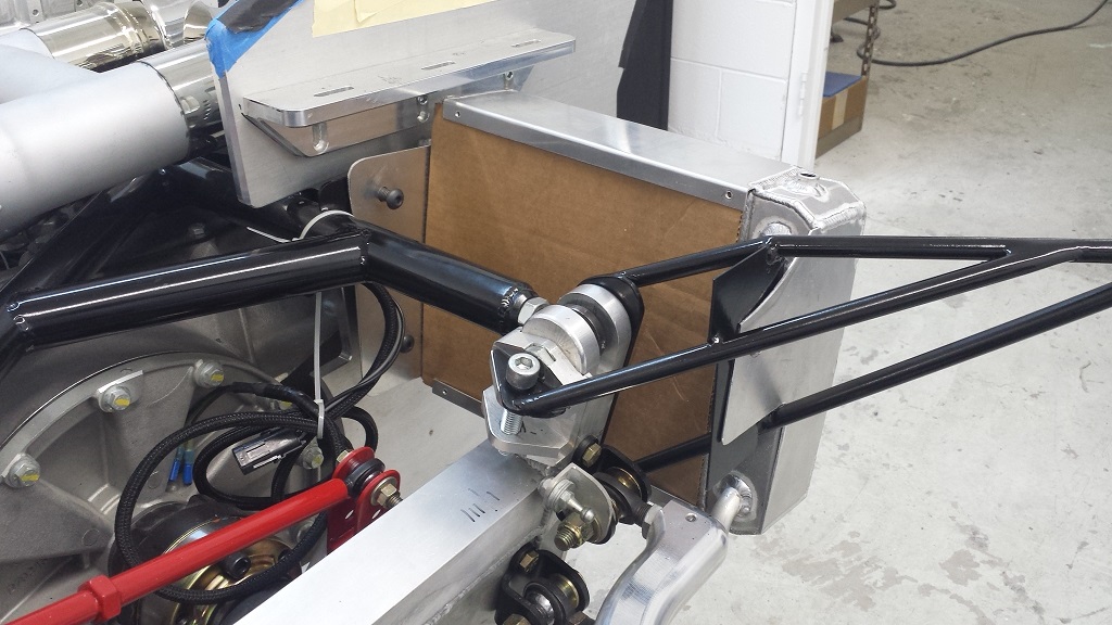

There was also a realization that the lower radiator mounting system was just too flimsy for comfort, so a complete overhaul including beefier materials was needed. Note the flapper doors added to the fan shrouds.

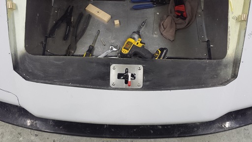

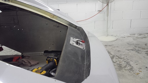

The original solution for the front trunk latch was based on a latch I had sitting around. It looked nice an clean, unfortunately once installed good looks didn't = works good. Even back then I knew it was going to need a complete rethink.
Here is the reworked version which includes a remote key fob actuated release. The safety catch handle was quite a challenge to get it to clear the closed lid yet still be tall enough for a finger to reach it.
I did the same thing. Started with copper, but it really is kind of dicey to have in a car with all of the vibration and sweat joints, and no way to repair with body on. I redid mine in alum 5/8" fuel line material.
Looks good.

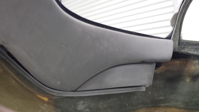

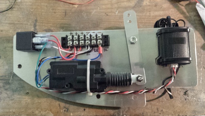

Along the way to finishing the removal of outer door handles I decided that all the Miata door handles had to go. Short version - removed both the inner and outer door handles from the equation. Built up this plate to hold all the electronics for the 'touchless' outside door releases. Press on a certain spot on the outside of the door and pop goes the door latch, no handle, no button.
Tested OK in the car, won't actually finish it and all the real linkages until after the body sees final installation.

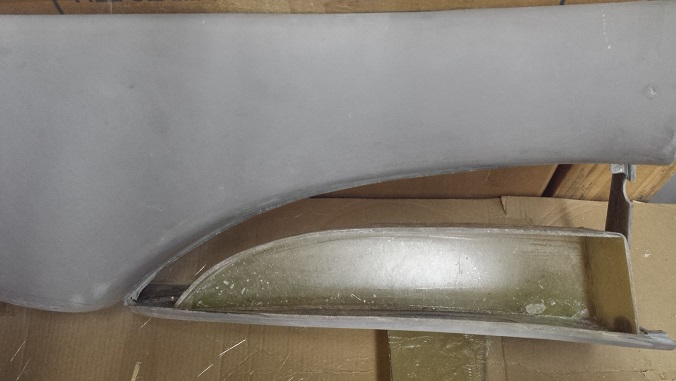

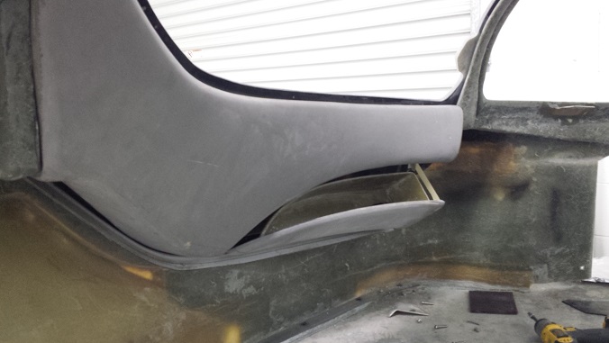

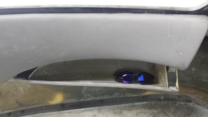

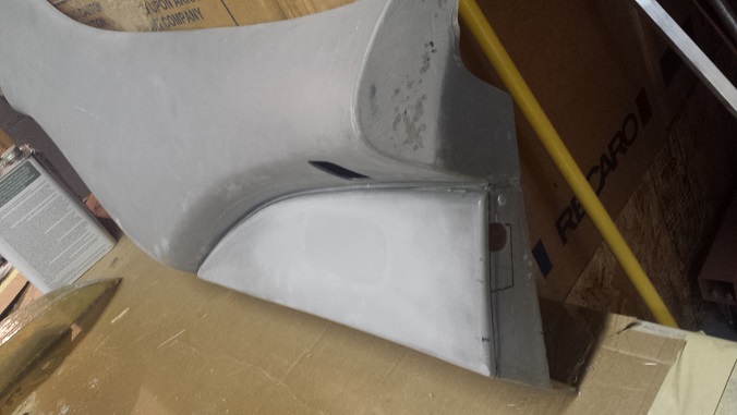

With the inner handles out of the way there was space available for creating tilt out door storage.

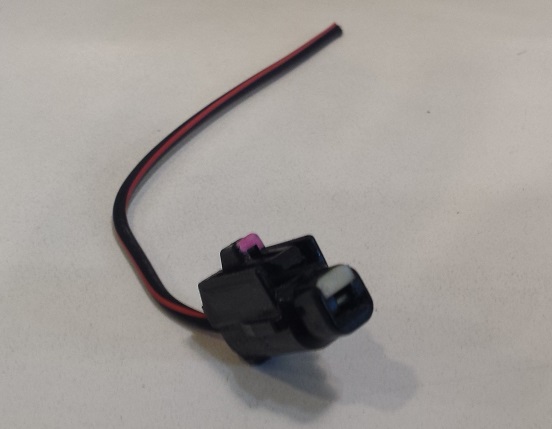

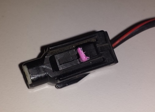

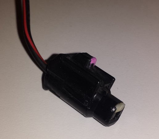

After years of (passively) chasing down leads today has seen the culmination of literally minutes upon minutes of research into the capture of this very elusive creature. The task required great risk and foolheartedly plunging oneself into the deepest darkest underbrush of automotive recycling yards.
I must admit it took some assistance from local tribesmen to complete the task as I had somehow not managed to pack a 10mm box end weapon of influence in my overstuffed mechanical adventure kit. How is it inevitable to take everything, yet still leave something behind?
Regardless, I have now returned to civilization with the prize few have sought, and fewer have yearned for.
- sound of trumpets-
Behold the exclusive Ricardo Ford GT starter solenoid plug in all its glory!

I wasted like 8mths trying to find one several years ago! (and yet Cam was right - just stick on a spade connector and call it a day, LOL)
Ken Roberts
Congrats on the find Mesa. What year Toyota Camry? I'll try and locate a new pigtail from this info.
Looks like it was used on Toyota and Lexus starters in the late 90s and early 2000s.
