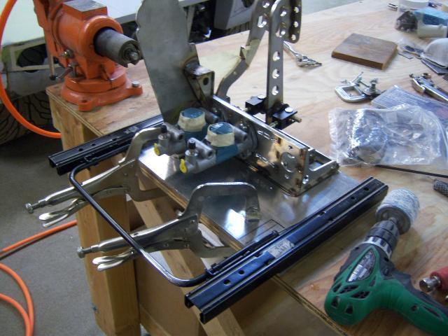

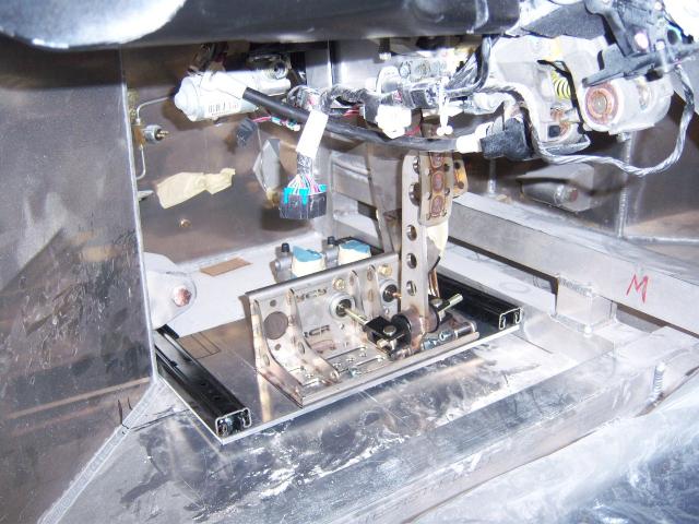

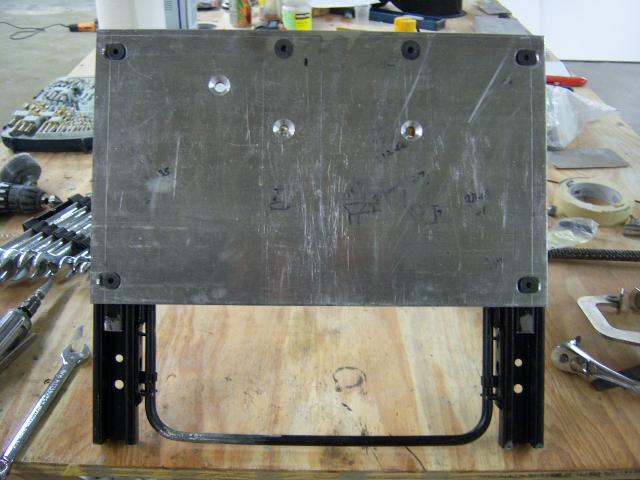

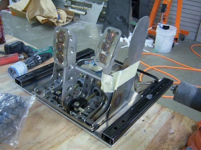

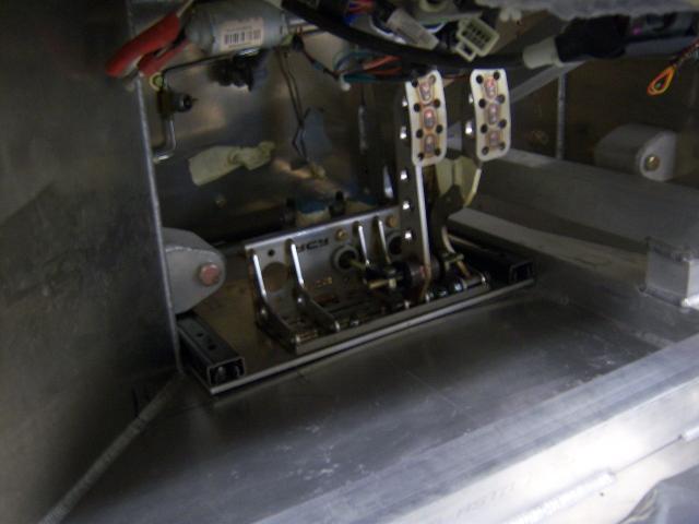

I took Tom's and Howard's pedal ideas and combined the thinking...here is the result. In the picture showing them in the foot well there is a conflict so they are not as far back in as they could be. When done they will reside about 3 inches farther back.
I had to take one of the seat tracks apart to see how it worked because I needed to shorten them....things were going fine until I noticed a ball bearing go 'plunk'.....hey where did that come from?. Eventually I chased down 12 of the little beggars. As it turns out after shortening one needs to weld a stop back on the tracks. Most importantly it holds the bearings in.
Sorry about the flash, when I get the final positioning I'll take another shot
In the end this setup gives four inches of travel.

Now that is an innovative idea! I like it Rob. I also like the inset Digi-Dash module - that's exactly what I plan to do. Refresh my memory - are you doing the adjustable pedals because the seat will be fixed or are both adjustable? Unfortunately, I'm not far enough along to decide if I want adjustable pedals and/or seat...but soon!
Dave L
Great work Rob.
I'm following the same tack although I may try to "tilt" the DBW a little rather than at a vertical. Just got my Ricardo today!
Dave,
With the Recaro seat there just isnt enough room to install tracks, the only thing that will happen is you'll smash yourself against the dash if you move the seat forward. IMO its far better to have the pedals move. With the four inches of travel in my car the driver size range will be approximately 5-6 to 6-2. Not counting headroom limitations.
Dave Lindemann
That makes sense - I forgot about the proximity of the dash and wheel to the seat. What will be involved with moving the pedal assembly in your SLC? Just reach down, pull up on the seat rail locking lever and slide them?
Thanks,
Dave L
The third pic in post 127 shows the narrowed and shortened grab rail, that will be buried at the front of the foot box. A upward pulling cable will be attached to it about mid point to be actuated under the dash near the steering wheel.

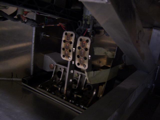

A few more with the pedals in the correct location

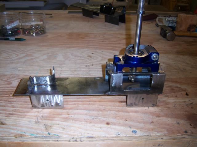

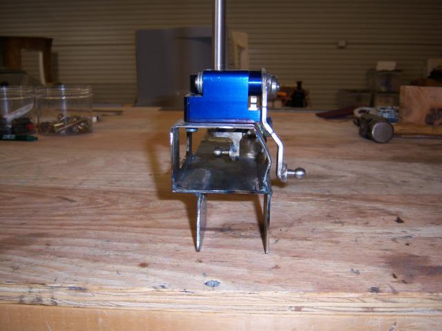

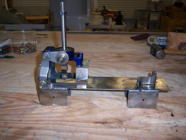

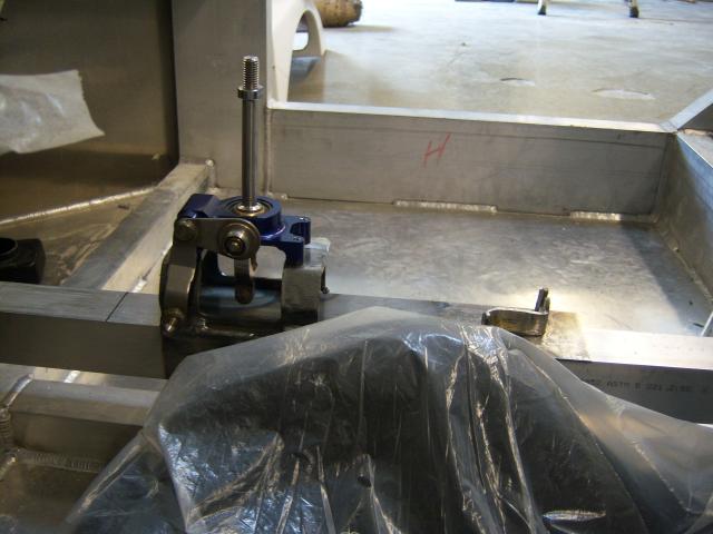

it has always been an ambition to rebuild the stock (remake) base plate for the ricardo shifter. the stock plate is massively wide and is curved to fit into the GT center spine. it all ends up looking a bit much, of course this is fine if you cover it with the nice RCR center trim. me with my seats so close together there is no room for such things. besides i like the idea of some of the car have that naked look. so here is my first attempt at fabrication in steel from scratch. don't beat me up too bad....Ox I am not.

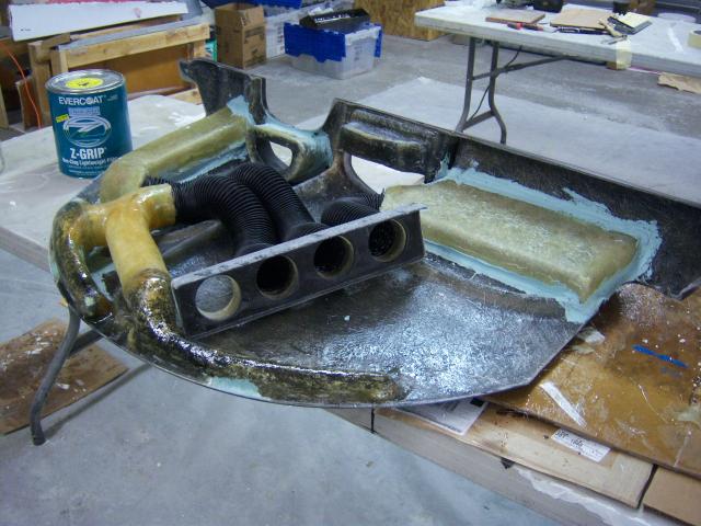

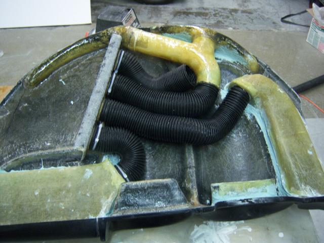

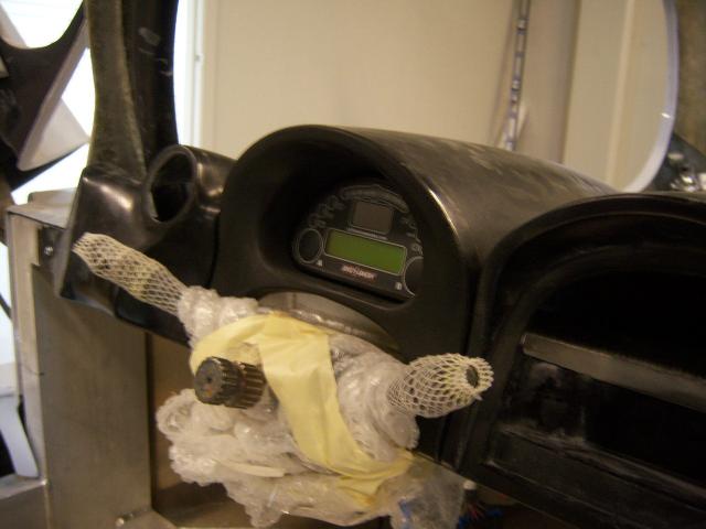

here are a few more of the finished underside of the dash. this has been a particularly demanding winter on a number of fronts so the time and truthfully interest on the car has been way down. sometimes other aspects of life are way more important, so not much progress.
hope you enjoy what little i have done.

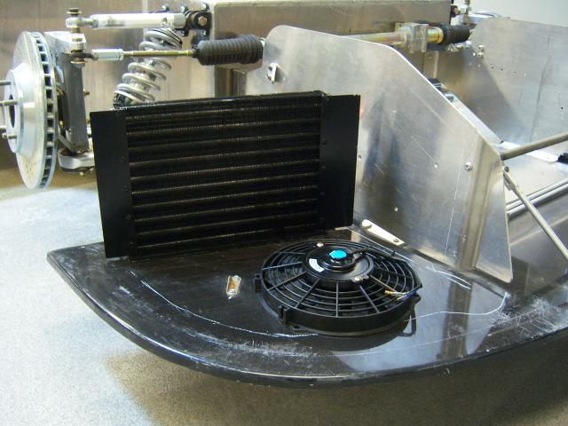

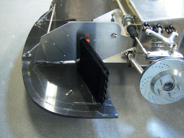

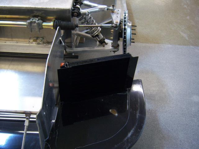

here are a few shots of what has made making a full front trunk at all possible. these puppies took months and months to find somebody to make them. i got suggestions (thank you) from all over the globe on the subject. in the end it was a company right here in so. california that got the job done. they are sweet, made to exact specs and very reasonably priced. without these the whole idea would have been a bust. oh, i guess i should have said what they are....a/c condensers
