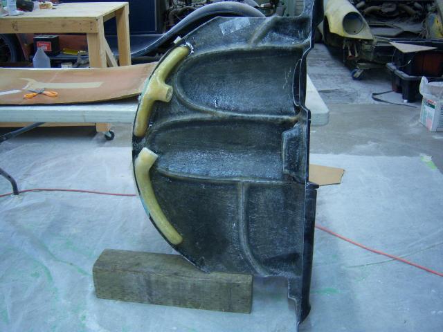

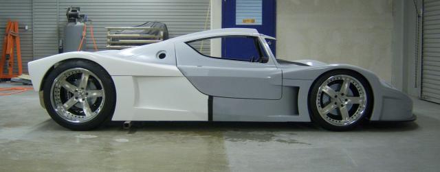

When I was a teen I spent a year hammering out a slope nosed wide body 914 fender set out of steel. The guy next door thought I was a loon for cutting up a perfectly good car only (he thought) for it to never be finished. This here is my second attempt at creating such a thing. I understood the concept of it all but never have done this scale of glass work before, so it has been an interesting upgrade to my body styling skill set.
My technical advisor on this project has been Jack Molleur and I'd like to thank Jack for his selfless sharing of a career's worth of fiberglass part design and working knowledge.
Hey Rob, you did the real work, and a great job too! We're all here to share as best we can. You can really be proud of this accomplishment. Looking super! Great student too even though almost 3000 miles away.
Put in a long day Sunday in order to get the deck lid put together. Ahhhh....slept well that night.

So what is the overall width now?

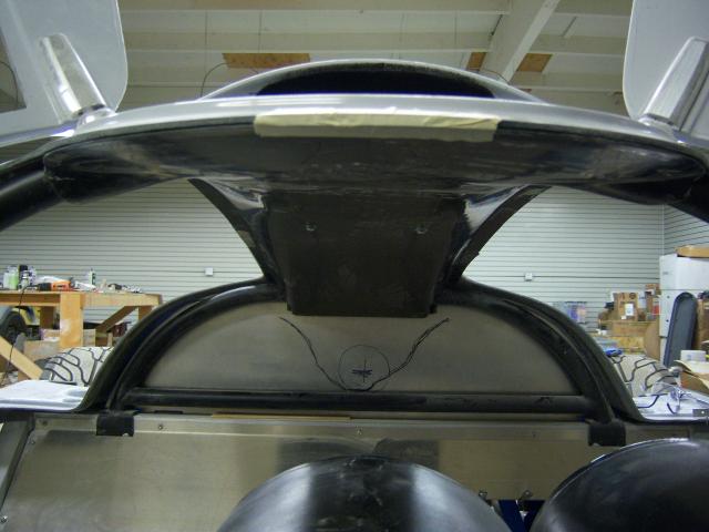

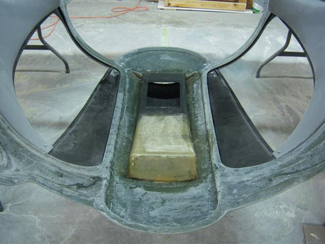

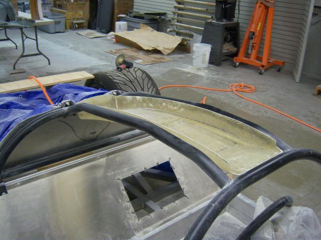

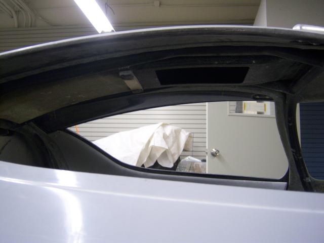

I am set on creating a functioning roof scoop, to that end I fabricated a tunnel to direct air down the center of the roof. The access panel is to allow installation of an air filter. The plan is to run a forward facing manifold (possibly custom design), run the intake ducting from the throttle body, under the rear roll bar and up to this tunnel. There is no way to run it over the roll bar in the rear because the roll bar blocks too much flow.

So, am I understanding your roof scoop correctly - you are drawing air to the interior through the scoop and through a filter to the interior and drawing air to the the engine intake through the same duct? If this is the case the only thing I would be concerned about is engine compartment gases migrating to the interior - especially when the car is idling. A charcoal filter may help. Coming from driving a Lotus my goal is to seal the engine compartment from the interior as much as possible. Just my $.02.

The filter will be used to protect the engine, the engineering has been worked out and parts identified to pull the whole idea off. The primary use of this is to feed cold air to the engine, the interior air option is a fall back position. If for some unknown reason the engine feed does not pan out, the plenum will be used provide outside air to the interior.
I really wanted to avoid having this beautiful scoop in the roof serve no practical purpose...that kind of stuff just says "k.t c.r" to me.

I drew a version of an air box like this one you show. My concern was the hard angle the air must make from the throttle body to get up to the filter box. Now that I see Apollo has done exactly that....I guess it's not as much a problem as I thought.
