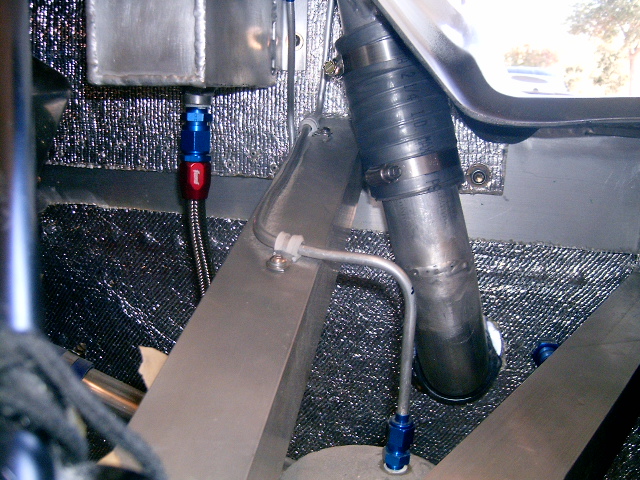

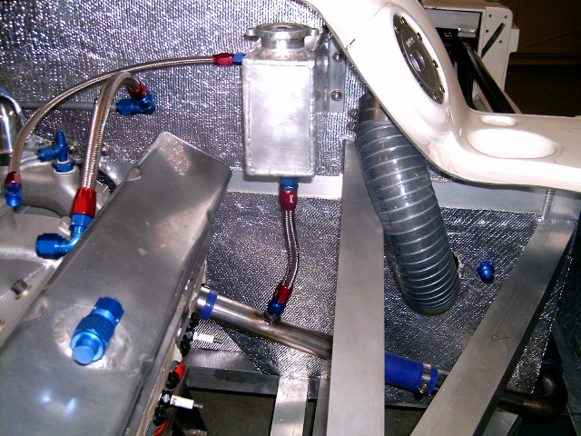

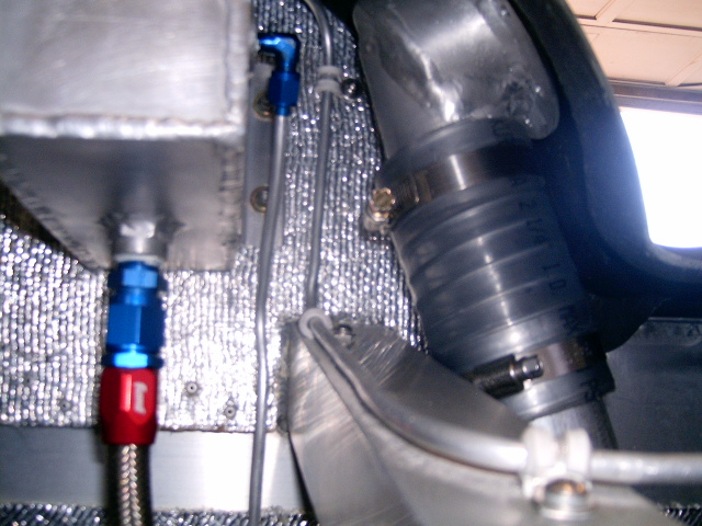

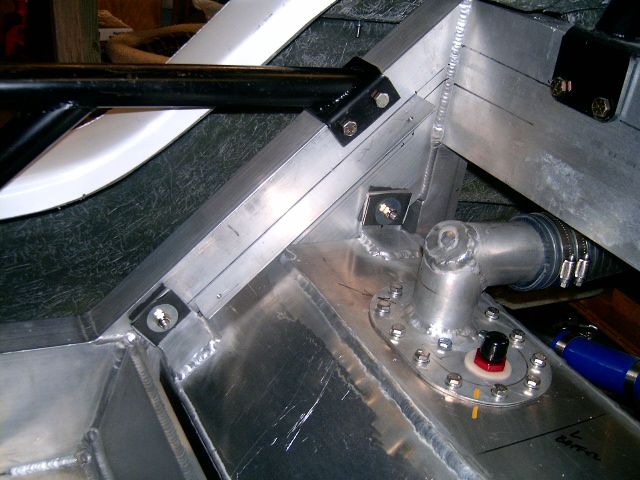

My supercharger intake and throttle body are where most people route the fuel filler hose. I need to route it outboard of 2"x2" just like you did in the picture below. You indicated that you used this flexible fuel filler hose: Wire Reinforced Clear Filler Hose - 2.25" I.D. - CFH225W | Fuel Safe .
Did you need to modify the Sparco or anything else to make it work?
Do you need to be careful when pumping gas?
Howard Jones
I did cut off the neck of the Sparco filler and weld on a more straight down outlet tube. It fills fine from a 5 gallon fuel can but I haven't filled it from a gas pump yet. I don't see why it wouldn't be fine however.
The hose I used is very stiff and if I did it again I think I would use a more flexible hose. A 2 inch hose work just as well so you have more lower priced hose available also.
I made all my pieces so here's some pictures for your information.

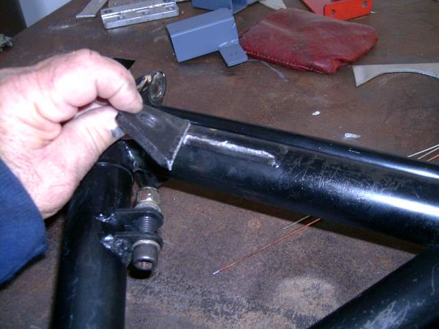

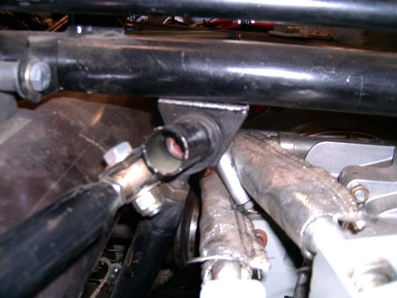

THEN DRAMA. 3rd session. There is a small tab welded at the rear on the chassis X brace over the engine that I used for a pickup point for the rear wing mount frame work. That 2 inch weld cracked and then failed. I felt it on the brakes at about a buck and a half and it was all my underwear could do to get the car slowed in a straight line. If anybody thinks that big wing is for looks then you are wrong. It adds a huge amount to down force. FUCK ME that was a moment baby. I though a tire had gone down or something like that but as I ran back to the paddock the car felt fine at low speeds <70-80 mph.
As I was getting out of the car to have a look a guy pulls up and gets out of his car DURING a session and tells me that "the left side of your wing is about 3 inches lower as the car get really going fast, you should have a look at that" I thanked him and he got in his car and went back out. Like I said really cool people!!!!
So I took the rear wing off for the last session and ran a couple of laps. Completely undriveable!!!!! Really, REALLY HUGE front aero push at high speeds >100. So bad I had a hard time keeping the car in a straight line. So if you ask me if the big honking canards do anything......Yes they do .... I was really surprised to find out just how much front downforce this car makes. With out the rear wing I just put the car away and called it a day.

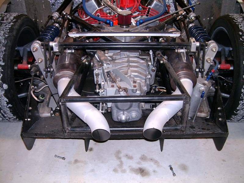

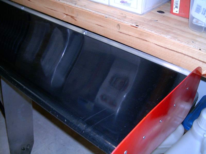

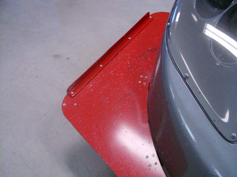

Here's a couple of pictures of the Gurneys I ran at COTA. The last two are the broken tab. I ordered all the material to redo the wing mount chassis frame. I will put both mount points in double shear and use separate mount points for the chassis link and the wing frame next time.

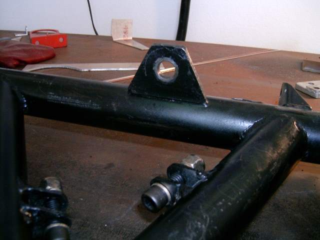

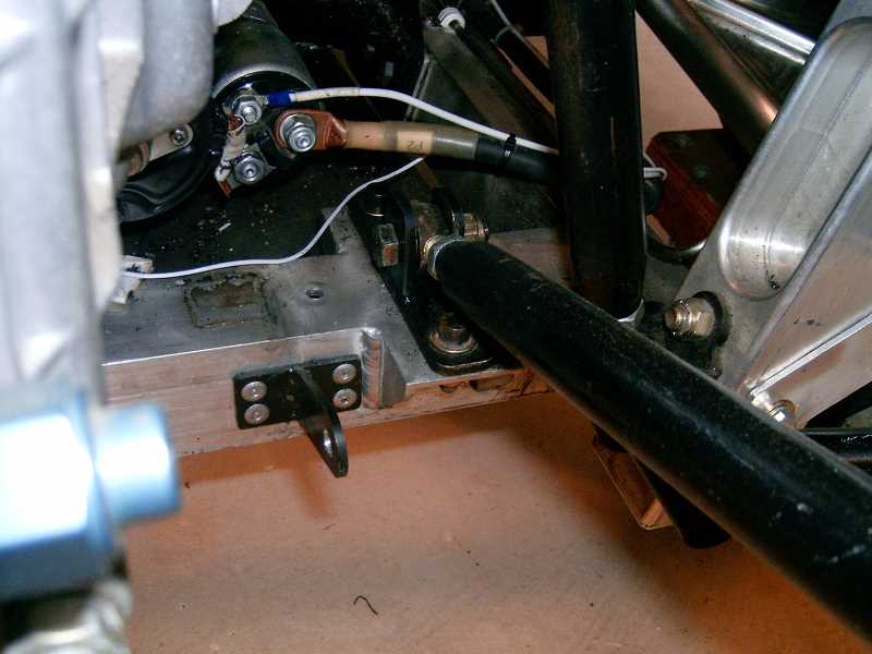

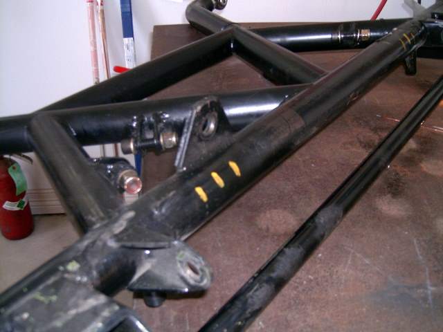

Howard Jones

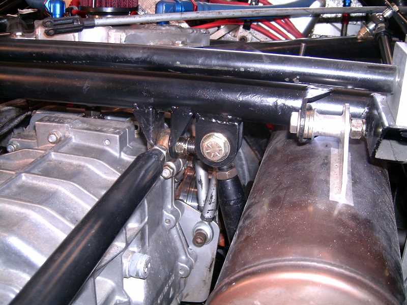

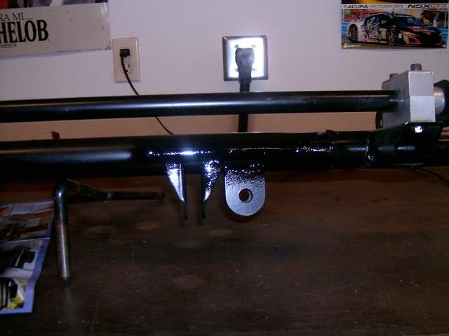

So I fixed the mounting tab problem. On my car the oem tab was welded on only one side cracked and broke off. To be fair it was being asked to take an additional load fore and aft instead of just in tension as originally but if yours is only welded on one side I would recommend you weld the other side.
Here is the double shear repair and the additional mounting points for the wing system next to them.

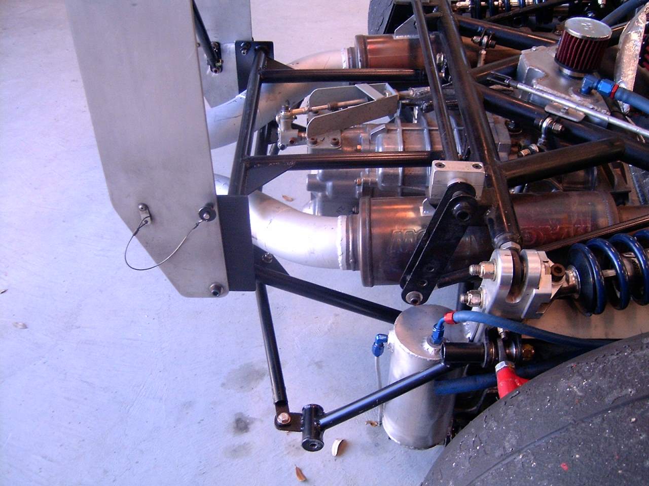

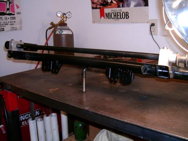

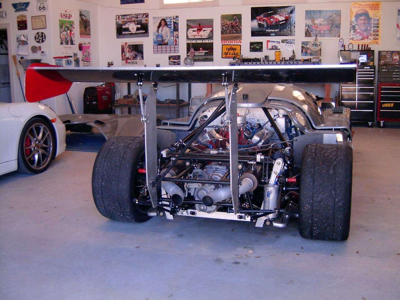

Howard Jones

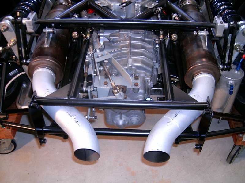

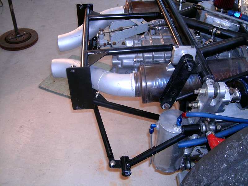

I finished the remake and update of the wing mount sub chassis, the mount points on the big X brace, and the removal of the diffuser and redesign of the body support mounts.
All the material came from Aircraft Spruce and its 4140 CM. The big tubes are 1X.058 and the smaller ones are 5/8 X .058, and the steel flat stock is 1/8 thick.
Next I want to redo the wing uprights slightly mainly to allow for better and easier wing AOA adjustment.
Making these tubing structures is very interesting from a learning process but fitting the "fish mouth" notches can be very time consuming. I used a free online tubing notching program to do the basic tube notch cut out line on the tube but getting the angle correct isn't as easy as it looks. In the end the fit of the joint is the important thing because it make the welding so much easier and stronger.
I think most of my snails pace is due to experience but I marvel at people who can just look at two pieces of tubing, cut them up and weld them in a few minutes.
Anyway here are the pictures.

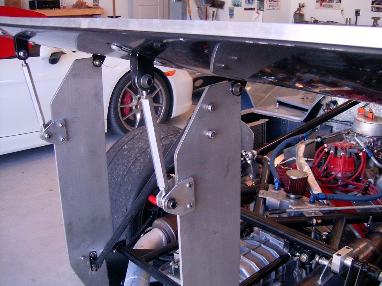

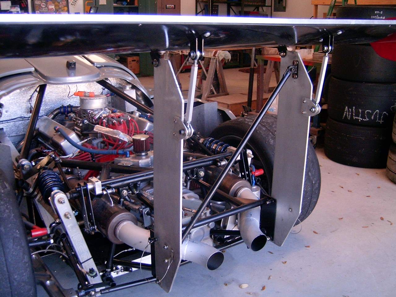

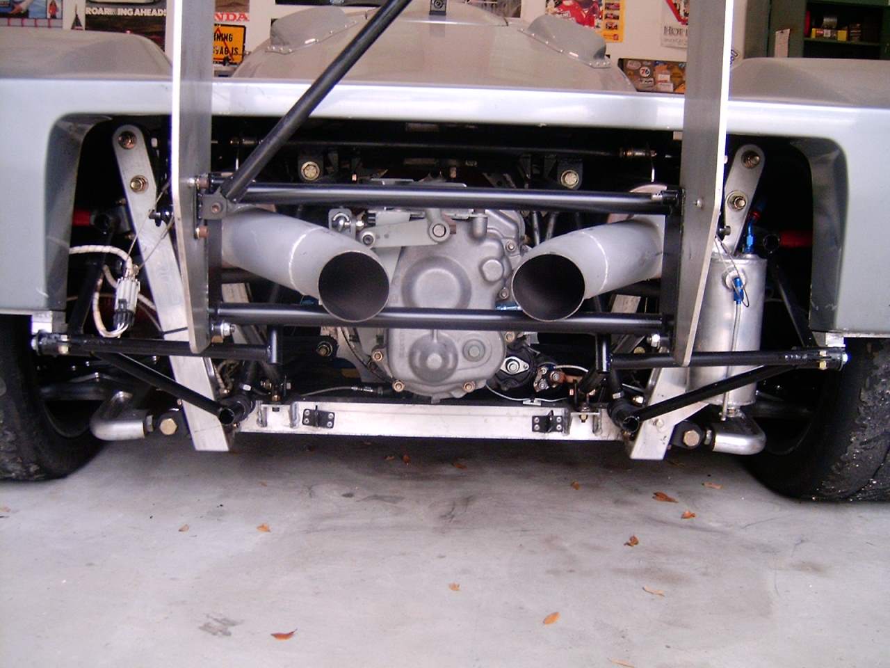

Howard Jones
Here's the completed modification to the wing mounts. As is I can adjust AOA from 0 to +6 degrees. Changing the aluminum hex tubes to ones that are 1 inch longer will allow for AOA changes +5-12 degrees.

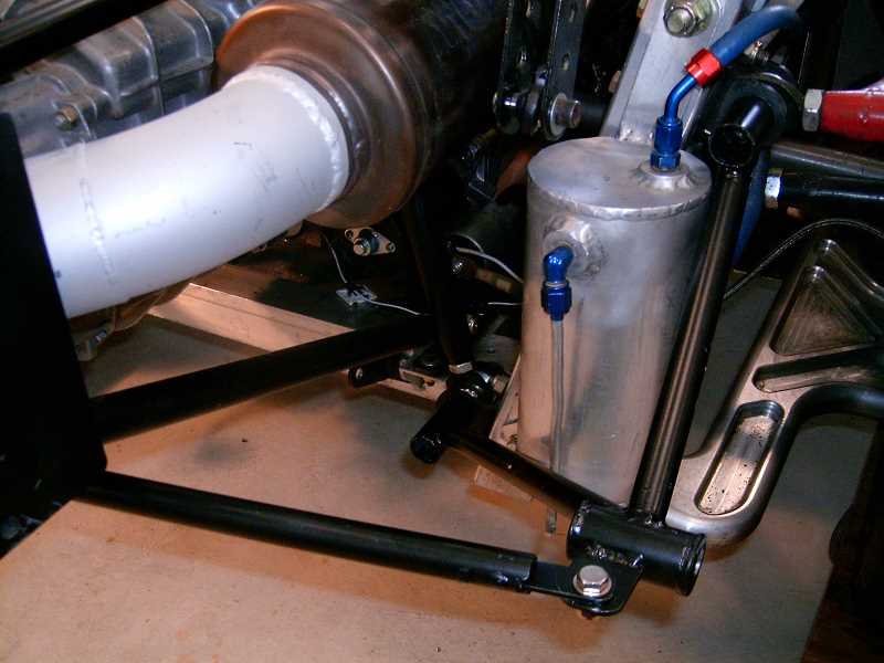

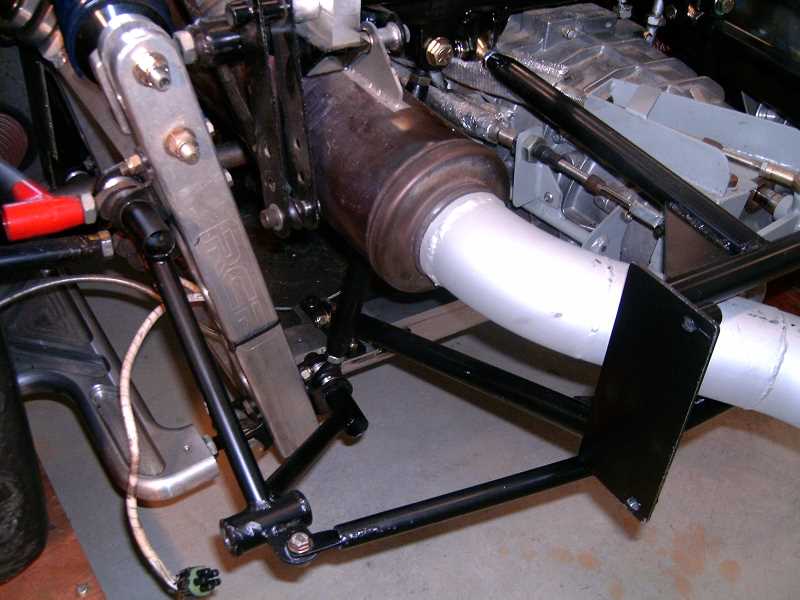

Howard Jones

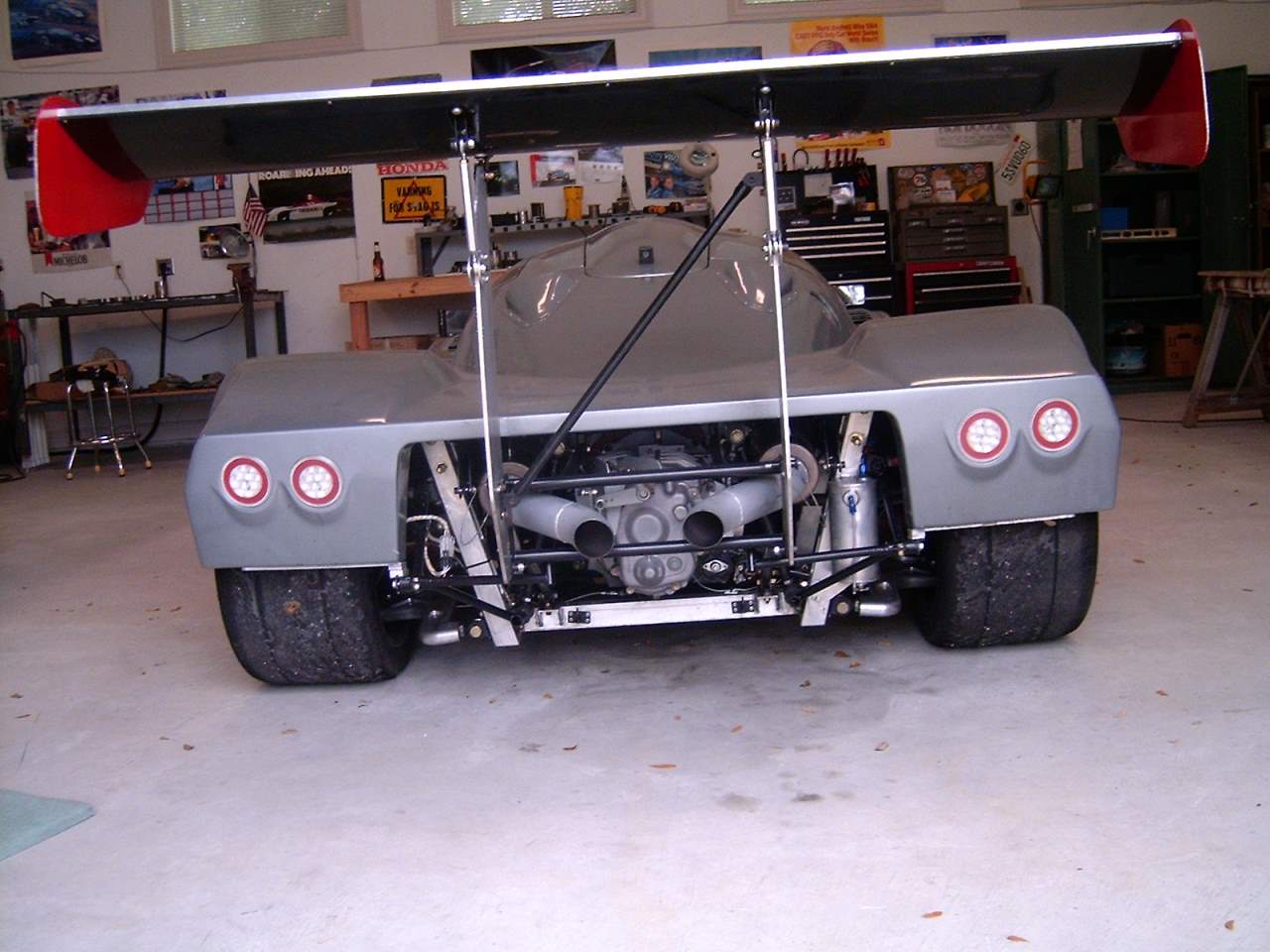

Here's how the car came out complete with the removal of the diffuser/ body mount replacement sub-chassis.
